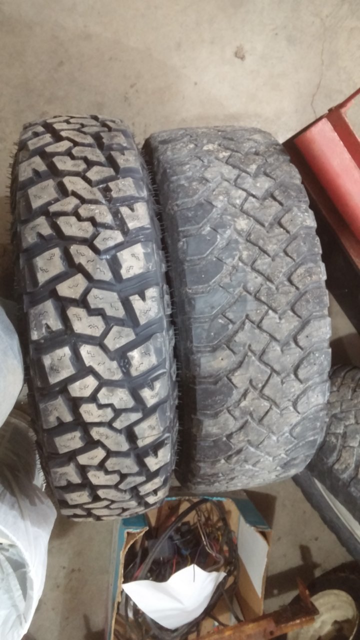

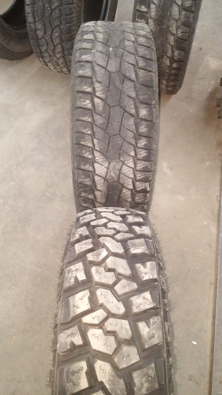

    Those look bad ass! What brand and size are they?

    @DJB1 They're Dick Cepek Extreme Countries 235/85/16. They are pretty quiet so far and smooth no problems balancing. I haven't had a chance to get them off road yet.

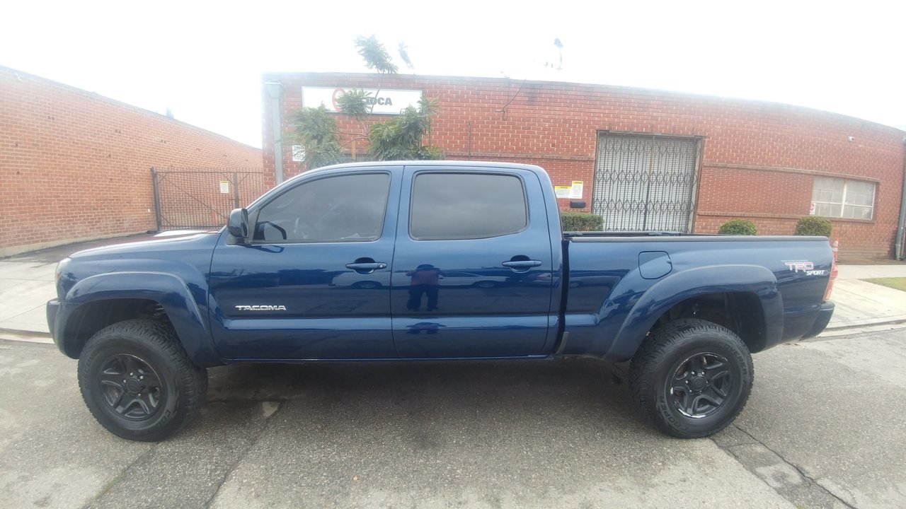

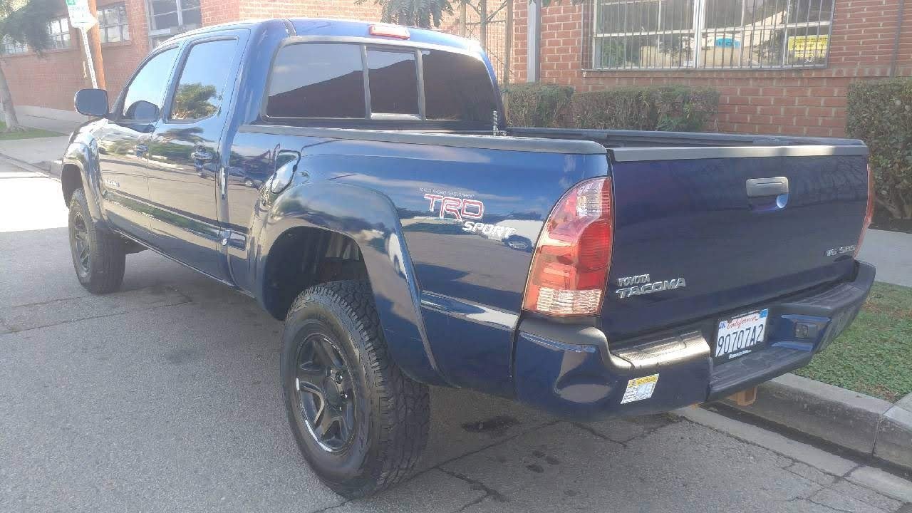

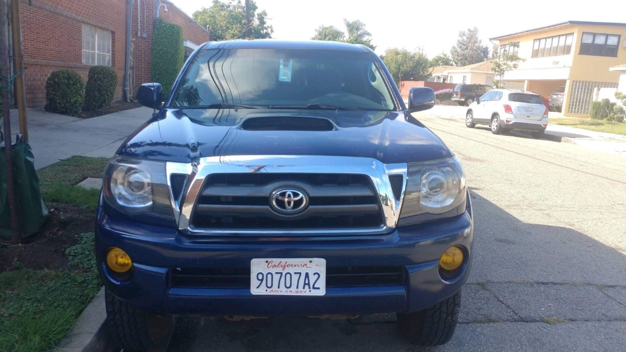

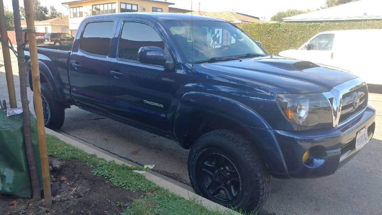

    Went from 285s to 235s and haven't looked back since! Love the lighter and taller tires.

    235s are taller than the 285s you had?
    what was the second number in that?

    Just barely taller... 285/65/17 = 31.6" vs 235/80/17 = 31.8"
    Guess they seem much taller since they are much more narrow and play tricks on my eyes
    Got much better gas mileage though! Gained about another 3 MPG

    Looks great!
    Stock suspension?
    I'm planning on 255/75/17 or 255/80/17 on my stock suspension, then lift later on.

    Not stock suspension. I have 5100s with OME 888 coils up front with extended length 5100s in the rear and Dakar leaf pack. Approximate 2"-2.5" lift overall.
