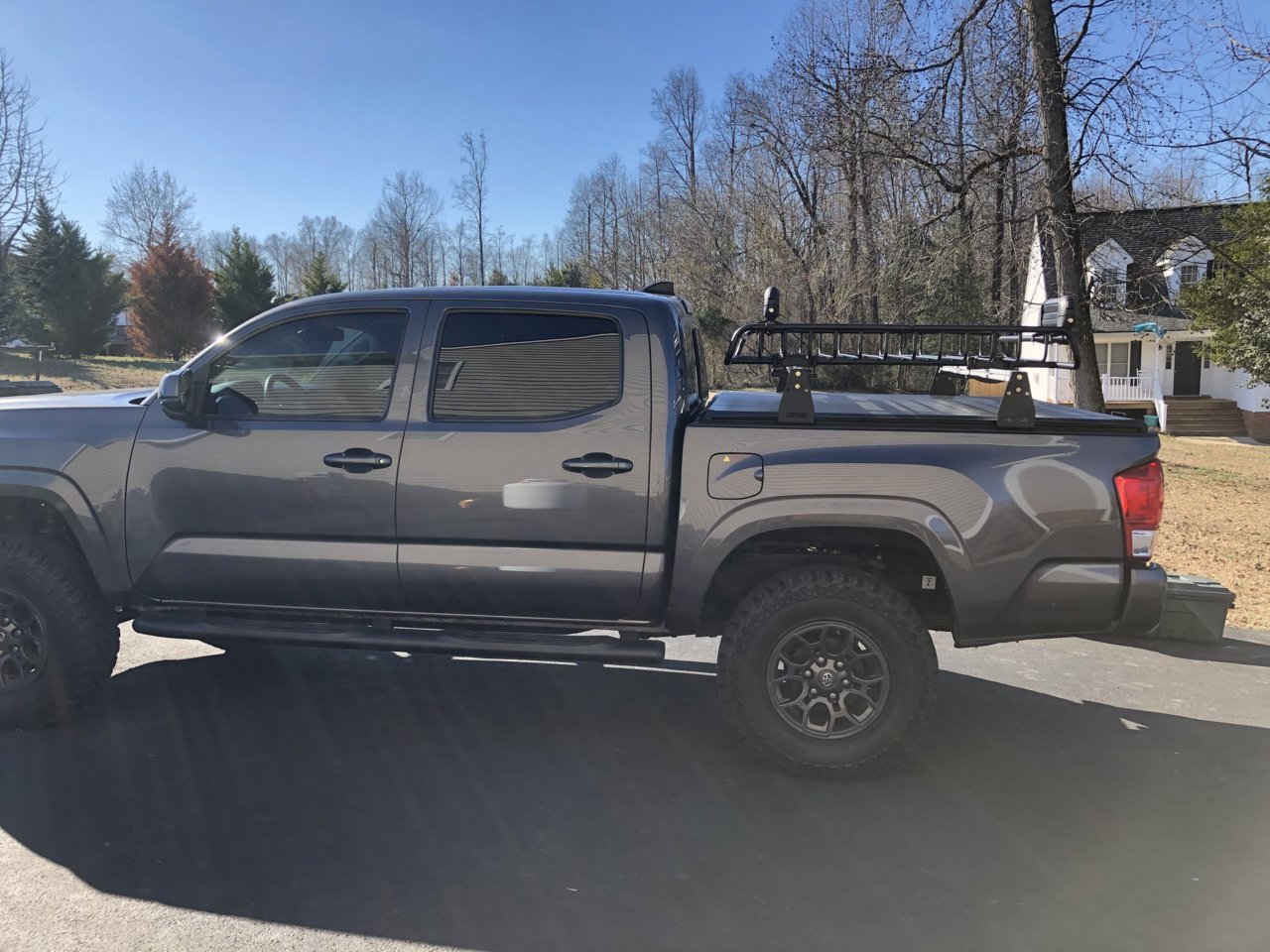

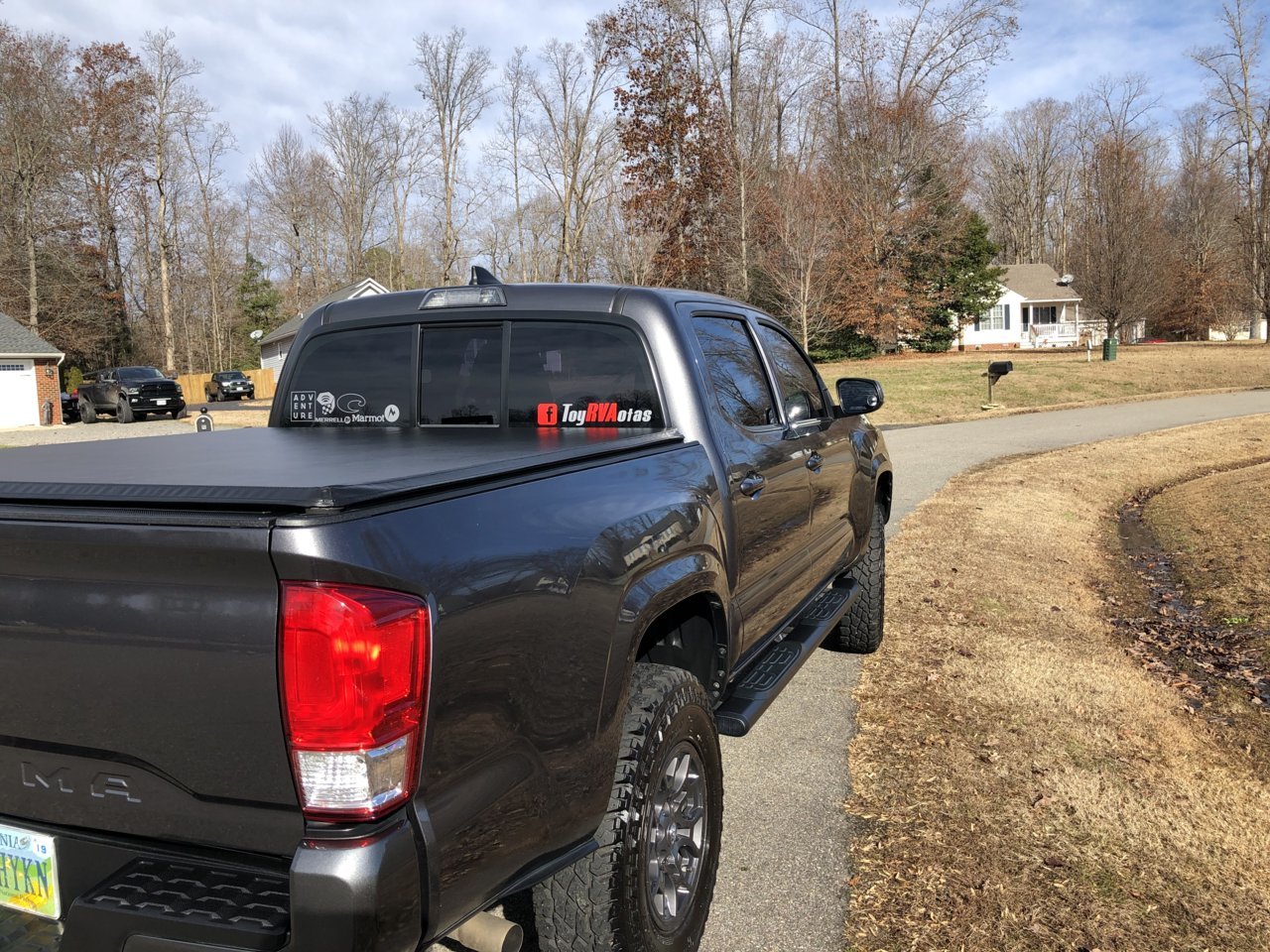

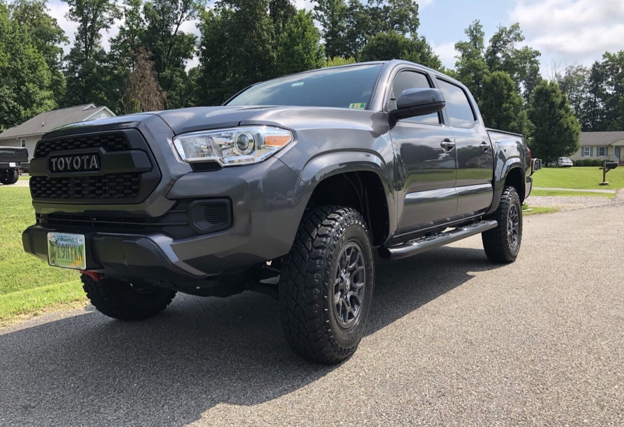

    DD1F42F9-ADD5-4D11-8CAE-6024BFD8F6F0.jpg 02519CDE-3936-434B-9097-6CAE73CFE964.jpg 8E97E426-2289-417A-A570-0ECAEE6CBBCC.jpg I love my 235/85/16 Cooper ST MAXX’s

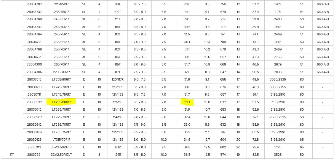

    Based on Falken's website the overall diameter is 33.1in.
    Here is the info found on Falken's website, this shows the specs for the Wildpeak A/T3W's

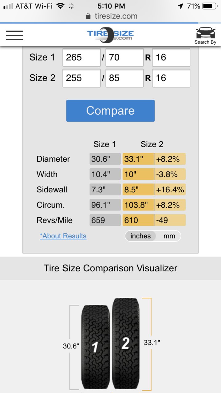

    Is that accounting for the amount your speedo and odometer are off now?
  12. Jan 24, 2019 at 2:15 PM
    #1552
    go2cnavy
    go2cnavy Well-Known Member
    Sep 25, 2016
    #198172
    1,236
    ‘17 OR DCLB. VF Tuned, 5.29s, Dobinson’s MRR
    OVTuned w/ 5.29s 2” lift on Dobinson’s MRR paired with ICON RXT leaf packs. SCS RAY 10s Toyo Open Country AT III 285/70R17
    Yep. That’s what the factor of .92 represents - 30.6/33.1=0.92
    or multiply by 1.08.
