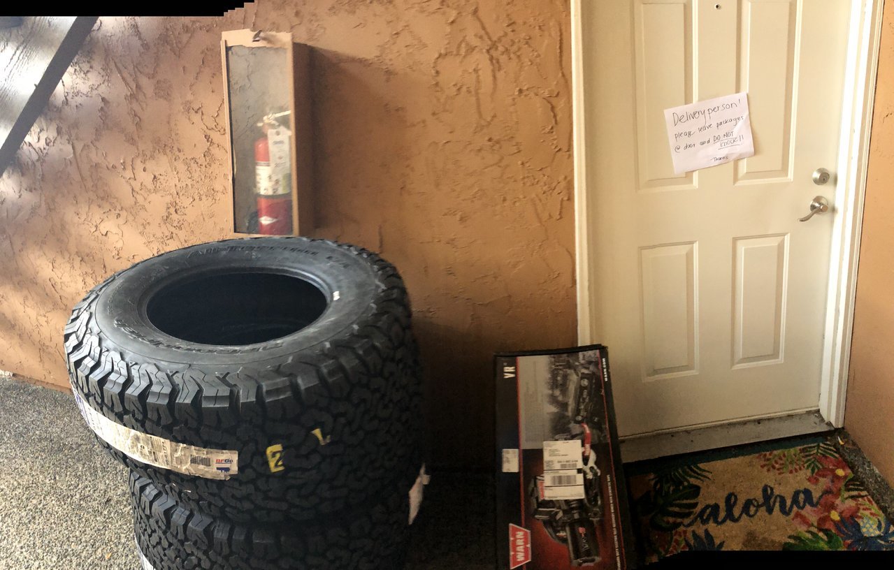

    Look what goodies just came in. KO2s 34x10.5x17 to replace my duratrac 255/75r17. Excited but can’t lie, KO2s don’t look much bigger than the duratracs! Anyways, I’m in the Seattle area, my duratracs will be for sale in a few weeks if anyone is interested.

    How much do the BFG's weigh and are you lifted?

    Got a 1.5 inch toytec lift. Will be pulling the lift out next week for OME. Those will be for sale as well. Both tires and lift have about 18,000 miles.
    Bfg package weight 60lbs. Don’t got a scale

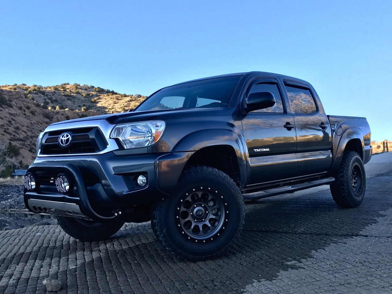

    Personally, i run 255/75/17 KM. 36F0DE17-E8CF-47DD-A70A-7BD5BE6A90B8.jpg

    Nice truck, what do you have for a lift?
    Can you post more photos?
    What psi are you running with the Ray10s?
    Thanks

    Thanks bro. For the lift it only has a 2.5 leveling kit in the picture. I have a set of kings for the front and total chaos UCA and fox W/ reservoirs just sitting in boxes. I’m waiting for my bumper to come in before installing everything at once. Once it gets here I’ll bombard this page with lots of pictures.
