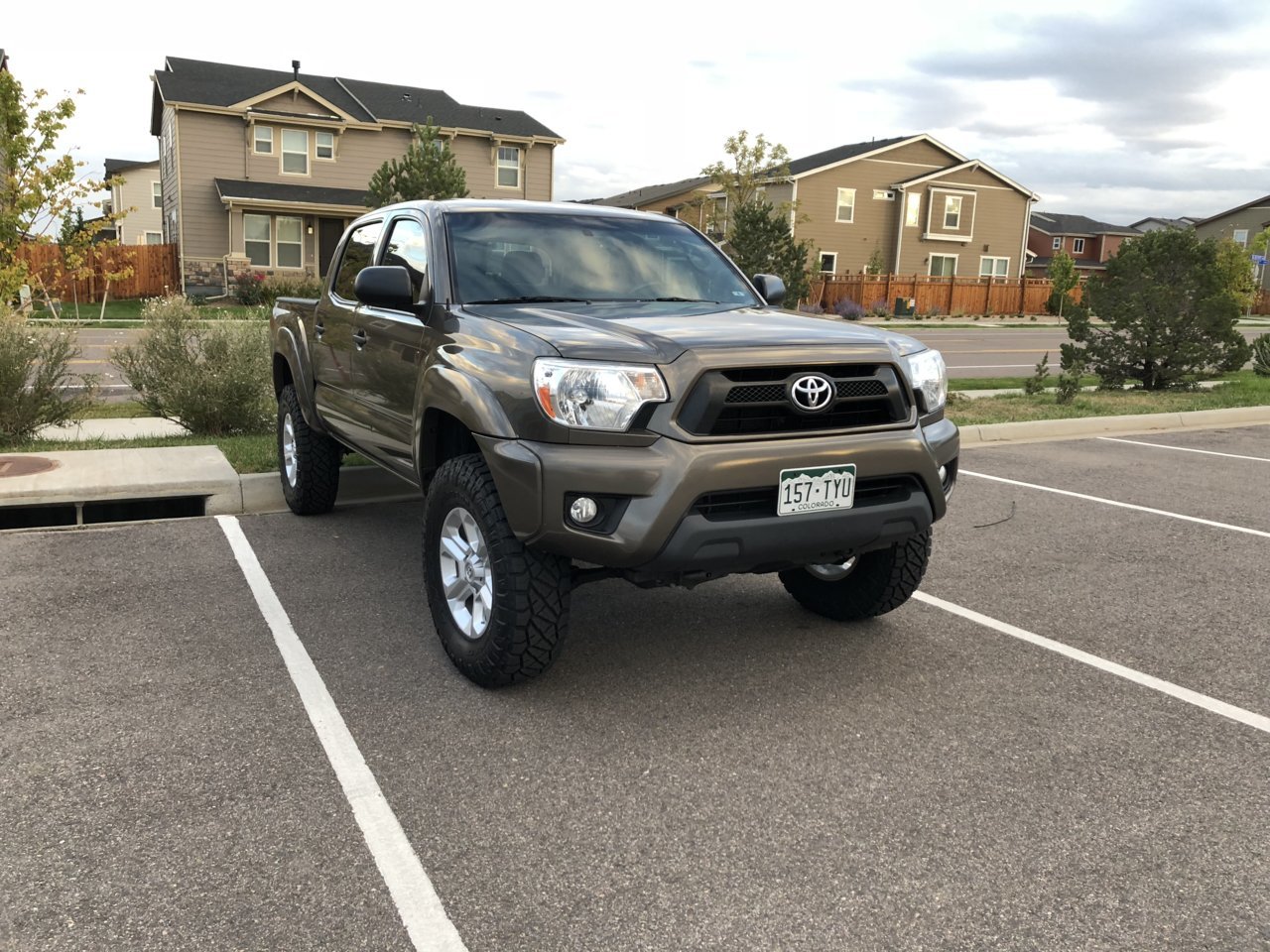

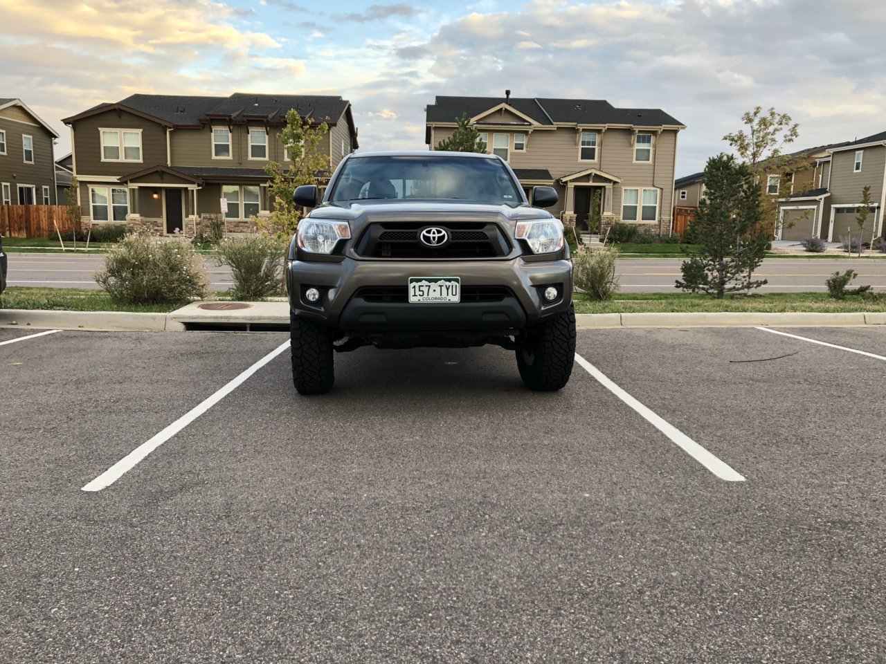

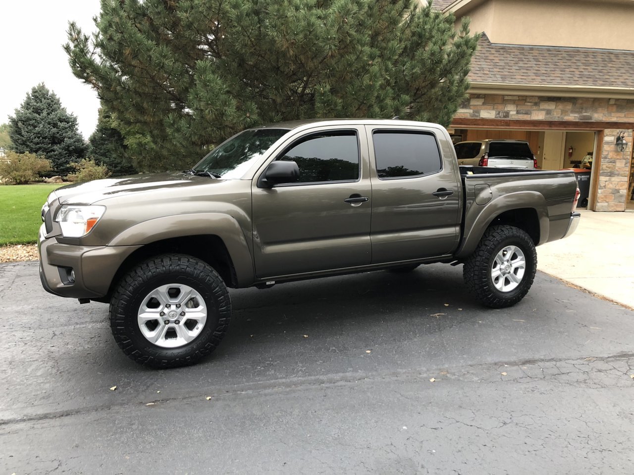

    @LadyRed I'm not sure if this is skinny enough for the first post but Goodyear is now making the Wrangler MTR in 275/80/17. It's definitely skinny for being almost 35" tall.
    Tire Size: LT275/80R17
    Product: Code750190326
    Speed Rating: Q
    Load Index: 121
    Load Range: D
    Sidewall: Black
    Max Load (lbs): 3195
    Max Inflation Pressure (PSI): 65
    Approved Rim Width (in.): 7.5-9.0
    Measured Rim Width (in.): 7.0
    Section Width (in.): 10.8
    Tread Depth (in 32nds): 21
    Outside Diameter (in.): 34.6
    Revs Per Mile: 602
    Price: $295.00
    I got them for $294 from Discount Tire. They had to order from the manufacturer because they aren't stocking them yet.
    Here they are mounted on my truck. Wheels are gen1 Tundra/Sequoia, 17x7.5 et15. I only had to do minor trimming to the front bumper and bottom rear corners of the front flares to be able to drive them on the street. I also have my LCA's adjusted all the way forward and my SPC UCA's are set to the +2 "D" caster setting. Lift is about 2.5" front and 3-3.5" rear. They will require more trimming and a small CMC to flex offroad.

    Diggin the Tundra/Sequoia Split Spokes

    That size look awesome. Fingers crossed for a 275 85r16 someday.

    This looks good, mang.
