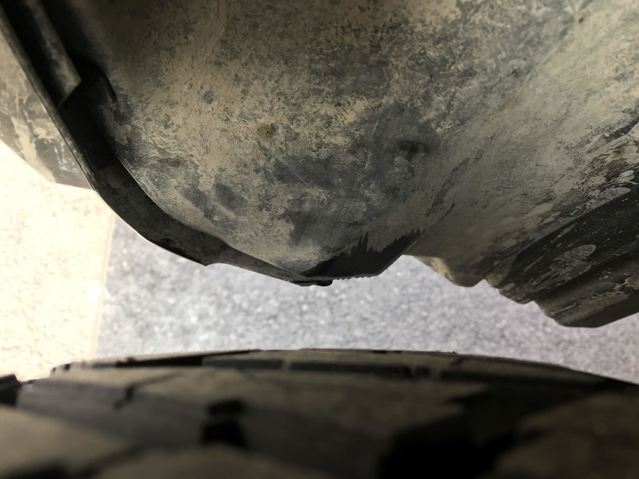

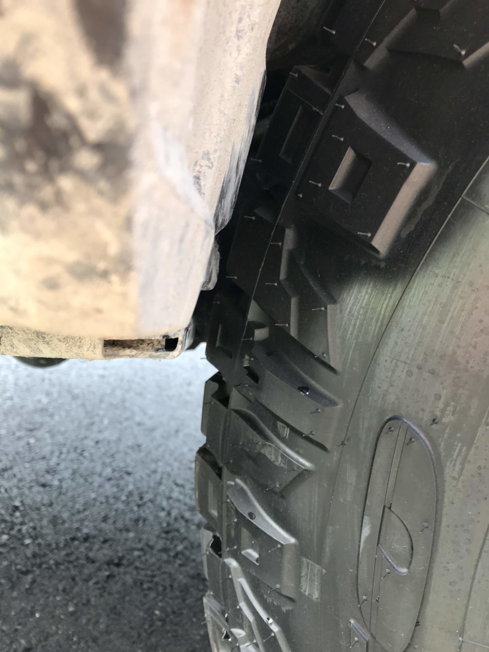

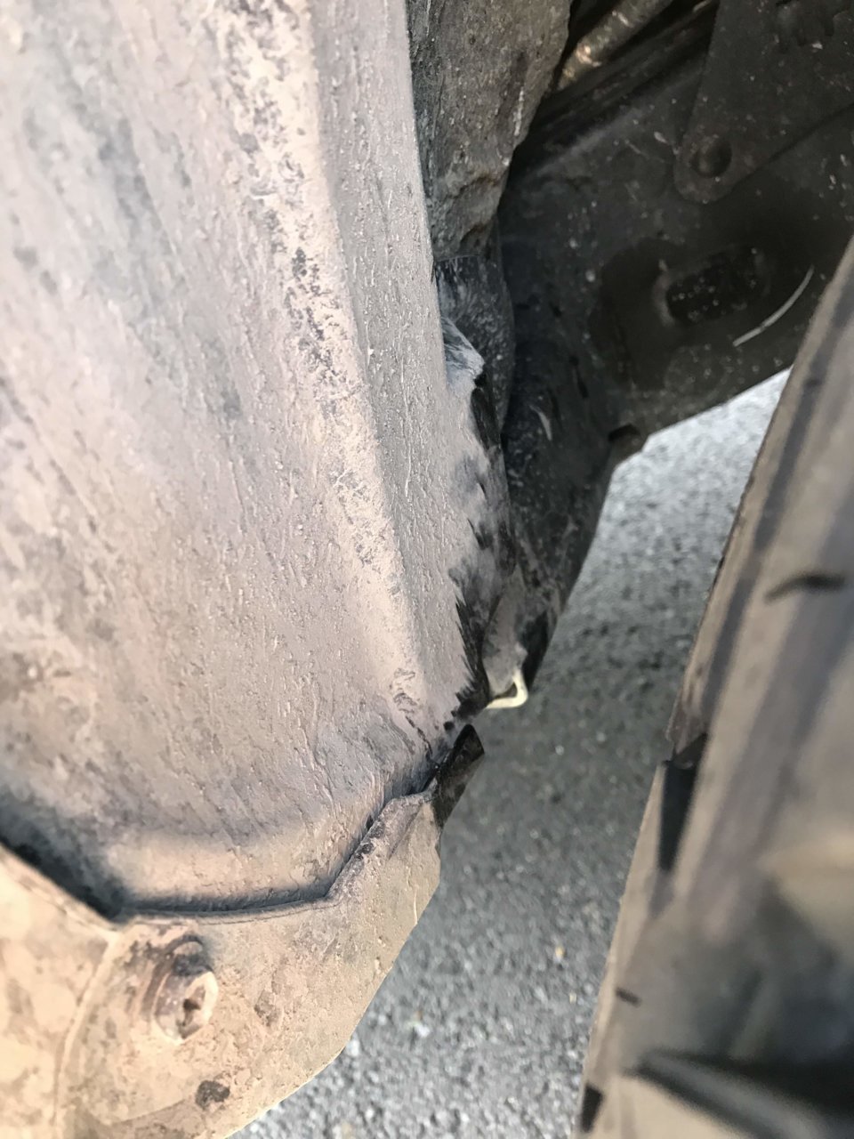

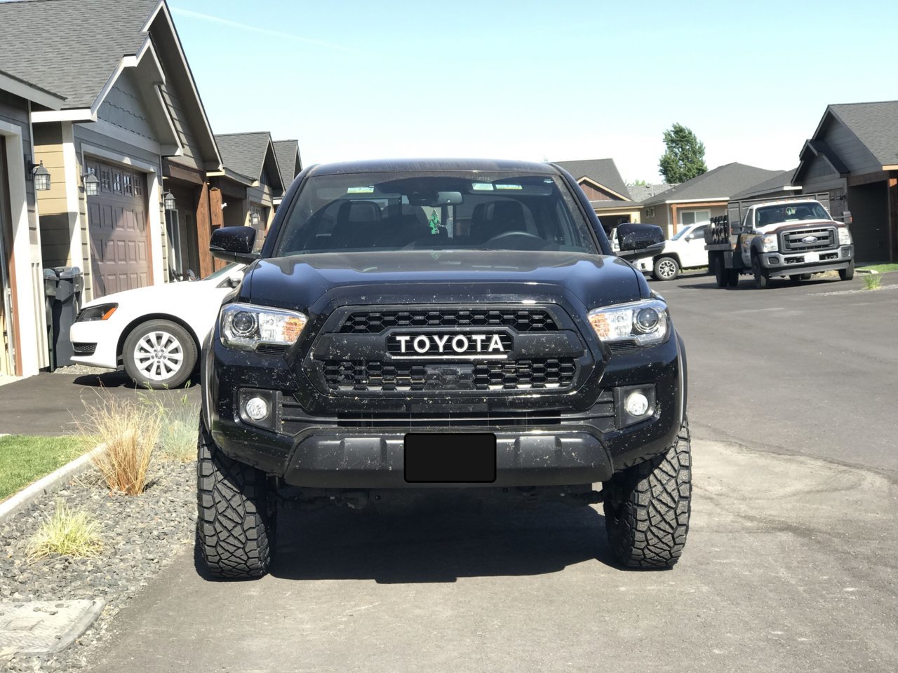

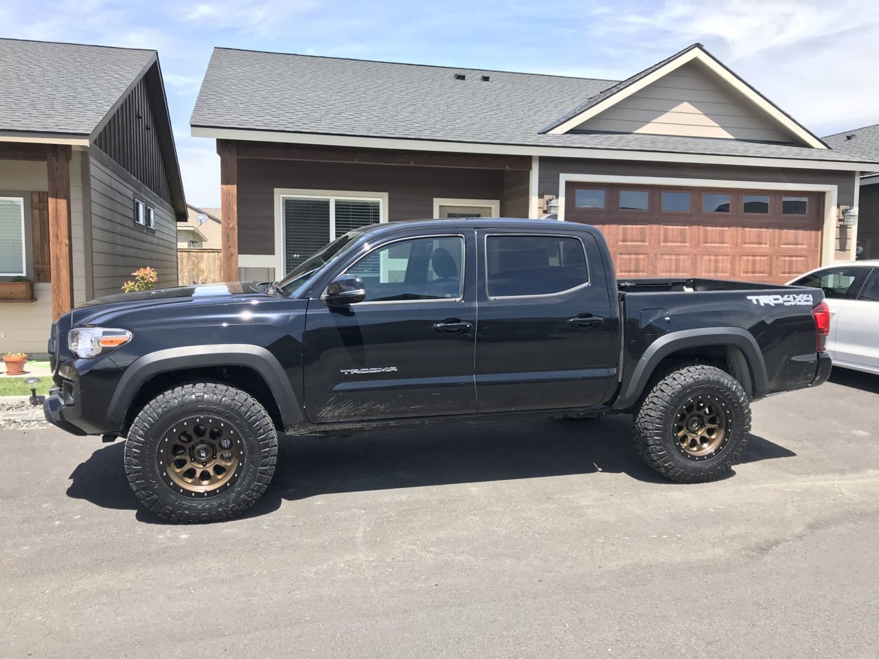

    Here are the Ridge Grapplers in 255/80r17 on 17x8.5 -10 offset. After getting the alignment done, it only rubs in the front some. I haven't had it flexed a lot yet, as I've been doing a lot of work and haven't gotten to go out. It looks like the frame won't rub even at lock unless it were a pretty big flex. I had to trim the tab that connects the bumper to the wheel liner and zip tied it back a bit further as well as the trimming the black tab of the fender on the rear, as it rubbed with any flex.
    I do plan on lifting soon, so I'm pretty happy with how it fits now.

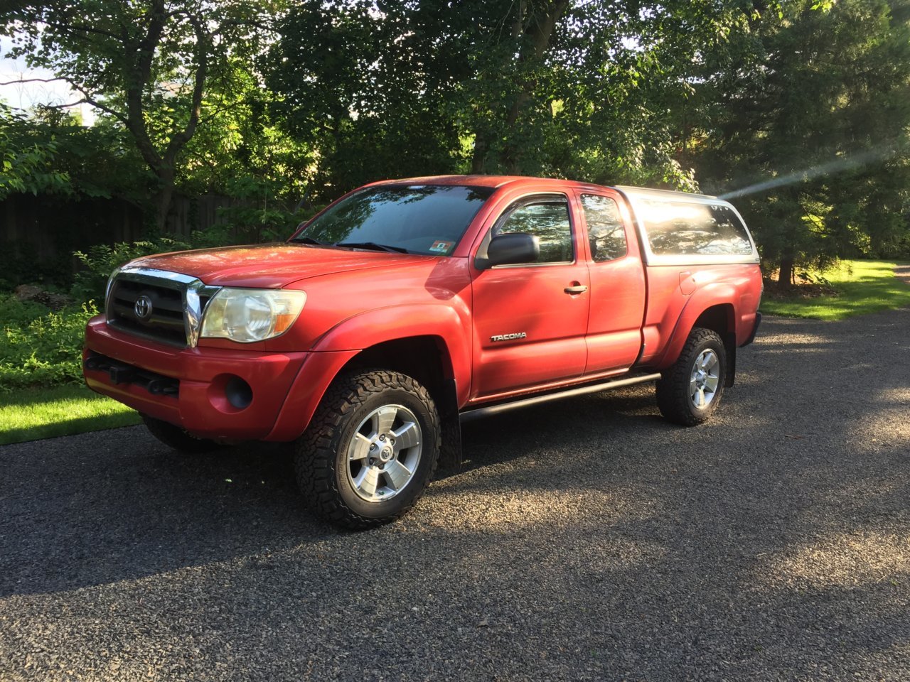

    Installed a few weeks back 245/70/17 K02. Is a nice change up from the last set, thanks for so many post as it helped with gathering data.5F222C88-B4ED-4279-AA98-8EFBD9DB87ED.jpg
