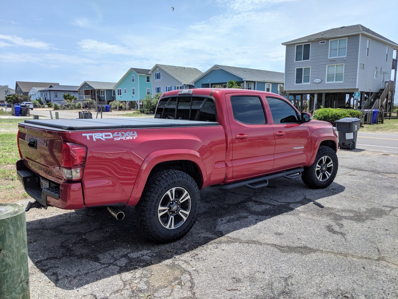

    Yep, that was a typo. 255/75/17.

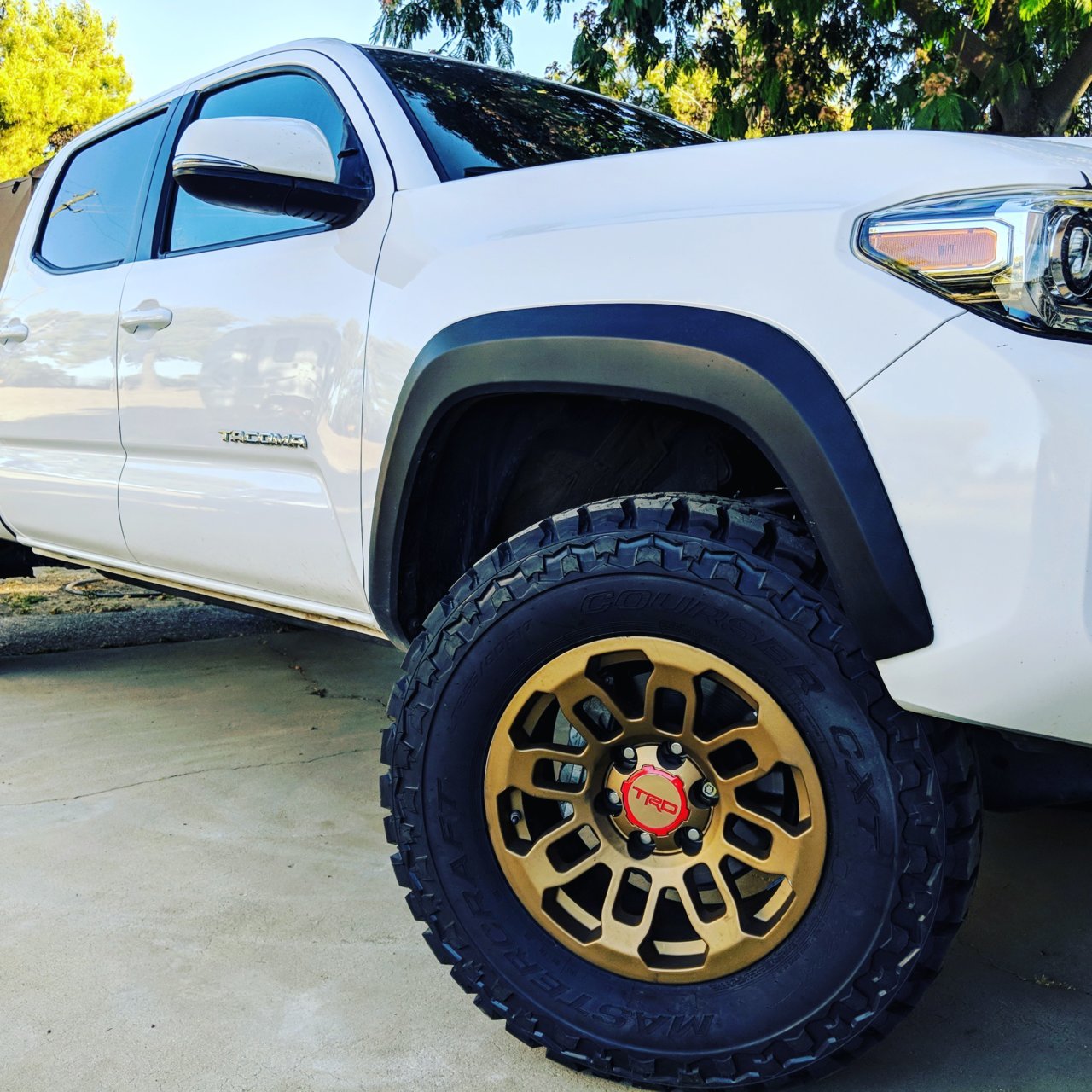

    255/80r17 MasterCraft Courser CXTs mounted on 17x8 0 offset.

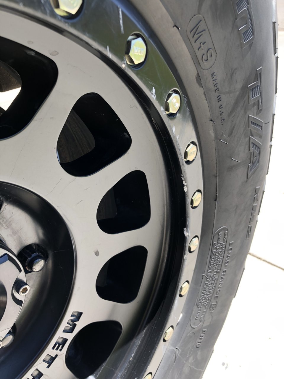

    I’m on method NVs 255/85r16. Every time I go out I scratch up my wheels. Never really had this issue with wider tires

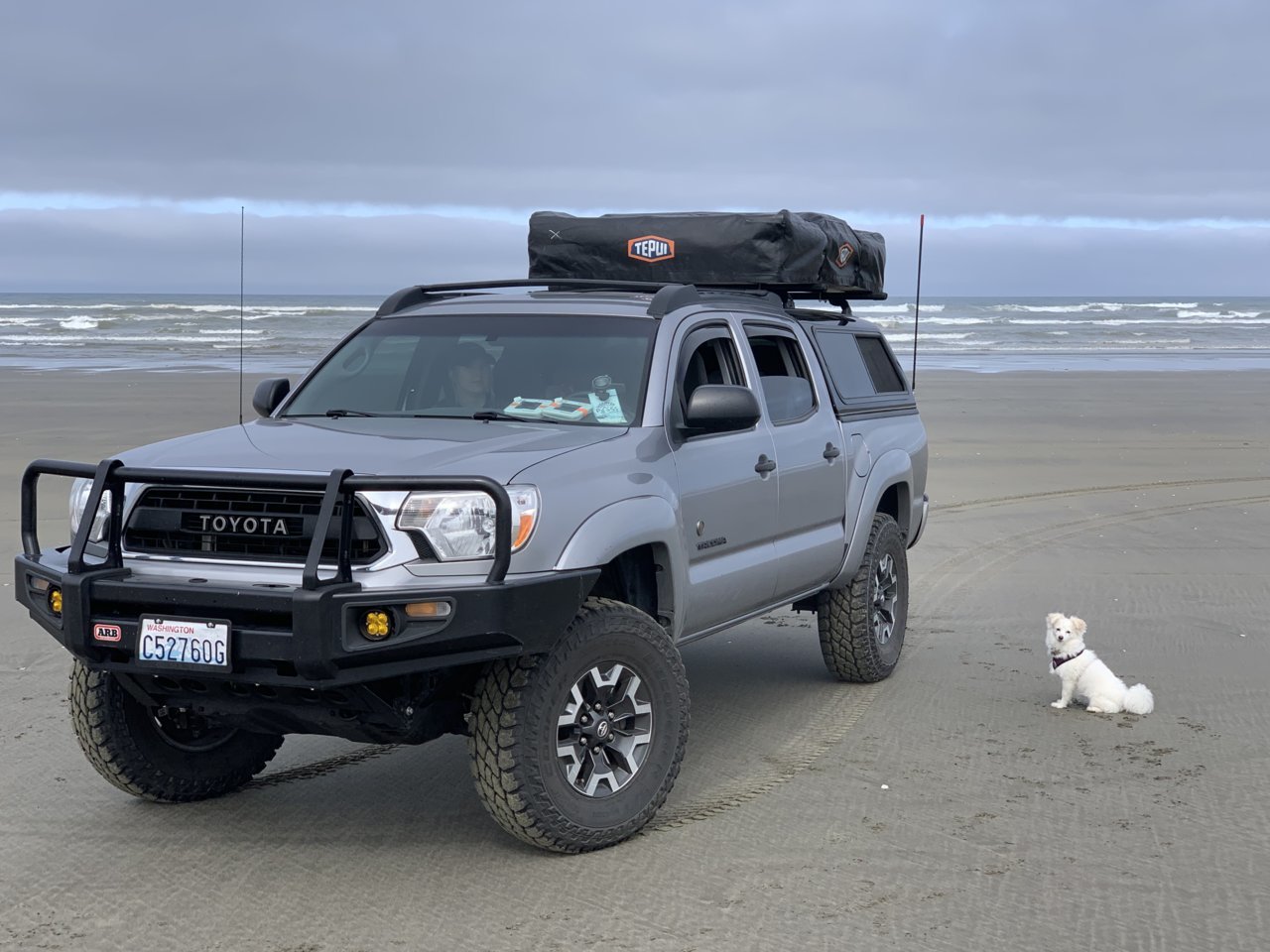

    I’m just running the firm OME w/ 886’s up front with some SPC UCA’s and medium packs in the rear.

    scratching your wheels...and scraping your sidewall...too wide a rim and too narrow a x-section.

    skinny tire on fatty rim and user error, gash to sidewall

    Sawbladeduller, I think you nailed it. My conclusion is that a 8 inch wide rim is to wide for Offroad use with a 255 tire. Granted I do more than just fire roads or gravel roads. Thinking about selling the 255s off for a 285 now.

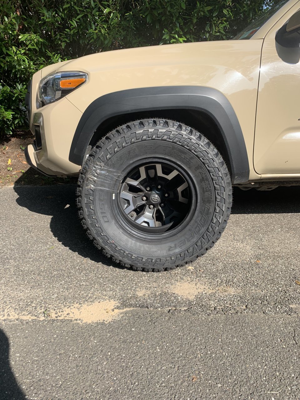

    Figured I would would post this here as well. Finally got my skinny st Maxx. They look awesome hopefully get them mounted and balanced this week.

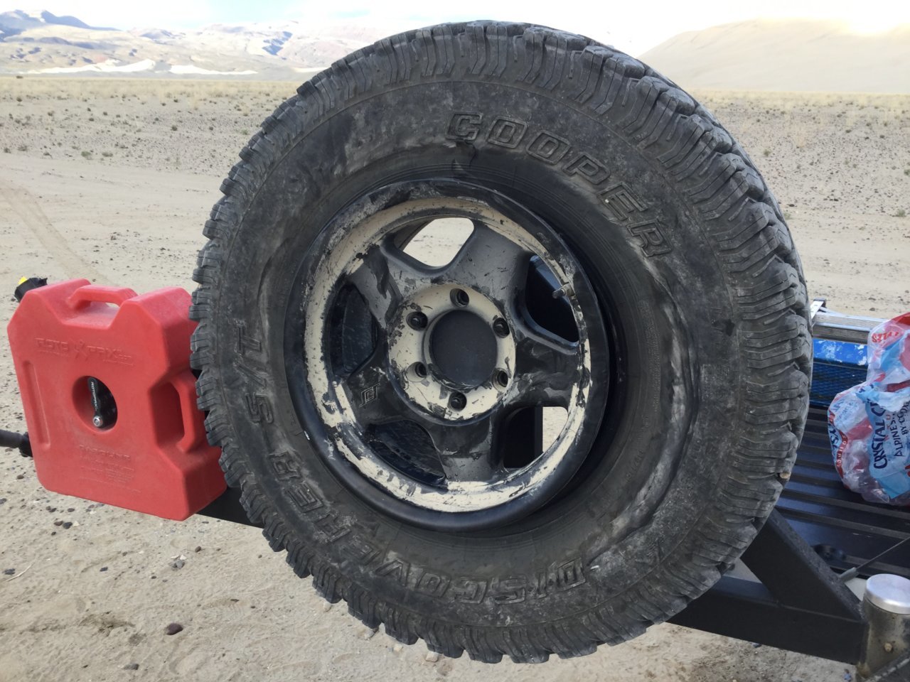

    ...i have had a Cooper ST 255/85/16 in this position previously. note the ST is an older discontinued tire. i have the complication of an after market bumper which has a hitch tube stinking further forward than a stock bumper. i did beat on the spare tire frame claws as well. you might want to check on croms build as he places a Toyo MT 255/85/16 in there, and i think he moved the hoist bracket an inch or so rearward, and also does not have the same bumper complication that i do. i currently carry one spare on the swing gate.
