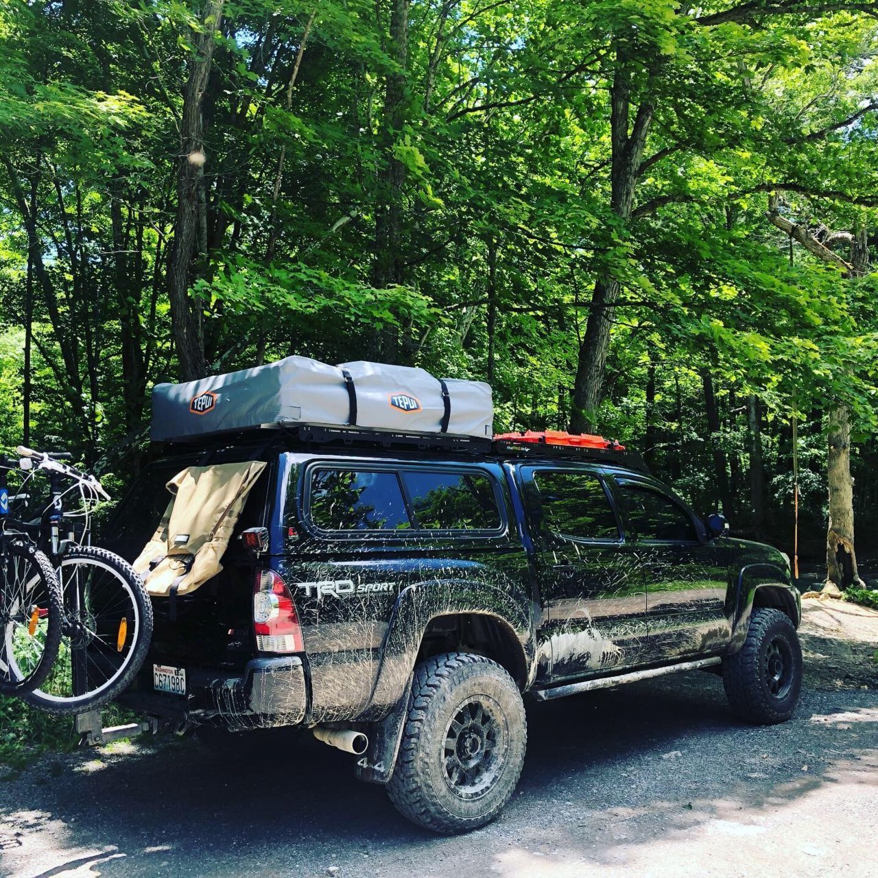

    ready6delta
    ready6delta REGULAR GUY
    Mar 16, 2014
    #125448
    5,730
    JACOB
    Still in PNW but moved to Boise.
    Black pinstriped 2014 DCSB 4x4
    IT NEVER ENDS..........
    7C1D104B-87BA-48C8-B1D5-43DE2EF91D9D.jpg 28F1ADD7-51B6-454E-8C90-690D83F795C0.jpg 2A589A97-9460-4D47-BE8F-C57D1D56E920.jpg
    haven't posted in a while still loving my 255/80/17 copper st maxx
  10. Jul 16, 2019 at 4:13 PM
    #1930
    sealfab
    sealfab Well-Known Member
    Jun 25, 2017
    #222369
    83
    North Virginia
    2006 DCSB TRD
    What lift are you running?

    JACOB
    5100/886 up front w/ dirt king UCA and HD Dakar rear w/ B110. Just ordered new ADS 2.5 ext trav RR w/ 700lb springs for the front which should be on soon.
