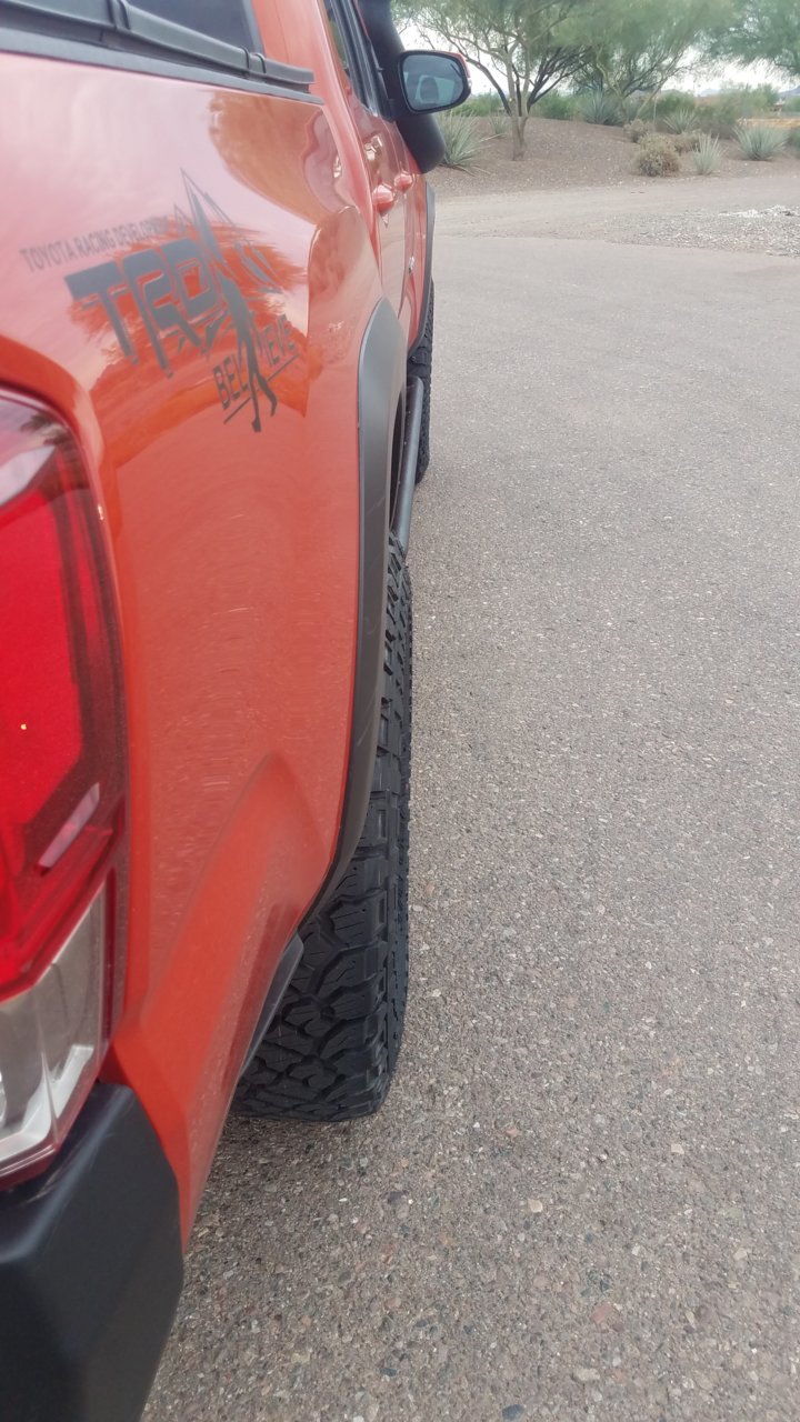

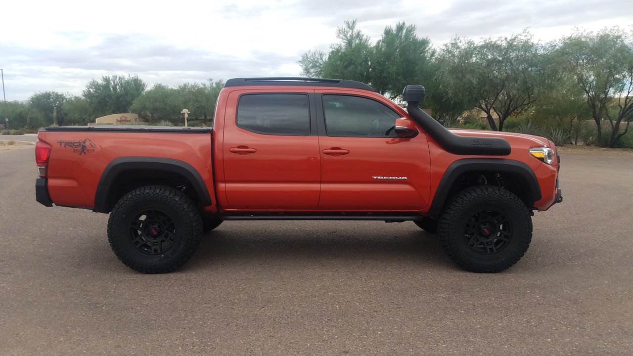

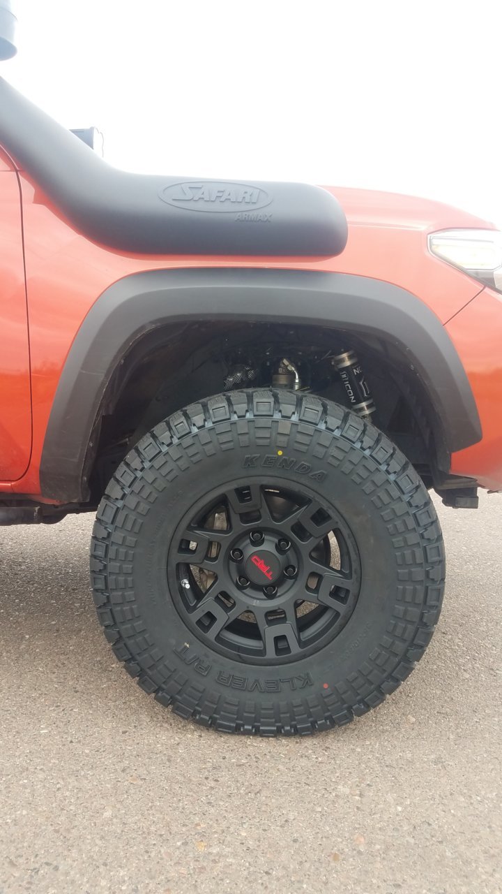

    Kenda Klever RT 35x10.5r17
    Awesome tires! I'll do a full review with more measurements and ride quality opinion in the near future.

    Did you happen to get a weight on these?

    Looks great. Did you do gears yet? Did you have the usual fitment issues? Just curious since it's a skinny 35. Also, I think I saw weight of these around 68 lbs. Not too bad for a 35.

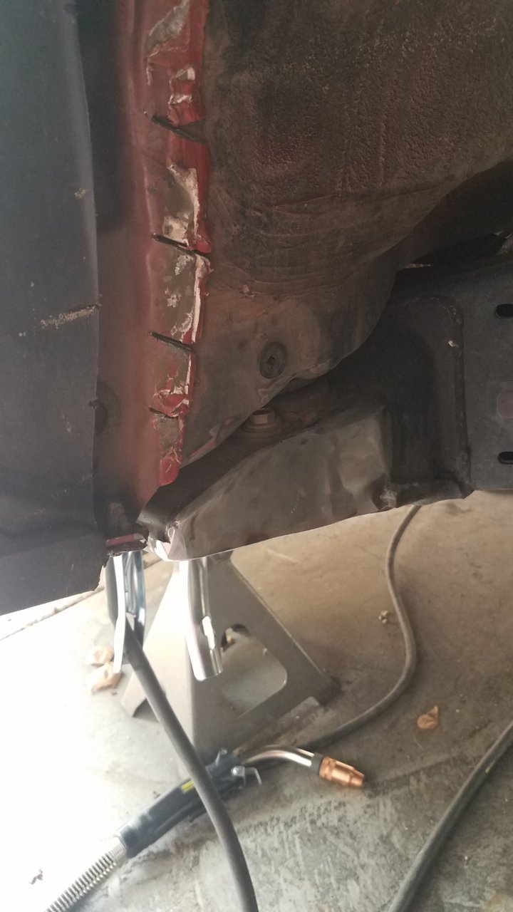

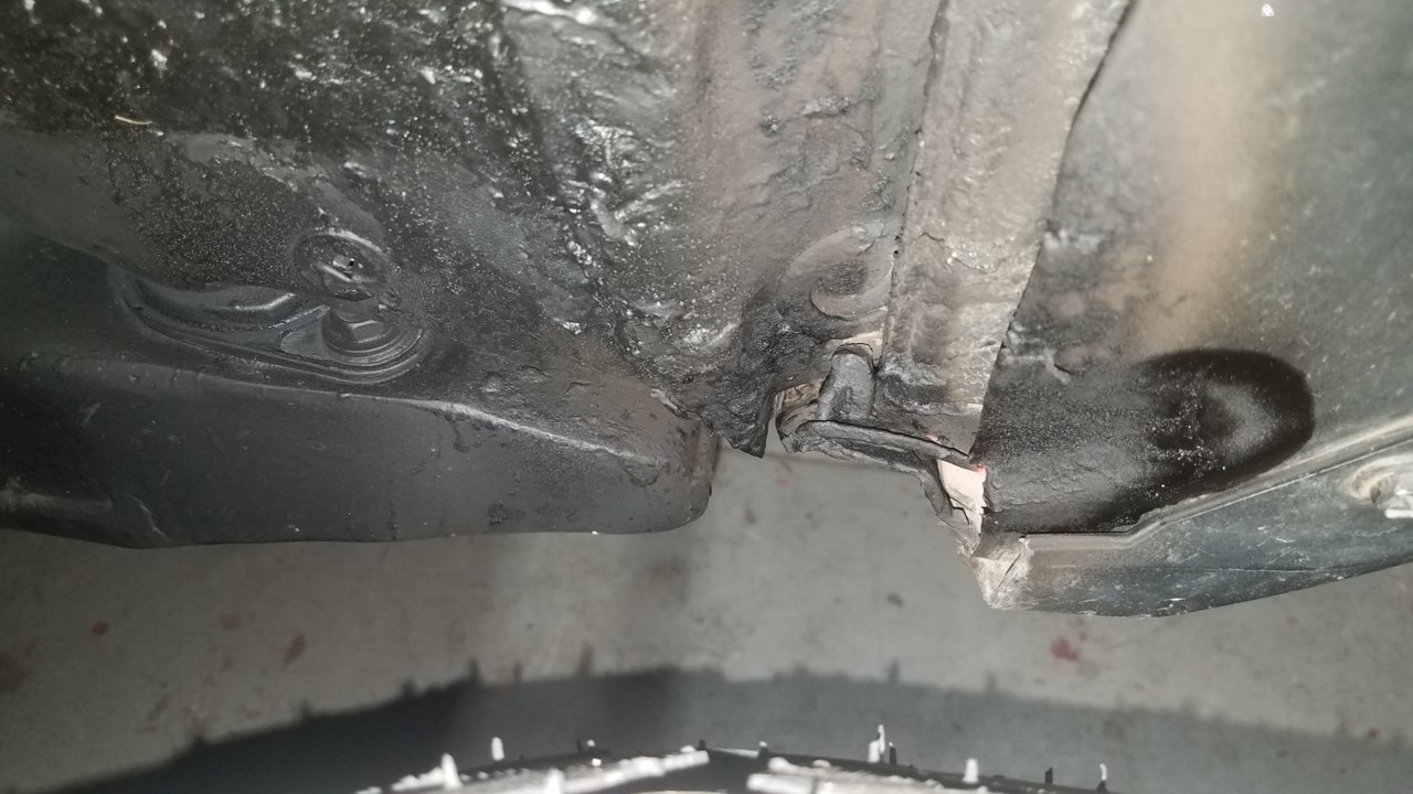

    Yes I have already re-geared. I've been running the 4.88s with 255 85s for a couple years. I don't really notice any difference in acceleration with the larger tires and 4.88s. I actually couldn't find a weight on these online but I did use a bathroom scale and they weighed in at 68lbs!
    As far as fitment goes when I did my CMC and pinch weld flattening I just went deep enough to clear 35x12.50s. I figure no reason to half ass it lol.
    From my observation I'm guessing I had to do allot less fender flare trimming and hammering here compared to those with a 3"lift and 35x12.5s.
    I have no UCA or frame rubbing with ICON tube UCAs and TRD 4runner wheels. No spacers. @spongejosh gave me so very good info regarding wheel offset with his setup.

    Thanks for the info. I also have 4.88 gears. Best mod I've done. how much lift are you running? I only have the Bilstein 6112 with Dakars and currently running around 1.75 inches of lift. Was debating on the UCA as I still have stock UCA but same wheels with no issues.

    I'm about 2.75-3" over stock. I think some kind of aftermarket UCA would be necessary for clearance at the rear of the fender well.
