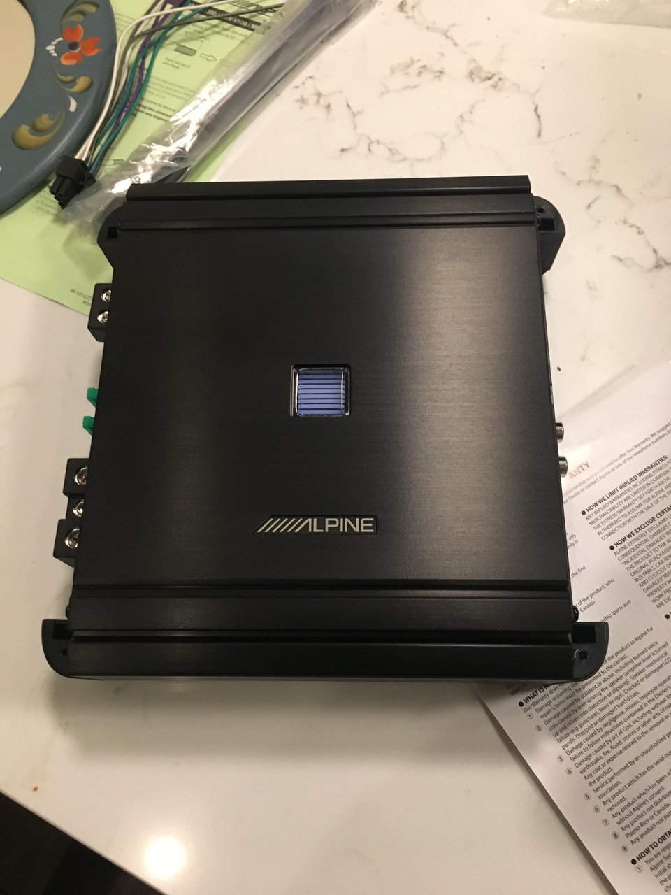

    So I pulled the ********* amp yesterday and replaced it with an Alpine MRV-M500.
    This little amp really cranks!
    Was on sale at Best Buy for $150
    https://www.bestbuy.com/site/alpine...MIzYuMwd7B2QIVhWx-Ch04bgIiEAQYAiABEgJMLvD_BwE
    Check it out on the Dyno
    https://m.youtube.com/watch?v=qjjoe6dVm6o
    This little amp is a legit power house.

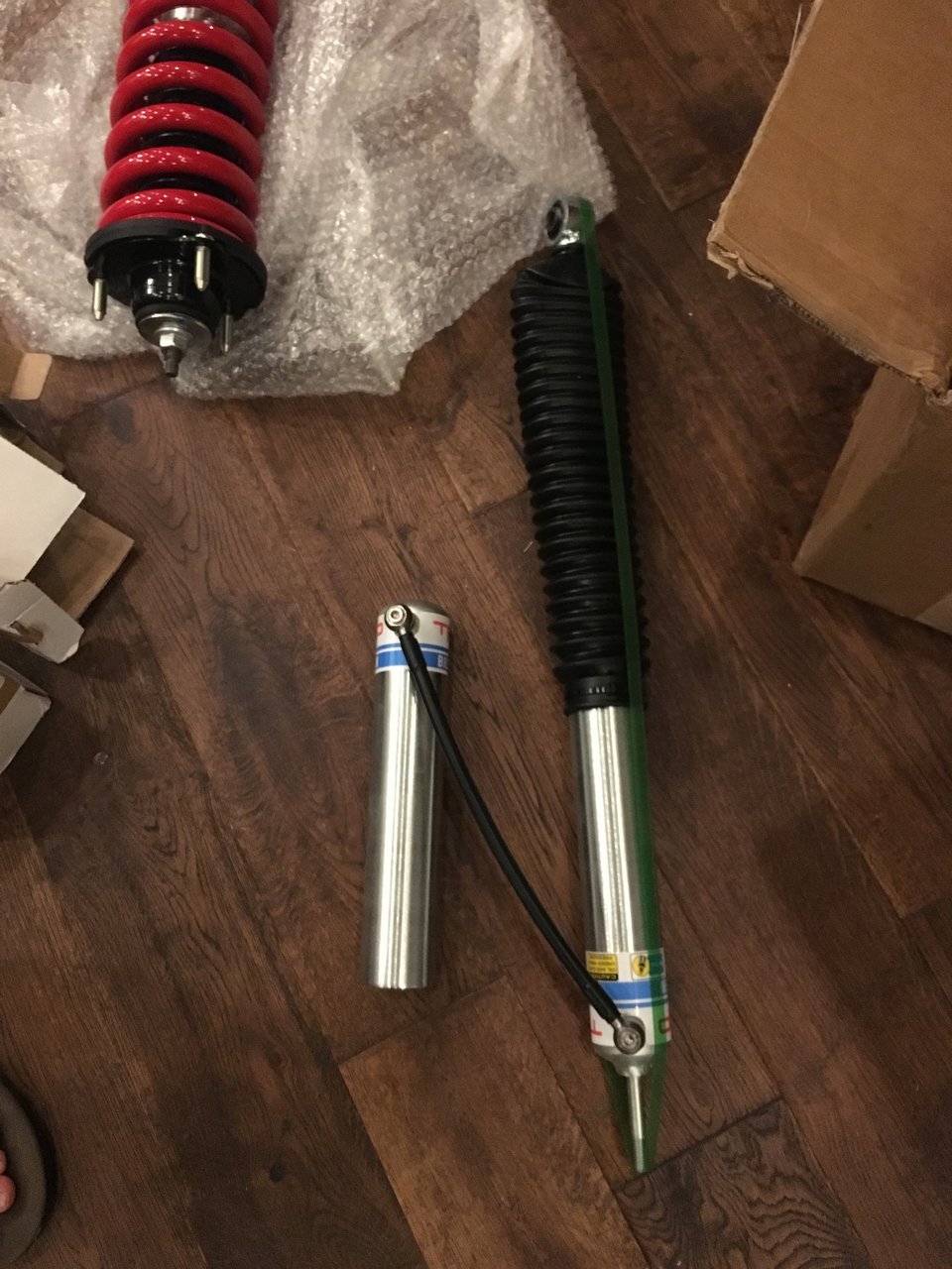

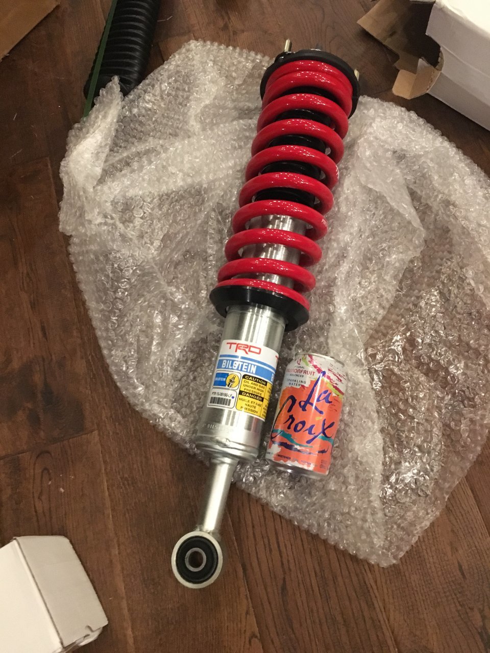

    Installed PTR13-35150 Bilstein TRD PRO kit and ICON AAL
    • 2.5-in. front shocks and 2.0-in. rears with remote (piggyback) reservoirs • Zinc finish with multi-layer coating for extreme surface durability • TRD tuned Eibach® coil springs with custom rates • Engineered by TRD and tuned by TRD engineers to provide better ride quality and off-road performance.
    Mule Expedition Outfitters in Issaquah Wa installed the kit Tuesday along with an ICON AAL.
    What an improvement in ride quality and dampening!
    With my SSo Bumper, Winch, Sliders, and Cap, my stock OR suspension was really suffering.
    Prior to installation up front I was sitting at 34.3/4” and 34.7/8” .
    Now I’m at 36” and 36.1/8”
    Out back I was previously running Hellwig Helper springs and was sitting at approxamently 36”
    We removed the Hellwig springs, stock overload, and installed the AAL. Now I am sitting at 37”
    The Hellwig springs were giving me about a half inch lift over stock.
    Hub to Fender Measurments
    Drivers LF 21-1/4 Passenger LF 21-1/2
    Driver LR 22-1/2 Passenger RR 22-1/2

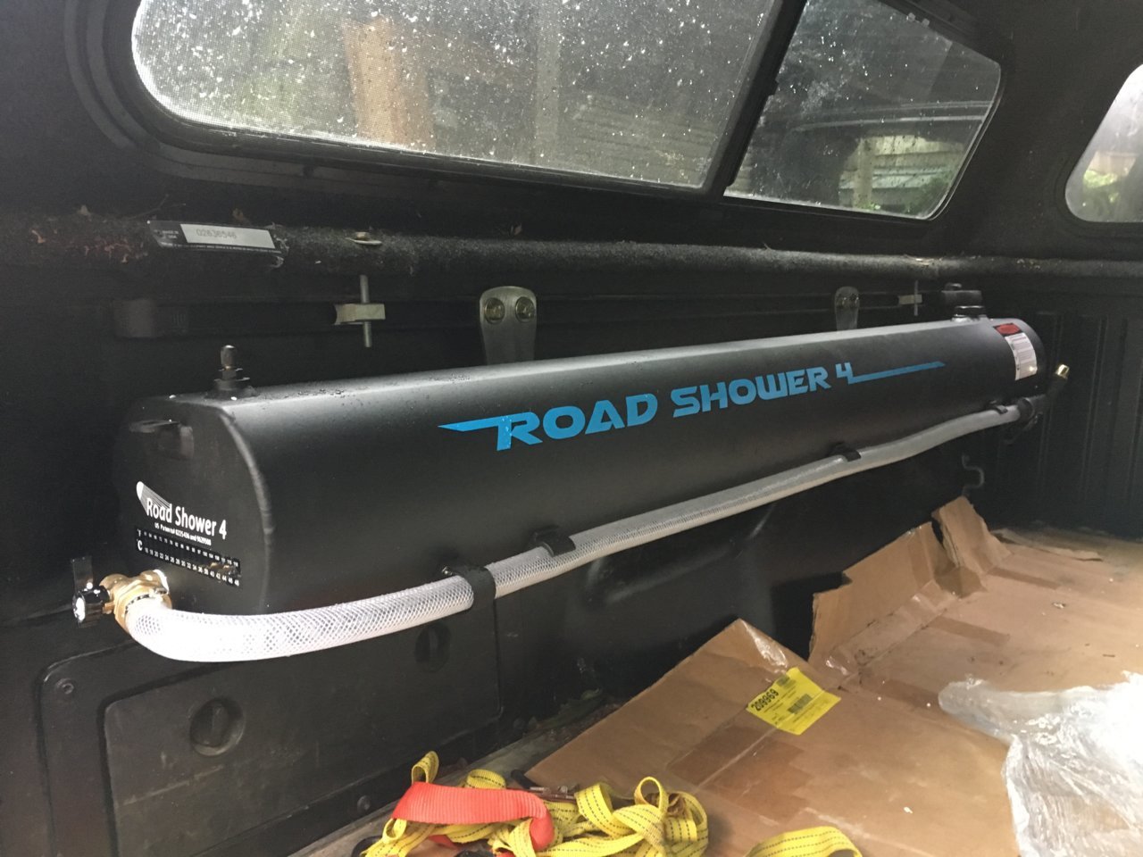

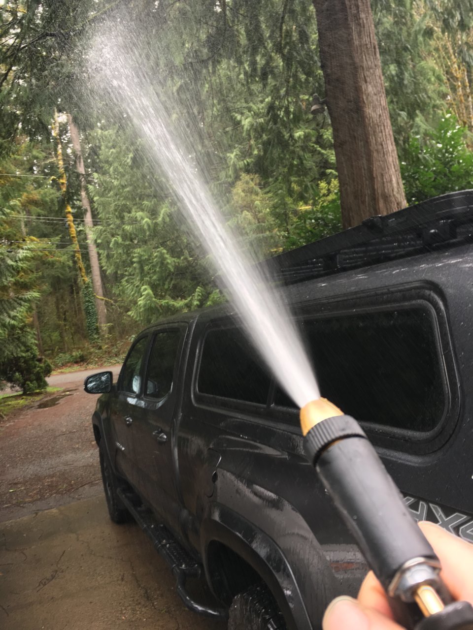

    74D47E35-74A9-470F-8536-7D9D85558A15.jpg Finally pulled the trigger on a Roadshower.
    I picked up the 7 gallon Roadshower 4.

    like your setup, how far does the system stick out over the wheel well? i just ordered mine but worried that it will use up more space than wheel well and i wont be able to fit other stuff, did u use like L brackets or how did u mount it wise of the rail?
  16. May 8, 2018 at 10:00 AM
    #76
    TRD-OffRoad_Ben
    TRD-OffRoad_Ben [OP] Well-Known Member
    Apr 24, 2016
    #185181
    252
    Ben
    2016 TRD OffRoad LB
    i used some relentless fab brackets
    It doesn't stick out far in my opinion...
    I used a pair of Relentless Fab Tacoma bed rail Single Quick Fist mounting plates and supplied mounting hardware that came with the Tank to secure it.
    With the Quick Fist mounting plate not only is it secured to the wall/bed rail it also sits perfectly on top of the wheel well for extra support.

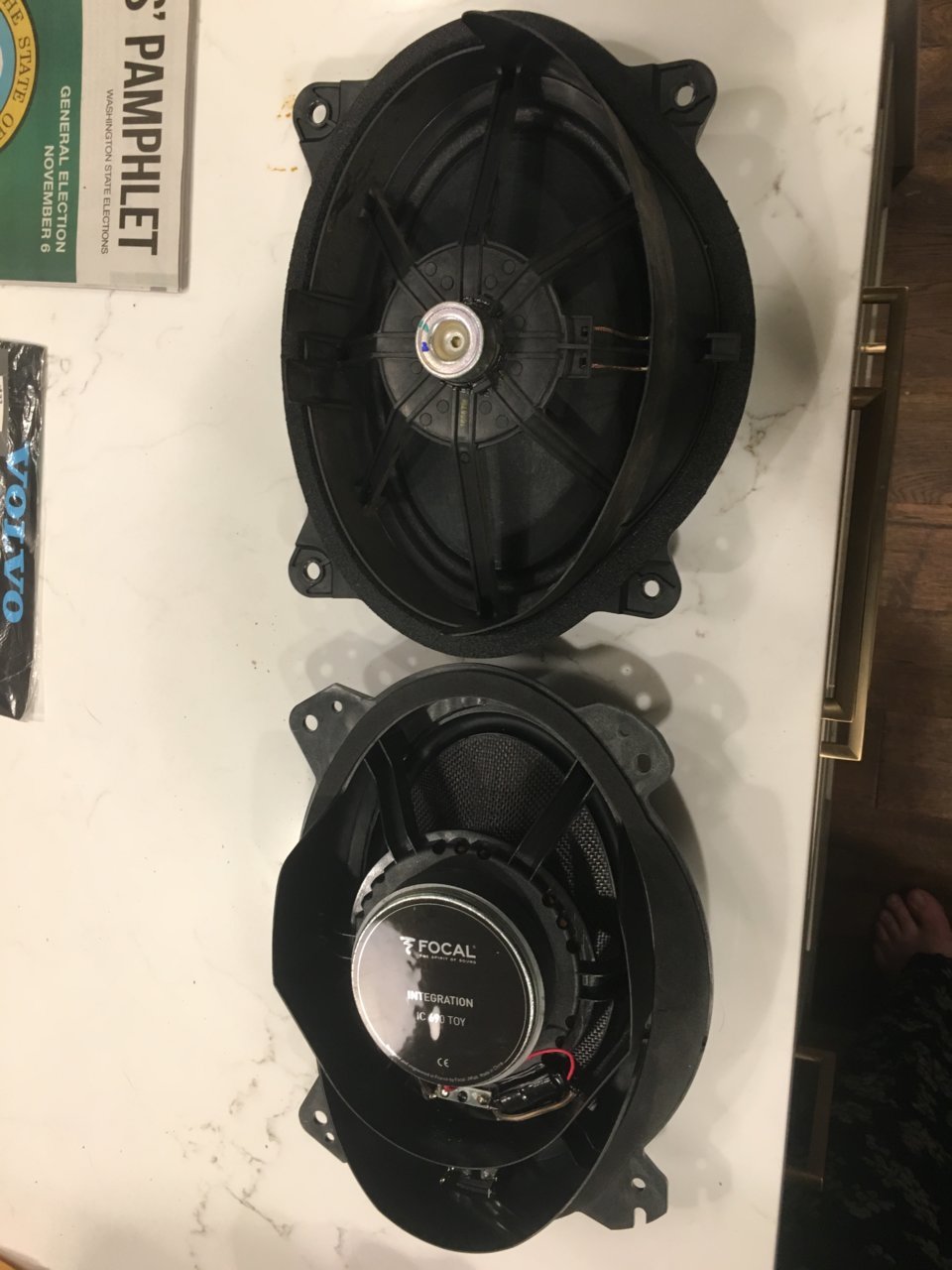

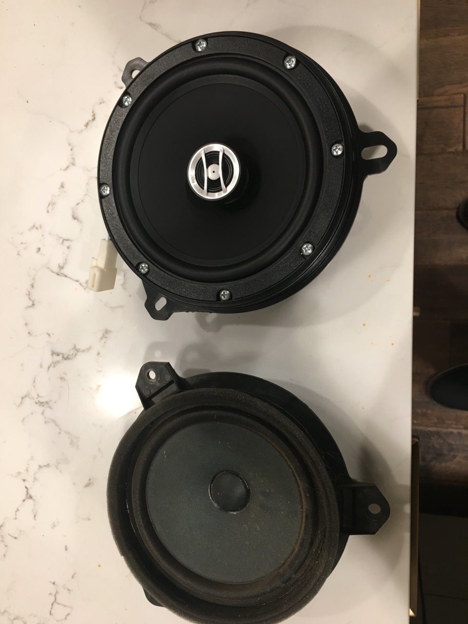

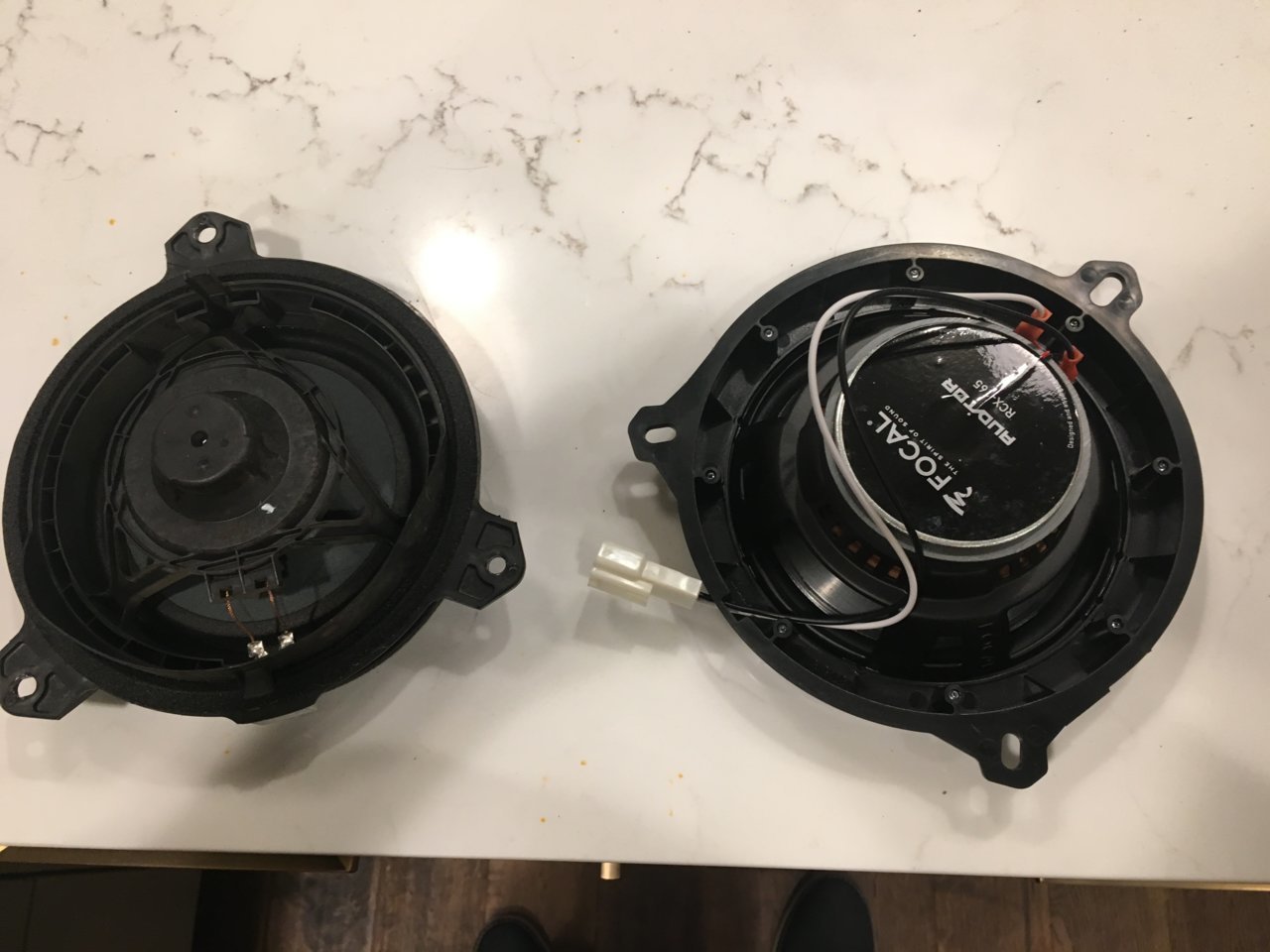

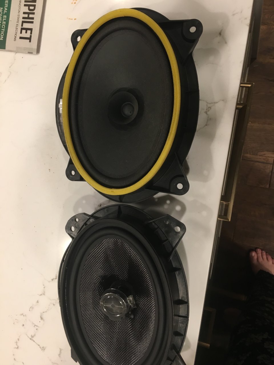

    Latest update...
    Speaker upgrade!!!
    Picked up a pair of Focal 6x9’s
    Model IC 690TOY
    And a pair of Focal 6.5’s
    Model RCX-165
    0A51D38C-882E-46AF-B9DE-16C1F65C8A03.jpg D01E05F4-4354-4AF3-860F-3DE5F08FD8E2.jpg
    What a Major improvement
    I just want to sit in my truck and crank the music.
    Used Metra adapter rings and wire harness for the 6.5’s to make them plug and play.
    The 6x9’s were plug and play right out of the box.
    All the stuff above along with my 8” kicker sub and alpine amp has the sound system really starting to sound good!
    Need to do the Kicker tweeter upgrade next...
