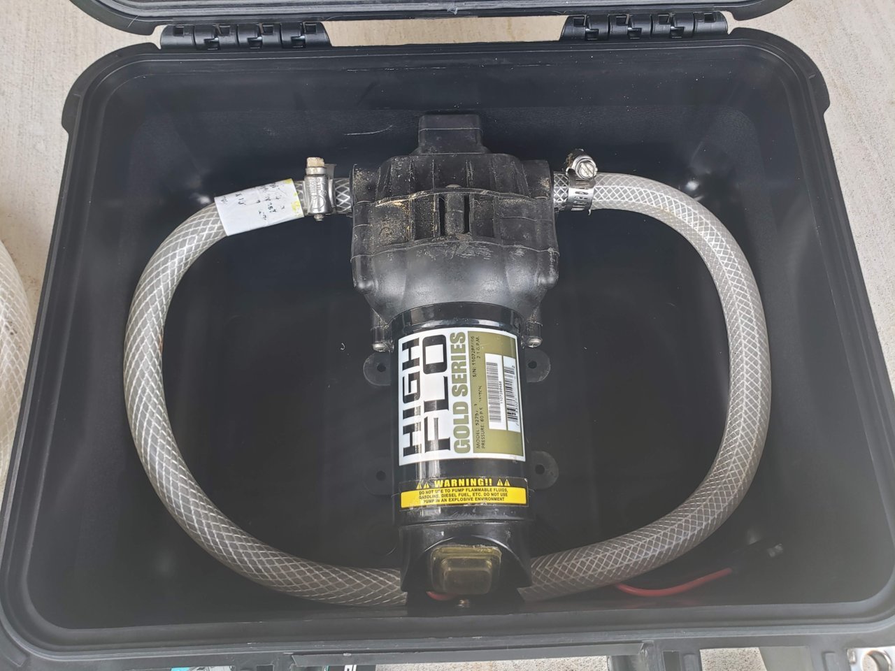

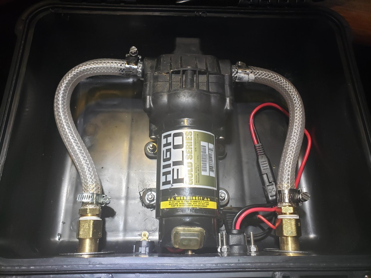

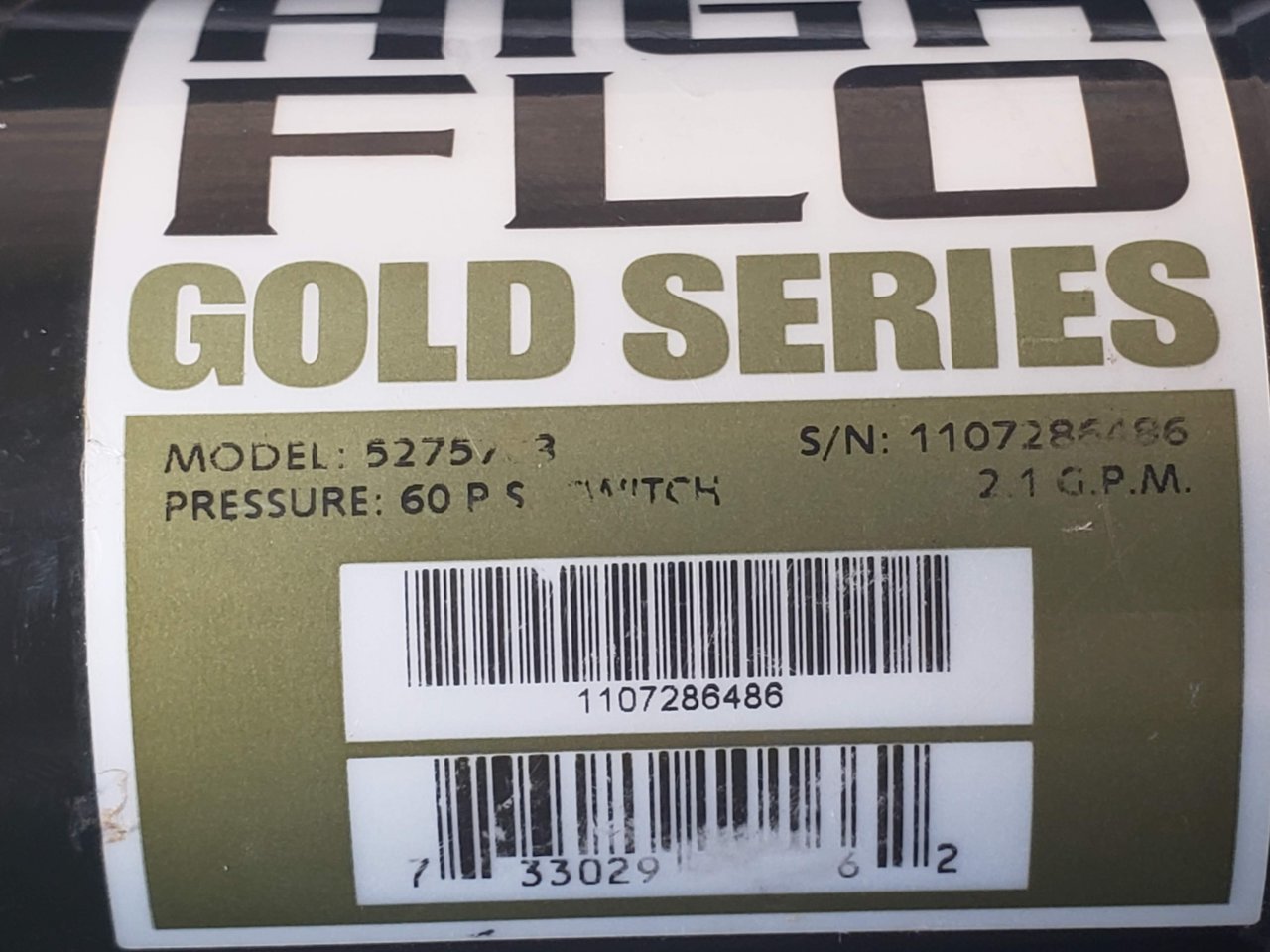

    So the on demand water system 2.0 was born. A trip to tractor supply resulted in a 12v demand pump and some misc parts comming home me.
    The data plate is starting to wear a bit, but you can still read it 60psi @2.1GPM
    Now this kinda rode around as a bare pump for years hooked up as needed, kinda a pain actually.
    Then When I came to TW, and saw the thread by @ProForce on his onboard water system thought yep a nice solution to the problem, but with the 2019 no drivers side cubby to make it a simple install. THEN... I saw his post on his Portable unit. it was then I knew that the solution to the problem was at hand. Ya know they say imitation is the sincerest form of flattery... So in order to prep for the upcoming Semi-Epic road trip, and to appease the wife on the multiple nights of camping. the new an improved water system was built, using the ground work done by @ProForce as a guide.

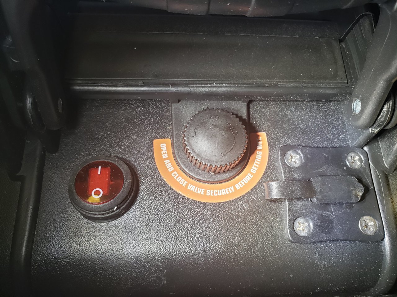

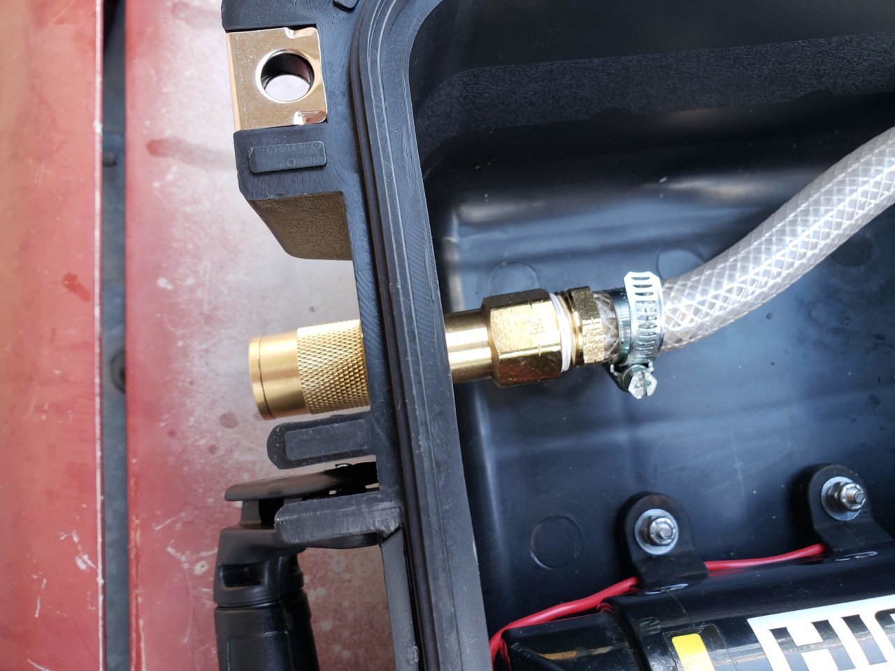

    So, it was time to double check, and see if the case he used would work for the pump I already had. The new Pelican knockoff sold by Harbor Freight did indeed fit.

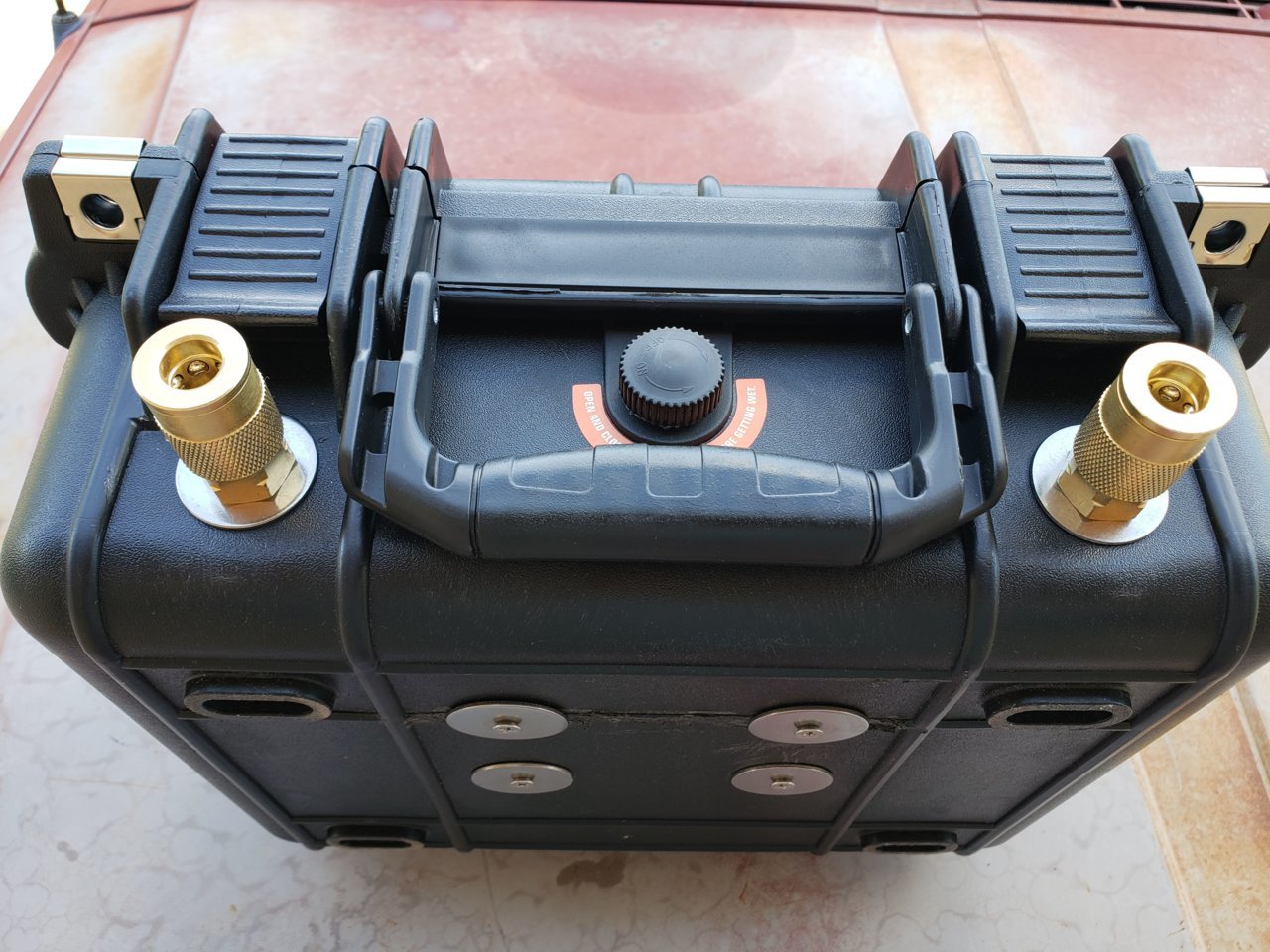

    I did a dual washer under the homebrew Bulk head fittings, a large fender washer inside, and standard washer outside of the case.
    Stainless hardware was used as well, with Nylocks since getting everything really tight is hard with out compressing the rubber isolator mount on the pump.
    Because of how I placed the pump, I ended up grinding down one of the ribs on the bottom so the fender washers would lay flush.

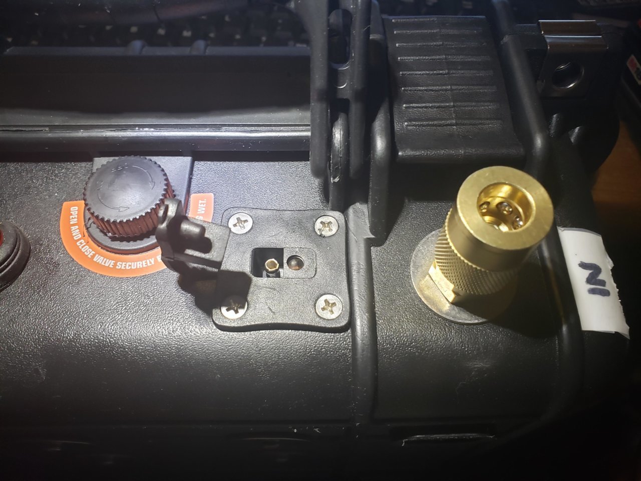

    Switch is in place, but currently not wired up. the SAE cord has a switch built in so it is a bit redundant, but since it was in the spare box, left over from a light harness. and to to prevent it from getting lost later. I went ahead and installed it
    The cap on this Panel mount SAE 12v power inlet is a tight fit, pliers help to get it pulled free. but it appears to be durable rubber, and the leads are 12 gauge.

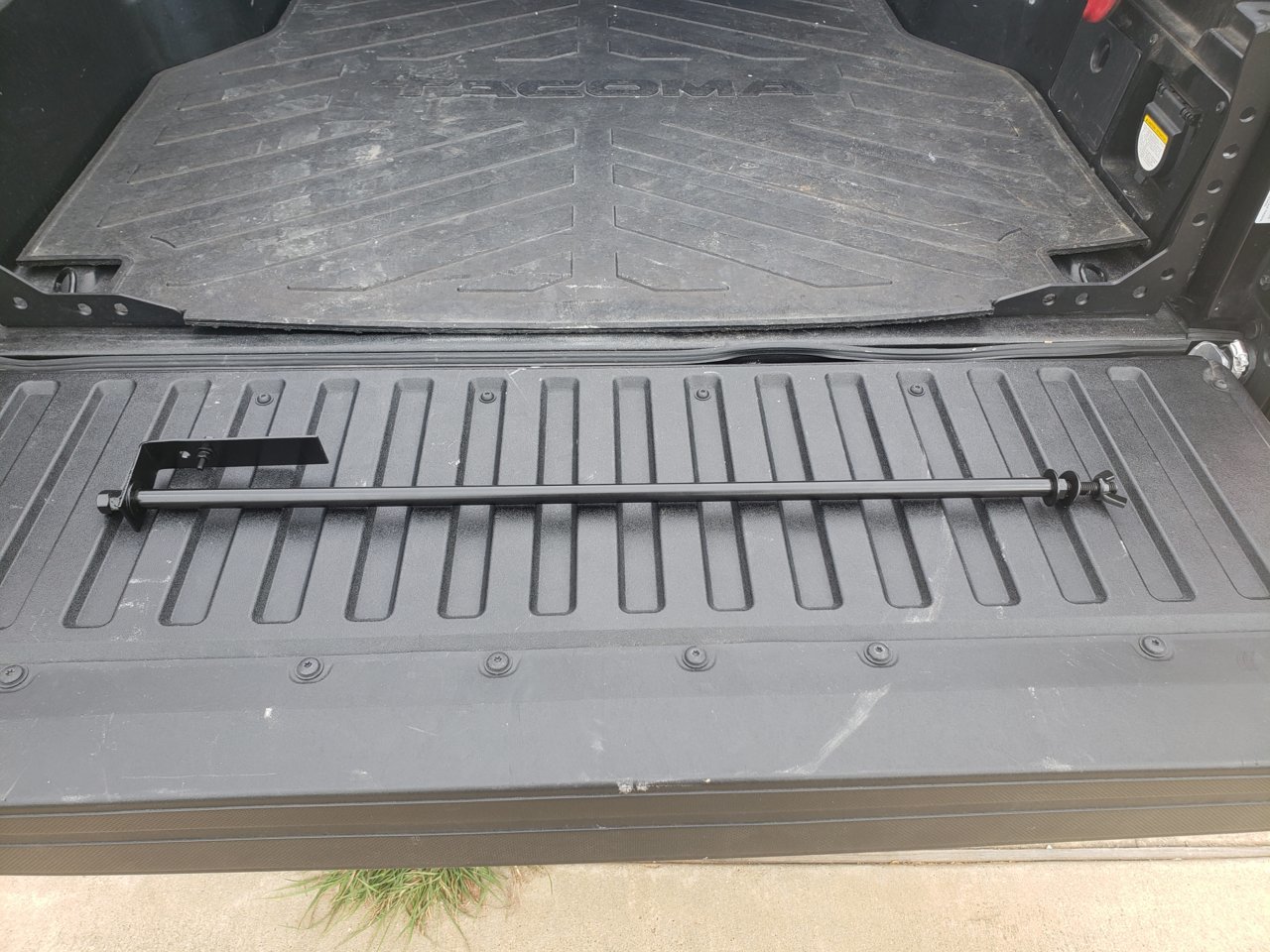

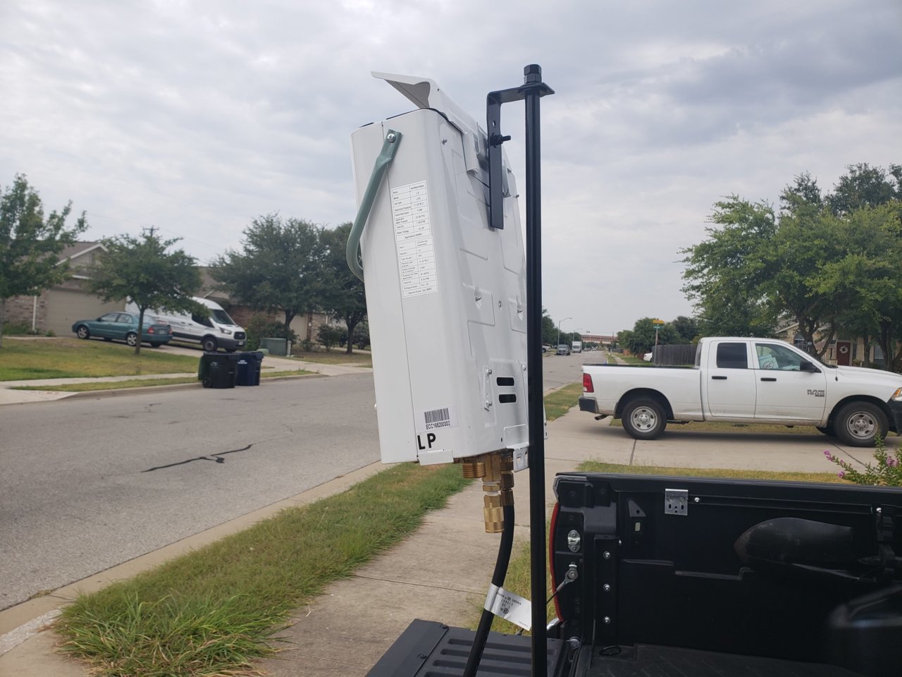

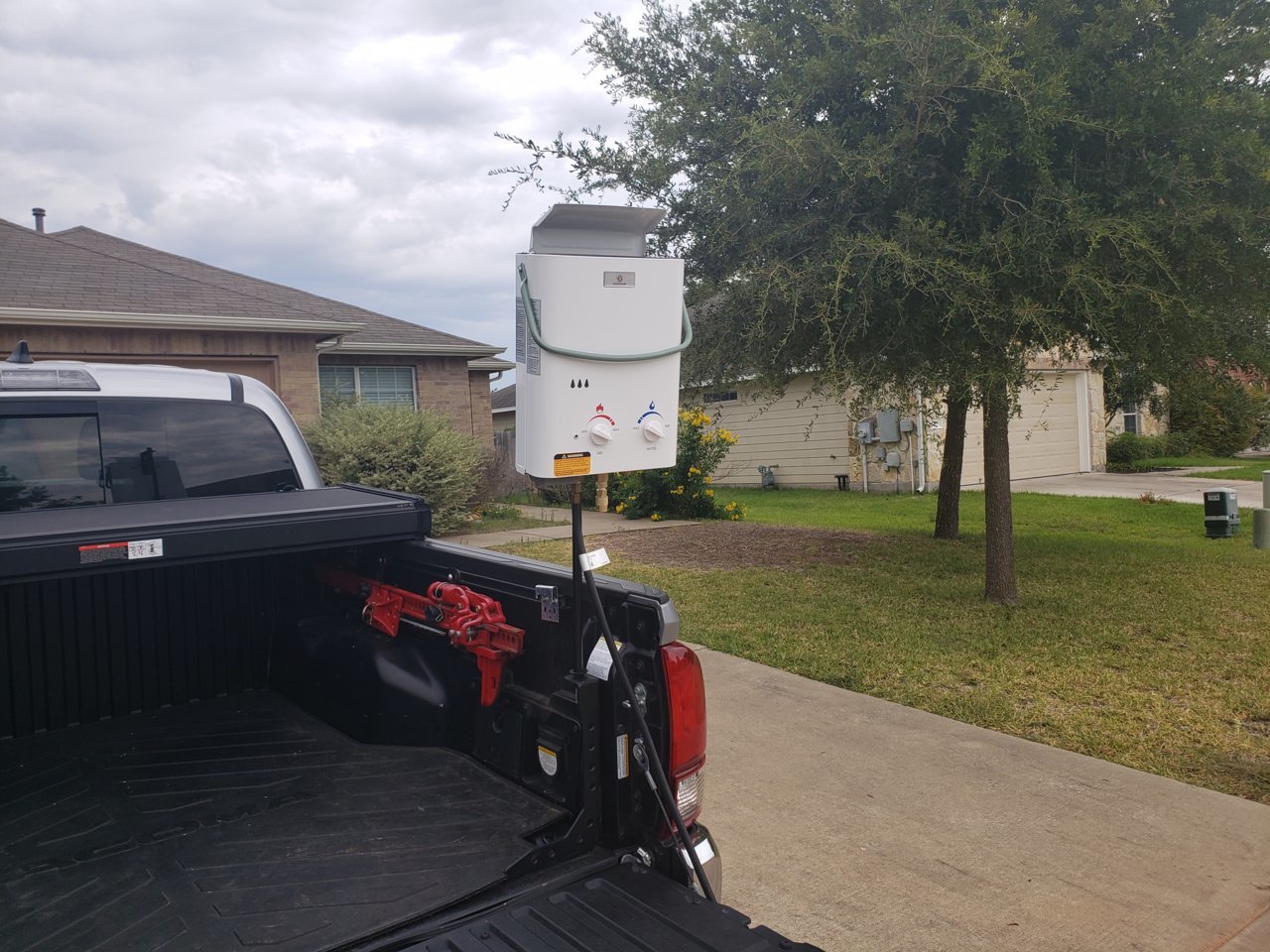

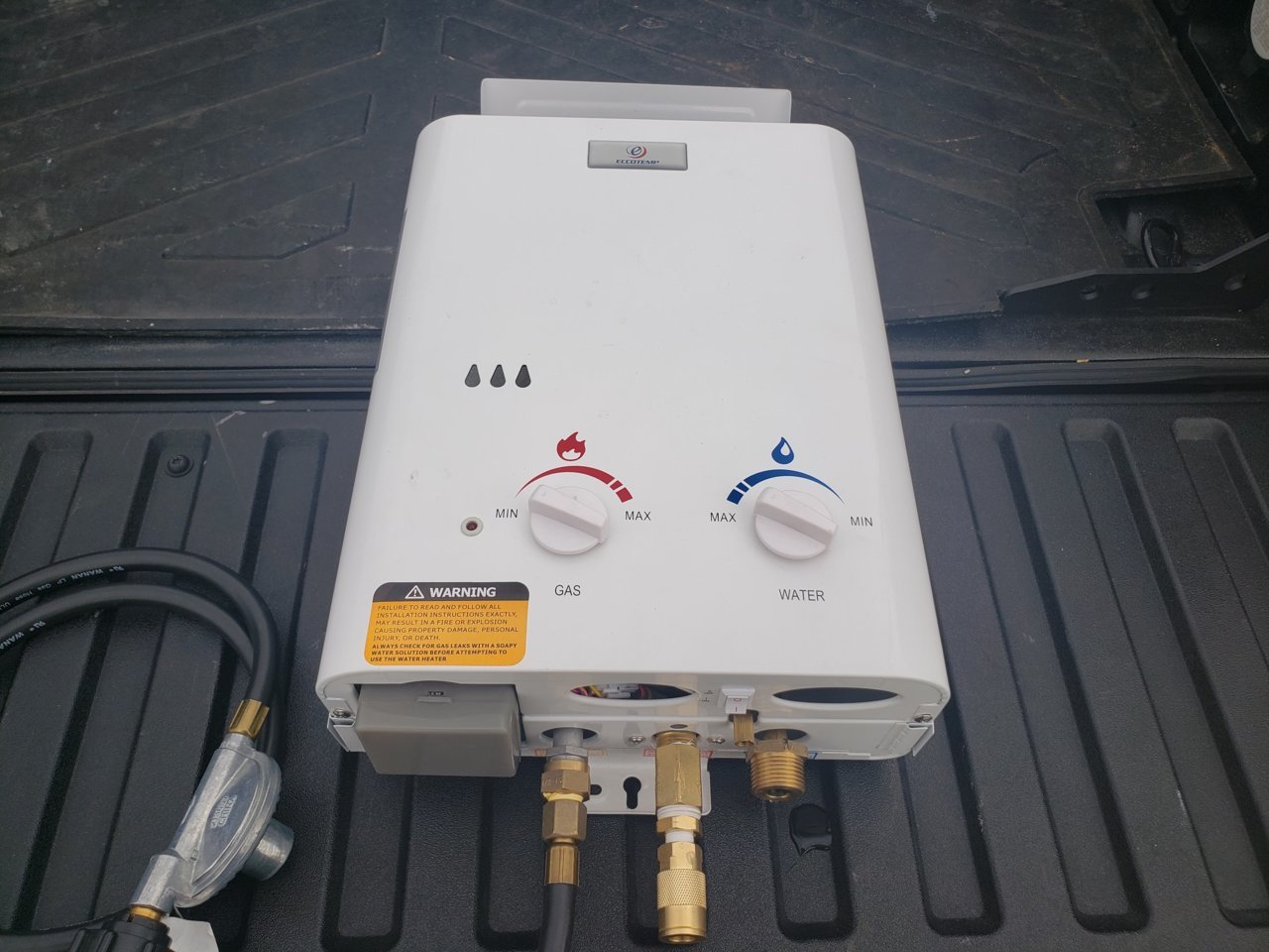

    Now that the water pump portion of the water system is done, it is time for the "Hot water" portion of the project. awhile back I had pick up an Ecotemp L5 to add Hot water to the camp kitchen setup. I had the chance to use one on a camping trip several years back and I was much more impressed with this, than I was the Zodi units.
    I added another female Quick Disconnect to the output side of the heater, and the matching male end to the shower wand hose, this is so I can take the shower wand and use it with just the pump later on.

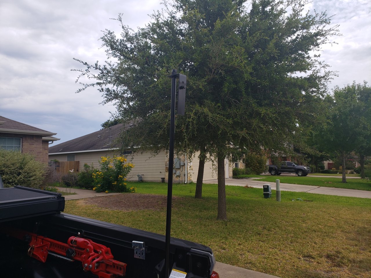

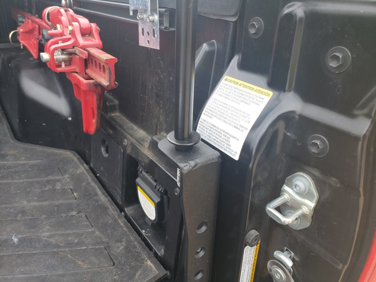

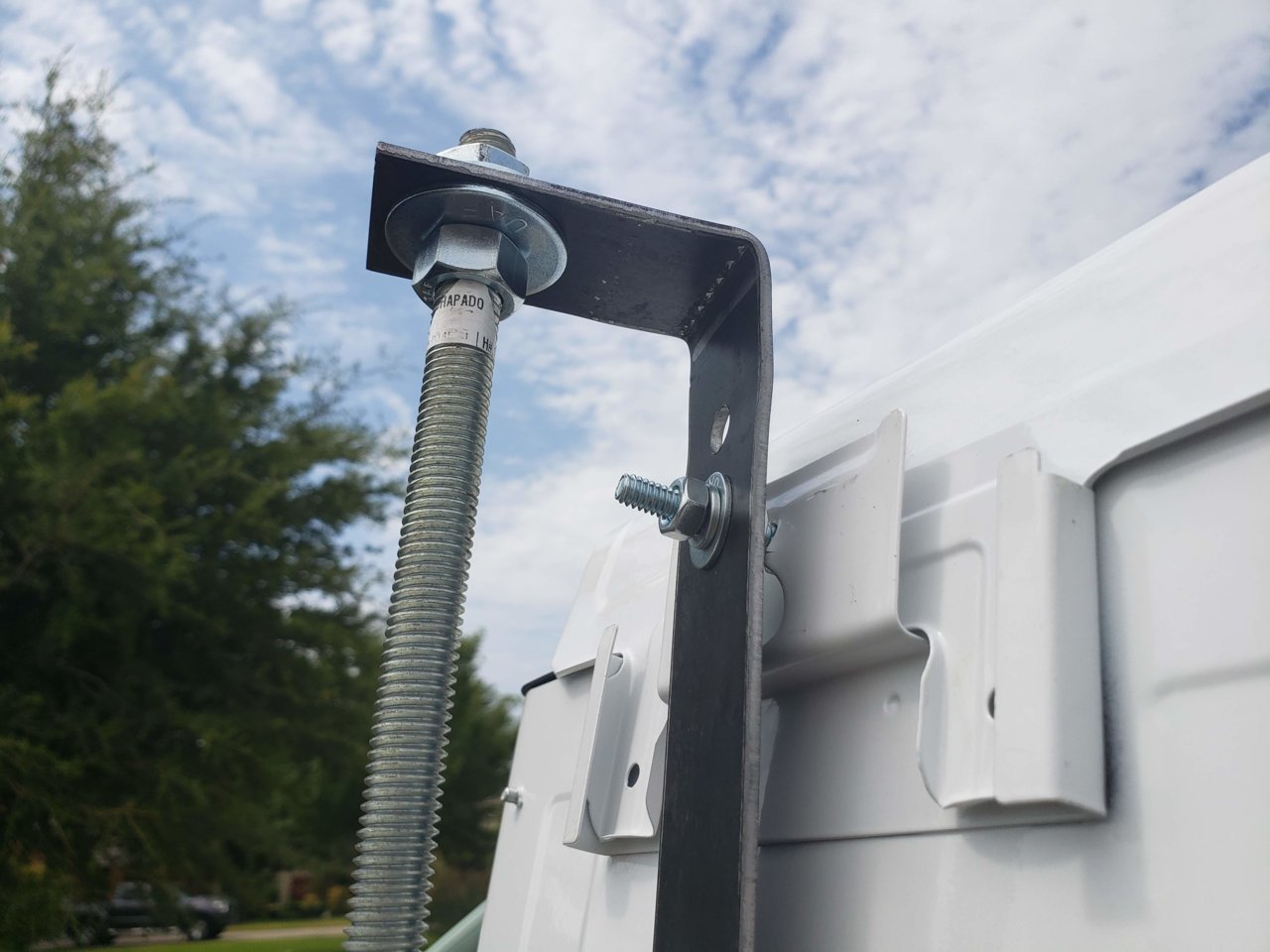

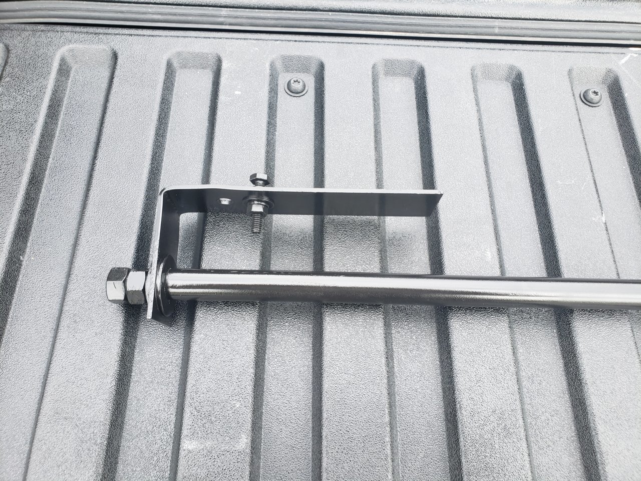

    Next I needed a way to hang the water heater, And not cause damage to truck while it was in use
    So, I picked up some.1/2" all-thread some misc nuts and washers, a piece of EMT. Along with a left over scrap piece of steel from making the tool mounts for the bed rails
    I added the EMT over the threaded rod to help add some strength and prevent deflection under the weight of the water heater.
    Bolt one end to the hole at the top of the bed stiffeners...
    The Gas hose is long enough to reach the tank on the ground.

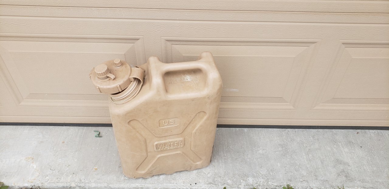

    The water Will be supplied using a couple of Scepter Military Water Cans (MWC) that I was able to pick up recently.
