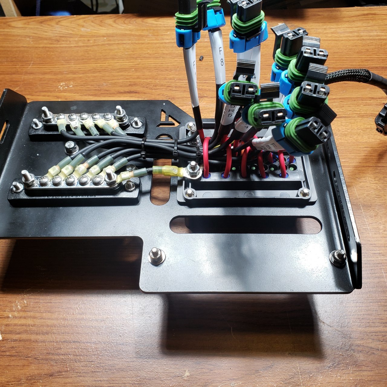

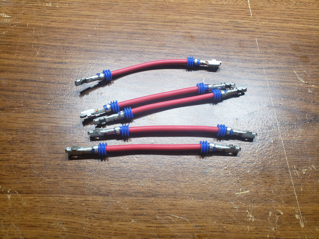

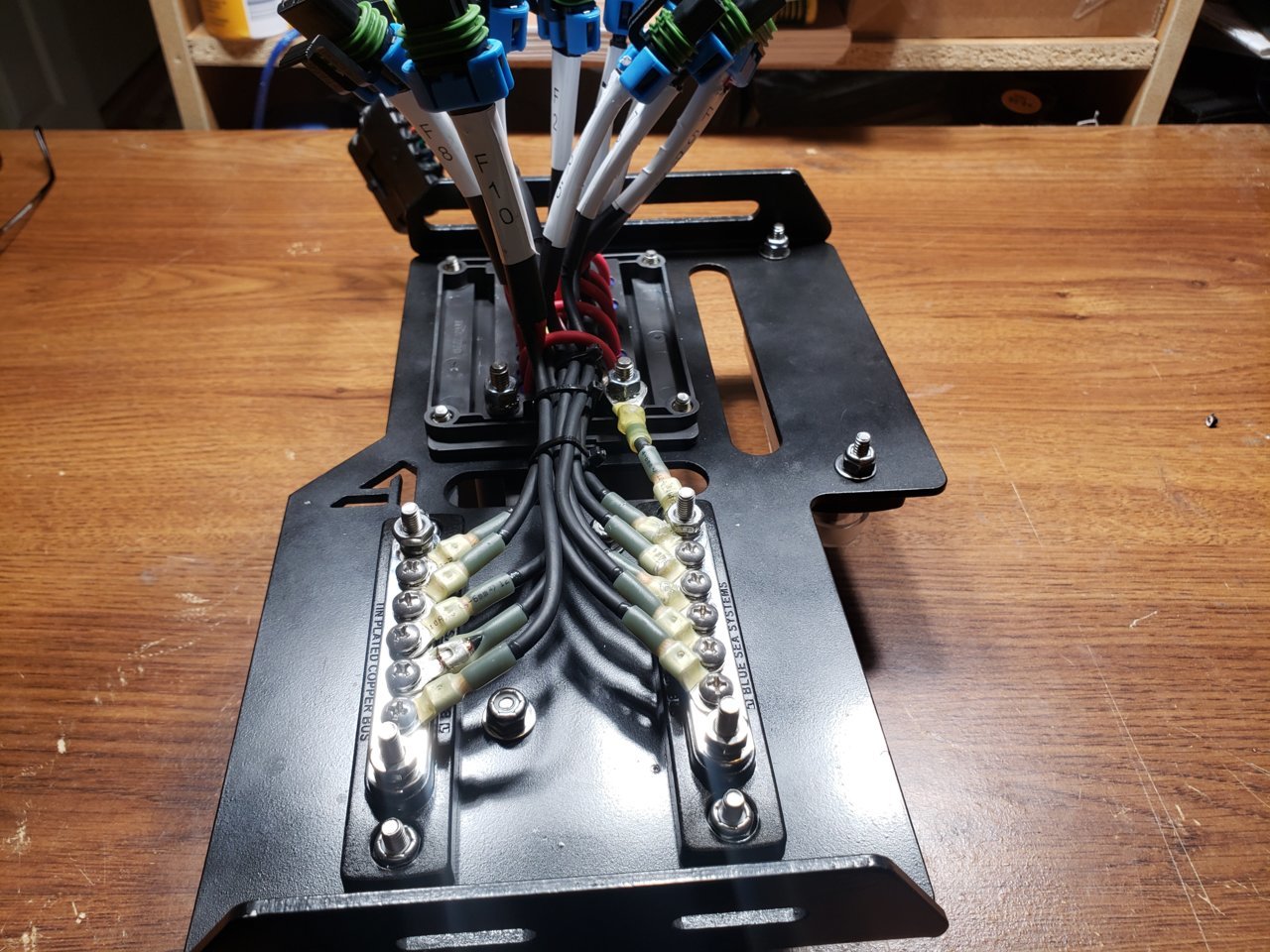

    Nice. Did you solder those or crimp? For light duty use I was looking at the el-cheapo chinesium ones on aliexpress. For the number of times I need to crimp something that large it would do just fine and make life much easier.
  2. Apr 27, 2020 at 7:13 PM
    #122
    Pyrotech
    Pyrotech [OP] Well-Known Member
    Nov 25, 2018
    #273741
    3,008

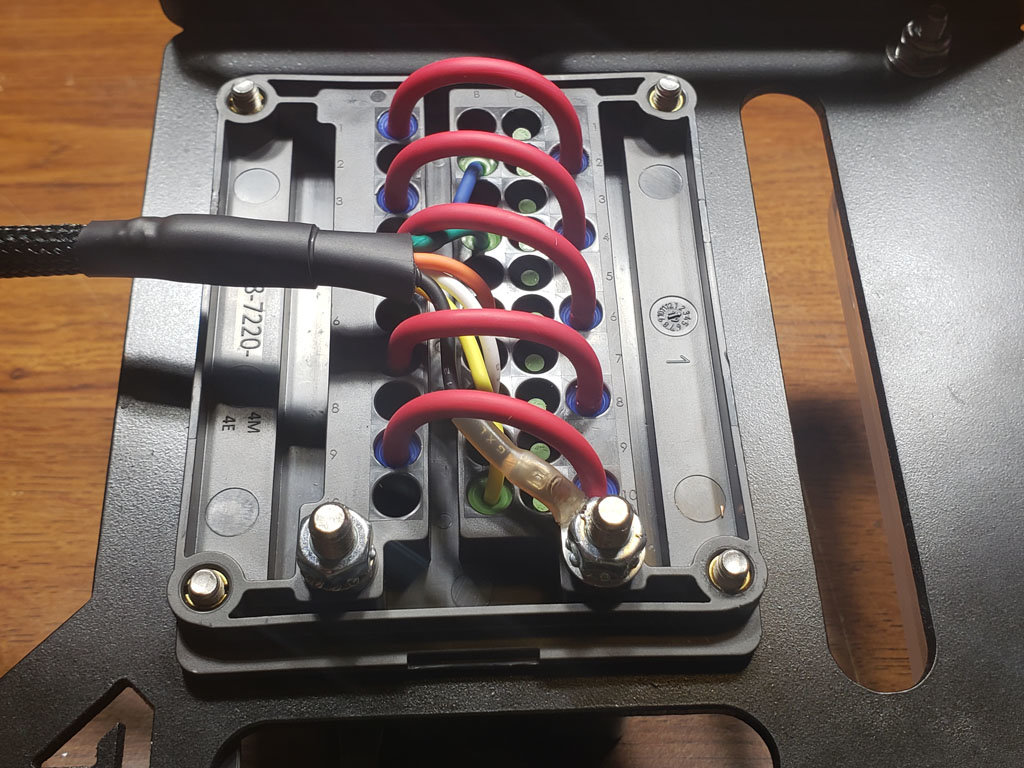

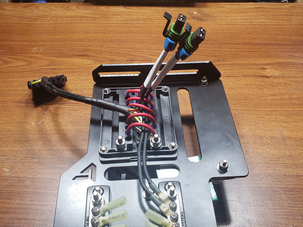

    crimped..

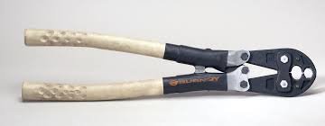

    I have a big 6 ton hand crimper, Burndy MD6-8 and used a w-162 die for the #4 terminals
    same style we use to make our crimps on our jumpers at work

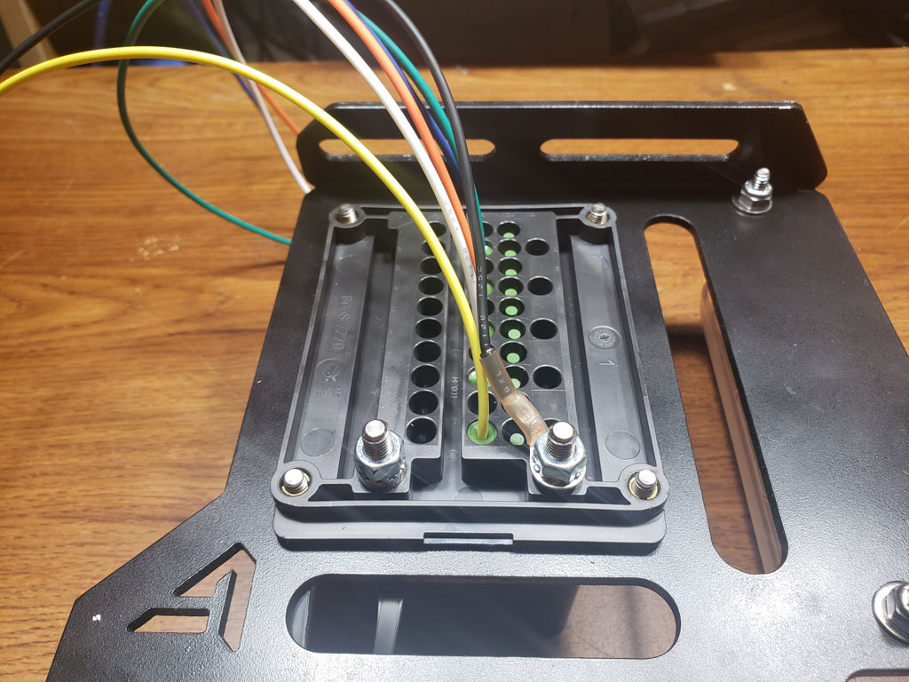

    and because The pictures of the PDC being built never made it here...
    Getting my crimp on....
    lapoltba likes this.

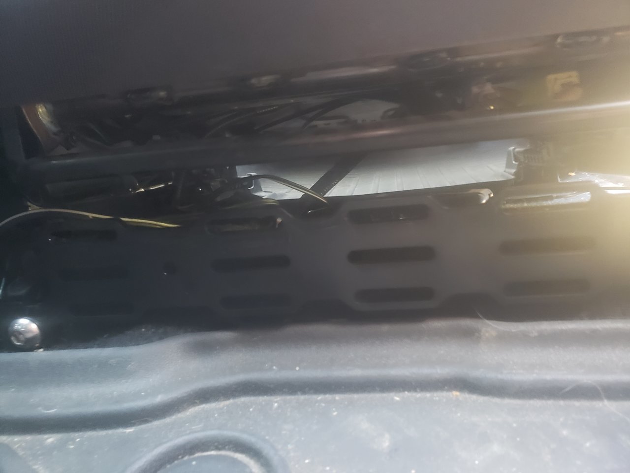

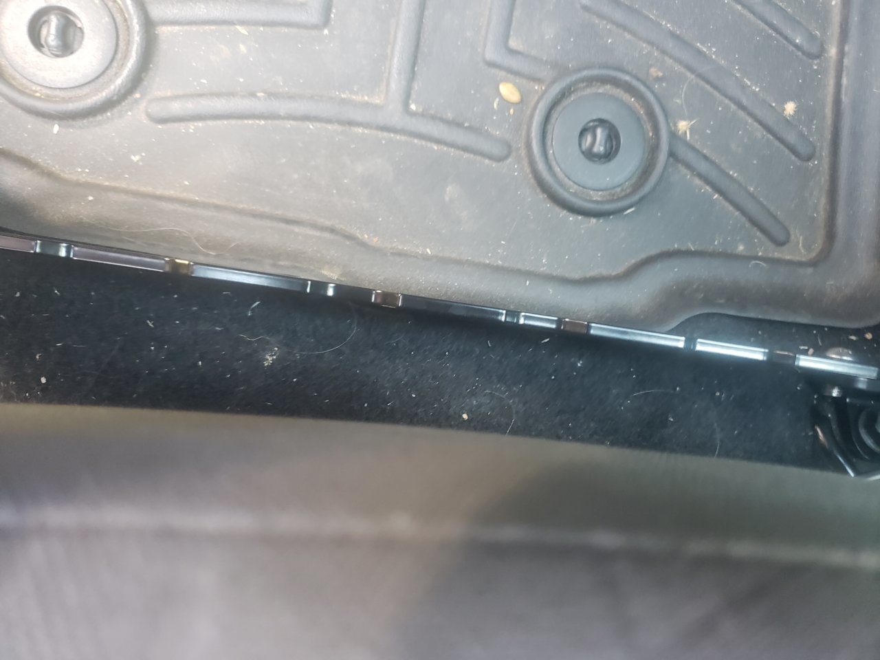

    A quick little upgrade, the DDI Front Seat Multi-Mount Panels from @EasyDoesIt
    Attach the brackets to the panel loosely with the provide allen screw (15/64)
    The new bracket for the multi panel will fit here using the new provided bolt (16mm), remove the front factory bolts (13mm)
    View from the front
    Once everything is in place go ahead and tighten everything back up
    looking down from the top
    Still have room to reach the bar to slide the seat back and forth.
    it took longer to write this up then it did to install it...

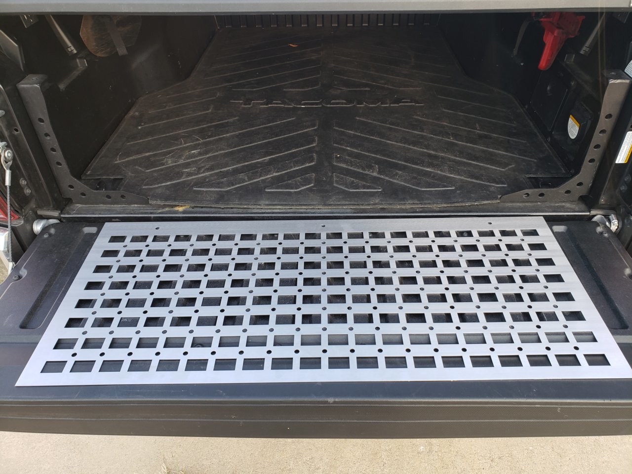

  8. May 7, 2020 at 9:12 PM
    #128
    Pyrotech
    Nov 25, 2018
    #273741
    3,008

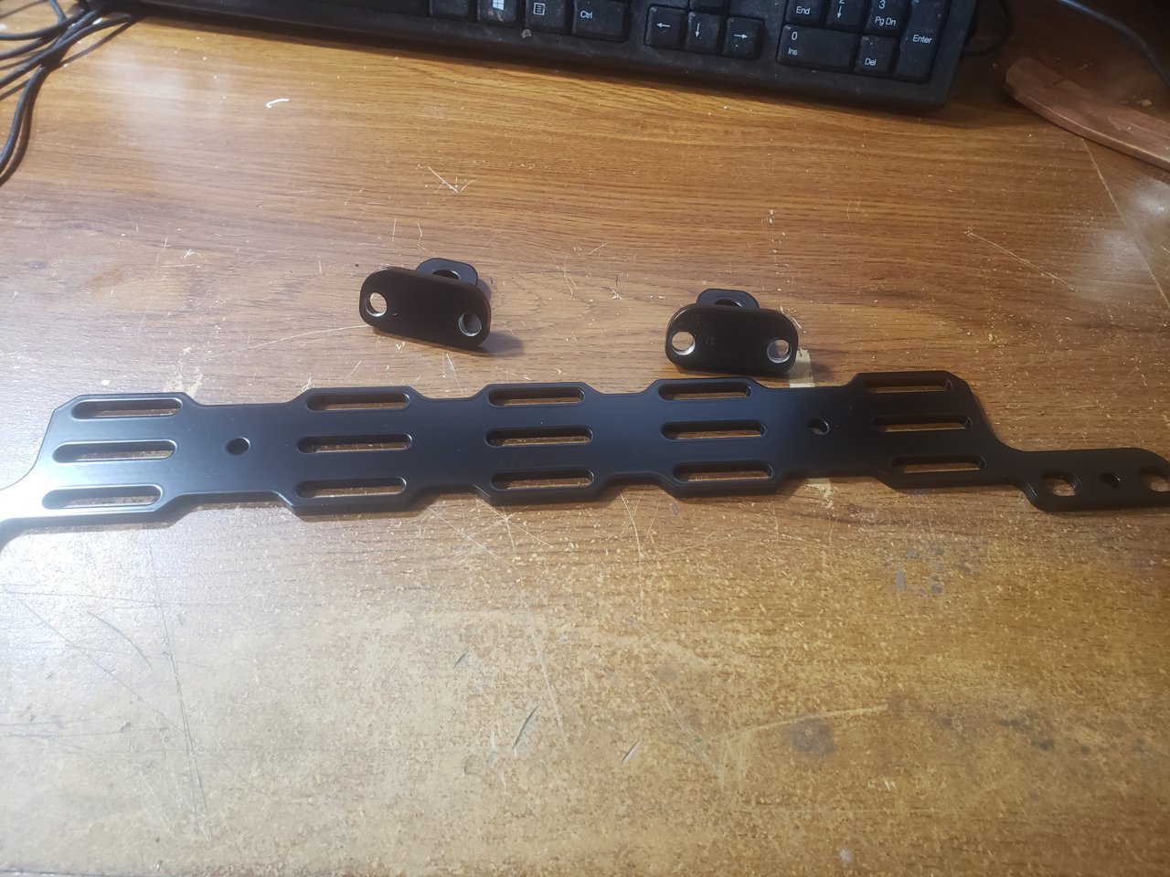

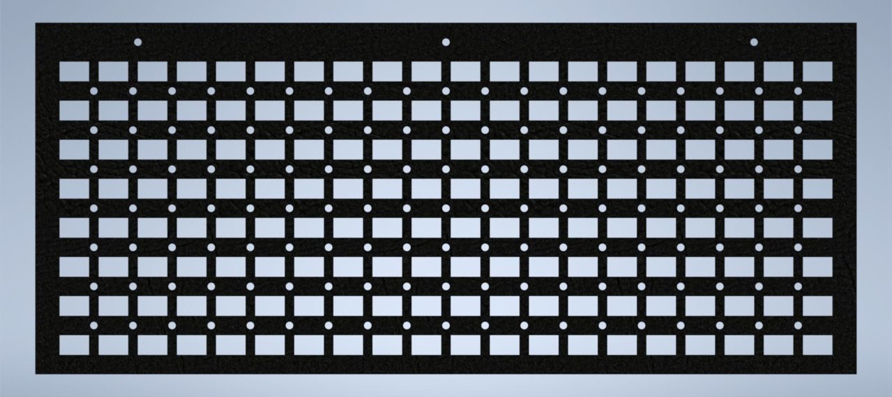

    bringing this over here just to keep things complete..
    This is one of the little items that forked off from the Bed Rack design I was working.
    I wanted to make use of the extra space and with the bed cover, it should help with security and weather
    It is a ONE piece Molle and Shock cord grid system for the front of the bed on a 3rd gen with the header rail. using a standard Molle spacing grid on the rows
    Couple minor tweaks are needed. I am going to change the mounting holes at top to slots. And the bottom corners need to get a radius. This will help the panel fit a little better.
    kwill likes this.

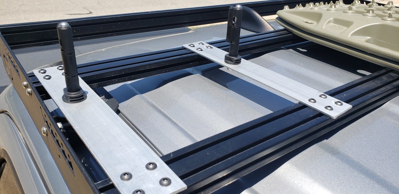

    Made the brackets for the Maxtrax's that I recently picked up as part of the group buy.
    Not 100% satisfied, but it will work. I am planning on powder coating the brackets later. and I may end up remaking them, with some fine tuning to the design.

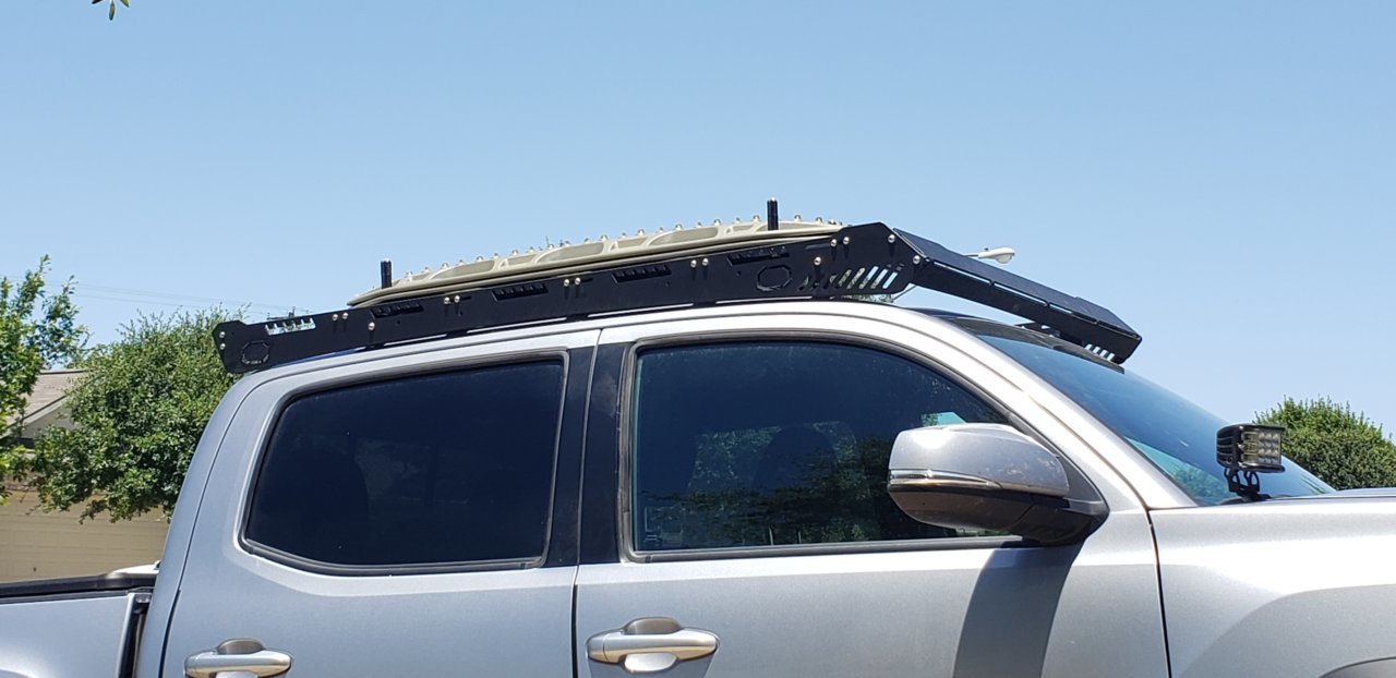

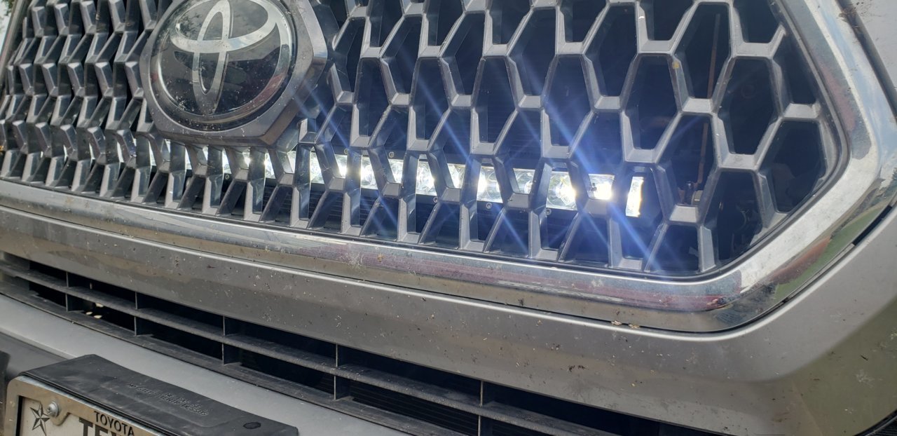

    Finally got around to installing the hidden light bar bracket and one of the light bars I got from @KENNY earlier in the year.
    KENNY and Bigdaddy4760 like this.

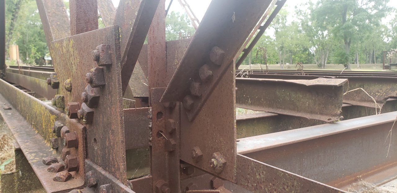

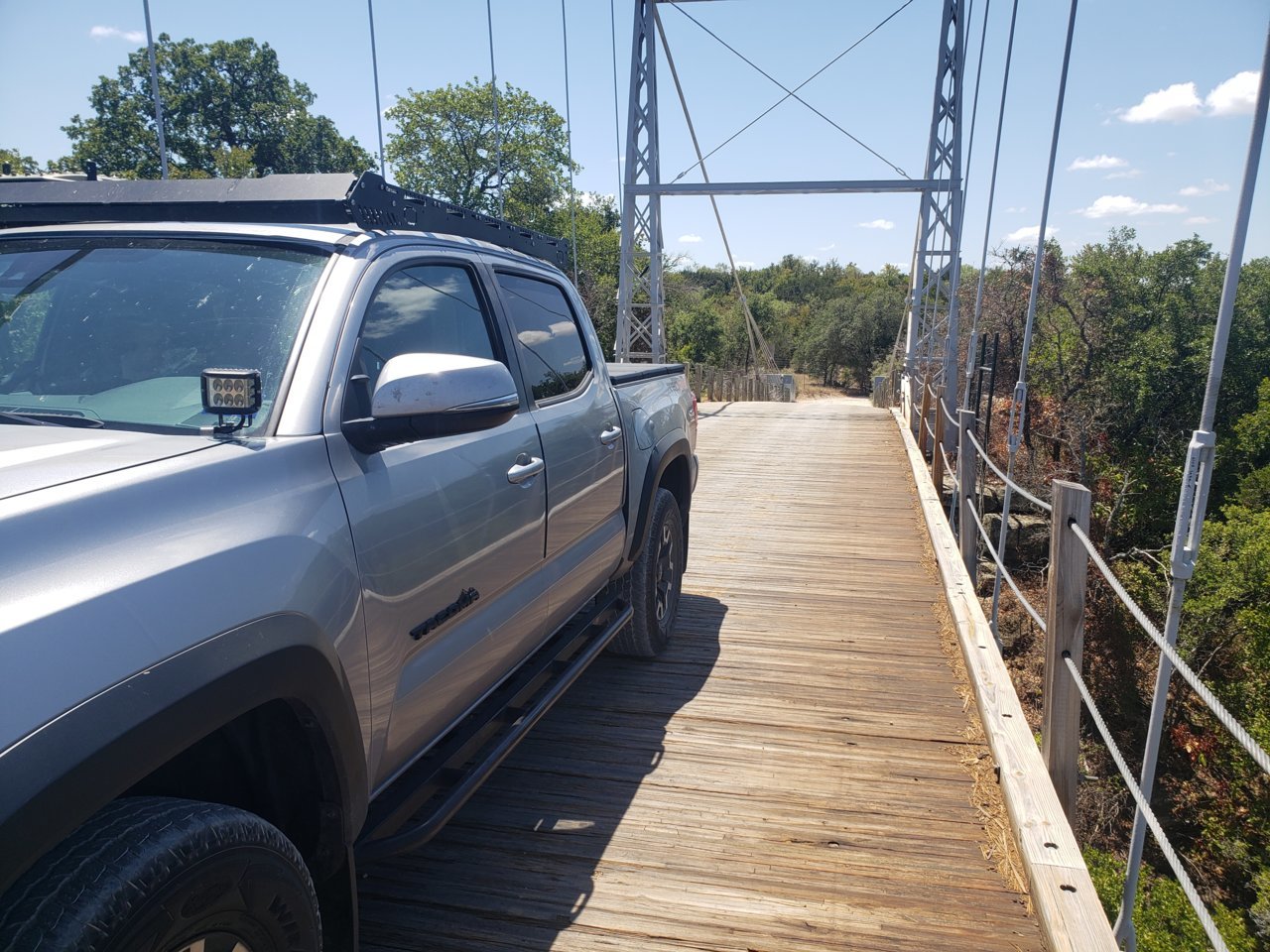

    Boredom has gotten the best of us an it was decided that a day trip out to the Davy Crockett National Forest was needed. The idea was mainly to get out of the house while maintaining the newest trend of 2020 social distancing. Second goal was to scout out some forest service roads and see if we could find some nice dispersed camping spots for the future.

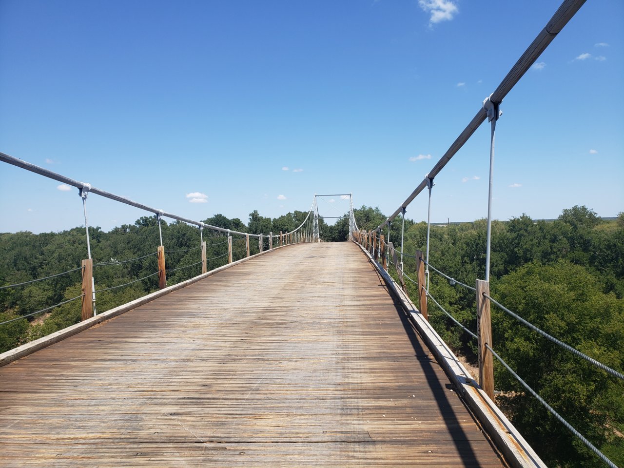

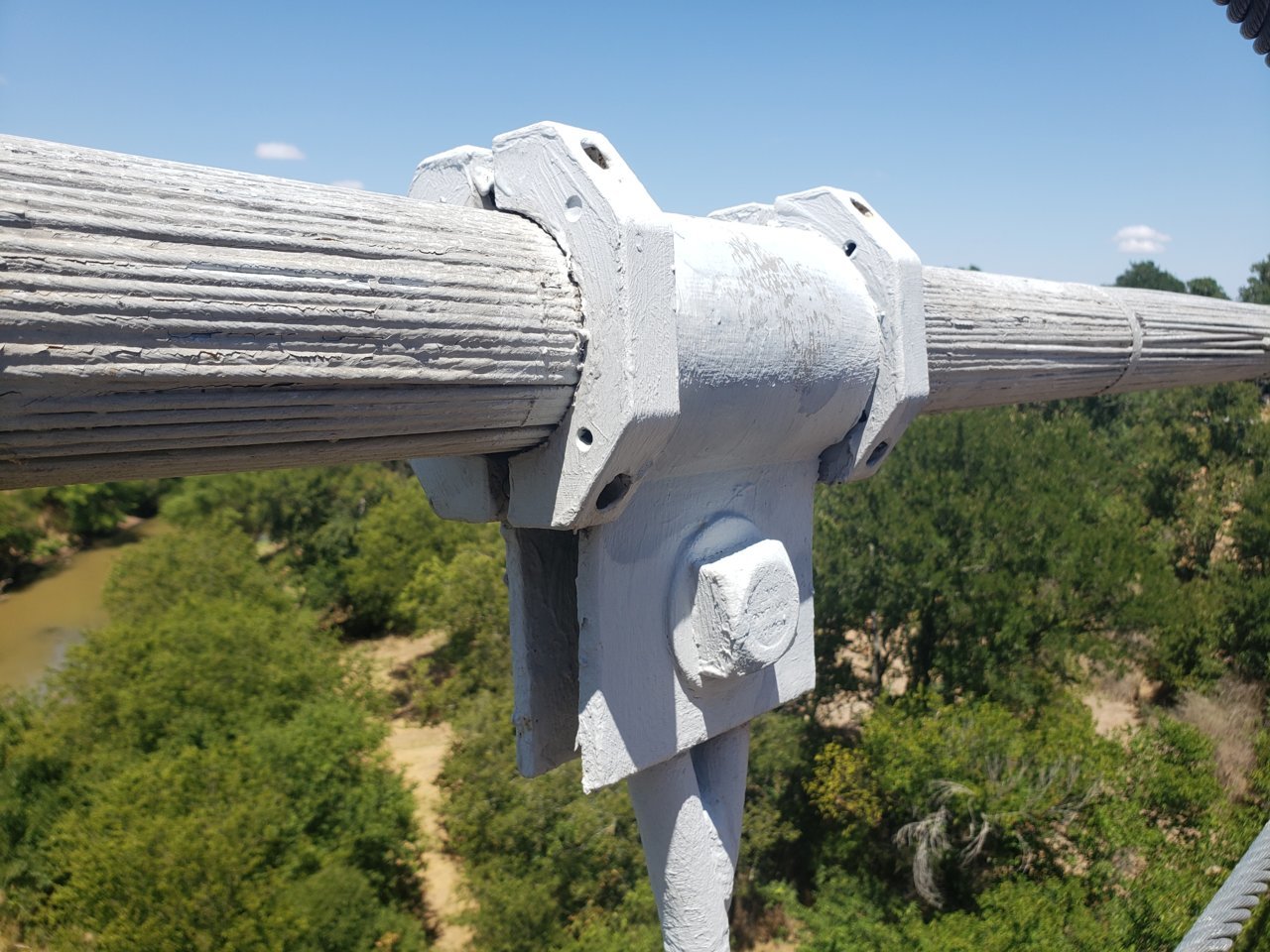

    As we drove through Rockdale, A little park with a couple of old bridges, and stange looking building caught my eye. So we made a quick stop and took a look. and this is what we found.
    An interesting bit of history, of the old Jail.
    There is something about old metal work, and equipment I find fascinating. and the bridges here where no exception.
    After spending a bit of time wandering around, admiring the ingenuity an engineering that went into the bridges. we again hit the road.

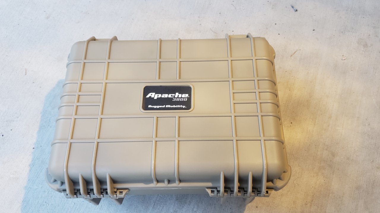

    Picked up an outerlimits supply quick release bracket awhile back.
    I used an Apache 3800 case from harbor freight. And it took a minor modification in order to work.
    As you can see, I had to remove two of the little ribs on the bottom. I used a small pair of flush cut sidecutters and just nibbled the ridges off, then hit it some sandpaper to smooth it out.
    Pull red handle to release .
    Now to find a spot to mount it, not sure if it will go on the roof rack (least not full time) or in the bed on the front mollie gear panel I did last year.
    Have not seen much posted about the bracket or using it on other case than what outerlimits sell.

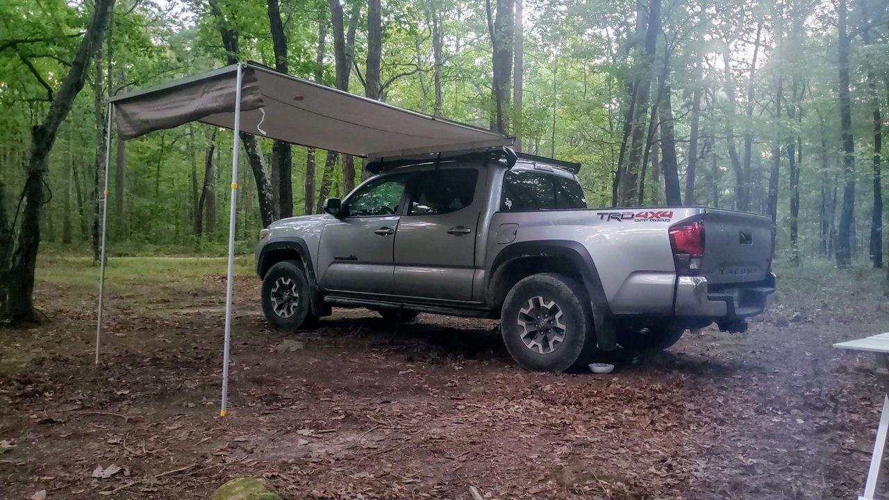

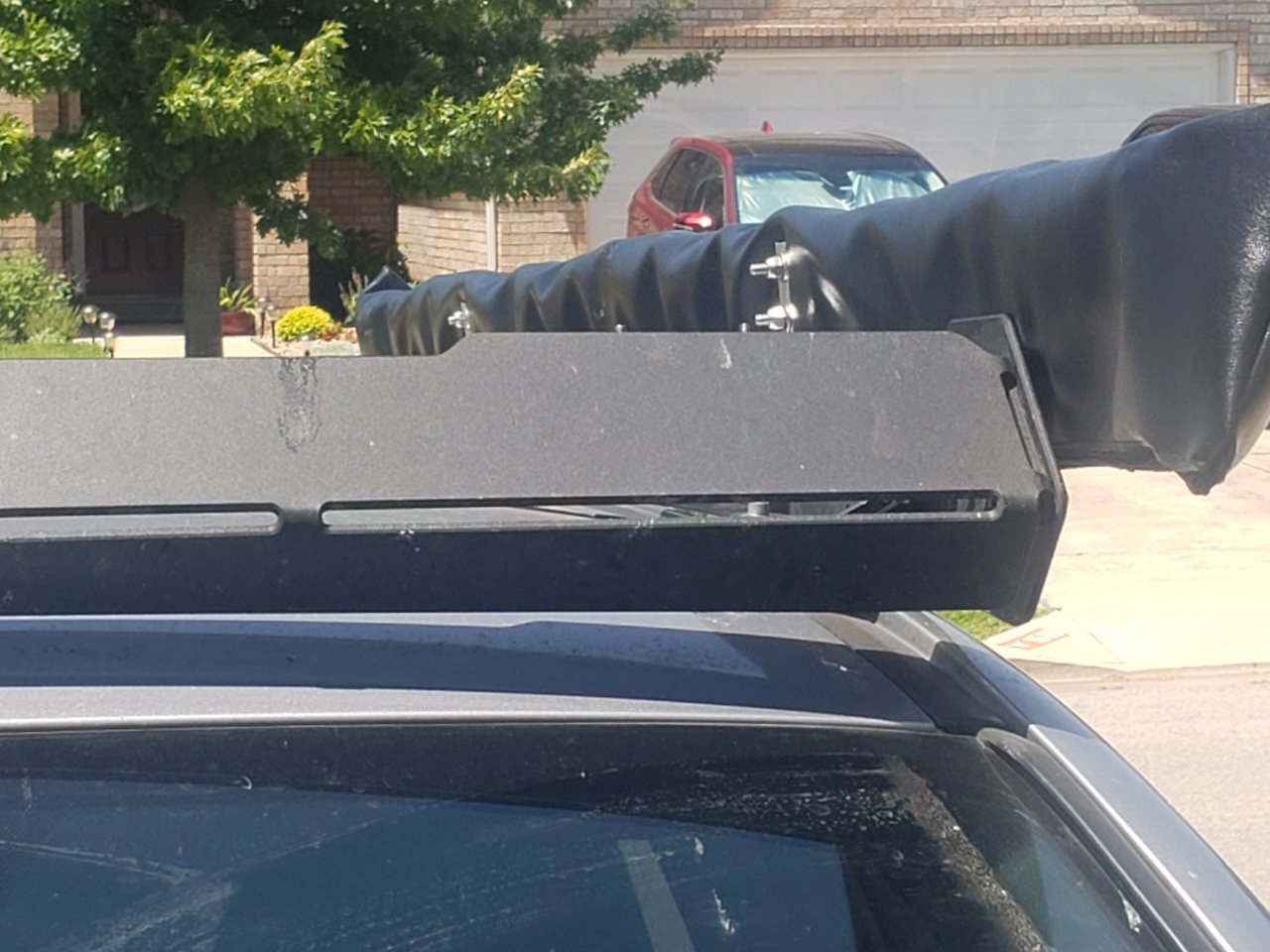

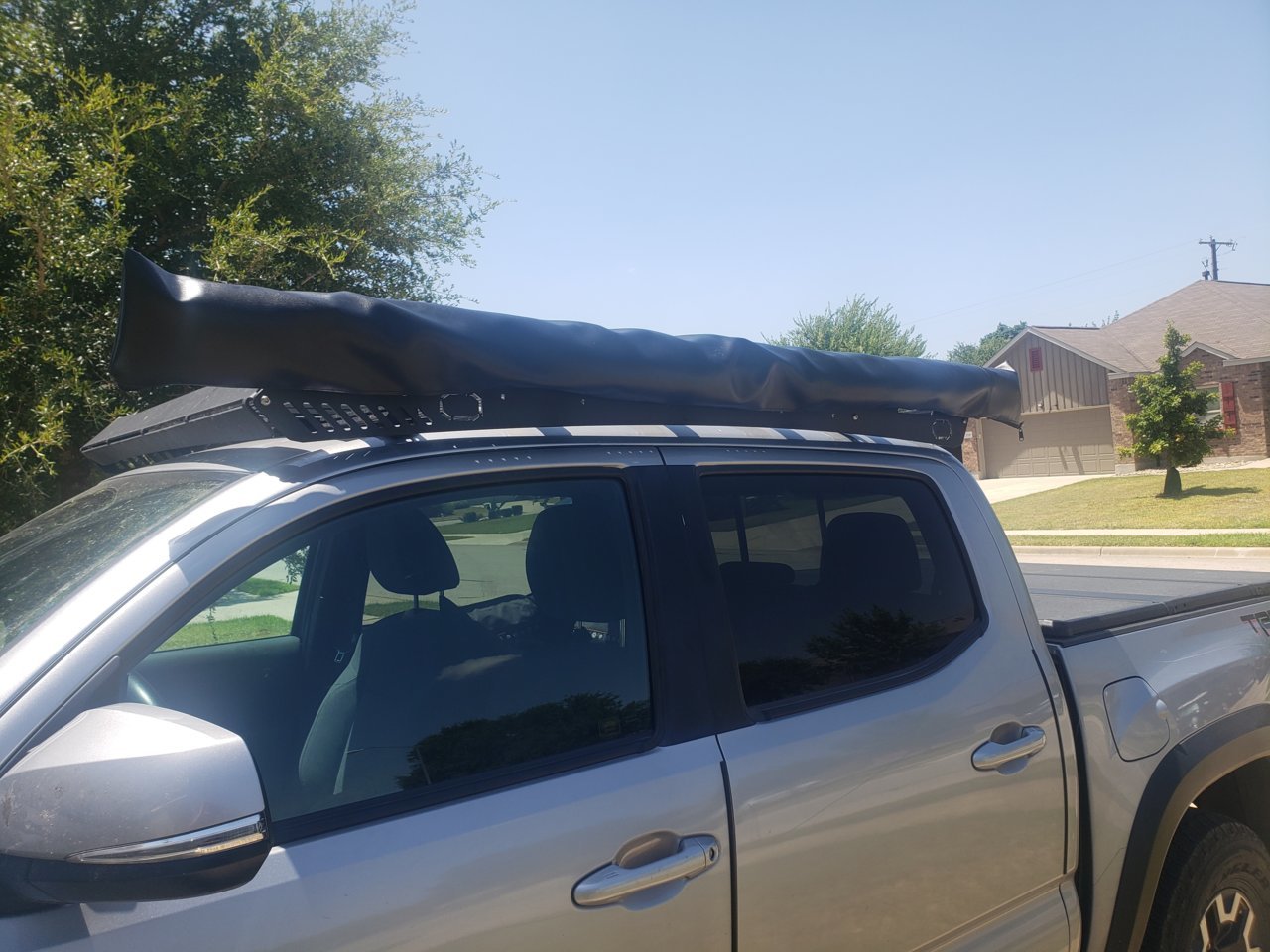

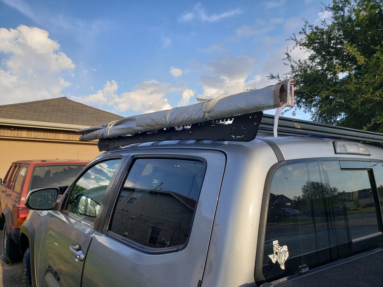

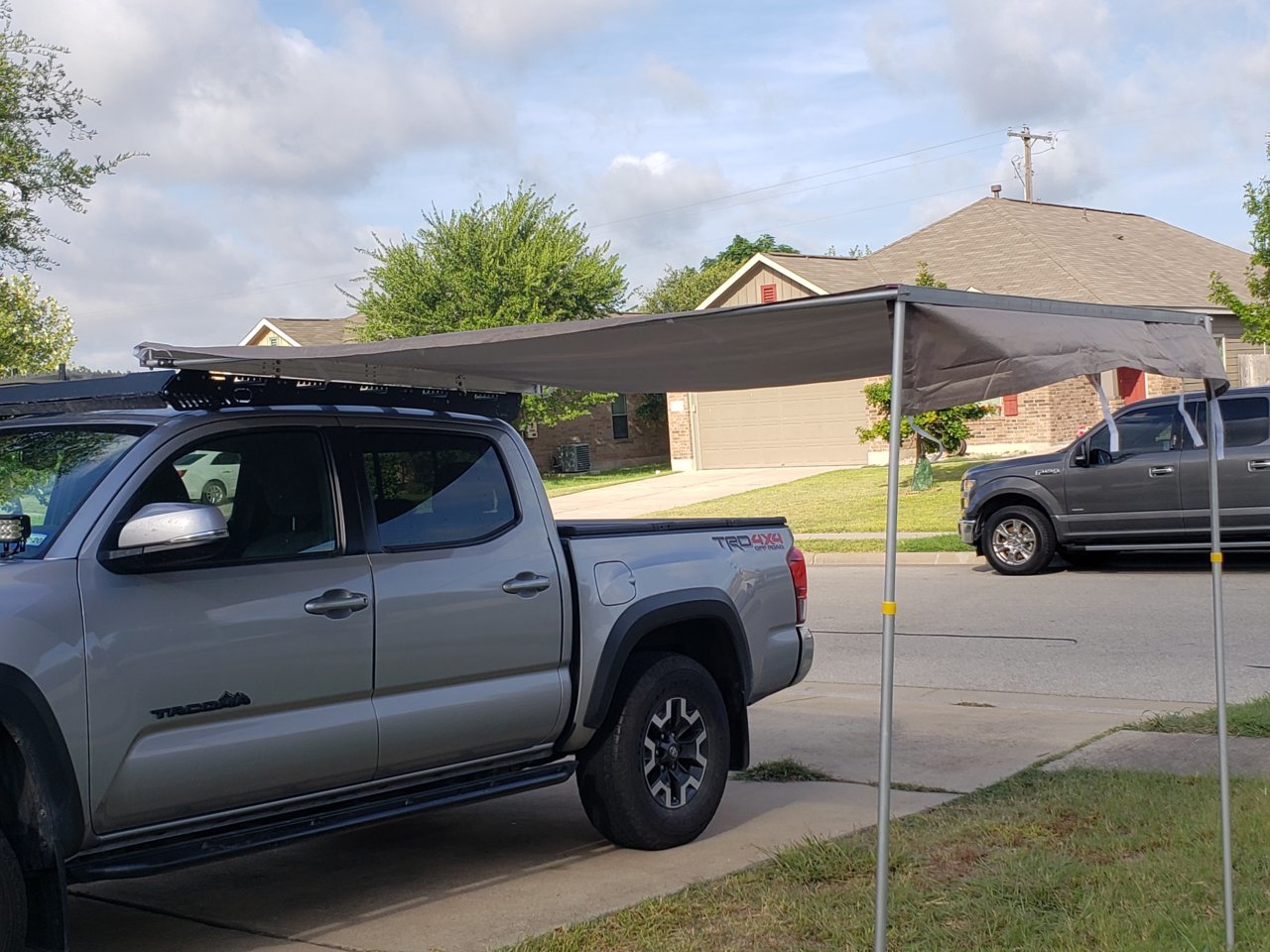

    Finished up the diy awning and the cover...
    The mule tape was a temporary way to hold everything while test fitting.. it has since been replaced with 1"webbing and quick release buckles
    Now to test it out for durability and longevity.
    Bigdaddy4760 likes this.

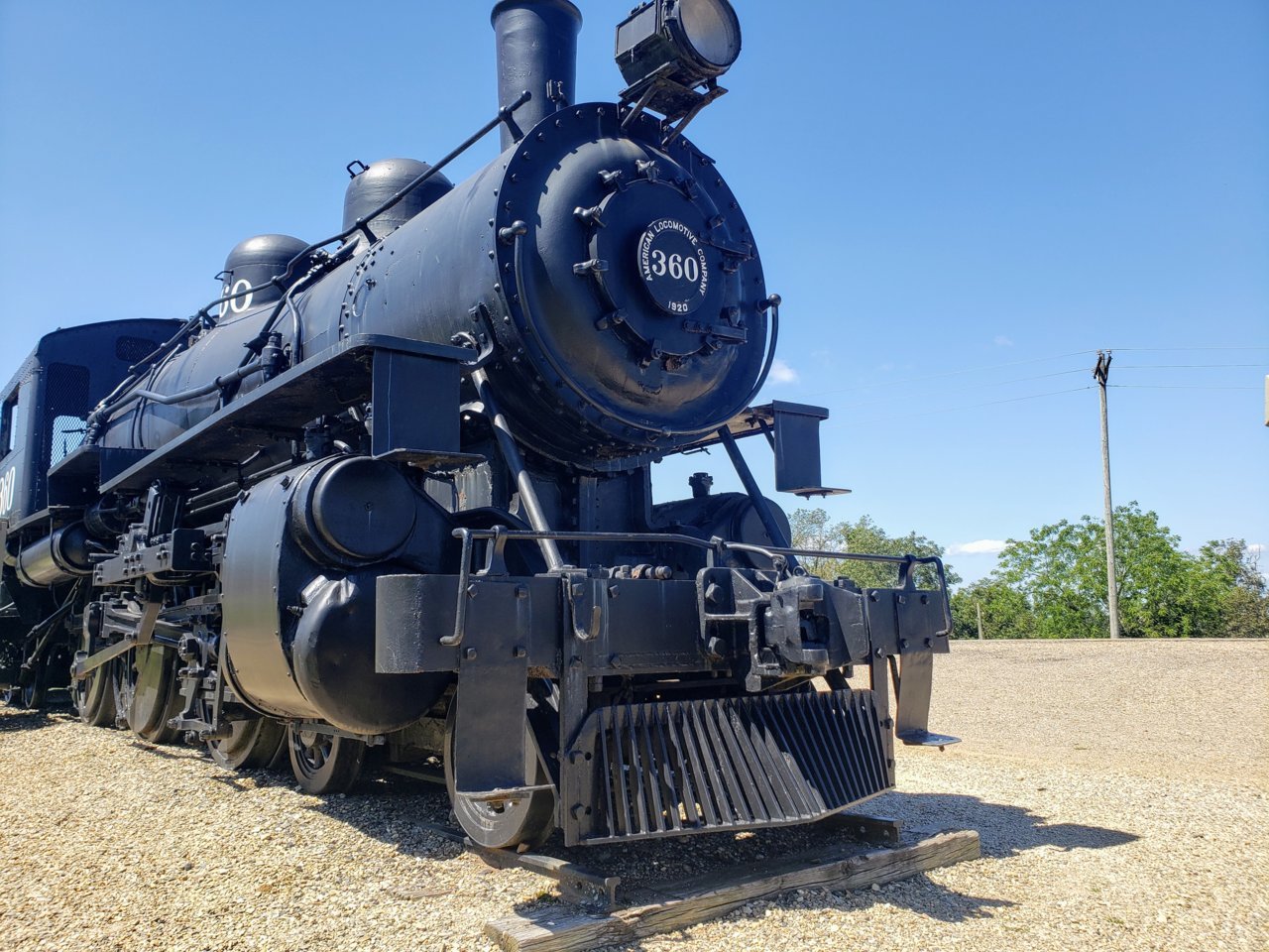

    Over on the Arkansas side of the Talimena drive, we came across this restored Steam Engine,

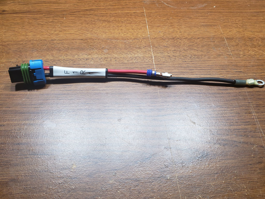

    Look what arrived, another @MESO mod... The Drop in Hitch Reverse Light in collaboration with @memario1214
    Simple and quick to put together. but as you can See not real good at following directions.. I left the sticker on, to use as a marking surface for
    the Black marker, since I was able to find a Silver Sharpie
    Drill slow... The drill press was a bit fast, and it created a bit more of a burr on the inside than I would have liked to see. however, it only took a short time to clean up the and deburr the inside of the hole
    Now to build the Delete in Reverse Harness with the Tap for this so it all remains pLug'n play

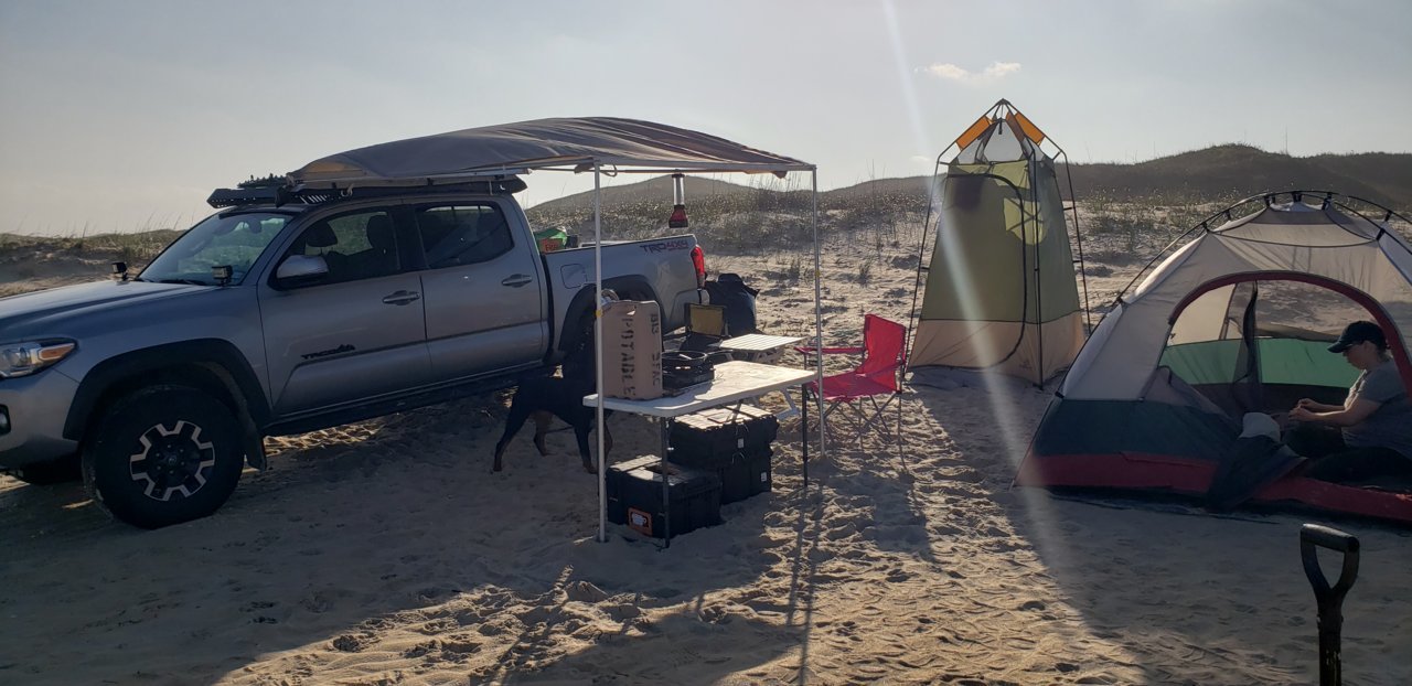

    Somewhere around 18 to 19 miles down the beach, I found a spot where no one was in sight, and found a nice spot to setup camp.
    Since it was now lunch time, the camp kitchen was set up under the Awning, and lunch was cooked.
