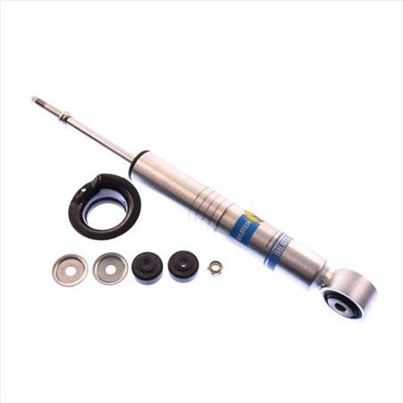

    Definitely not a guru, but there's no spacer in top. However, your Bilsteins are set on either the second, third, or fourth notch.

    What does it mean "set on 2nd, 3rd, notch"?
    I'm guessing that they're extended a bit?

    lol not the first time i was wrong and there's three notches on bilsteins for how much lift you get 1st notch is 0 2nd is 1.5" and 3rd is 2.5"

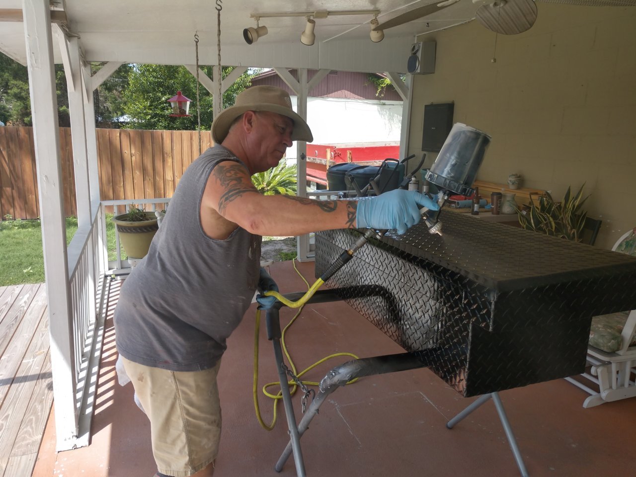

    Just a few more pics.
    Dad changing the toolbox to black.
    Mirrors being sprayed.

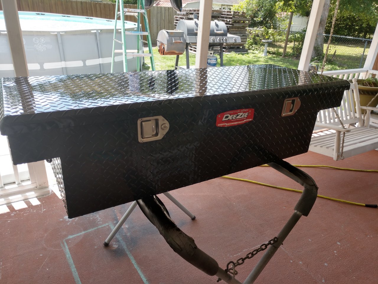

    Man finding a black toolbox to fit this stepside is impossible. I got lucky 12 years ago.
    Here it is finished.. looks like it was made this way.

    Newer ones have 4 notches I think, but that's why I hedged my statement with 2, 3, or 4, lol.
    Definitely not the first notch because you can see it below the spring

    There are different settings on the 5100s to adjust preload/lift. There are notches/ grooves in the shock body and you move a split ring up or down depending on weather you want the "stock" amount of lift/preload or more.

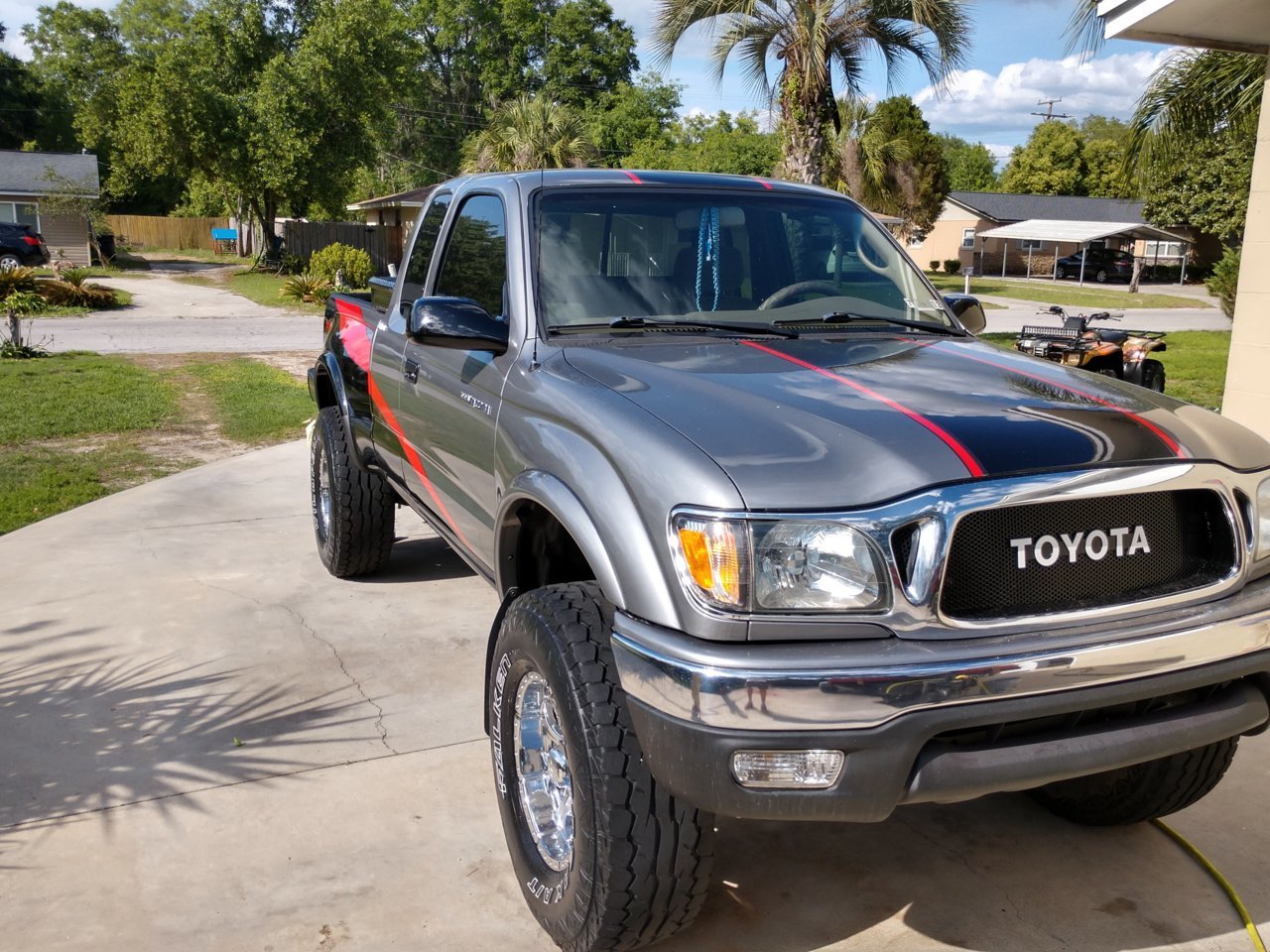

    Looks tough!! Love the step side!! Personally, I think those painted red coils you have are a nice touch. Great job and great father you have there!

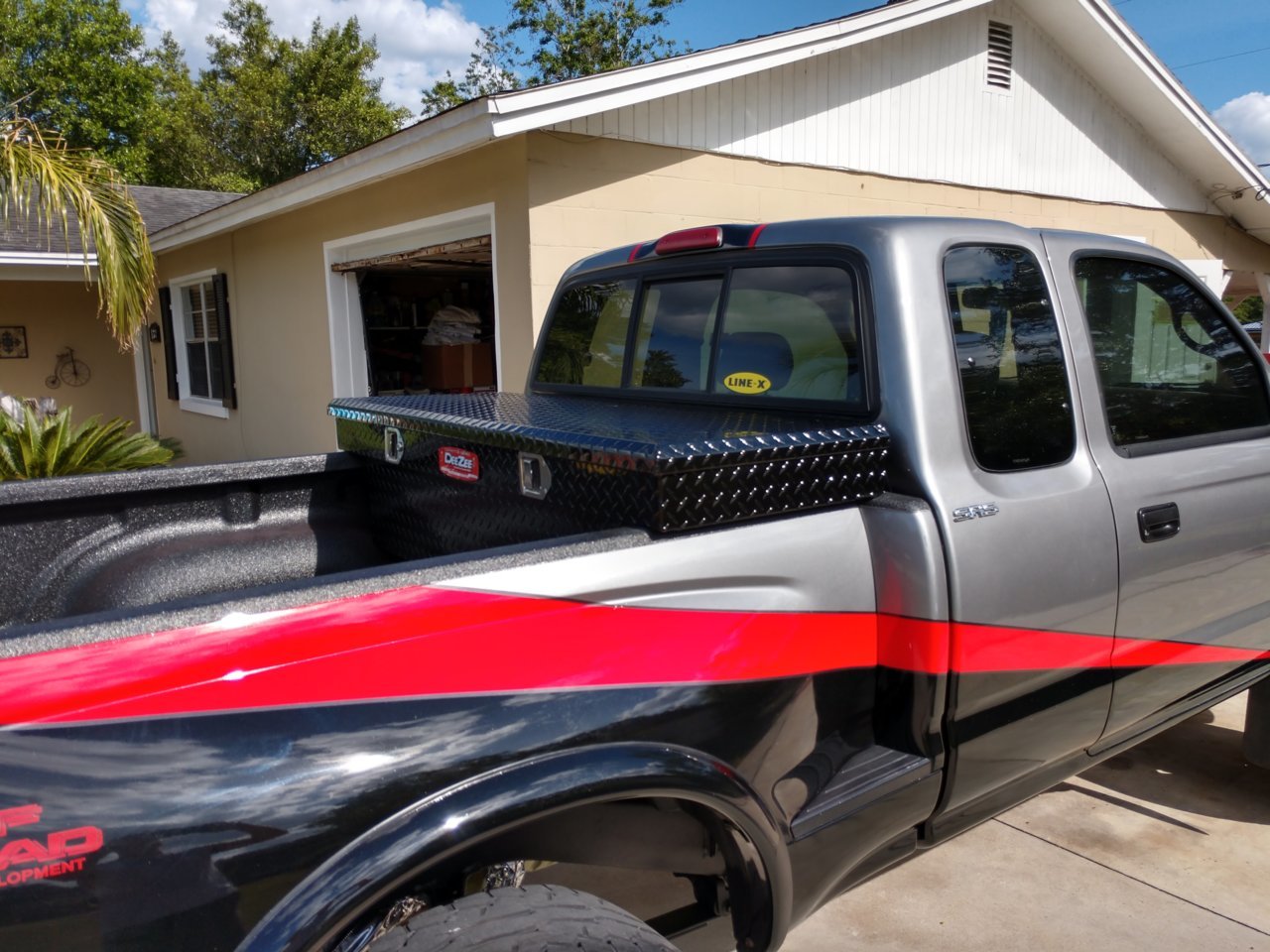

    Alright here is the tool box installed and the mirrors on. That's it! It's finished all that's left now is to wash, wax, go home to TN, and put on the finishing touches of the wheels and tires!
    Black mirrors
    I really really like this!!!
