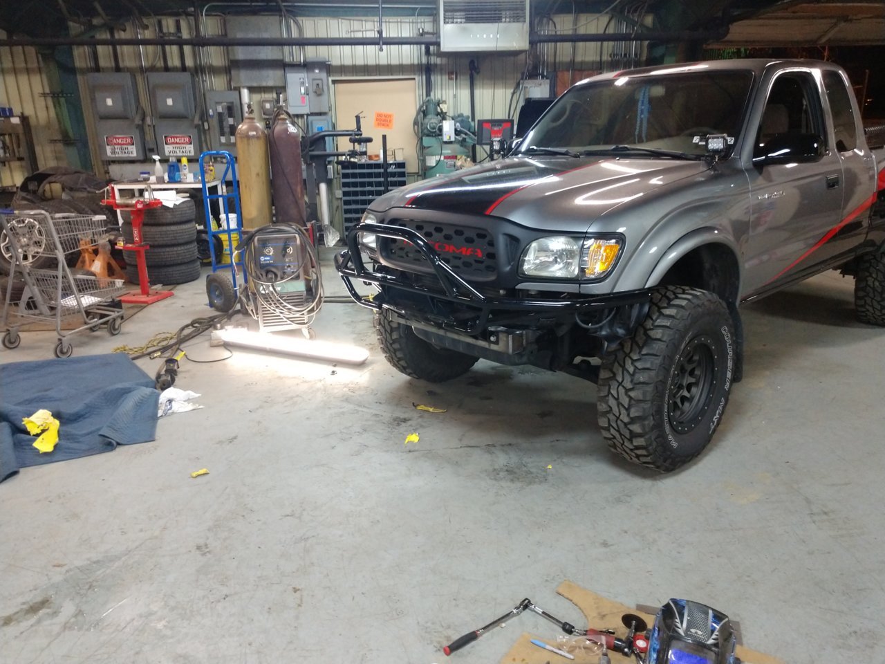

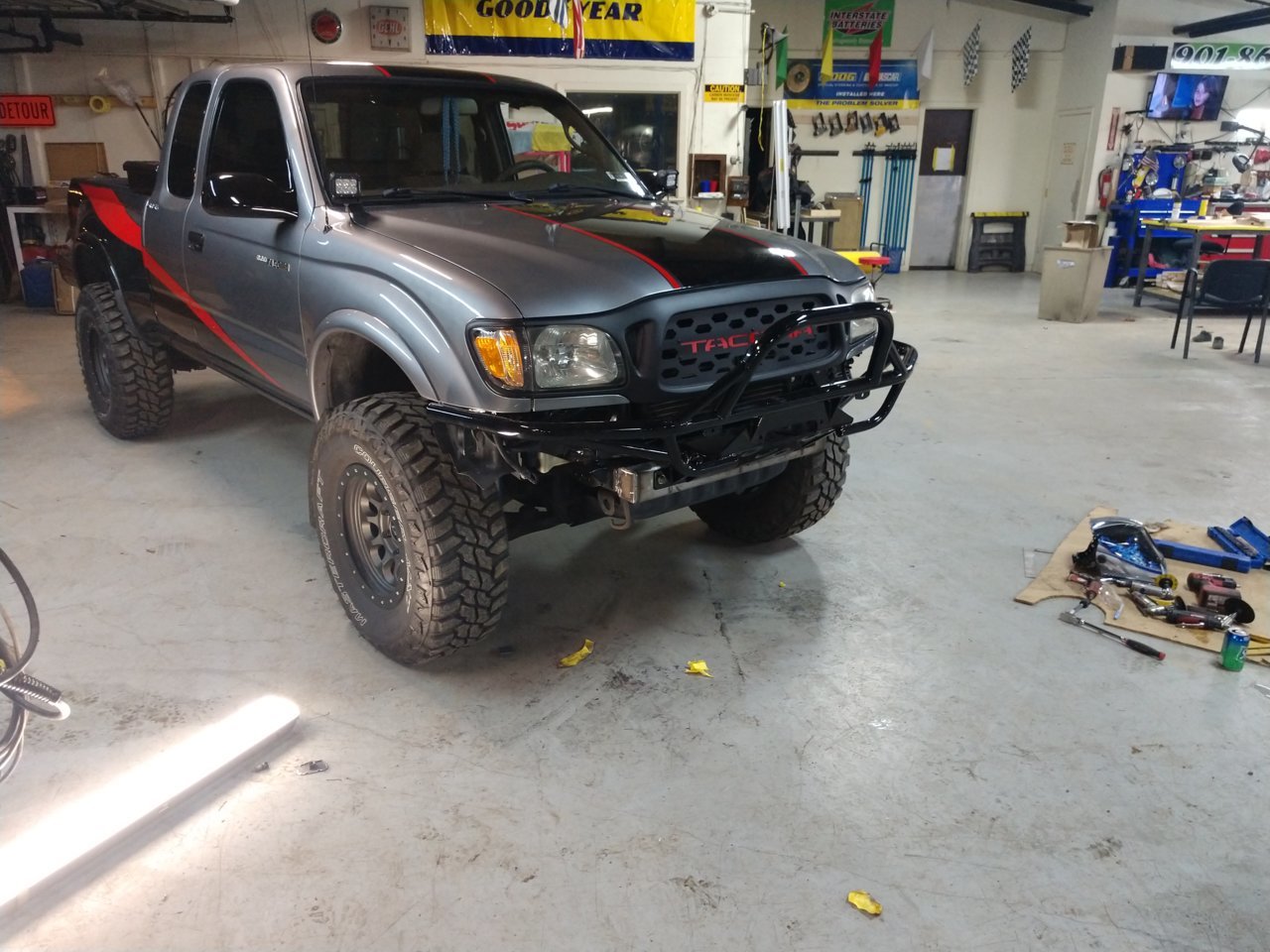

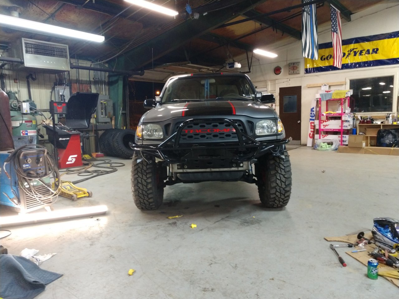

    Alright! Bumper is finally installed! Just have do some trimming, a little paint, and install blinkers.
