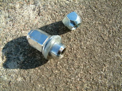

    I have been running with them for about 3000k miles... What is it that I should be worried about?

    Sheering off every single one of your lug studs. The fact the tire shop allowed it is insane. You can and will damage your wheels also. Steel wheels use an acorn lug nut, aluminum wheels use the kind with the cone that centers the lug hole on the rim with the lug stud. Absolutely do not drive like that, but the correct lugs.

    Damn, didn't realize it was that serious. Had it done at the dealership, he said it pretty casually and I kind of forgot about it. I already ordered them I'll put them on ASAP, thanks for the help.

    When you do it, inspect the studs and rims just to be sure. Once you have the correct ones in hand, you will see they are totally different.

    Didn't realize there the steel ones different as I've always had aluminum wheels. Definitely need to pay heed more.
