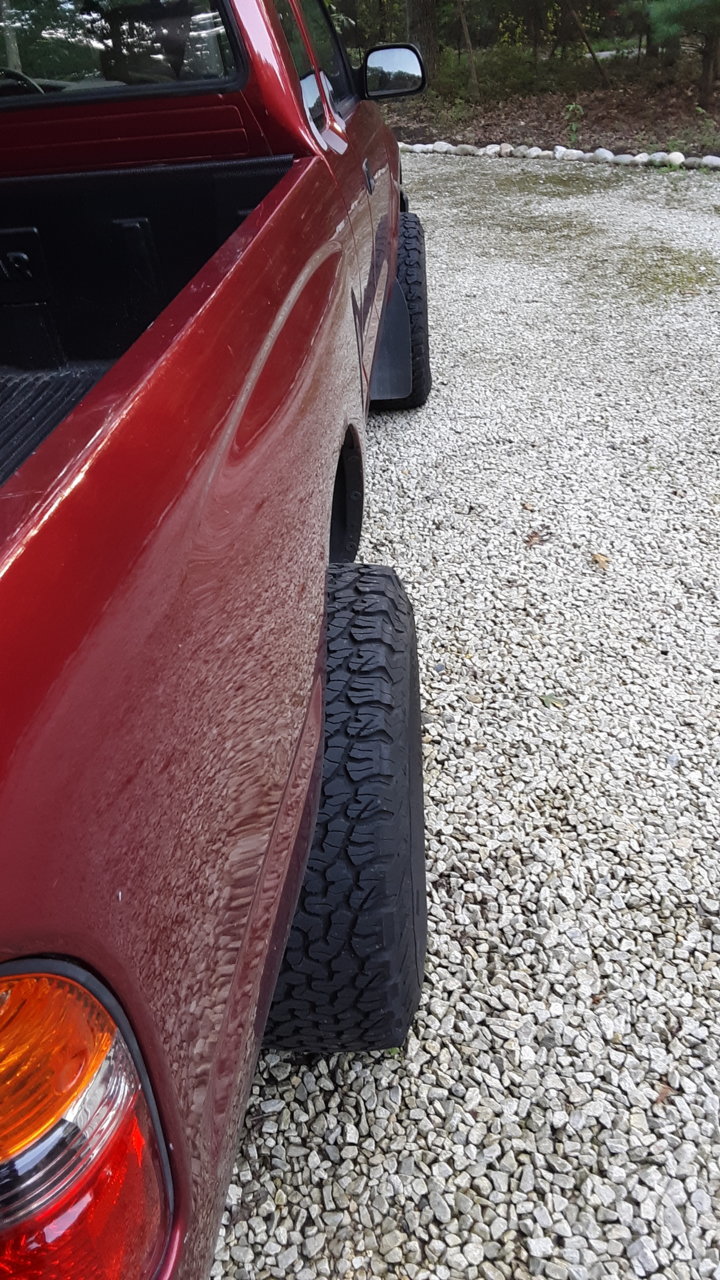

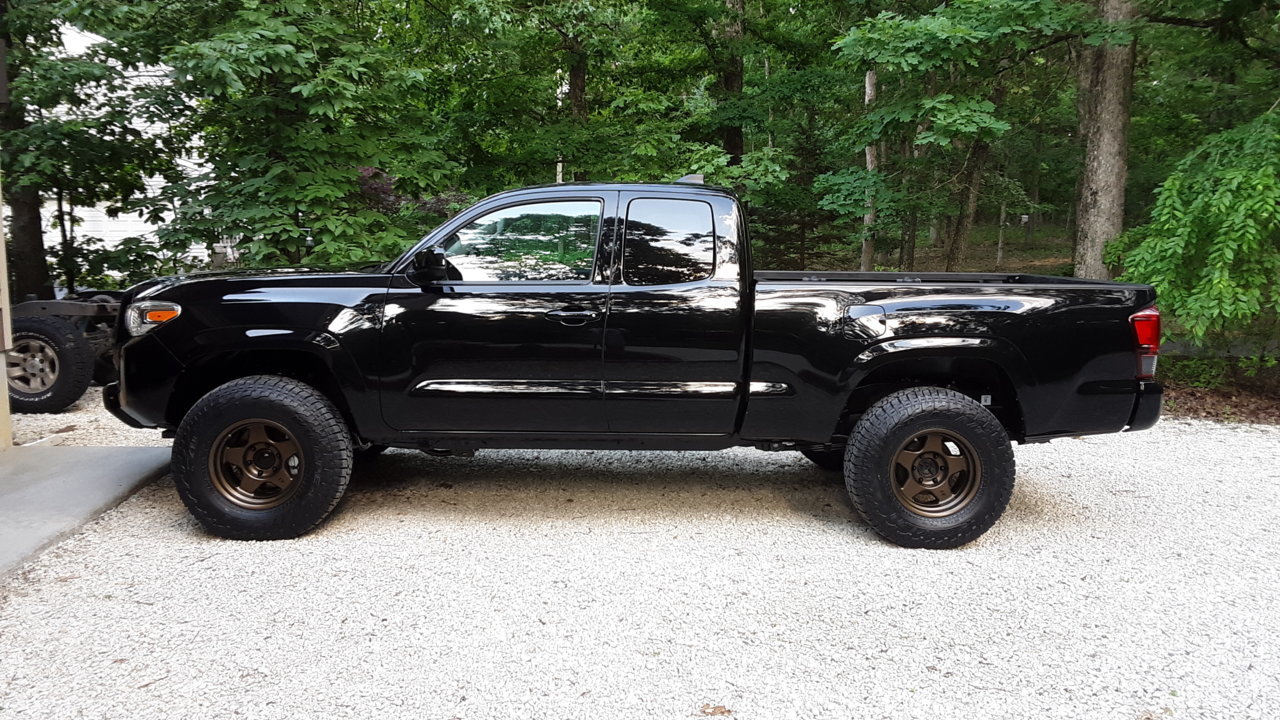

    This. -25mm offset is certainly unnecessary unless you want your tires to stick out past the fenders (which causes minor scrub radius rubbing). Most folks go with -12 or 0 offset which should be good as far as rubbing is concerned. I liked the wider LCOG look like I ran on my first gen for 20 years. I'm old school and when buying a new truck I kinda wanted it to be like my first gen which had -19 offset no lift.
    Comparison:
    Ran this setup for over 250k. No issues until the past year when I removed my rear mudflaps after pulling my bed to replace the rotted gas tank. Roughly 2 years without rear mudflaps and I have some cancer forming over the fenders. If your running negative offset it's best to have flares or some sort of wide mud flaps for paint protection.
