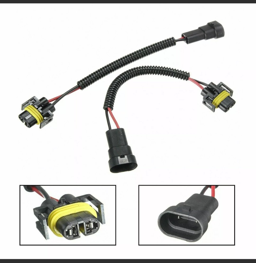

    @Kenstogie is right. If you want to go this route you can pull power from battery to relay, then power fogs from relay. For taping the low beam for the 'on' signal, buy or make one of these and tap into that so you don't touch the factory harness.
    EDIT: picture is an H11 harness extension BTW

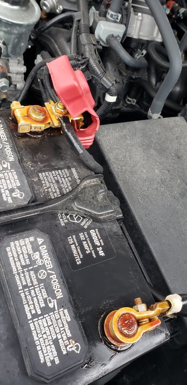

    Depending on how many relays/devices ....You could do this route also which can be a neater set up... and in electronics/electricity neatness counts.
    https://www.amazon.com/Circuit-Negative-Protection-Indication-Terminals/dp/B07X32KGF8
    https://www.amazon.com/ONLINE-LED-STORE-Waterproof-Automotive/dp/B07MR64XK1
    when I am done with any exposed connections I brush/spray on some ncp2 (corrosion protection grease, the orange stuff) see below...works great but it’s to seal out the elements and prevent corrosion and such not for use on the actual electrical connection...
