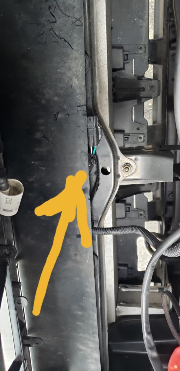

    I have an SR 2019 and found (another) random plug that is unused with green and white wires…. It’s located in the middle/center between the radiator and grill looking down…. My guess is it’s prewired for Fogs but that’s just a guess….

    That is where the engine harness connects the fog lights to the main harness. You'll have to check under the dash as well. From what I have observed I believe 2016-2019 SR with convenience package is prewired, 2020+ SR is prewired. I think I saw someone with a 2020 SR utility no convenience prewired, not positive though.

    Yes. Get the premade harness if you don't want to make it, plug in the relay, put in the stalk (10 mins) and go. You just saved hundreds of dollars instead of buying it with it in.
    Check to see if the wiring is there first, most are.
    You can make an SR better than an SR5 or even offroad by doing it yourself. Tires, rims, suspension, radio, fogs, roof rack, etc. Jacked up prices on SR5 by letting them sell you it installed.

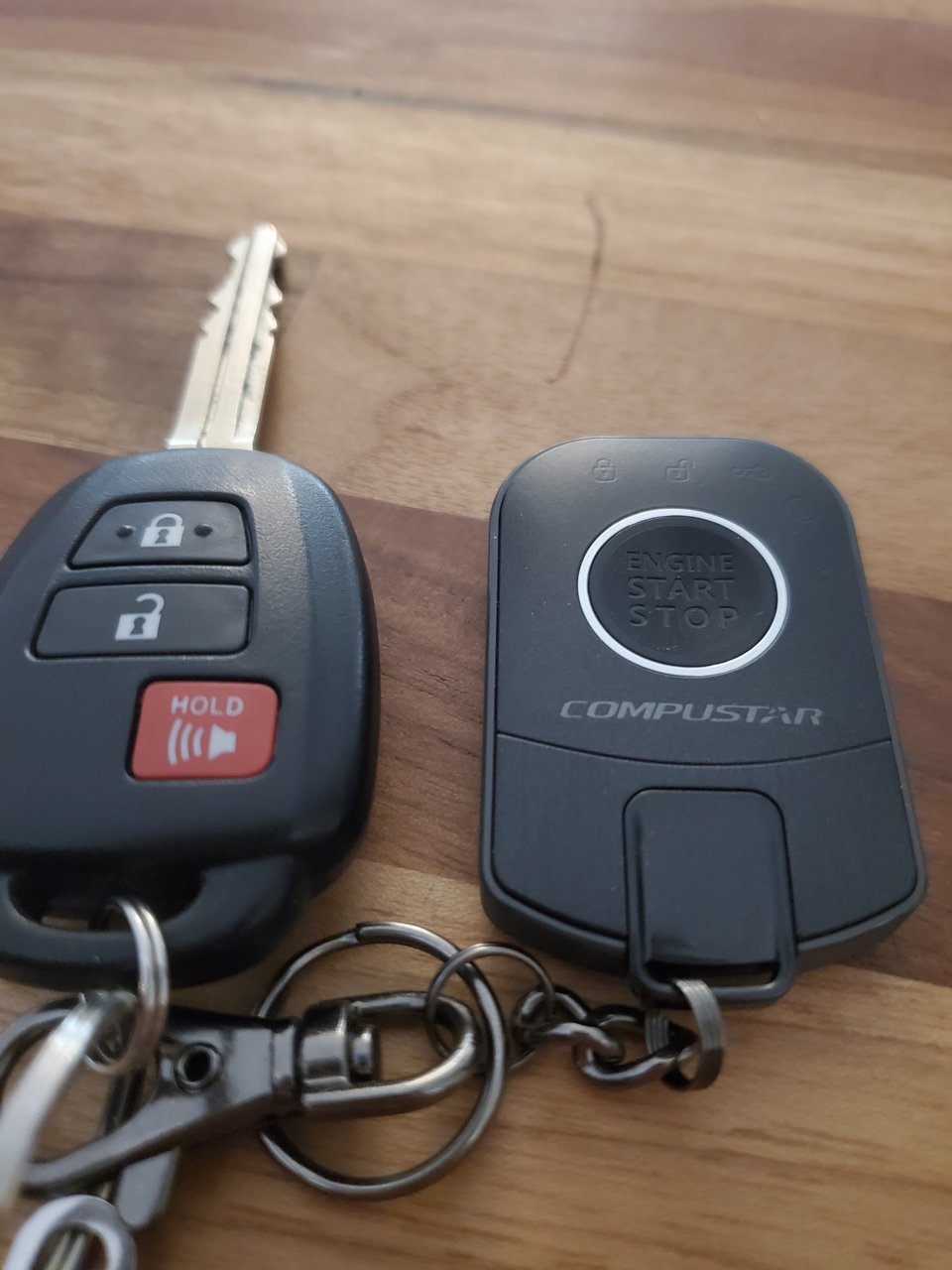

    I went with compustar through a local pro dealer. It was $600 but it came with drone mobile, proximity unlock, and a two 2 mile remotes. Main reason I didn't look at another brand is I trust their signal security more than vendors that don't even touch on the subject.
