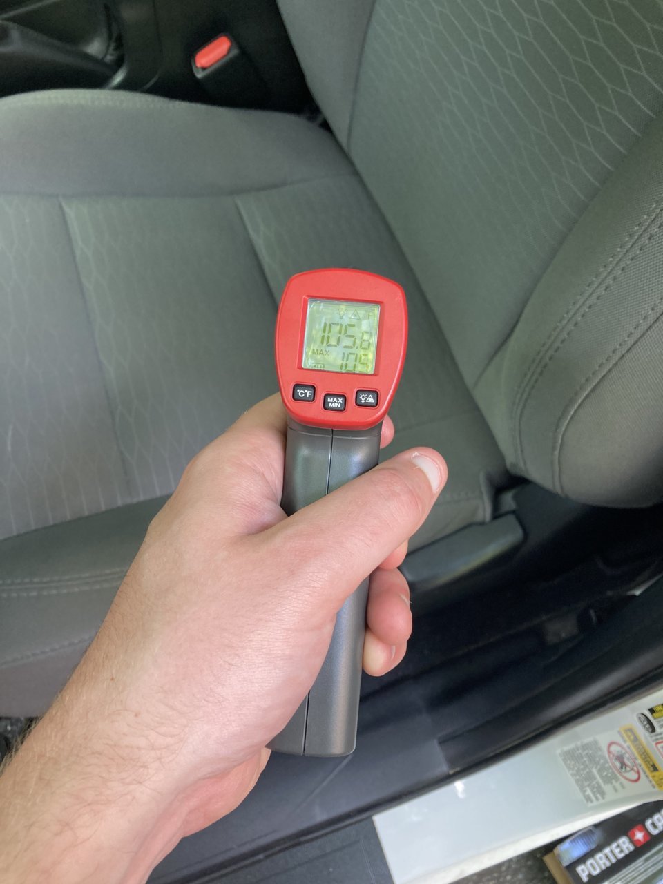

    Finally finished my seat heater install, just in time for summer! Went through 2 winters will all the parts and just couldn’t find time to do it since I don’t have a garage, but this winter my bum will be nice and toasty.
    Swapped in a fast dual USB charger for the cig lighter too while I had the dash pulled apart.
    The seat upholstery is by far the worst part. Not sure I’d do it again by choice, but for about $200 in parts, I won’t be cold on winter mornings.

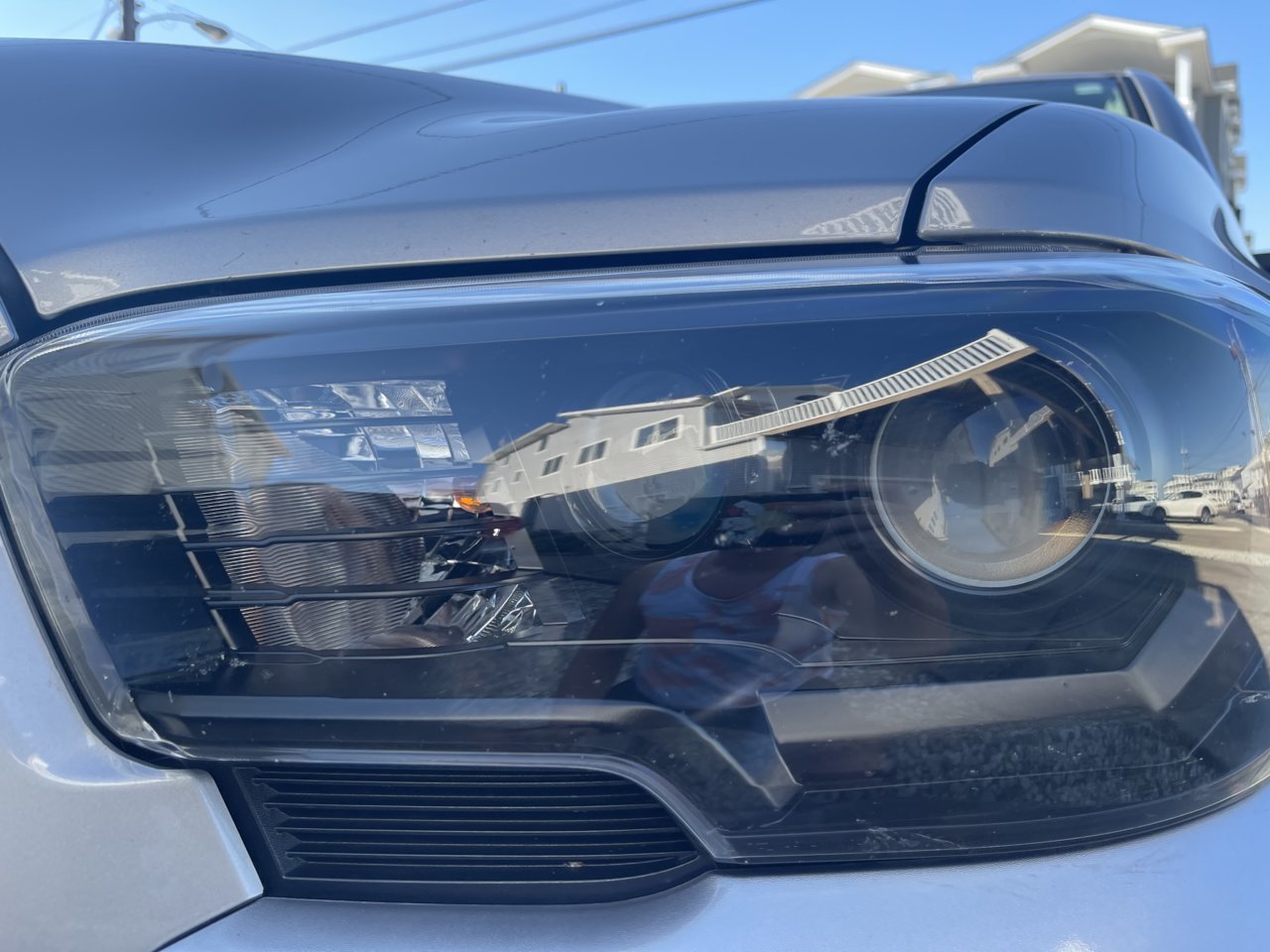

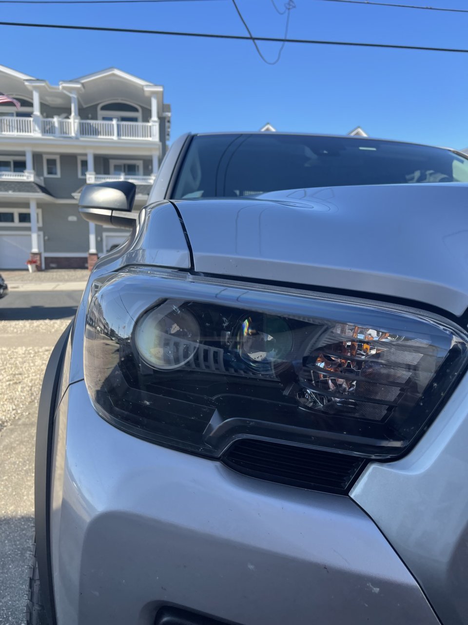

    Hey, I am @2k2 ‘s son, I’m gonna attach some pics of the work he did. They came out great, so far they’ve been installed for a little over six months. I had him paint the inside satin black, and he also swapped in some LED high beams. The price he charged for the work he did was phenomenal and I would certainly recommend him. One concern I had was moisture getting inside the light and it fogging which has not happened at all so the work is definitely of good quality. 03956594-ECF9-40AD-AC1B-67C8C30052F3.jpg9B2BE208-90BB-456C-AB9F-B3509E90B121.jpg

    Those look dope! Have a shot from further away so we could see the whole front end?

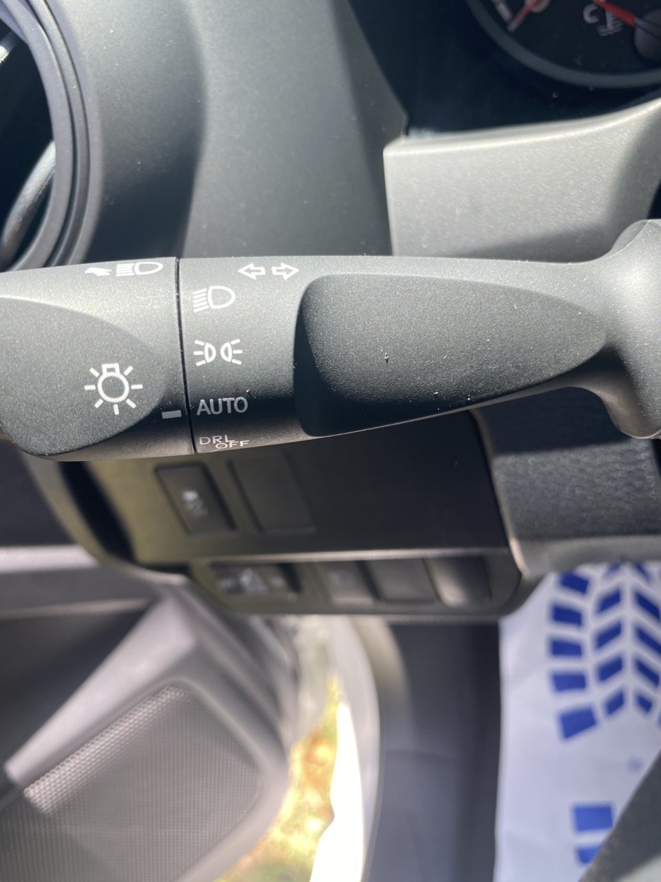

    Just picked up my 2022 SR. Is this stalk the one everyone upgrades to for fogs? Does having this mean I can plug/play fog lights and then get some aftermarket LED headlights?

    This.
    The OEM setup is pretty good, and, well..... its OEM. No muss.. no fuss.
    There are several OEM bezels to pick from... the offroad ones are like $8. Get the factory harness, stalk. Troll around the B/S/T forum for a set of gently used take off light units and you can get a factory setup for around $200.

    Looks like my sons stalk he wound up buying and putting on ... mine looks completely different, although I may have gotten the corolla stalk..
    Either way... they look different, but both work.. I'd assume you'll be ok just adding the lights and operating them via the stalk you have. Maybe the new ones have the stalk along with all the necessary prewiring.

    Drl... that's another story... the Amber turn signals are my DRL on my 2020 SR. I'd assume that's how the 22 is setup as well.

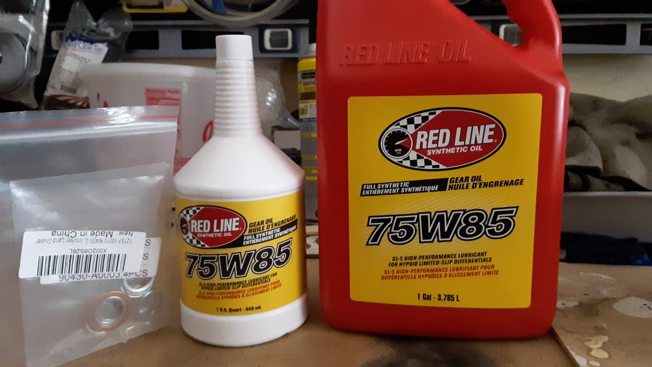

    Getting ready to do the front and rear diffs.. I'll leave the xfer case liquid gold alone until 60K. Eventhough I was clipped on the rear I still may give it a nice bath and wax job.... we'll see how the fluid swap goes.
    Anyone use this stuff?

    I have not, but I am putting a fluid change materials list together and thinking of going with Red Line.

    Just did the swap today. Aside from not having a 10mm hex key for the front it was painless. I had to go out and buy one for $7 annoying). The stuff smells horrible. At 32k miles now and the magnetic drain plugs were caked with metallic sludge. The rear fluid was black and dirty. The front was grayish and not that terrible. I left the transfer case alone... the dealership wanted $900 for a 30k service... really?
    The rear of my SR took around 3.5 quarts or so (I may have spilled a bit transferring from the 5qt container over to the 1qt), front took about 2 quarts. I have about 2/3 quart left out of 6.
    Quick spin.. nothing feels different.. well see how my drive into work tomorrow goes. I'll put it in 4wd later on today and drive for a few miles

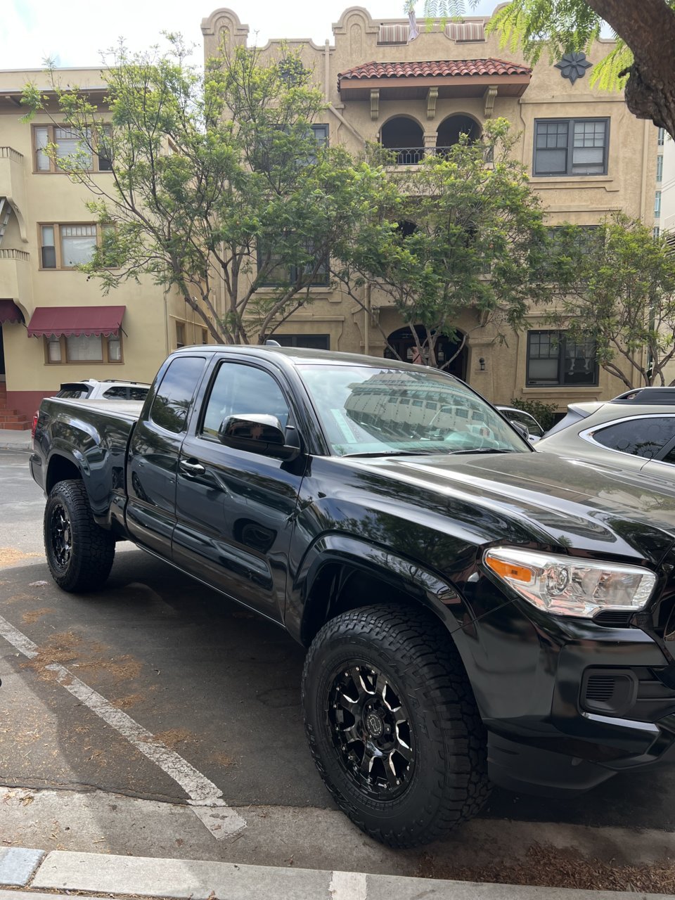

    Just sharing my 22 SR 2wd 2.7. Mpg went down but the truck looks cool. lol I hope I’m doing this right.
