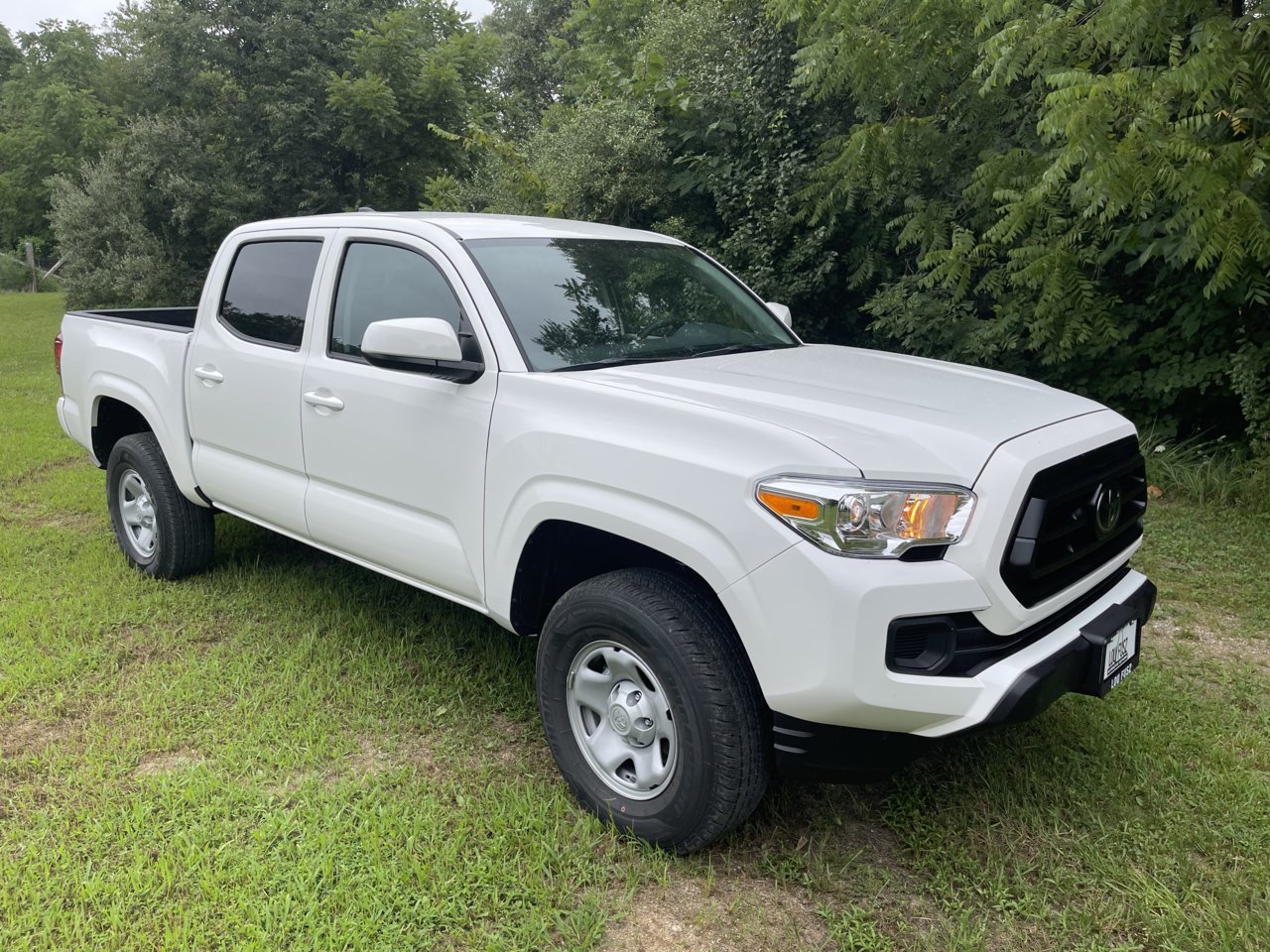

    FINALLY got my new SR 4x4 yesterday. Nancy at Lou Fusz in St Louis took great care of me. This thing rides and drives great! Now I can park my Ram 2500 and daily drive this. So much handier to get around in. I am a real estate appraiser so I drive a lot.

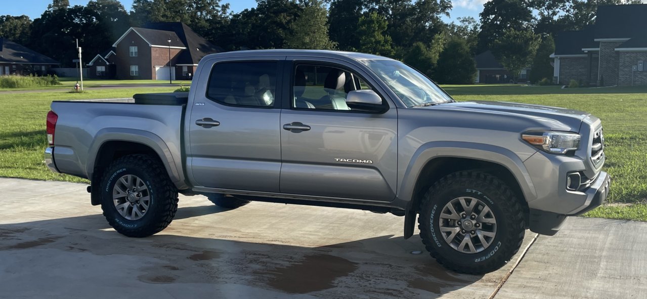

    SR5 265/75/16 cooper stt pros. Stock suspension and lift

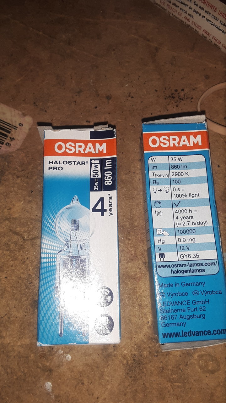

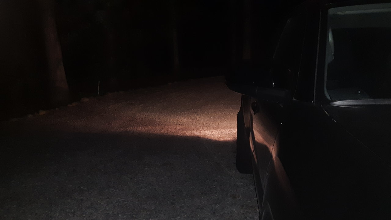

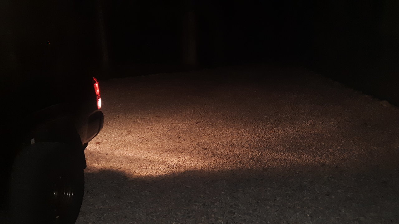

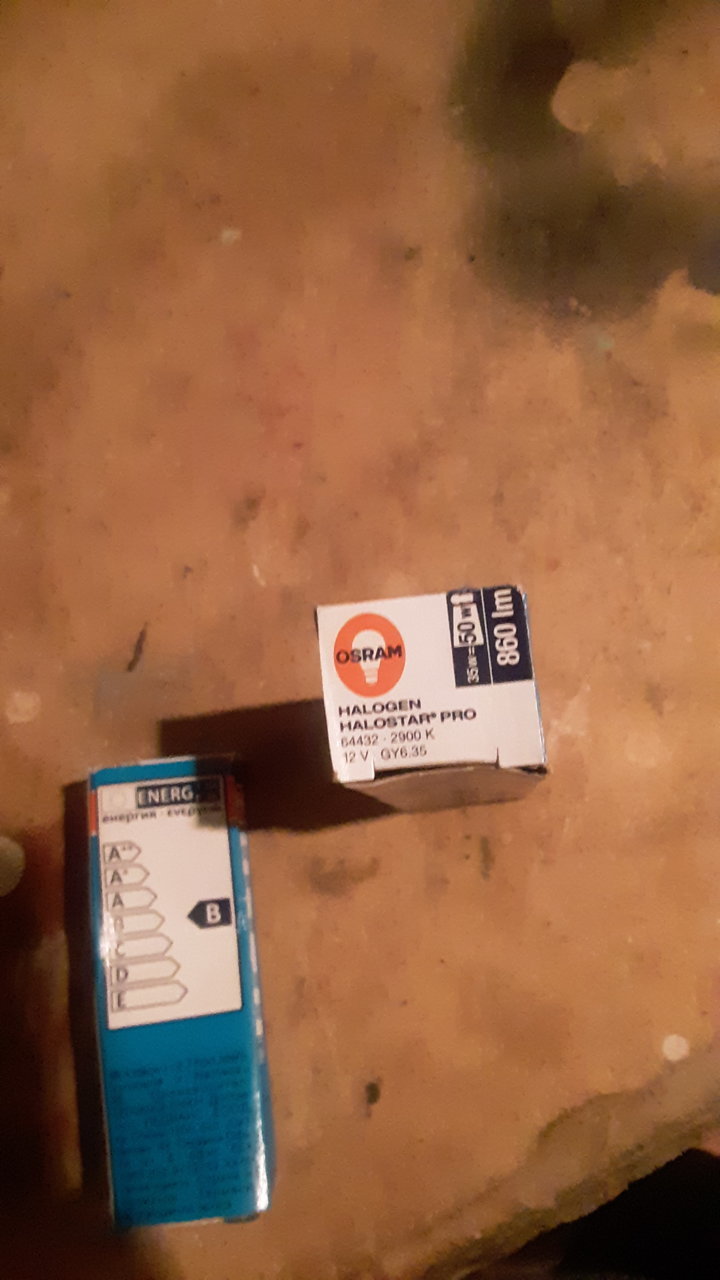

    I got a second to compare my reverse lights vs my sons taco this evening. The difference is pretty noticeable.
    1. The hotspot is much larger
    2. Useable light extends a bit further
    But... for me the biggest difference is
    3. Drastic increase in perephial lighting
    This is going to help me see the edge of my stone driveway and back out onto a narrow unlit road much easier.
    These pictures dont really tell the story, but let's just say that my driveway is roughly 50' wide at the rear of my truck. That 50' width is nearly entirely lit.
    I ain't the best photographer, but let me tell you that the light throw is farther, more saturated, and a LOT wider. Its damn near a 180° spread. This modification is a close 2nd to the bed mat.. I know it will prove to be a super useful upgrade for me.
    The only drawback I could pick at is that the light is intense and somewhat blinding. When looking at my truck vs my sons truck from the back, you couldn't really look directly at my reverse lights, it was too intense to focus on... his weren't difficult for my eyes to focus directly on.... However..... it is a reverse light and 99% of the time it's not going to be an issue to other motorists.
    Here is what I got
    https://www.google.com/url?sa=t&rct...wQFnoECA8QAQ&usg=AOvVaw2Yfha-RmcsxOwND5AiQ0qu
    Heres pictures of the boxes... sorry.... no pictures of the lights.. I didnt want to mess with them too much.. they were tiny.
    Again thanks to @crashnburn80 for doing all the legwork and posting some genuinely useful information.

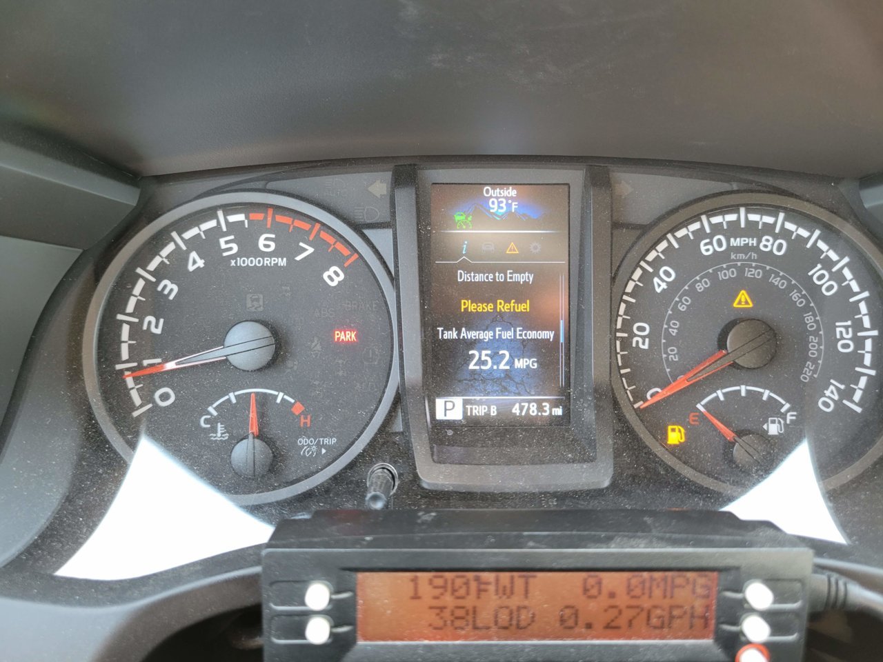

    2.7 4x4 did great in Colorado
    Stock aside from the topper, 245/75-16E Firestone X/Ts, WeatherTech mud flaps, a power outlet in the bed and Seat Jackers
    Nice sleeping accommodations
    2.7 + 65 MPH =

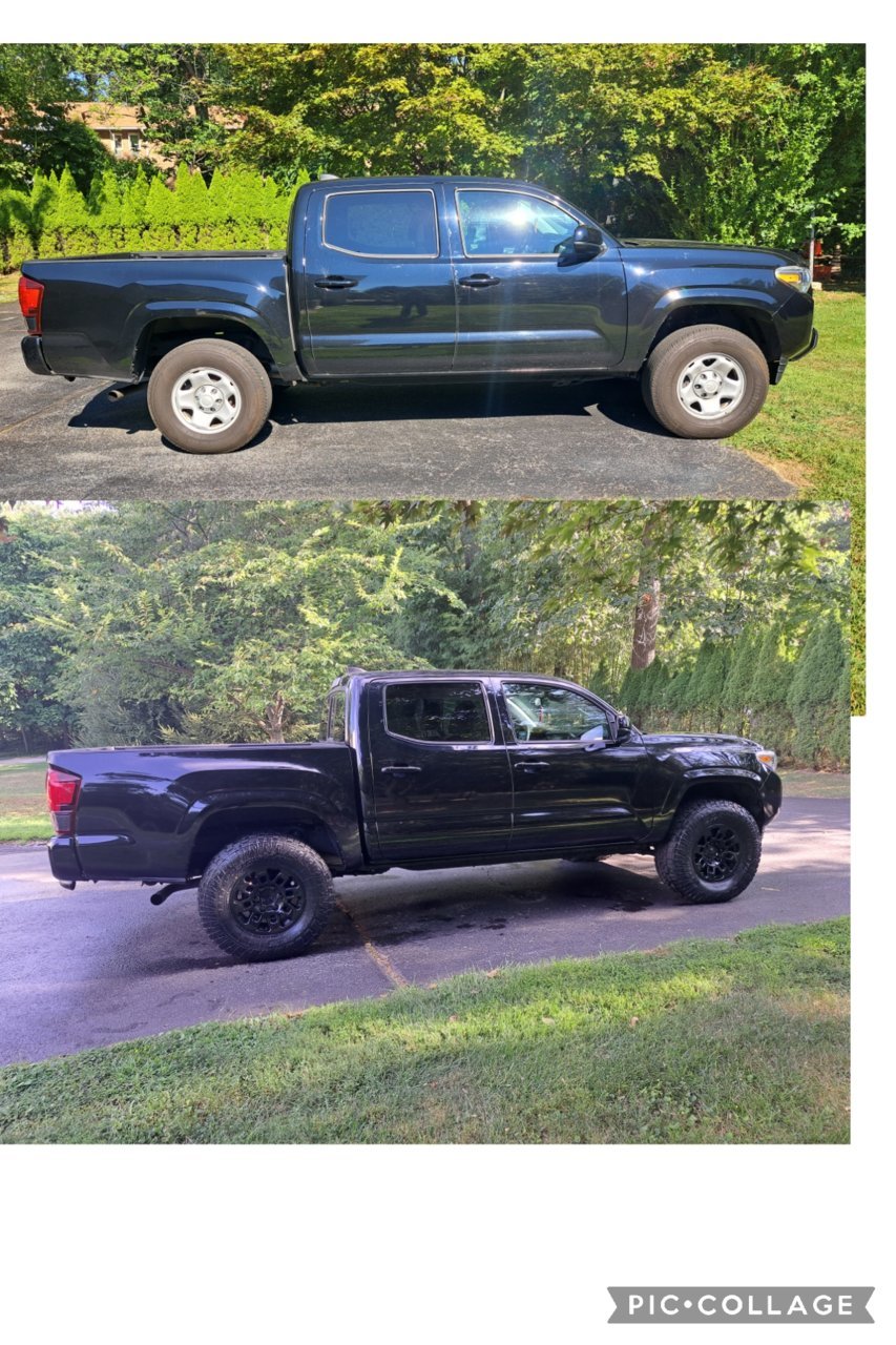

    Just got them yesterday 245/75/16 to 265/75/16
    On OEM TRD wheels,16x7C6373C22-66C5-4D56-BF28-9BBF7CA37474.jpgC6373C22-66C5-4D56-BF28-9BBF7CA37474.jpg C6373C22-66C5-4D56-BF28-9BBF7CA37474.jpg
    No center caps yet, coming in but not sure if I want them
    No hits no rubbing
    Stock SR and looks that much better

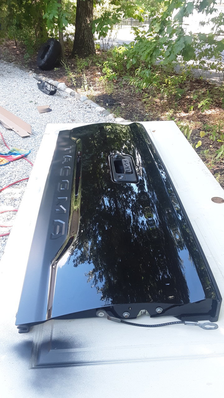

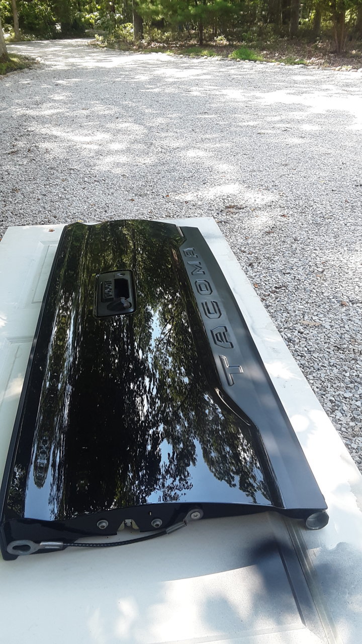

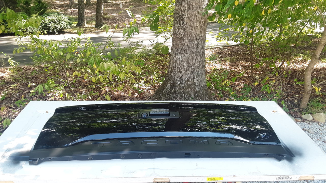

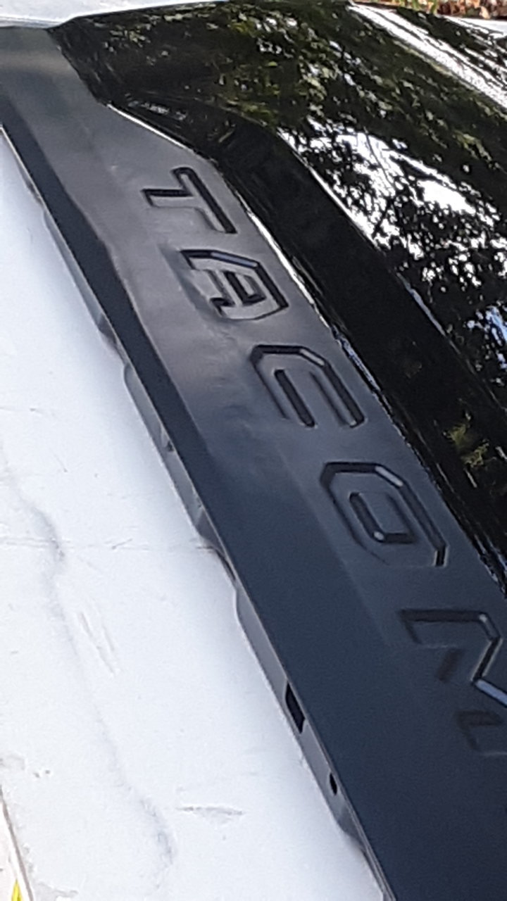

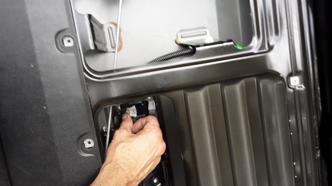

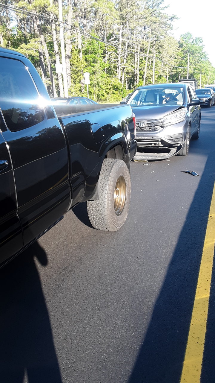

    And so...

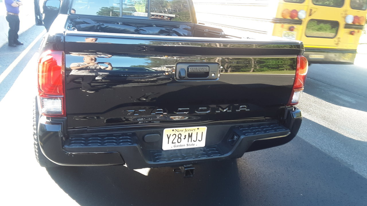

    It's been 2 and 1/2 months since my truck got rear ended.
    I'll spare the pictures but basically my tailgate got dented and folded right on the stamp and my bumper got bent downward leaving me with what looked like a saggy diaper (especially on the passenger side). My $40 DrawTite Hitch Receiver saved the day and really saved me from a lot more damage .
    The goal here is to fix it good enough in my driveway and have some extra chump change for things that are important. Initially I was soooooo friggin pissed .... but shit happens and after a good month or more of dealing with these jerkoff insurance folks and their "approved repair facilities", I decided that this damage was cosmetic and I really didn't want anyone touching or painting anything on my truck. Tailgates are prone to dings, dents, scrapes and scratches, same goes for bumpers... I'll need touch up paint, but I aimed to keep all the pieces of my truck and accept some superficial cosmetic damage.
    I finally received a check which took forever and had it's own annoying story, but whatever.. loot in hand = time to buy stuff to begin repairs. The tailgate could not be repaired. All 3 body shops I went to would not work on it and recommended replacement. I wasn't missing paint....just some scuffs and the huge dent. I contacted several PDR guys... none would touch it... I finally found one guy, but when he got to my house he quoted only an 85% repair for $400. He said the metal was stretched and he could only get it so straight.Heres a couple before pics

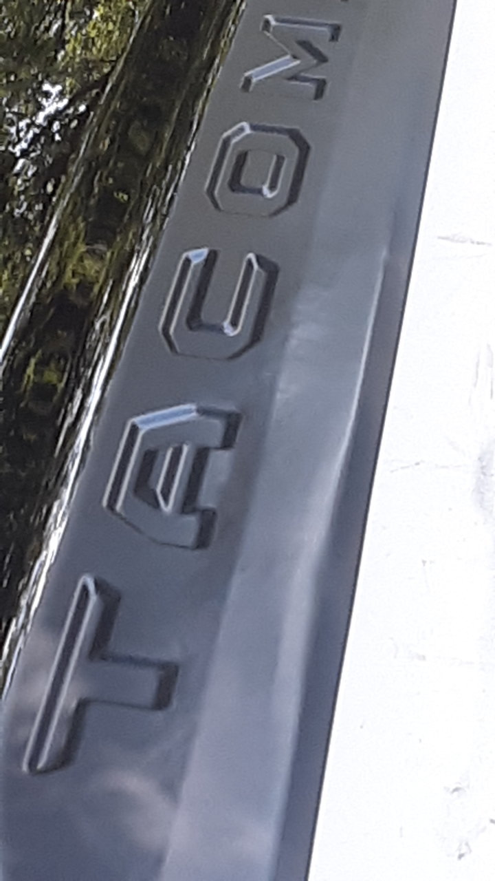

    Tough to see on black but the TAC area was dented and the bottom of the tailgate was folded under. There was hard line toward the bottom that was completely gone as well -- making this line again was problematic because the metal was stretched. I told the PDR guy to do his best.. I was hopeful for a better outcome, but I kinda knew it was gonna be an eyesore... you could see ripples and it was still a bit bent at the bottom. But I was appraised of the fact that it wasn't going to be 100% repair. I really didn't take pics, but let's just say it was something I probably could have just left alone. I decided to minimize the ripple effect by ...... yes....... using DERP:confused:. I figured a satin finish would hide some of the wavyness that was apparent in sunlight. Here's some pics... I did as little Derping as I could. Thick and steady coats to get a satin sheen.
    Heres some hyper focused pics.. you can still make out the ripples from the PDR as well as the bent portion of the bottom. What ashame it couldn't be 100% repaired with a PDR..

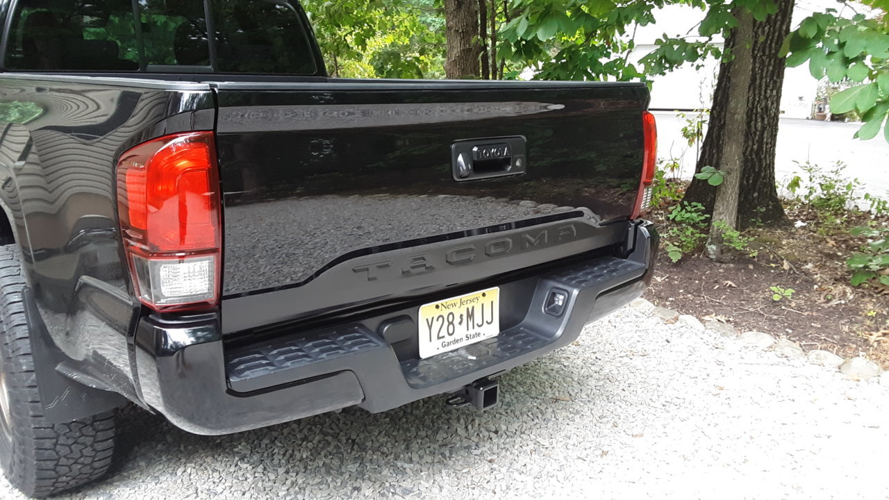

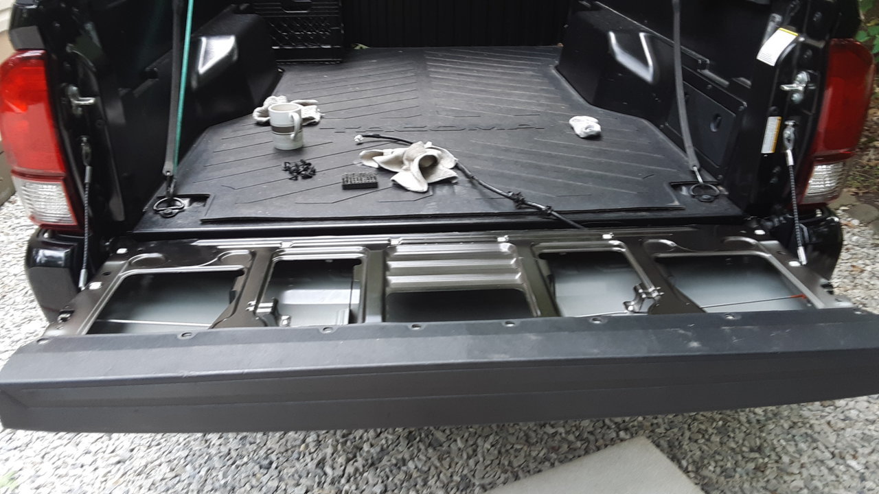

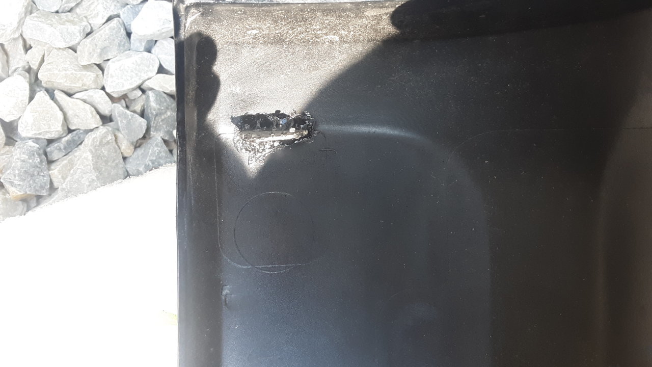

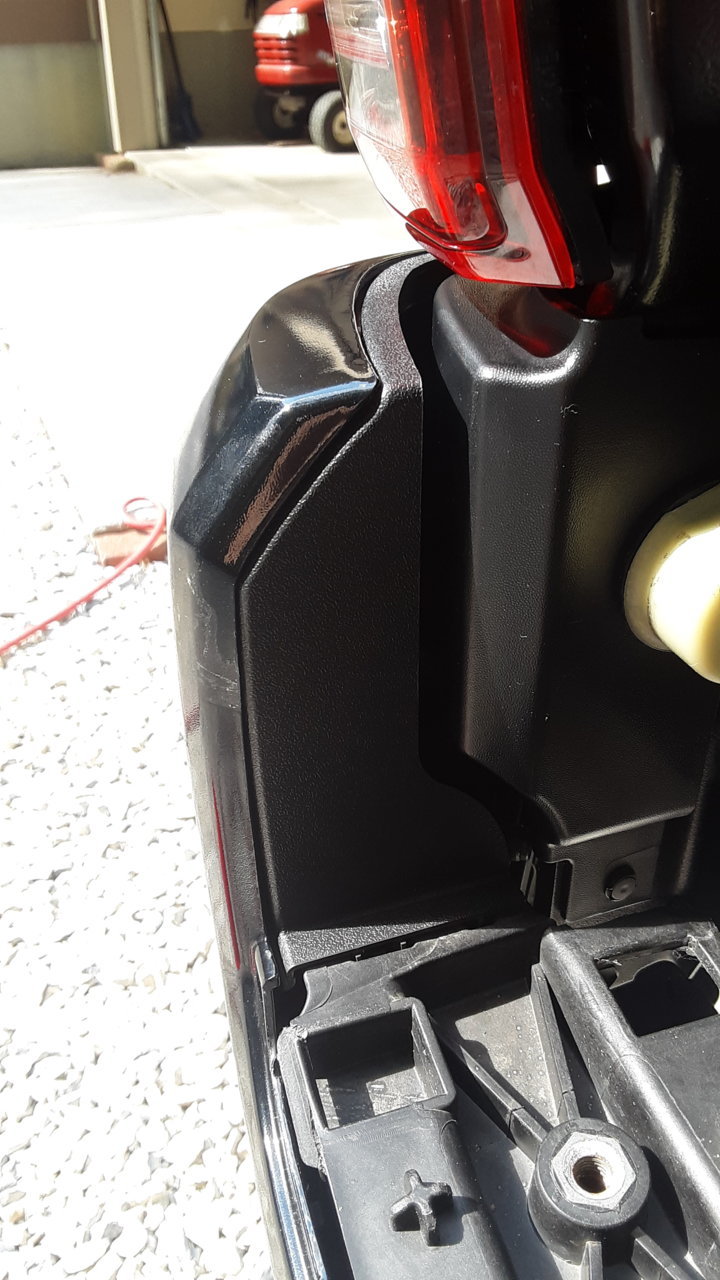

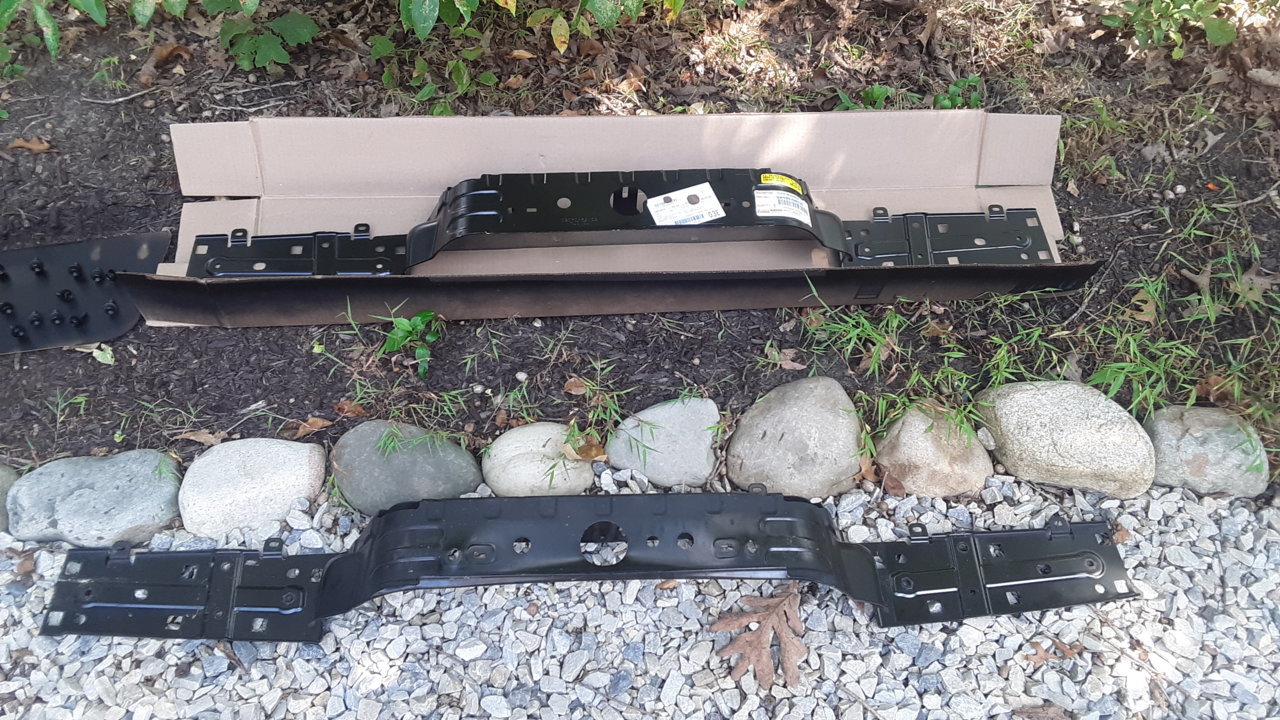

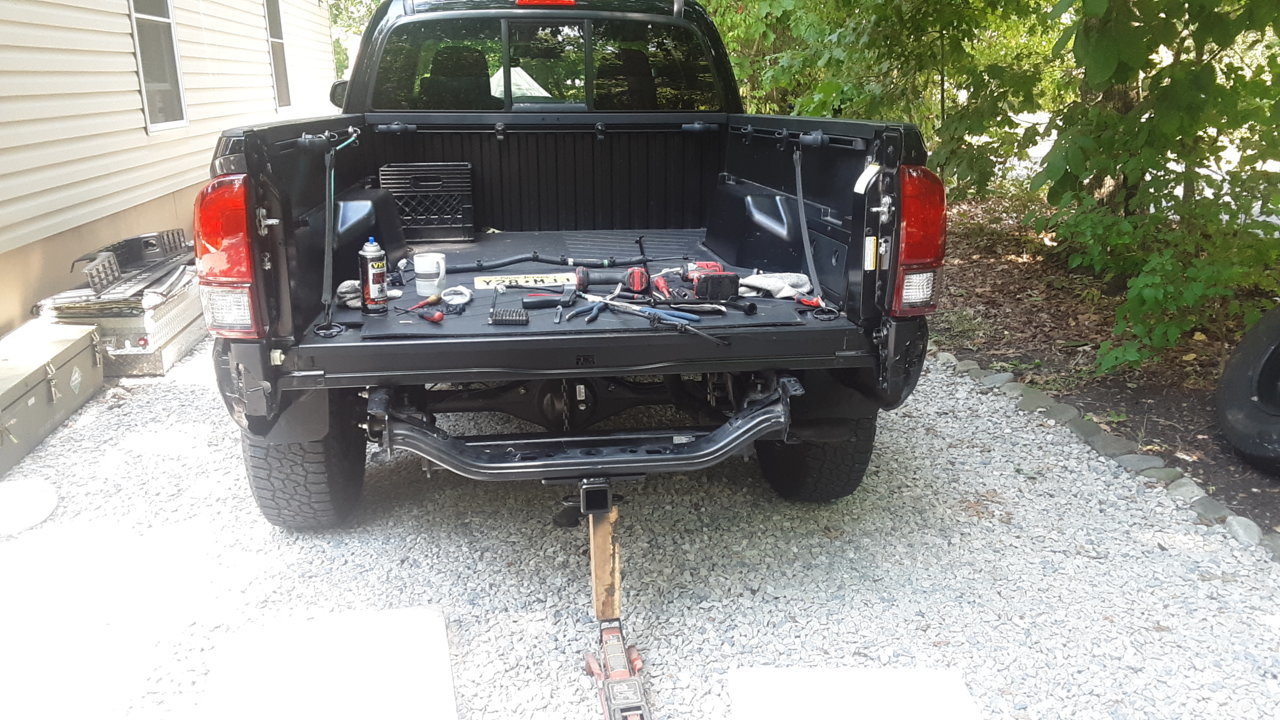

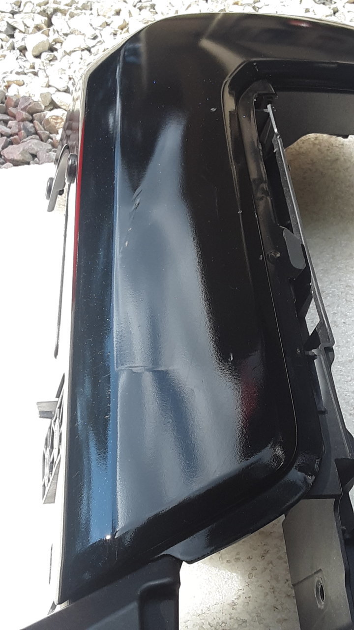

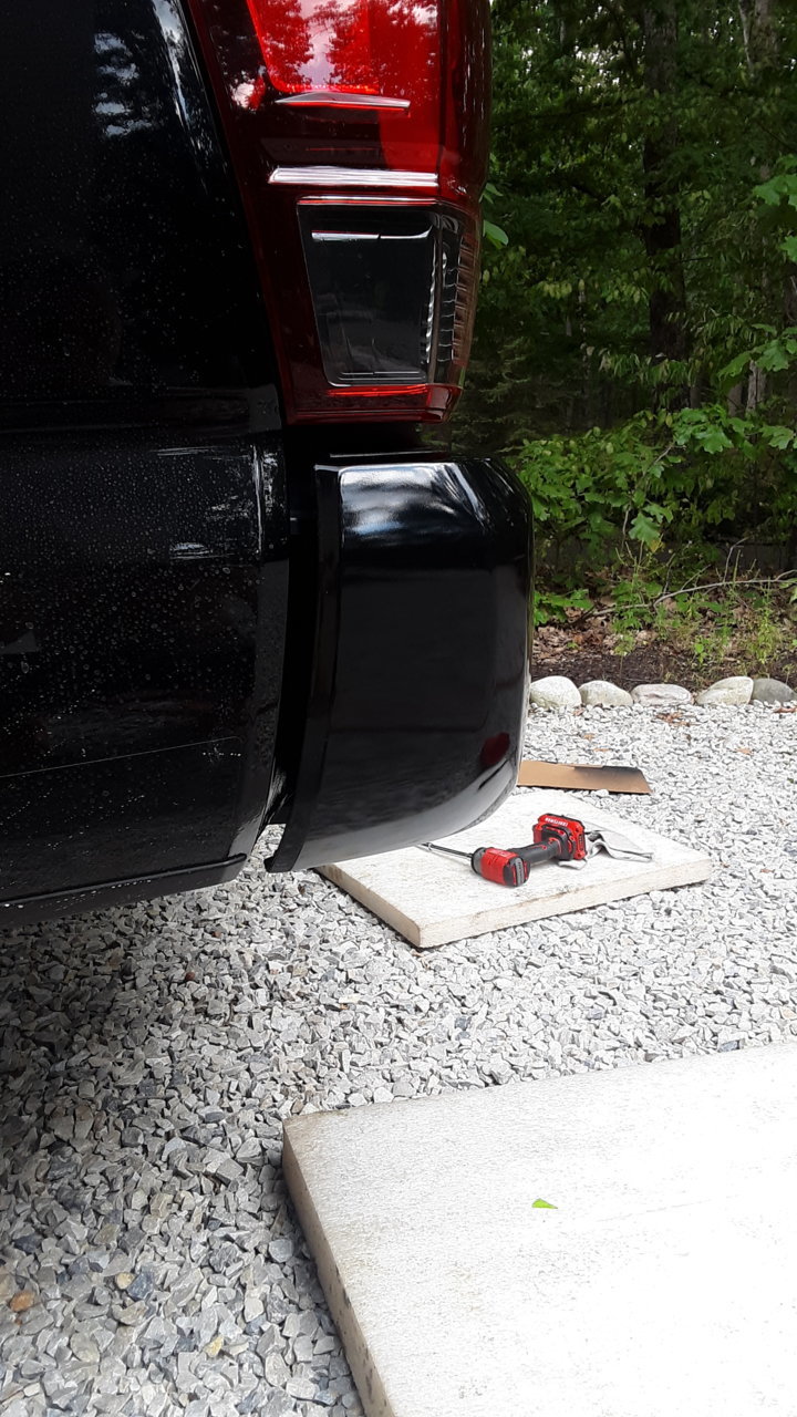

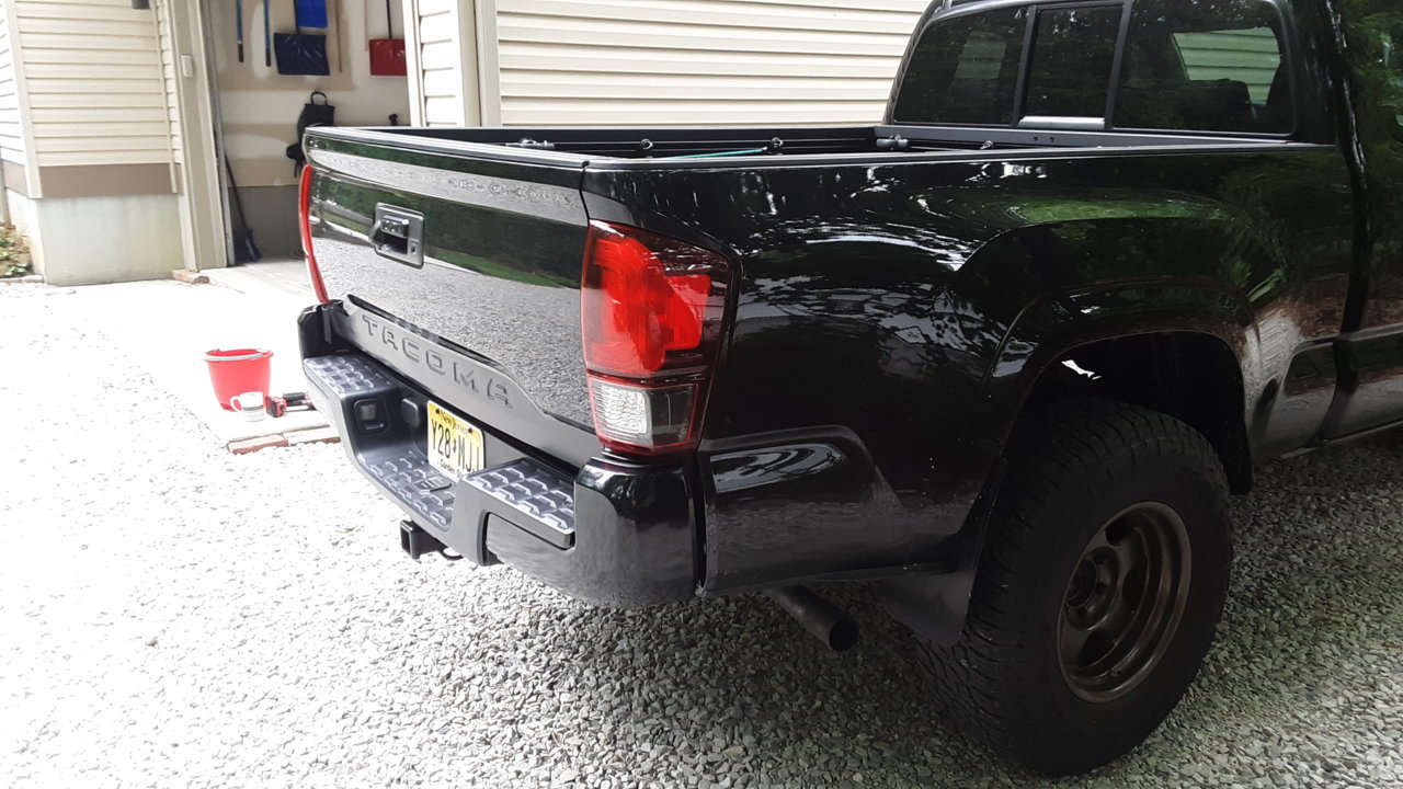

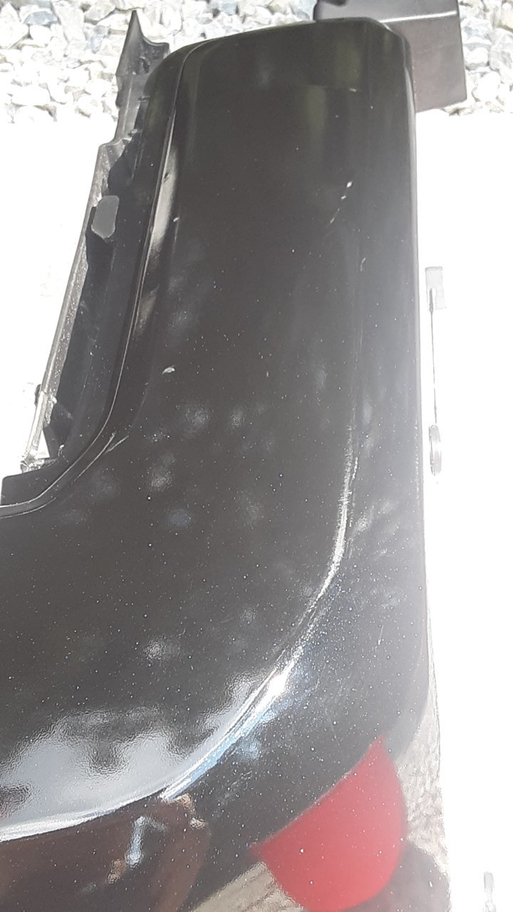

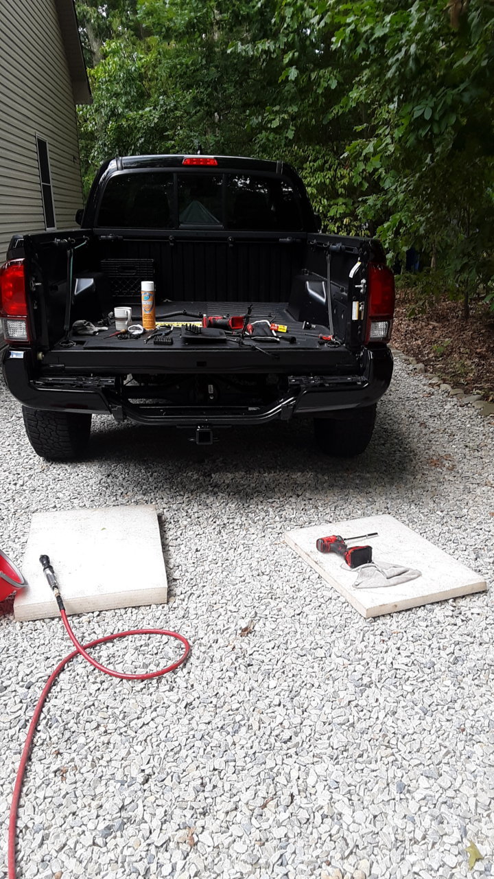

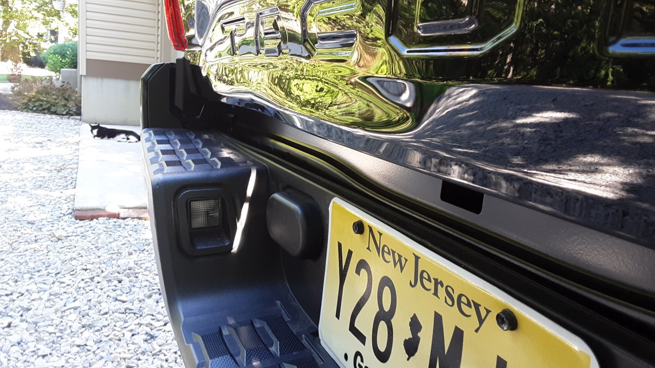

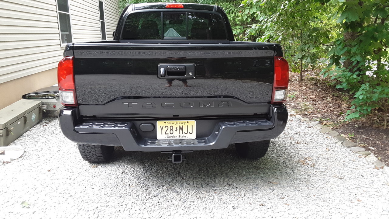

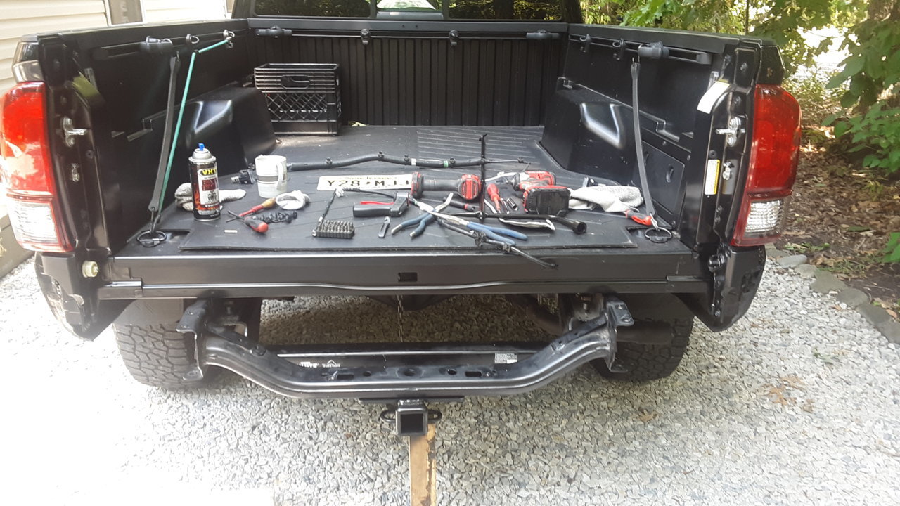

    The 2nd part of my repair was the bumper... again I knew going in that this wasn't gonna be 100%. The drivers side bumper corner has some missing paint and some creasing.
    Likewise, the plastic step pad had some marring.
    I decided I was going to live with these minor cosmetic problems. It's not going to cause rust, its hardly noticeable (especially on black), it gets stepped on, it's a bumper......shit happens.
    I also decided that I WOULD NOT live with the saggy diaper bumper....
    I've had some form of Tacoma for a while now.. I'm no stranger to bumper replacement. I've done a couple rears as well as a front... so how hard could this one be??? After laying underneath for a little while on some thick foam pads. I figured out these bumpers are about 7 major pieces held on by a variety of clips and screws I bought the piece I knew was bent which is cheap and not really much of a bumper...OEM as always...not worth trying to save a few bucks for crappy fitment
    You can see here the old one was pretty tweaked. Trying to straighten this wasn't worth the hassle. I don't have any pictures of taking this all apart, mainly because shit was bent and it took me a while to remove all the plastic crap without loosing the precious clips.. here it is going back together.

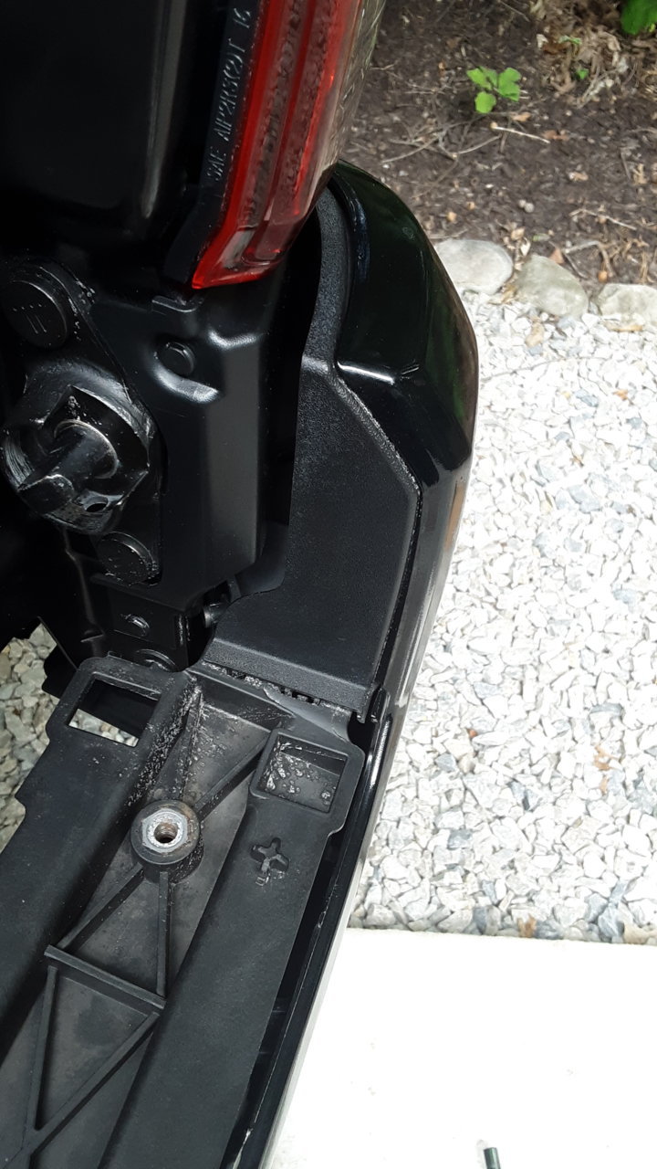

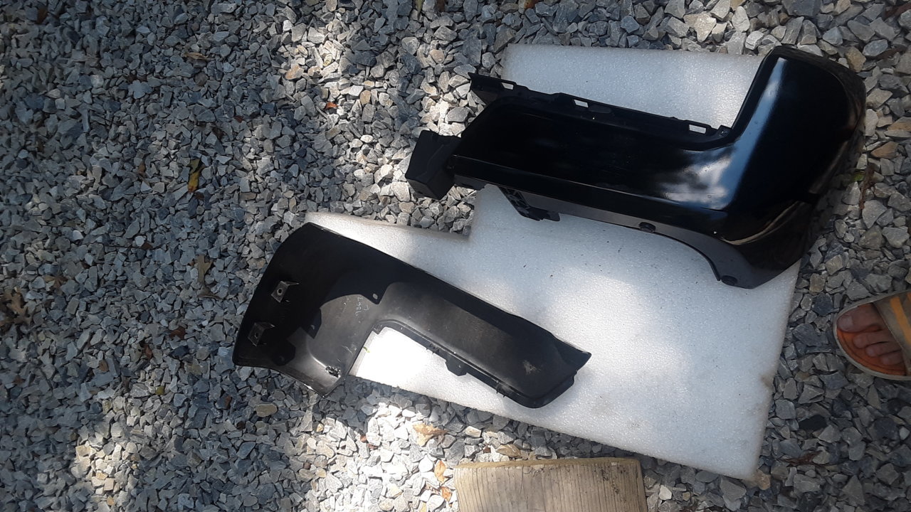

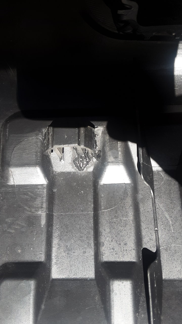

    1. Saving one of the mashed clips on the bumper step pad with some super glue gel
    2. Removing the driver side bumper cover revealed the alligator clip tounge was busted... more super glue gel
    Heres the part drying

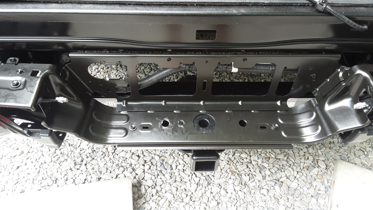

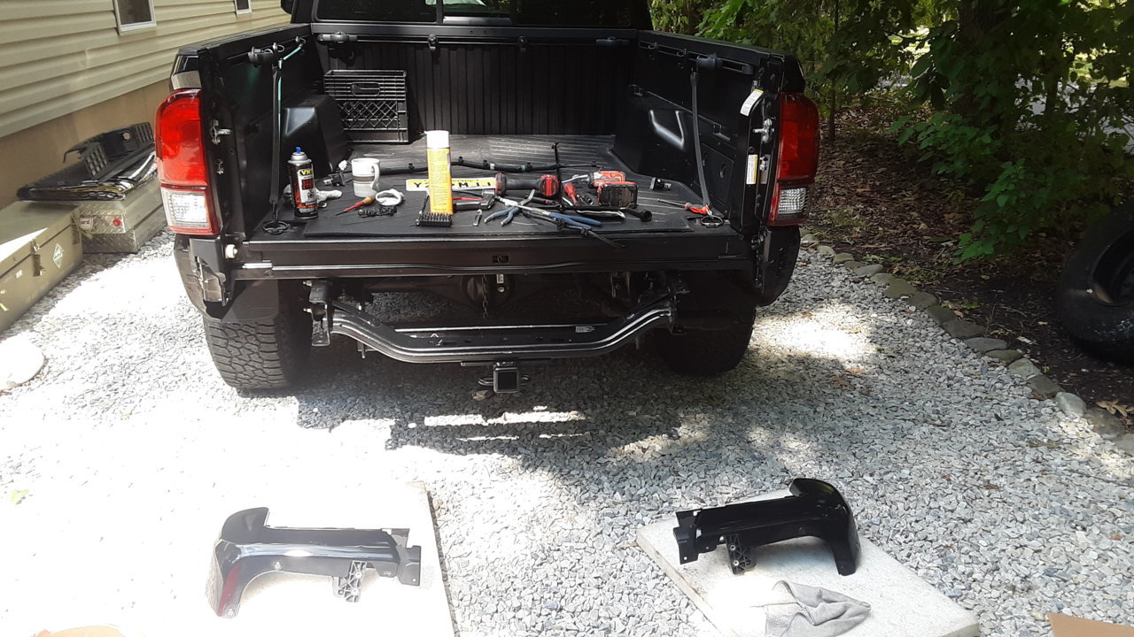

    3. I loosened up all 6 bolts to my receiver and all 6 bolts that hold the bumper support to the frame. Heres a good shot of what I would call the actual bumper.. this got tweaked downward. I used an old jack and a block of wood to support the bumper and receiver. Once I got things all lined up I tightened the 6 bolts for the bumper support followed by the 6 for the receiver. There was quite a bit of room for movement upward which was going to fix the saggy diaper.
    4. Bumper wings cleaned up, repaired, clips all secured and ready to go back

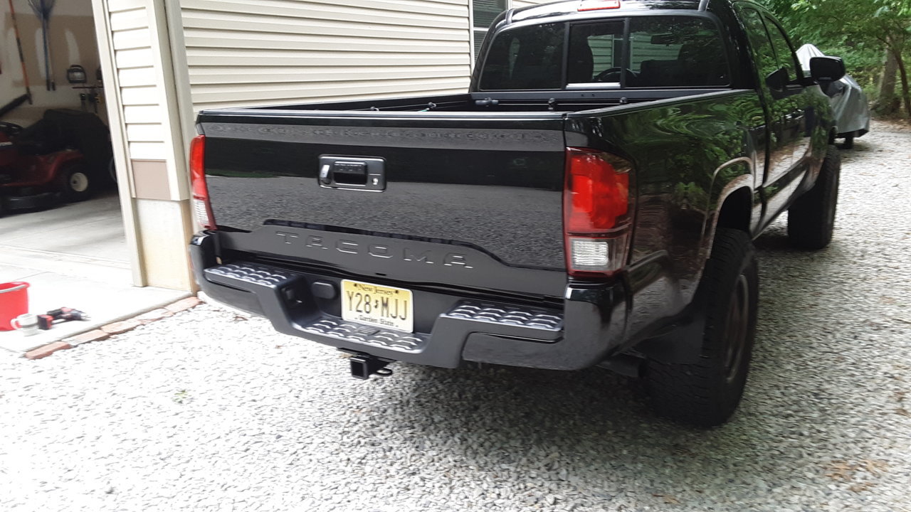

    And bolted up......

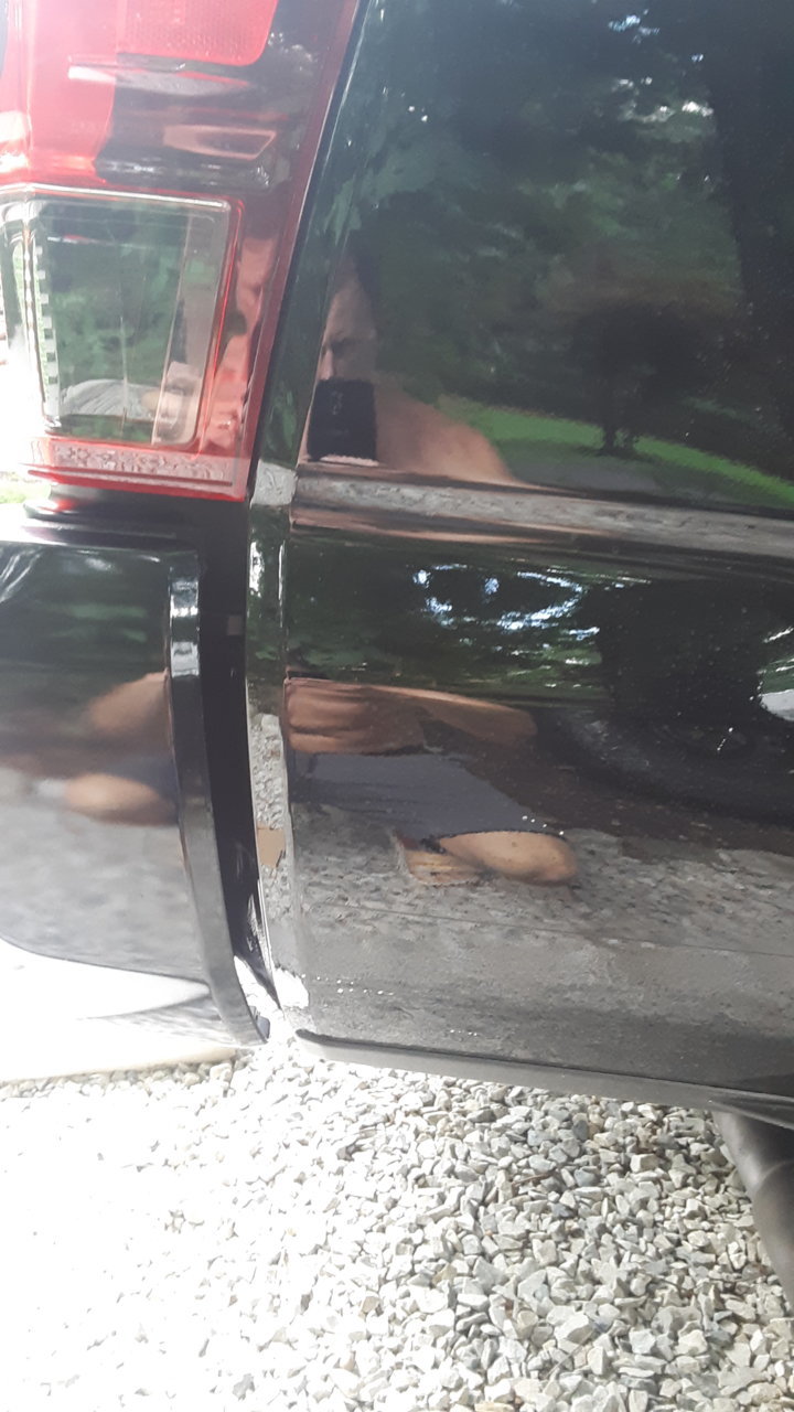

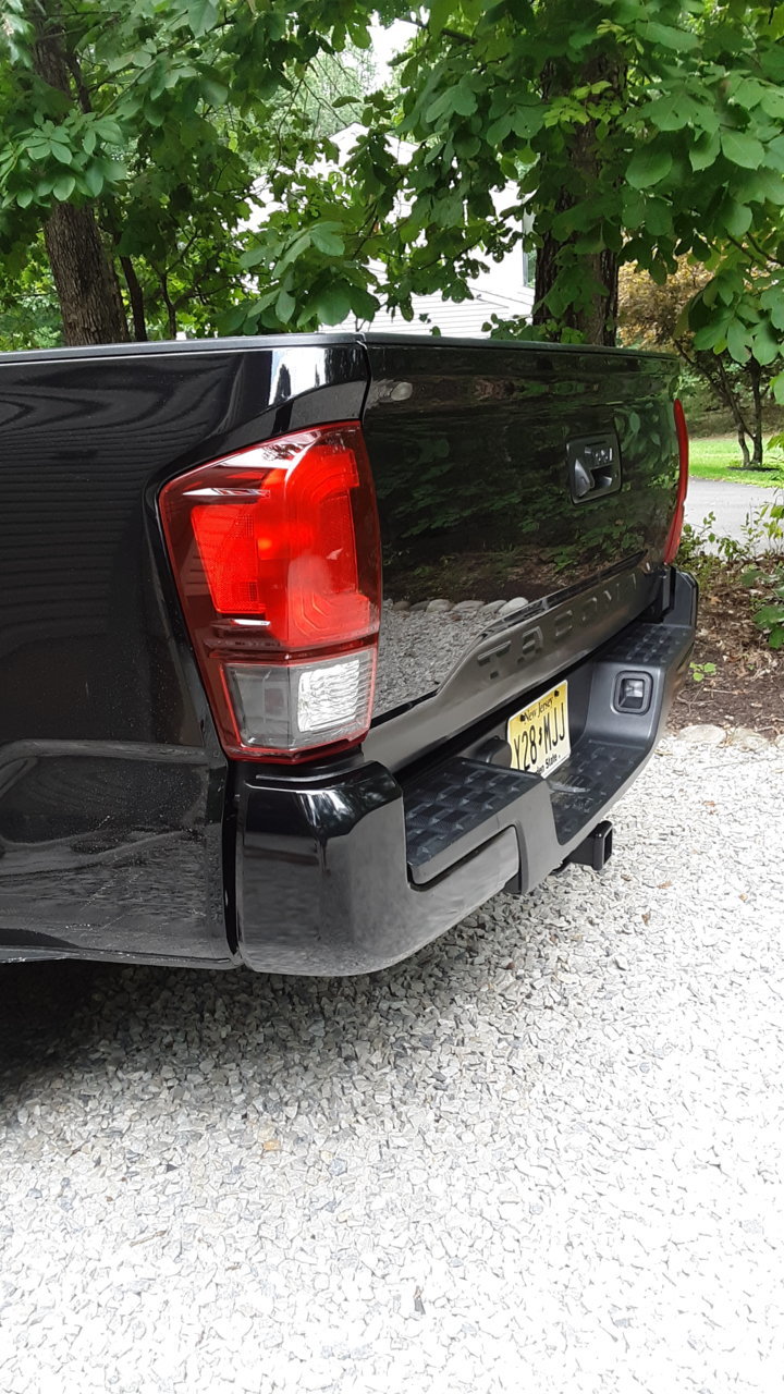

    Gaps are looking good.. high and tight.
    Not perfect on the bed sides, but still damn close. Much better than the 3 finger gap I had on the passenger side. This is pretty good.

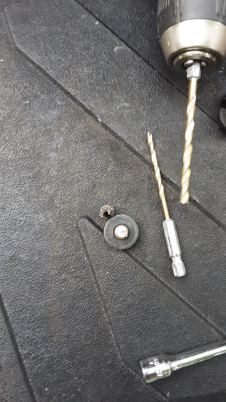

    .......What fun would working on your TACO be without breaking bolts... this one must have gotten weakened from the accident. The top just broke clean off... no rust, so it wasn't horrible... had to drill it out.
    Luckily since I've had some form of Toyota since 2002, I had the right bolt and thread pattern laying in a parts bin.. no additional trip to the parts department necessary.

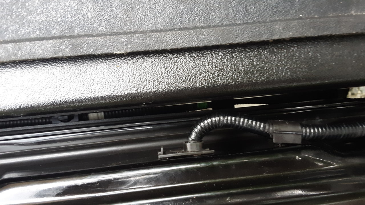

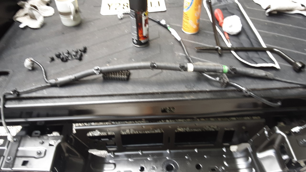

    5. Wiring harness cleaned up
    And all clipped back in

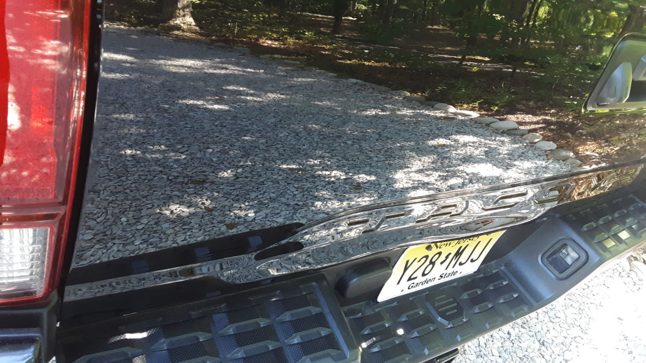

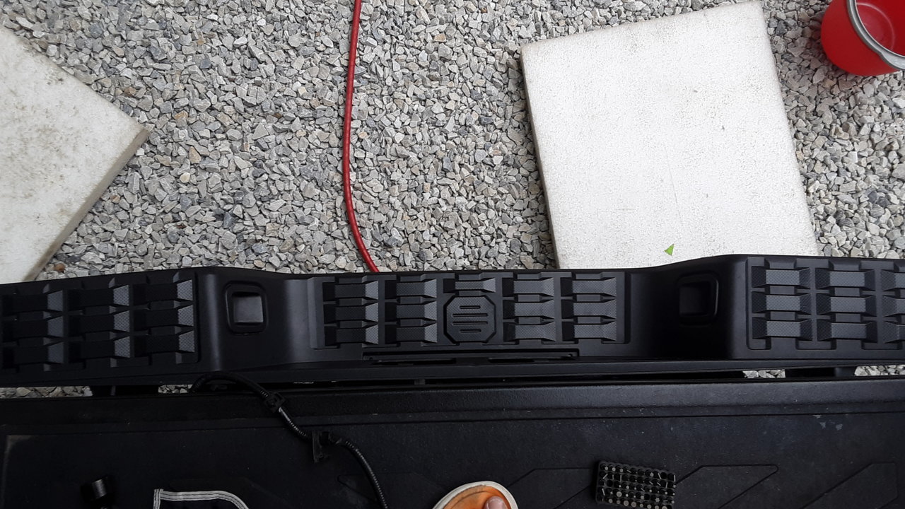

    6.Step pad all aligned and pushed back into place.
    Looking nice and straight compared to after the accident.. nice

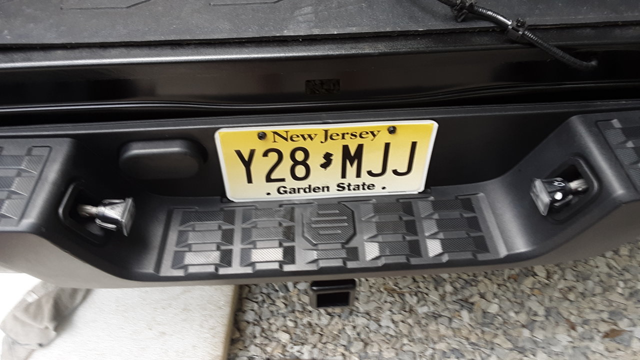

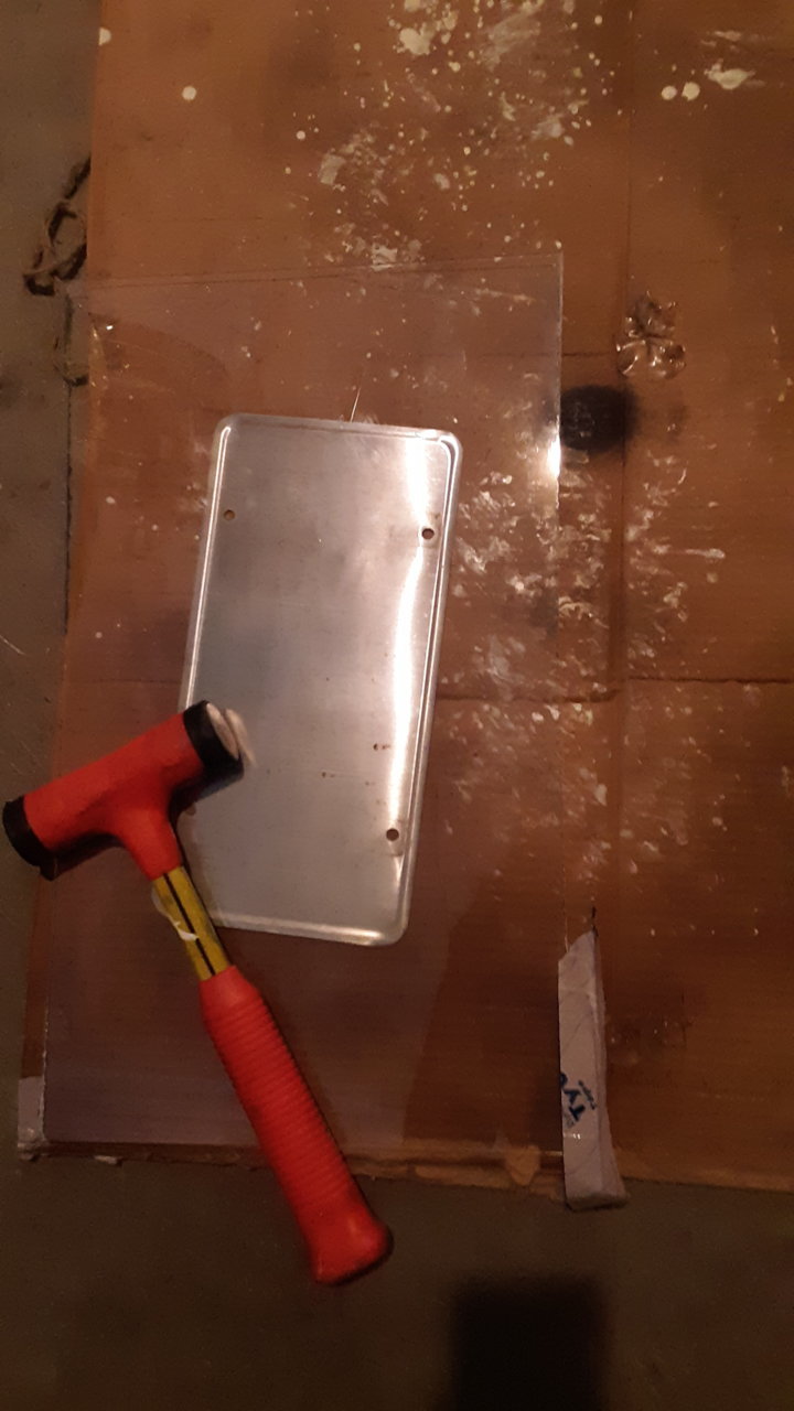

    7. Straighten that license plate. Sandwich the tag between a spare piece of plexi glass and cardboard and beat it with a dead blow hammer

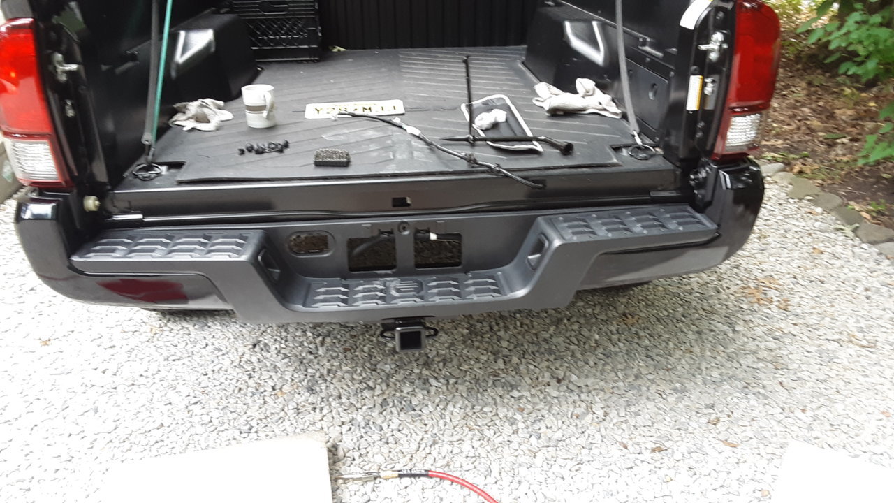

    8. Plate back on along with all the remaining bumper plastic clips, the tow hitch wiring harness blank, and the tag lights.
    9. Tailgate (see post https://www.tacomaworld.com/threads/the-sr-thread-lets-see-them.411453/page-366#post-27750886 ) back on
    10. Reattaching the camera wiring harness
    11. Hatch all buttoned up.

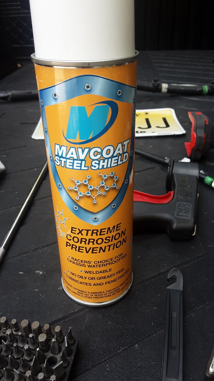

    12. Prevent rust... it sucks.... ounce of prevention. I hit everything metal with this while it was apart. Even inside of the tailgate as it was drilled in a couple of places to get the dents out.
