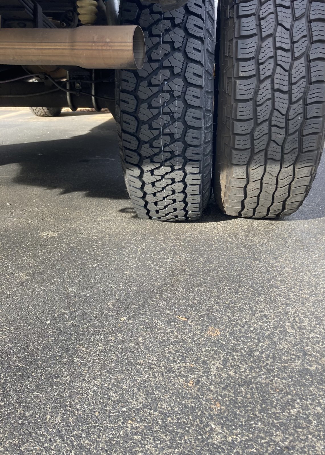

    Honestly great this was my first E rated tire and it’s as quiet and comfortable as my last cooper at3 4s. I know E rated tires are known to be a harsh ride but not these Firestone XTs. Cornering is not as sharp but how the truck feels on the accelerator under load is the trade off. Truck feels significantly better with the skinny it was like walking around with heavy boots and then putting on some sandals. The trade off is slightly worse cornering but it’s a lifted truck. Mpg on my short distances have been up 2-3 a big difference which I’m not surprised since I’m less into the throttle. I will be sticking with this tire size from now on. There’s a reason why skinny 33s are popular as well less rolling resistance is felt. Funny thing is this E rated skinny is 1lb less than my previous 265/75 so weight is negligible the difference is all felt from rolling resistance.

    Picture of the old cooper vs the skinny

    Awesome thanks! Good to know. I drive slow, so cornering isn’t a huge issue.

    I love that 235 look. I’m running 245’s on the geolander, but because it was the same size tire that came on the factory steelies. I remember the tire shop guy questioning my choice.
    The army used to put skinnies on the jeeps for a reason.

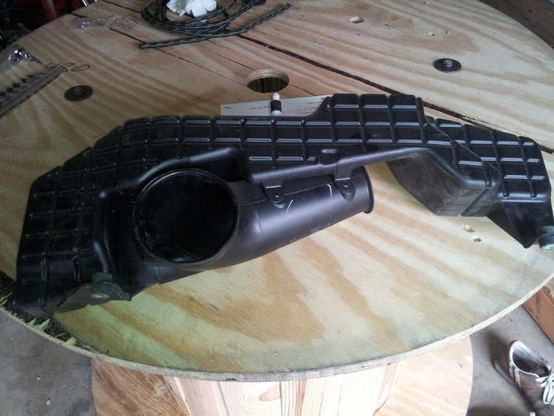

    Tune wakes up the truck especially since you have a header won’t be disappointed. The guys at OTT are actually coming out with an update on the 2.7 tune with some good changes so I would wait until then. I also removed the charcoal filter in the top of the air box. There is an intake elbow in the fender well I pulled as well. That and added the trd accelerator on the end of the box instead. Those were two cheap easy mods. Did it add power who knows probably not much but it’s smoother throughout the rev range. I would recommend that as well here’s a picture of the giant elbow in the fender well that attaches to the air box. It’s only on the 2.7 my best guess is it’s for noise. I didint notice any additional noise it’s not like the 2TR-FE is a quiet engine to begin with. I have an afe drop in too

    Have you noticed more debris in the air box with the “fendertake” removed? I’ll wait on the upgraded tune after a few folks test it out first.

    No extra debris in the box I pop the filter out every few months for a quick smack cleaning.

    Well hey .... If you all have all those mods you might as well throw in the air accelerator. Id imagine it won't do much being as you already did the bigger upgrades for breathing. Elimination of that plastic elbow in the fender may feed a bit more air? This is on my list of things to do .. the v6 doesn't have that goofy elbow

    I didn’t realize it had that massive box in the fender, yikes. Haven’t taken that apart yet. I wonder what the engineering behind that is for? Maybe to keep rodents out, or a moisture barrier?

    I really think it’s noise just need to pop a few fender liner clips and it’s right there very easy to do id suggest pulling the tire just gives more room to get the pesky clips
