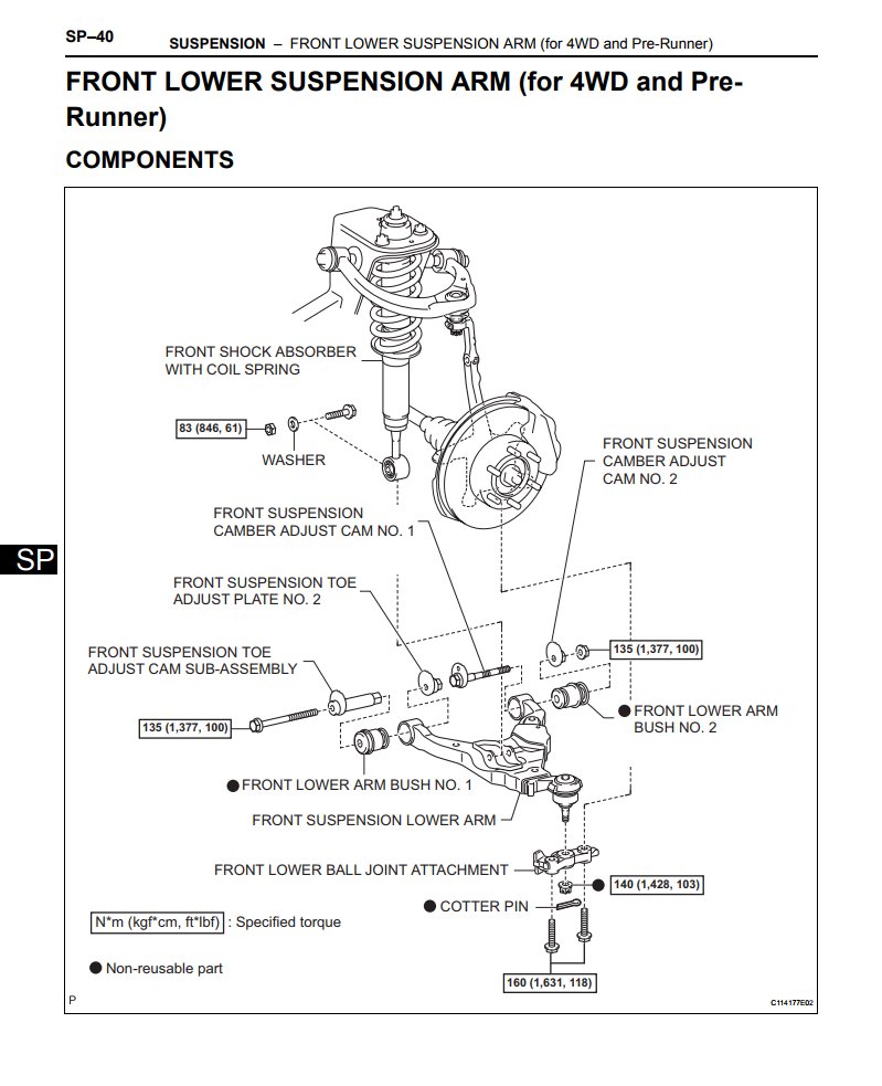

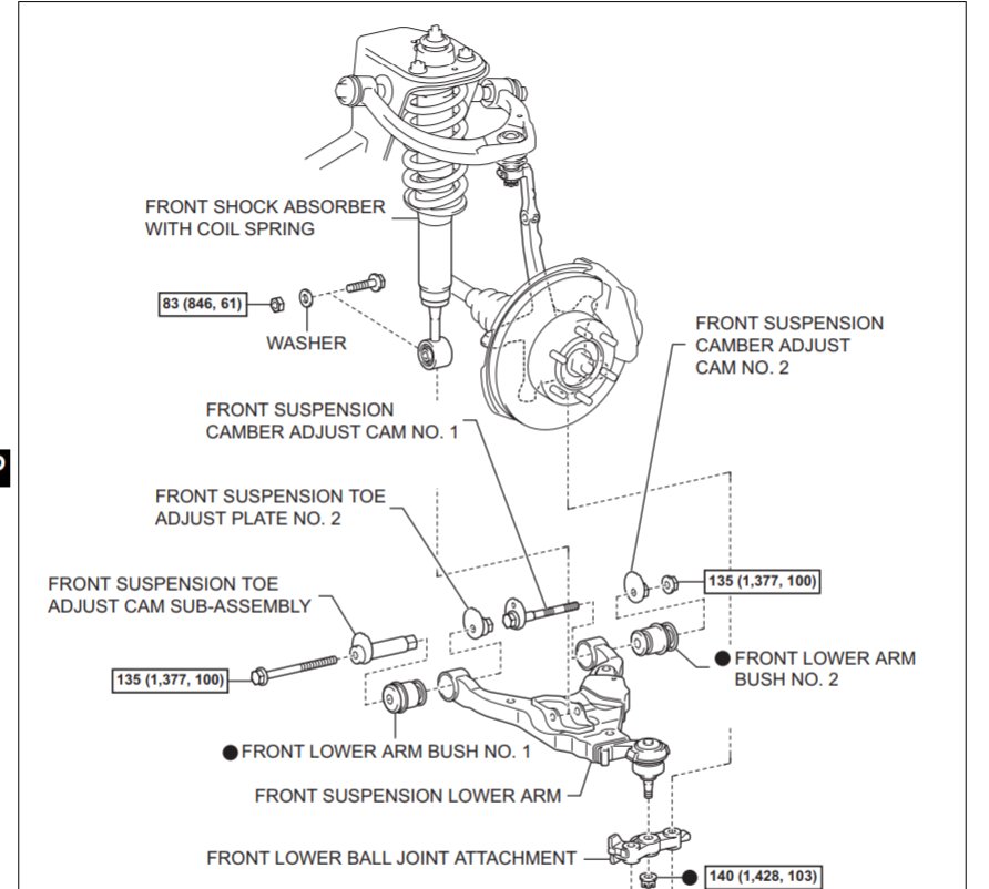

    Do you have a 5 lug? If so, the above diagram is fine. But if you have a prerunner or 4x4, then yes I'm sure.

    FSM attached

    What you are looking at is the diagram for the 5 lug trucks....
    here is the 6 lug. note 100 ftlbs.

    Hahaha dam thanks!! Will adjust asap

    Good news is I haven't driven it since alignment except to get home. So I'll set to 100. Didn't even realize I was looking at the wrong one. Thanks everyone
