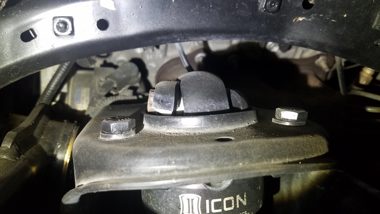

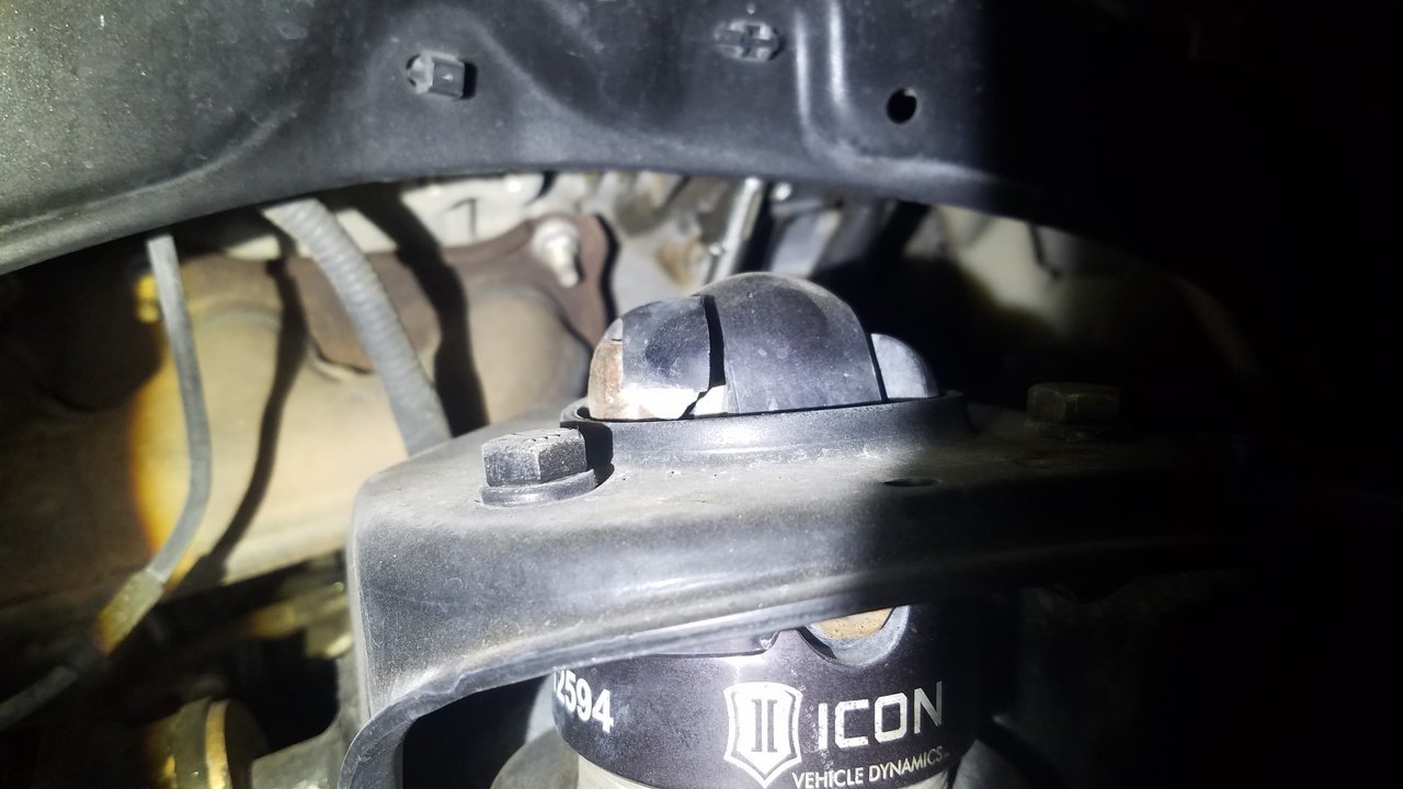

    Hindsight is 20/20 of course, but it seems like your heavily loaded rear bumper may have contributed to the frame buckling over the bump stops. Weight plus leverage. I never would have thought of that until I saw your pictures.

    Mind if I ask how much preload you have dialed into these coilovers?

    Thats the first question Icon asked when I called for replacement top plates. The passenger side has none at all and the driver has about an inch to compensate for taco lean. The lift all comes from the spindles which is 4". I think the bumps just werent enough. The UCAs went up into the wheel well and took a nice chunk out of it. I think bettee bumps and higher spring rate to compensate for the weight up front could have prevented those from breaking

    Thanks for that. I wound up having to go to 14"-700lb springs on mine when I hit the maximum allowable preload (2.13" exposed threads per Icon) with standard springs. I like to play in the desert and pay attention when I see threads like this. Hate to see all that damage.
