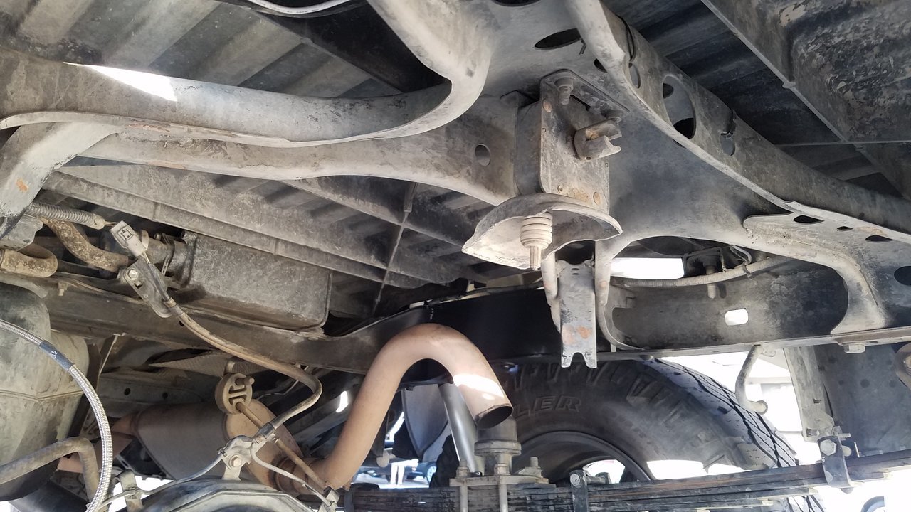

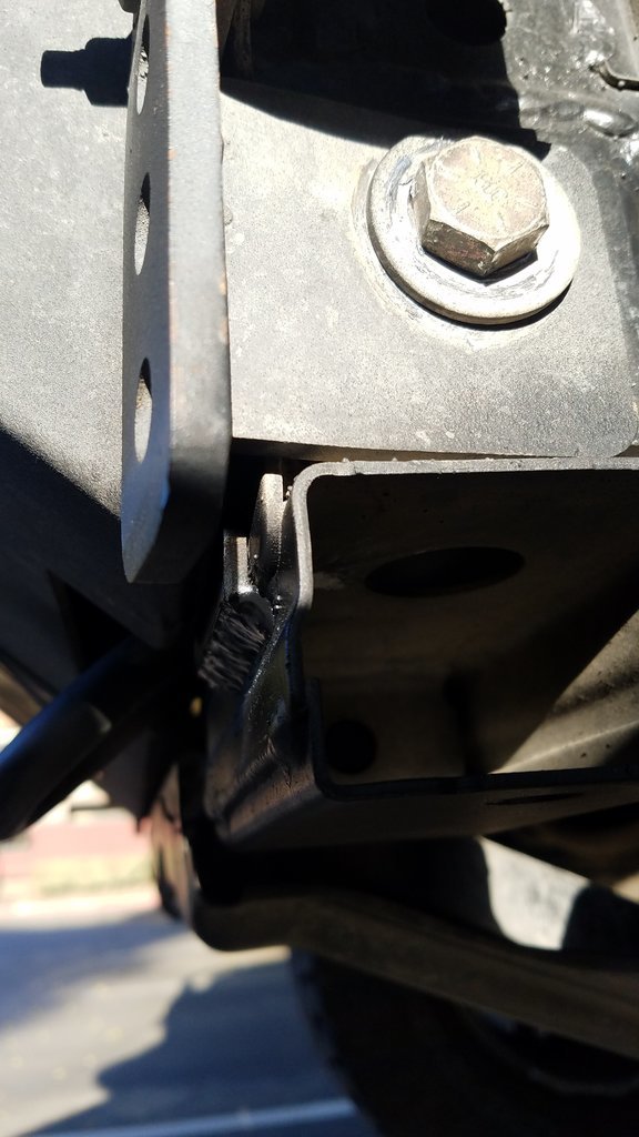

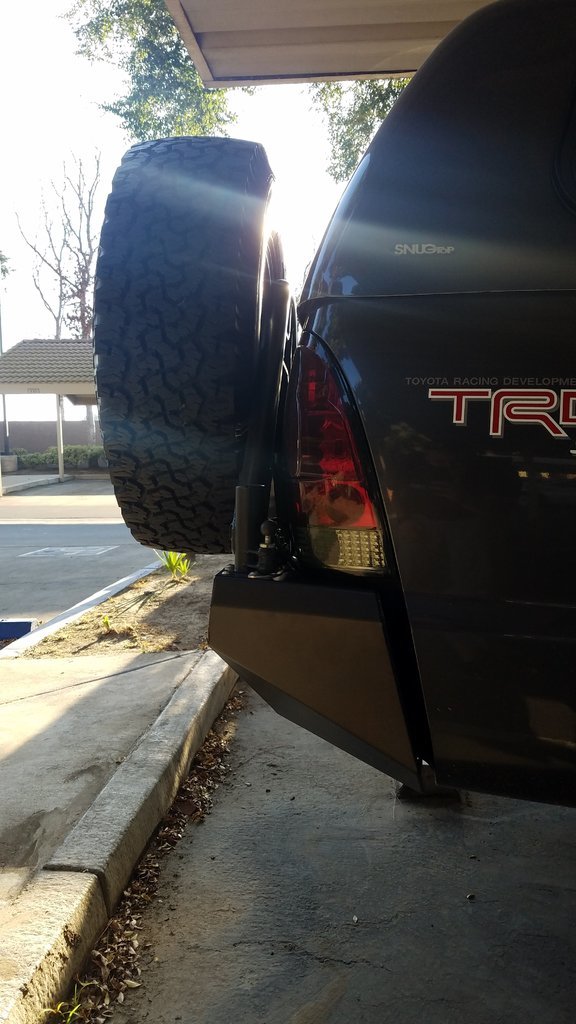

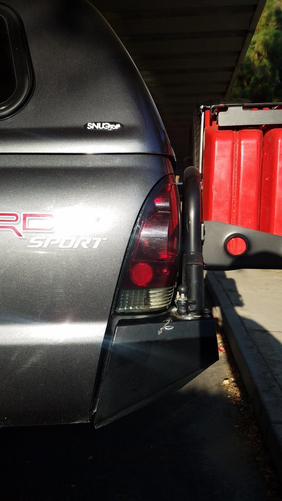

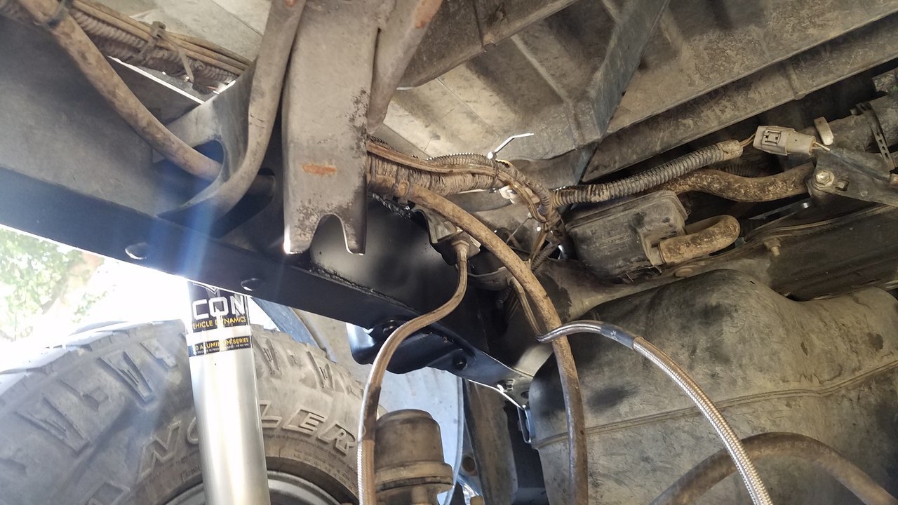

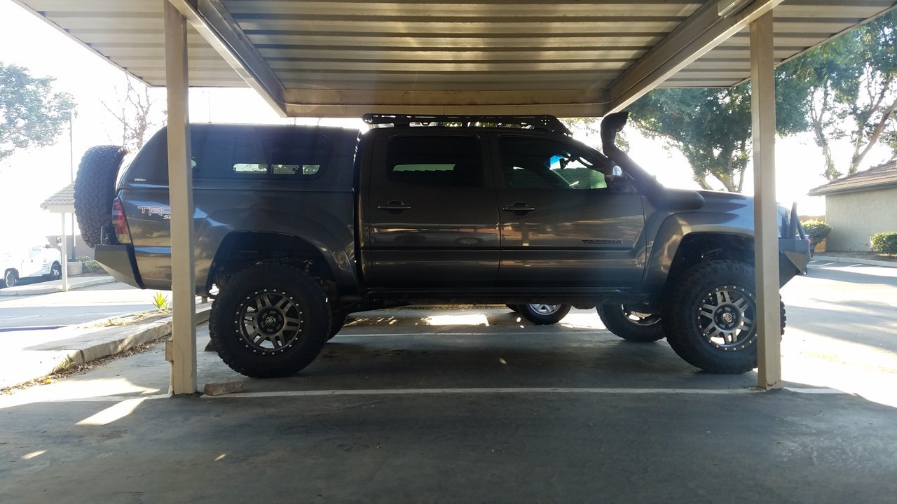

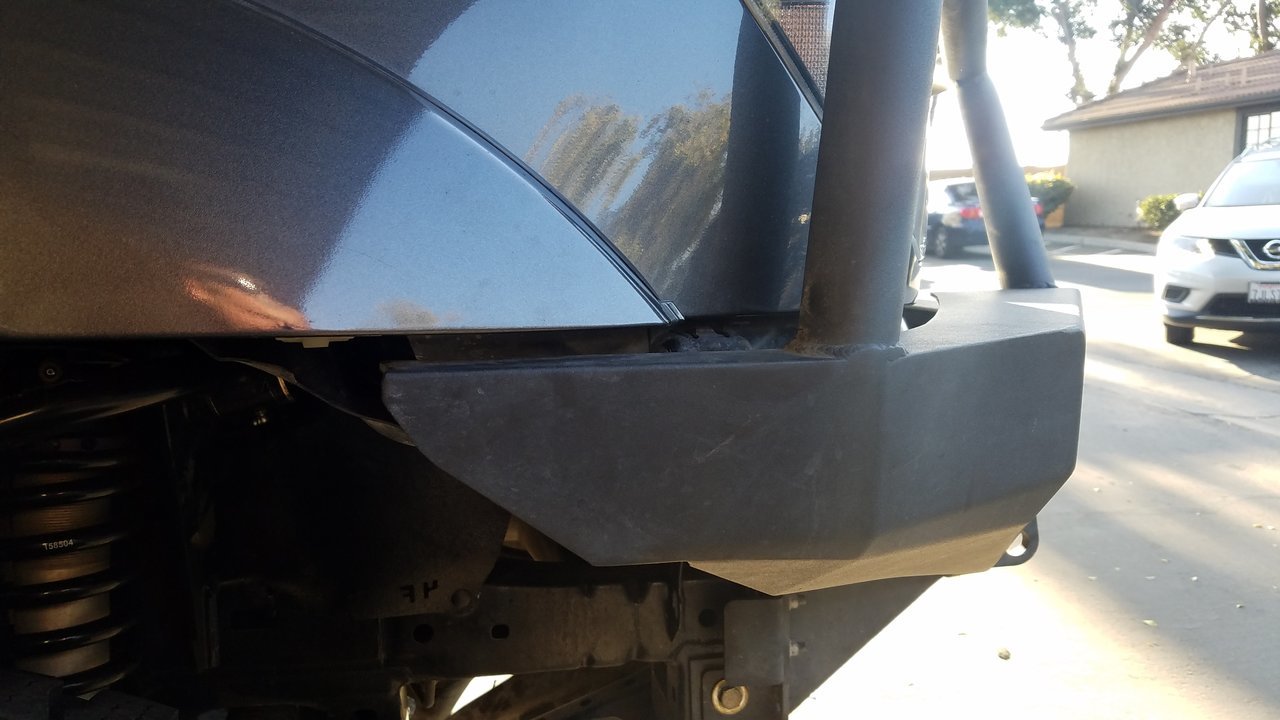

    She's all straight again!! Bent in 3 places. Front bumper pulled the frame horns down just a hair so that was pushed back up and reinforced with some small plates to support the bumper. The spacers on my rear bumpstops were removed to allow more up travel to help avoid this again. The frame at the rear bumps was straightened amd squared. Also the weight of the rear tiregate pulled the back end of the frame down and caused a bad droop on the rear bumper. All that is straight and sqaure again. Rear frame was plated with 3/8" plates for major reinforcment. Additional holes were drilled in the frame to allow extra hardware for the hitch and bumper for more support from the weight and during towing and recoveries. Total cost was $900
    They gauged the rear axle and it is bent also. Driver side is negative 1.5° camber and passenger is negative 1.1° camber. Next weekend ill drop it back off at the same shop and they are going to get it back to 0° camber 0° toe. That'll be another $250 but its a hell of a lot better then replacing the whole housing.
    Pics coming later

    No more ripple

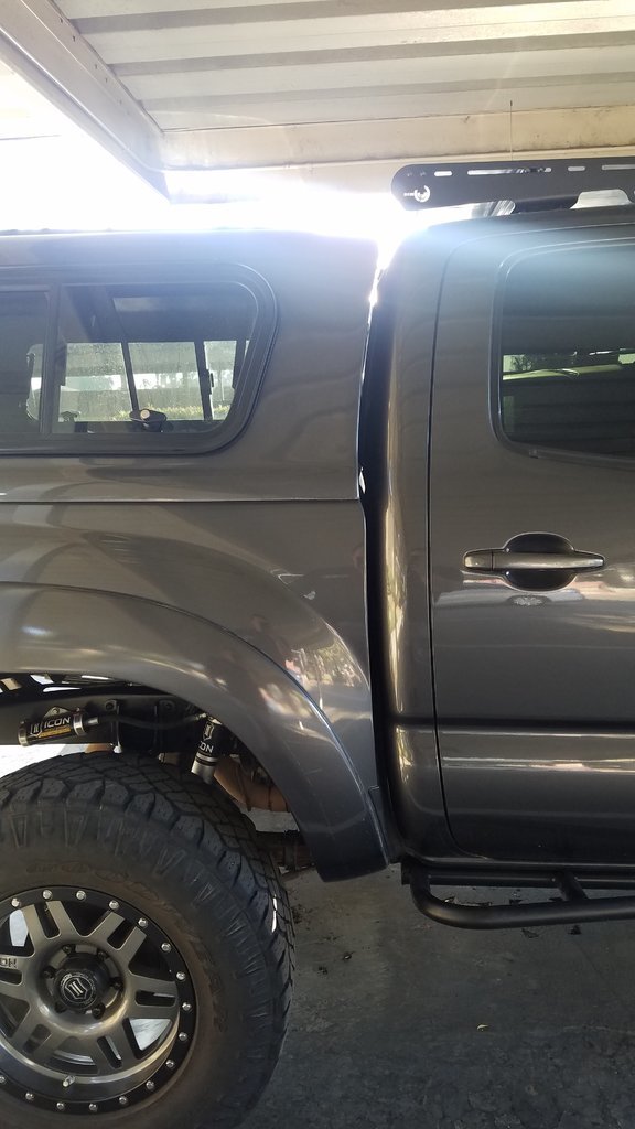

    Bumper is lined up to the body now without a gap
    Bed/cab gap is gone
    Front bumper is squared up and has propper gaps between the fender. Plate added on the frame horn where the bumper mounts to correct fitment and added support.

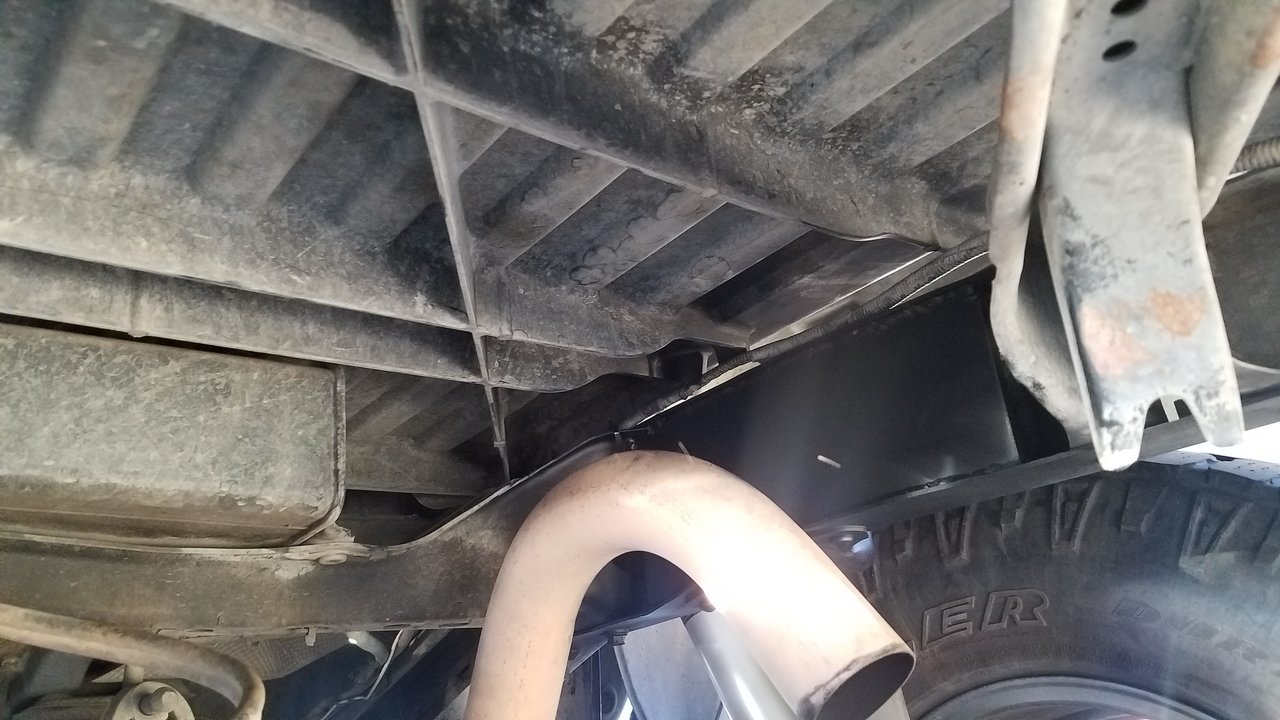

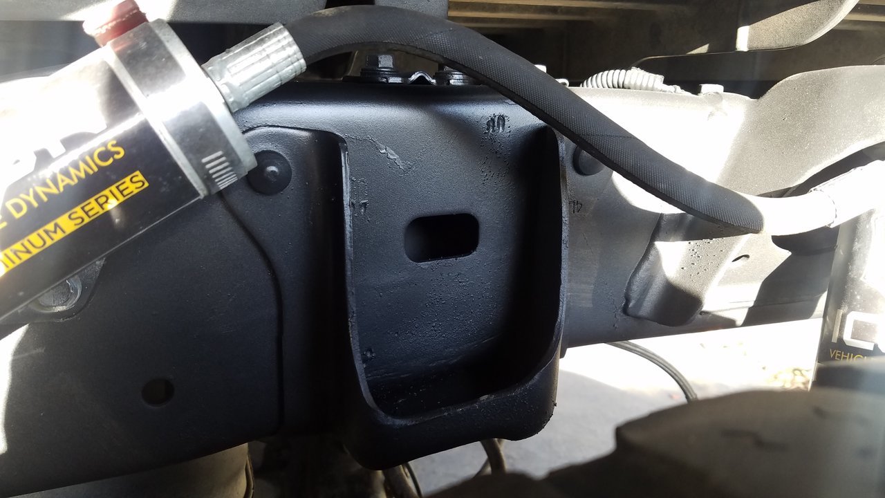

    About a 1.5 foot long plate added on the weak spot of the frame. Didnt go with a full plate as it is not necessary for how i drive. This was just an accident. Plate is 3/8th thick and recessed about 1/2"

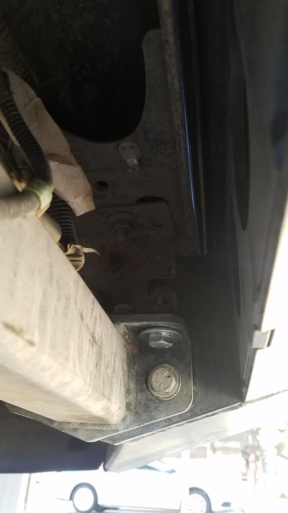

    Lastly, the AllPro hitch has holes where hardware is meant to go, but it doesnt match up to any holes on the frame. If i remember correctly it is there for the option of adding additional hardware but not required. Had the frame drilled and bolts added in those holes to have 4 bolts on each side instead of 3.
