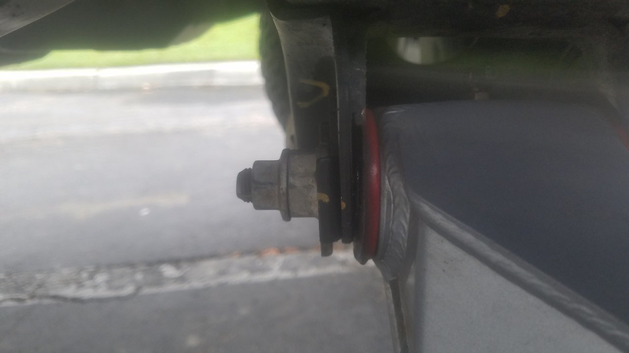

    Looks like you may have called it. Left my house this morning, slowly went over a speed bump and CLUNK!! :rant:
    Suddenly I notice a huge change in my alignment and when braking my truck pulls hard right.
    Pulled over to investigate and who woulda thought, dipshit left the LCA loose. Cam tab moved at least 1/4" and the nut was holding on by 3 threads. I could almost twist by hand. Luckly i had tools with nw and tightened it up.
    Have alignment scheduled for Thursday now

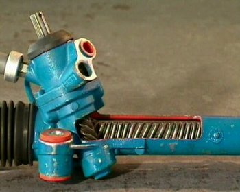

    Well the clunk wasn't the alignment. Had my alignment done and lca bolts torqued to 155 ft lbs. Also torqued the rack and pinion to the frame it was tight. Inner and outer tie rods are all 1 week old and no change after replacement. Seems to be coming from driver side or towards the center. It does not make any clunk above 10mph no matter how hard I drive it or what bumps I hit its solid when I'm driving. When I am going 0-10 mph it'll clunk when changing directions forward or reverse, when going over speed bumps or any imperfections in the road, or when at compete stop and I turn the wheel either direction.
    When stopped and I slowly and gently turn the wheel, the steering wheel will "skip" like 1/2" during the clunk like it's binding up. It's only does it once when you first start turning the wheel then won't do it again. It's worse turning right but still does it turning left. Doesn't matter what position the steering wheel is in either.
    Every indication points to an issue with the steering component but when I replaced tie rods the rack feels solid with no play, leaks or signs of damage. Unless it's an internal failure of a bushing. I could also suspect lower uniball, as my upper uniball are also brand new just replaced and it didn't change. Also wheel bearing or body mounts. But all of these things would or should show symptoms during driving also. That's my key is finding what has enough force during driving that would supress the issue completly. I don't know how the internal of a steering rack work... could there be a change when the car isn't moving?

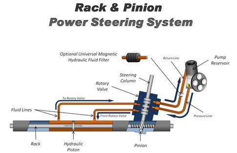

    there could be the slightest possibility that there is damage to the worm gear inside the rack and pinion.

  16. Oct 6, 2017 at 9:26 AM

    ProForce

    Thanks for this. Need to get down there with a second person to help pinpoint the source I think

    Just FYI, LCA bolt torque is 100 ft lbs, not 155. Your bushings are not gonna be happy at 155.

    fak, that looks bad
