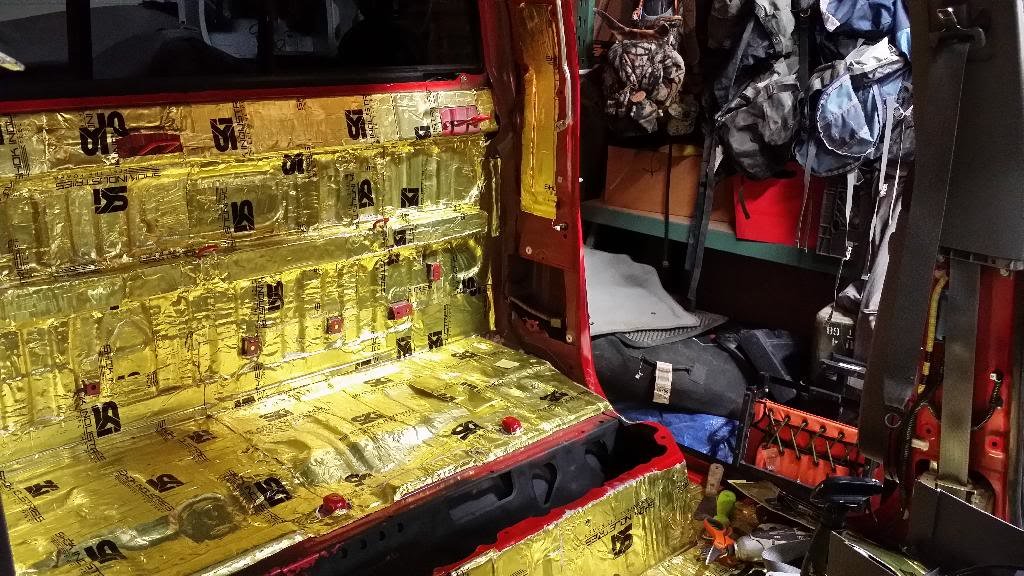

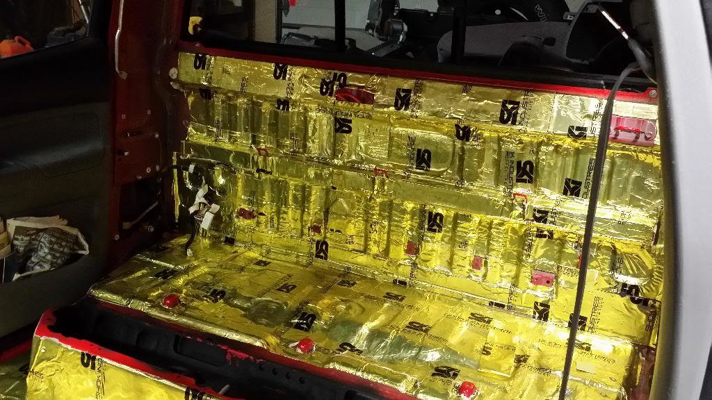

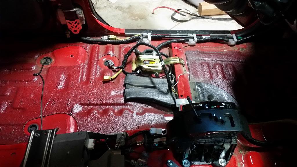

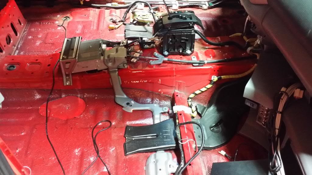

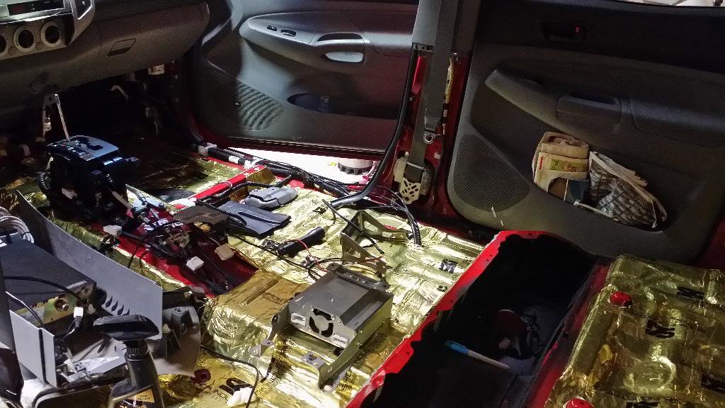

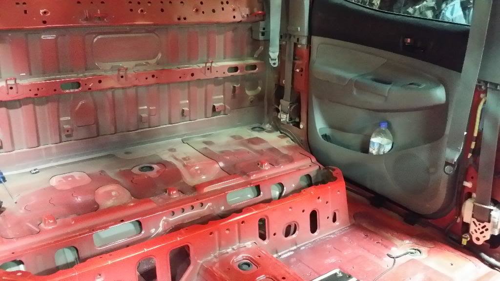

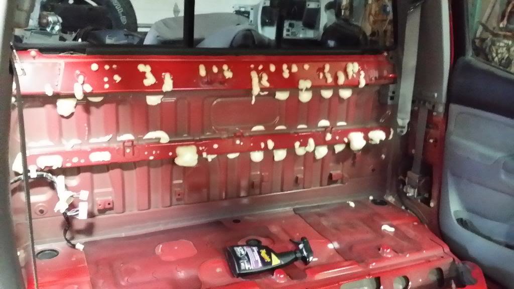

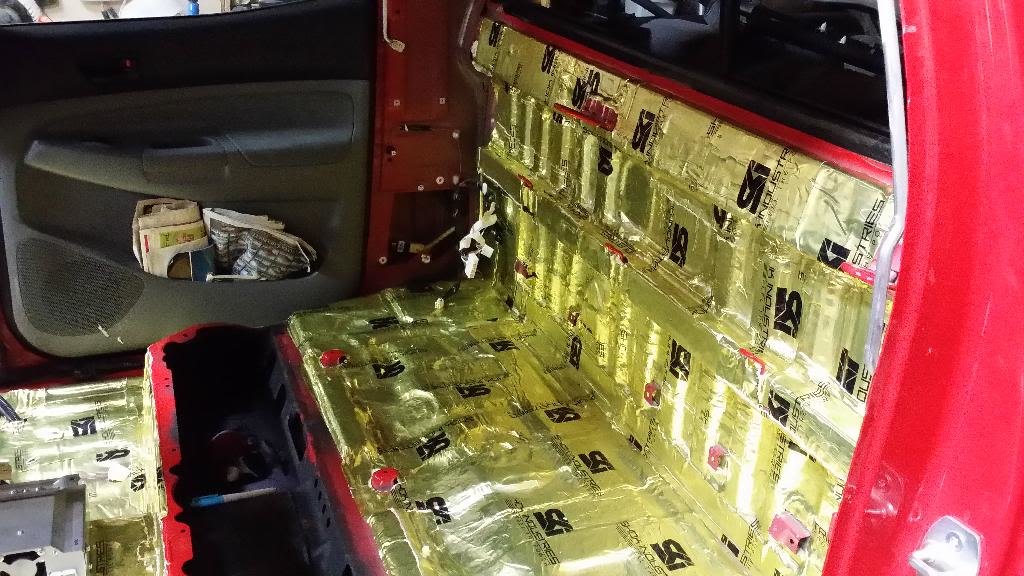

    Well that was a PIA! I'm not sure I would recommend this project, But I'm only half done right now. I still need to do three more doors and possibly the roof. Although I had a hard time figuring out how to get the headliner down. I was a little nervous about the side air bags and messing with them. So I'll finish the doors and see how it goes. I will say that after doing the floor and the back it does seem a lot quieter.
    Here is the truck striped of all of the interior.
    After I filled all of the voids with urethane.
    Finally after getting all of the Shok Mat down.

    Thanks if I do the roof I'll take all of the seats back out. But I'm still not sure if I will do it.
    Yeah I'm sure pulling the engine would be easier.. :D
    Gage if your thinking of doing that much then the floor isn't that much more work. The back wall and the doors are the hardest part.
