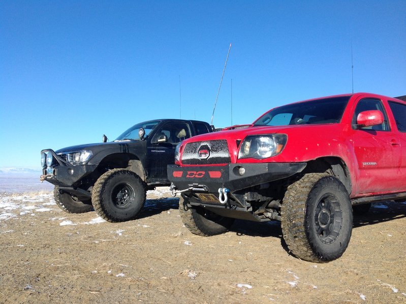

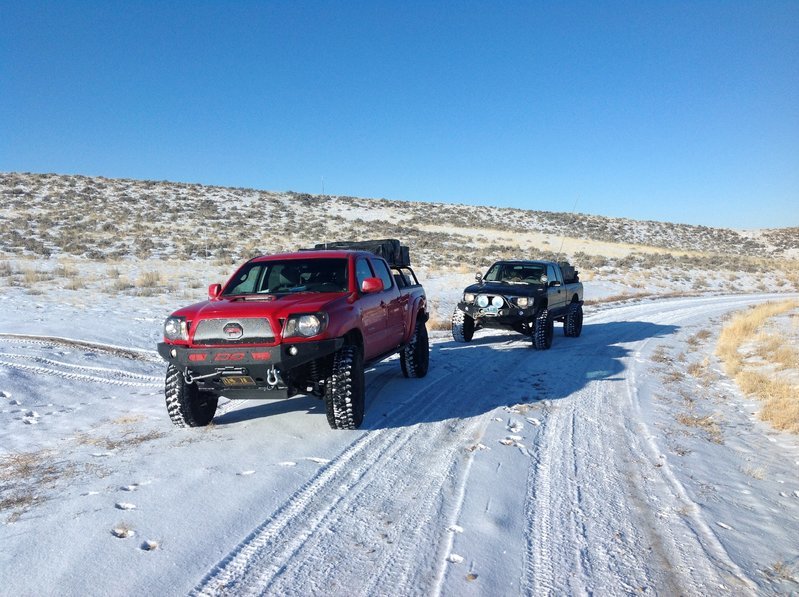

    Also, this is from January but I blacked out my dads headlights for Xmas. Looks good I think. My DSLR was dead so I'll get better photos later this summer.
