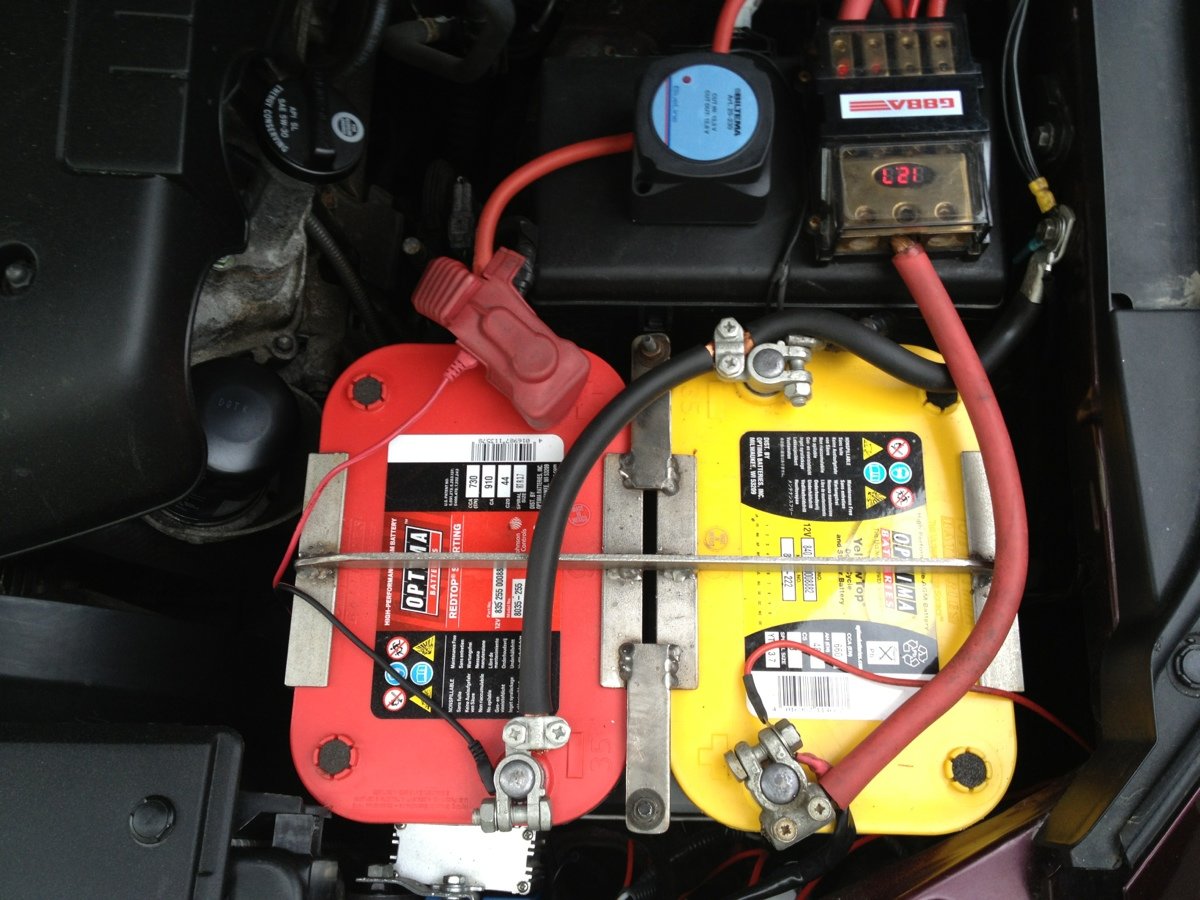

    I've not had any troubles per se. But I like to do the regular maintenance charge with the smart charger to be proactive about it. How are you able to measure percentage of charge?
    I've thought about solar but have never felt the investment was necessary, at least not yet. I suppose if the truck were to set for more than overnight without being charged by the alt, a 100 watt panel would be nice to have.

    The panels are not that expensive and depending on the load you have 50w may be enough to keep the battery topped off. I just used the 100w setup because I already had them for remote operations with the ham radios.

    That is interesting. I bet they are putting a resistor in the battery voltage sense circuit to fool the system into thinking it needs to put out more voltage. The only problem I see with this is that over a long period of time it may not be able to go into a float charge state and may end up cooking your battery. If the voltage never goes below 14.6 it would probably do that. A typical AGM deep cycle after fully charging would be happier floating around 13.8. But I didn't look at the whole thread so maybe they have addressed this.

    No. I have two Optima batteries: Red Top 44Ah and Yellow Top 48Ah, Yellow Top is connected through the isolating relay.
