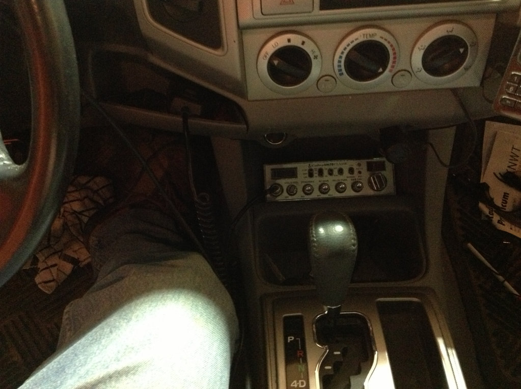

    Yea it works fine. It's range sucks with the tiny ass little antenna that just goes on it.
    Lisa tho got an external antenna for hers and it worked quite well. Best quality I've heard. Not killer range but her antenna was small.
    It died in Moab but was just a small power wire. My dad fixed it when i let him use it.

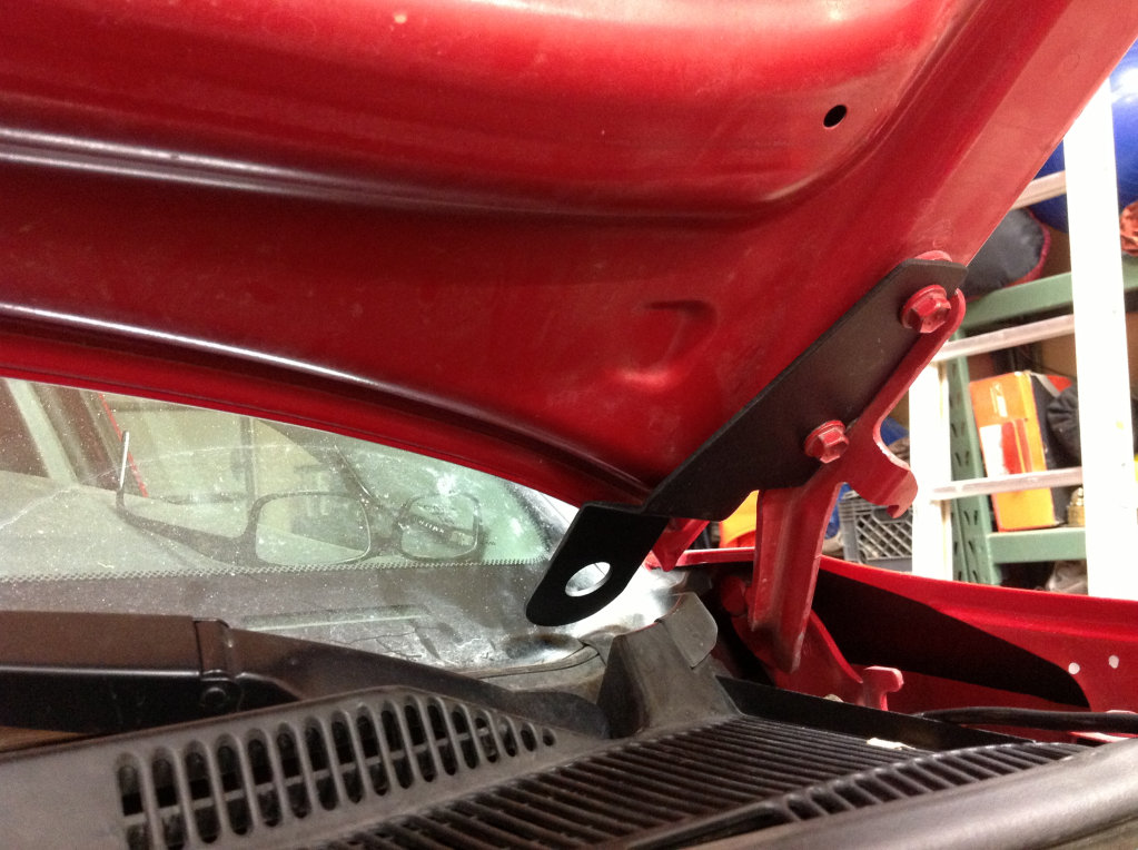

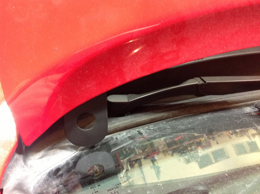

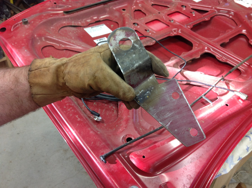

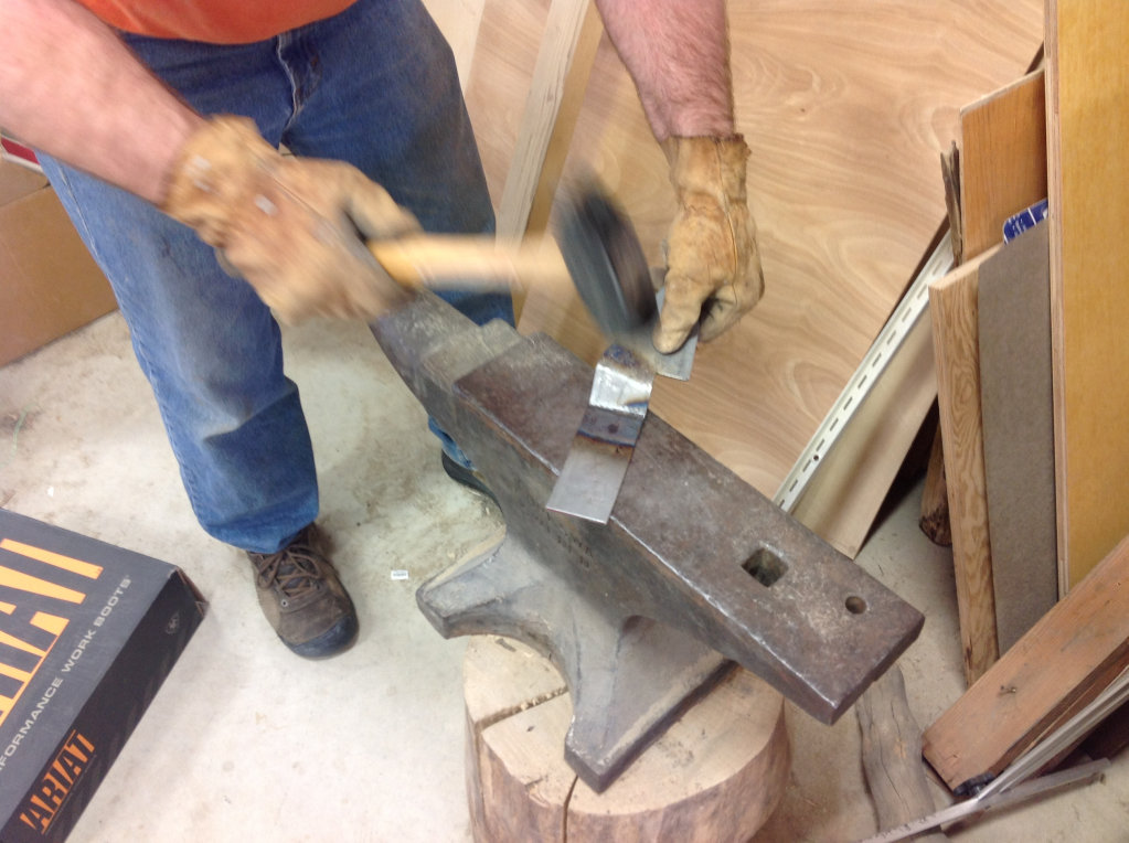

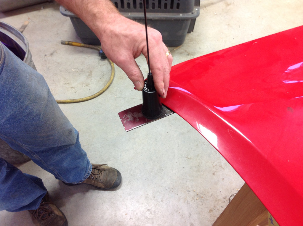

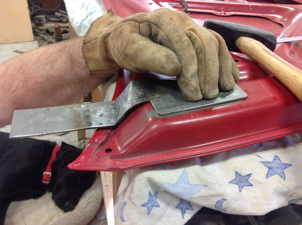

    CB bracket being made
    Old school fabrication :cool:
    Fits perfect

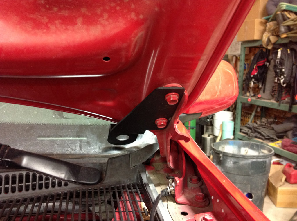

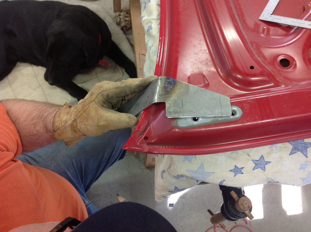

    Test fit
    Trimmed and ready for paint

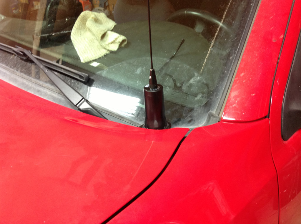

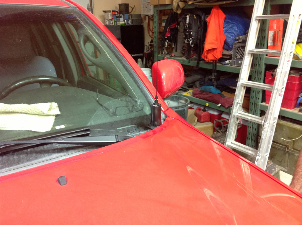

    And done! Works great. Built in SWR meter is showing below 1.5 on 1 and 40

    Hood mount FTW :D

    Took a while to make the bracket. But works great!
