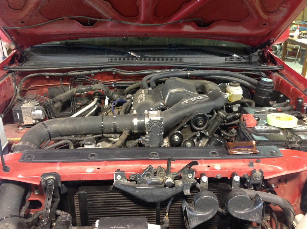

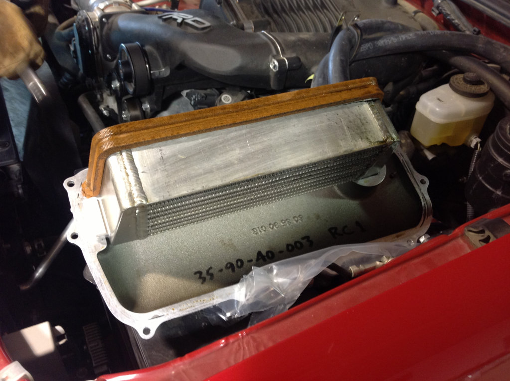

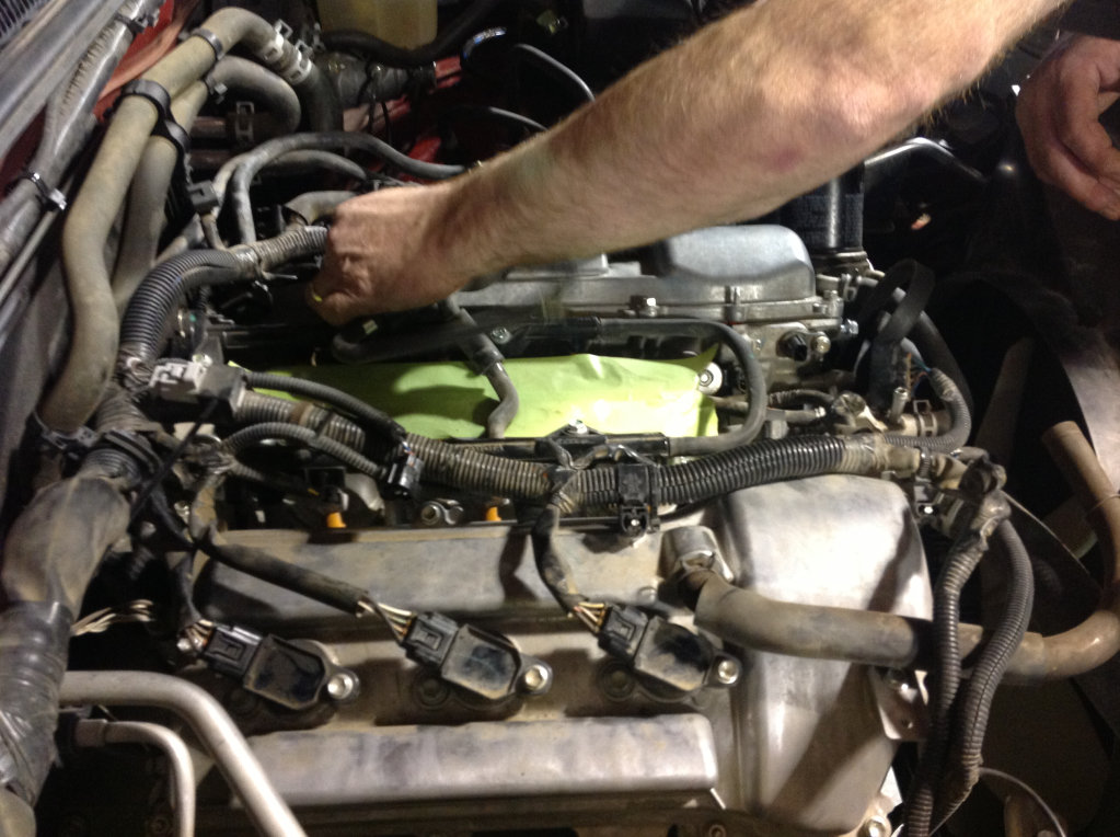

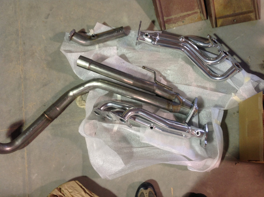

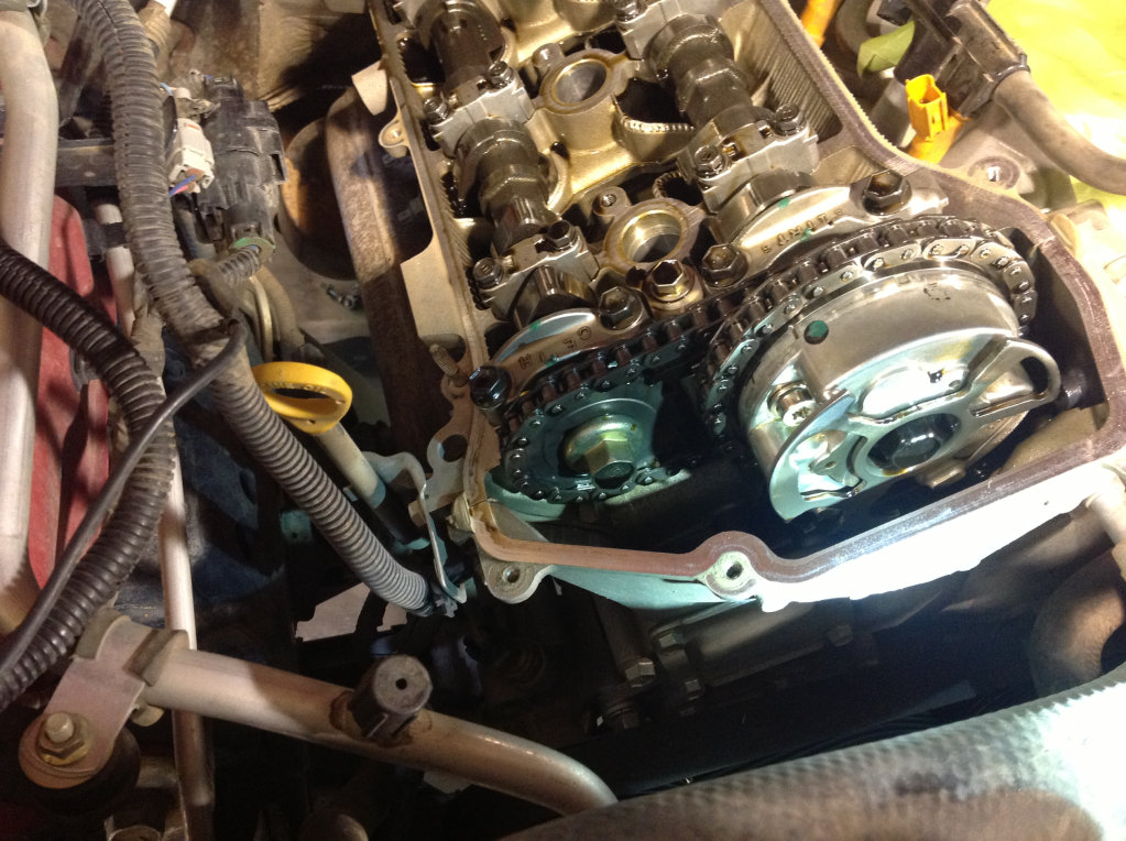

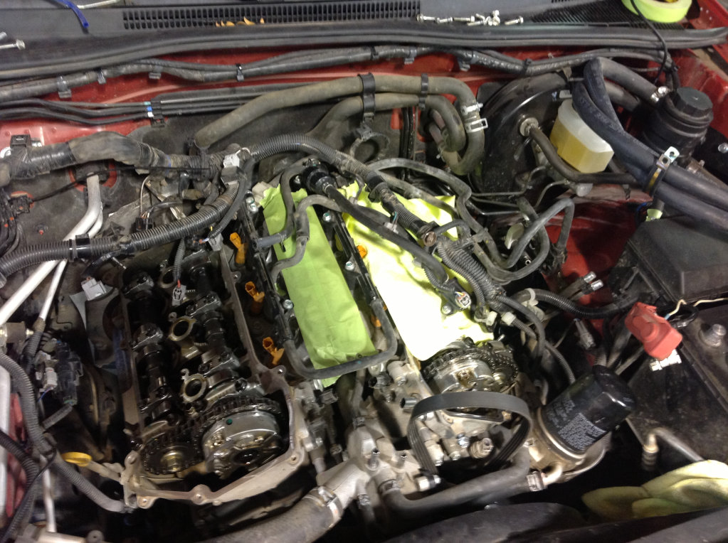

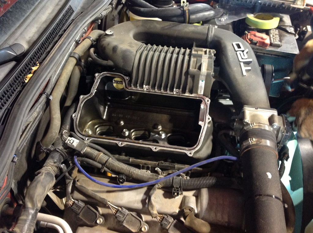

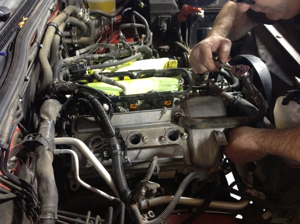

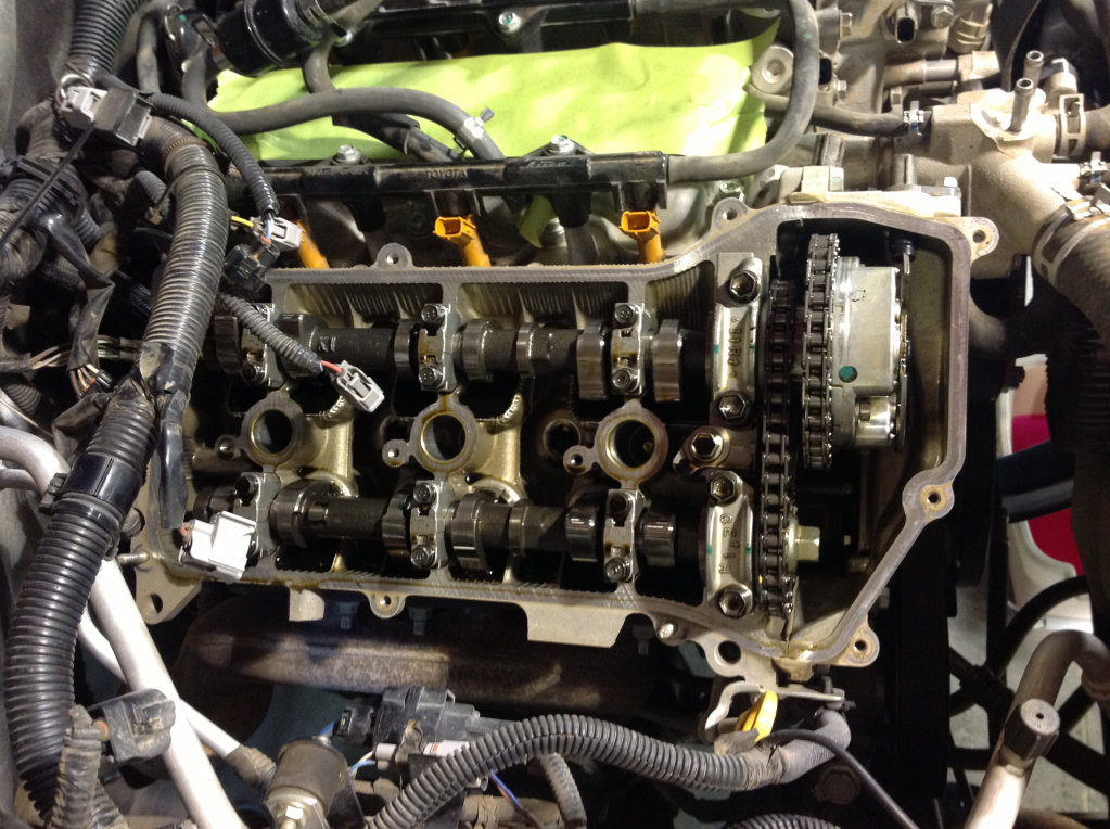

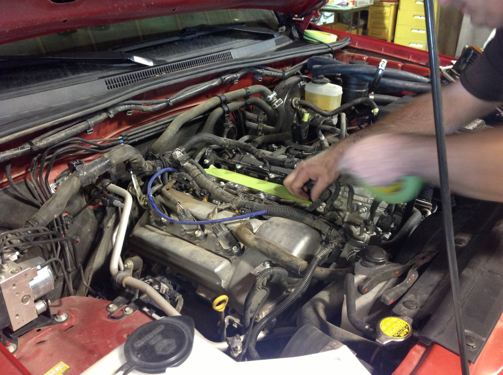

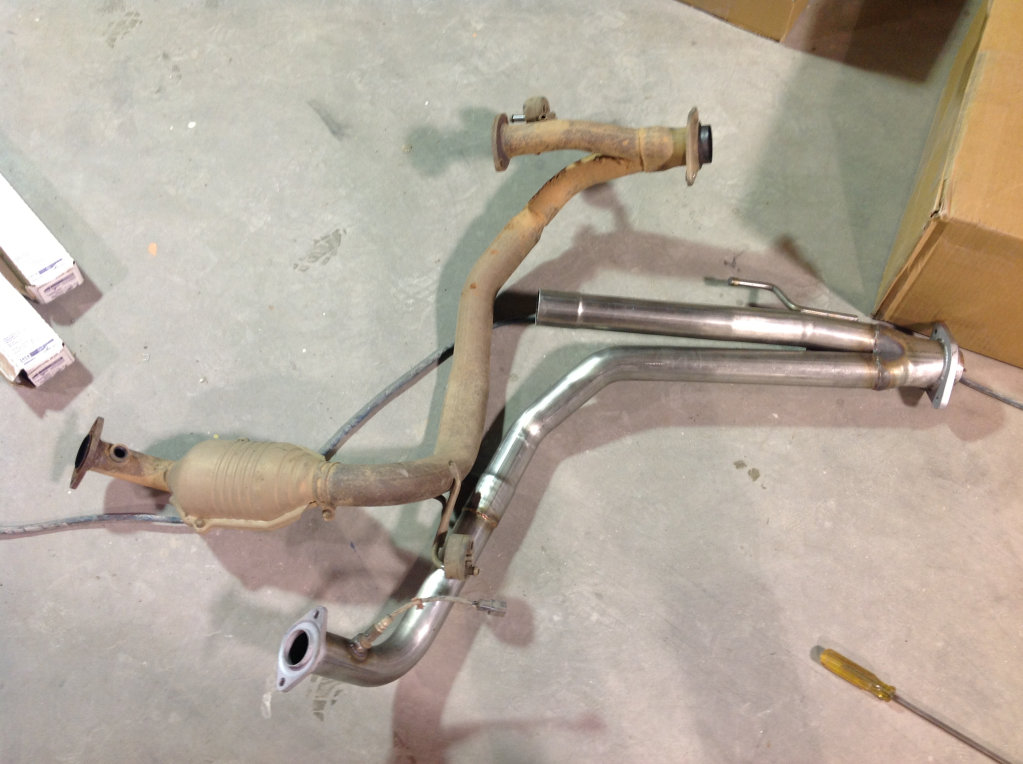

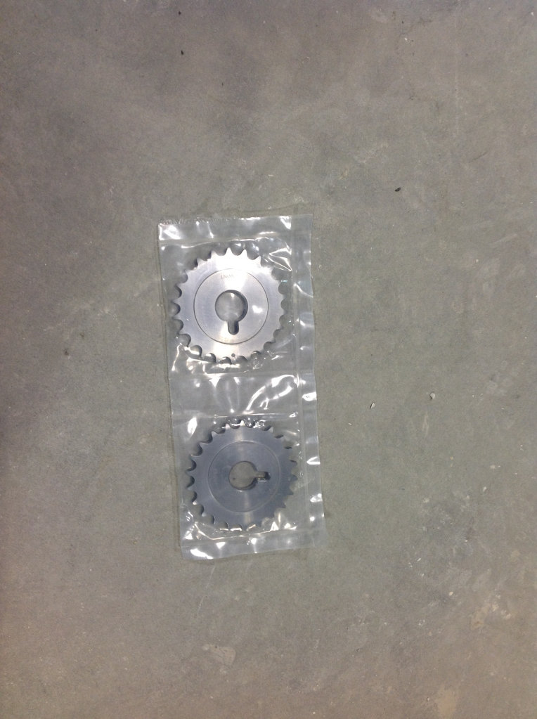

    Okay here are all the pics.
    Starting
    2117e1c86ce28b7a9d4217c3d80ecd5b_zps1a35_dfd978779092fdd65803769d57e581c0b7a69214.jpg
    Pulling the SC
    f9610452343cd69daabf1e089315f223_zps4031_738526aa9e846a245851f19366bef592956ecf0d.jpg
    f301c77a32238efb78c84a71e6e70629_zpsc678_76f8b3a3c5360ca4e87ed8de5fbf9d50bafa7910.jpg
    6d4629c6e4a26e3c7011b5a07379fd3b_zps08a0_2bedd40f036e5dd0c3749067852ad487319b84f4.jpg

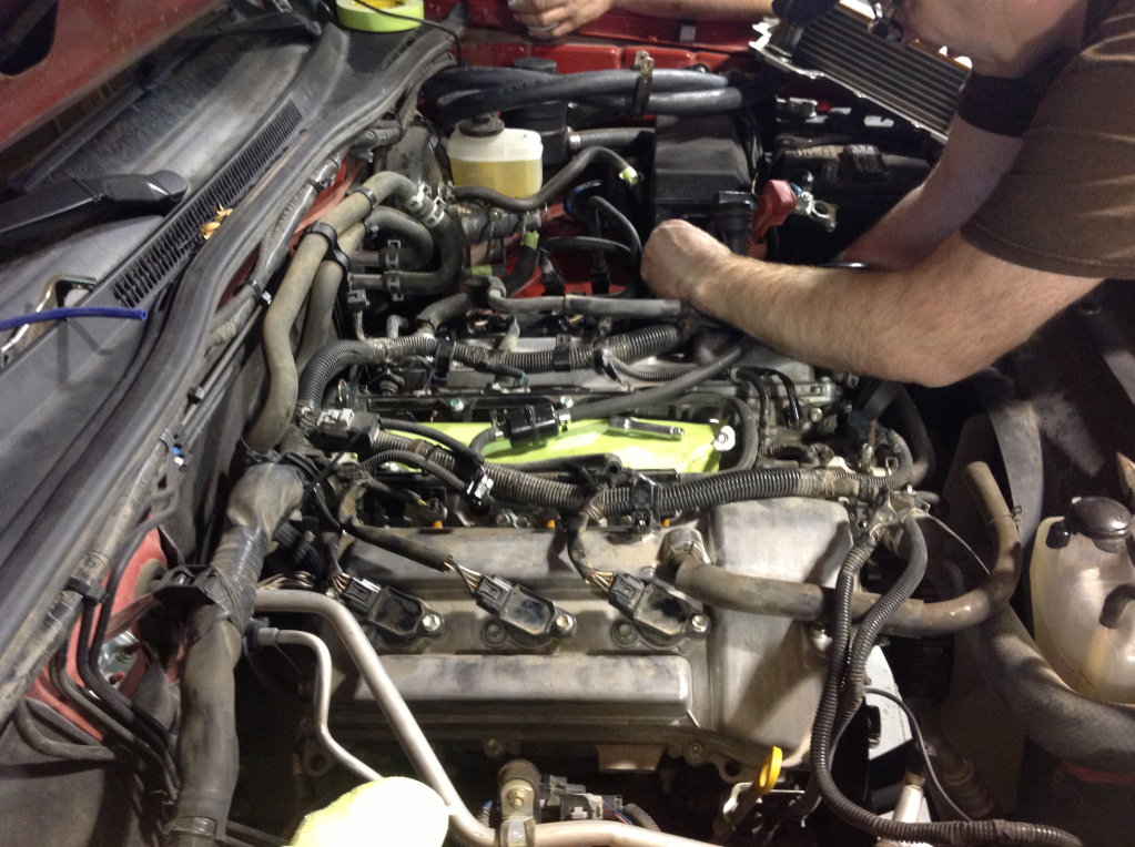

    Getting the cam gears ready to be swapped
    f777179385e8d0b71ea6b21b5750fee2_zps4c9a_f39d25f85ff878e27edb7f47b9be4b0afea3ff8f.jpg
    cfbfa448468bfbd2a77aa964bf3343ce_zps7bb3_5184703d32450c00a8ebd7a3e93f020d04ef5553.jpg
    Topless!
    89c2da706a580a2f439ddf9a45832067_zps56ab_34a8b1e6a1a259535f559aa26368476cb09f9439.jpg
    New gears
    7b7caf8f303c69332523225116cce238_zpsfa5b_d2d8b7758af87754362cbf29e041480844b2250e.jpg
    Done with one side
    660286c2f319bf26b374d52290789b03_zpscab2_7842b48e62a091571e9969b9c5e4262661982e5d.jpg
    Buttoning it back up
    2eb0211e7e4fe16934ef5e1f70837dab_zps3218_e445276b2898f43e6ab3f94036bcdb38906c5493.jpg
    140af803bac9fd3df1d994528770880d_zps49b9_a14f210bbdb946a8c9b9a40245a21e31ffefd295.jpg

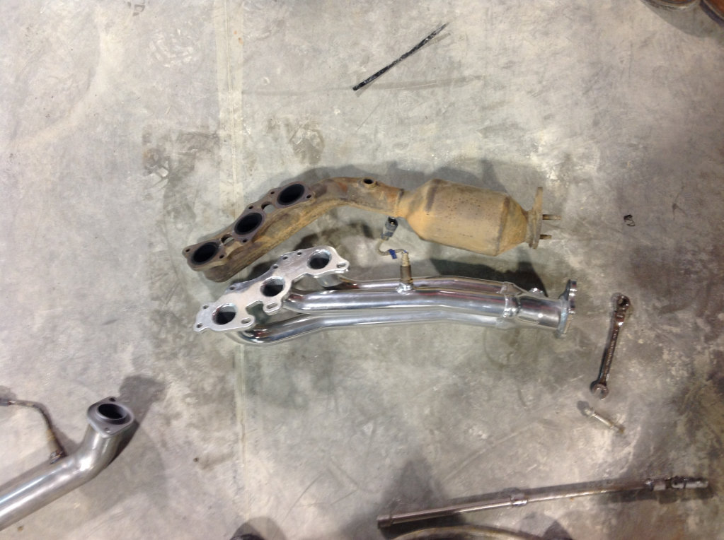

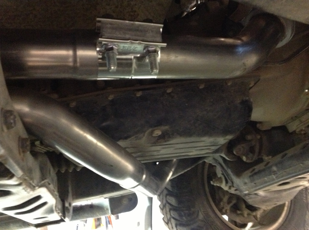

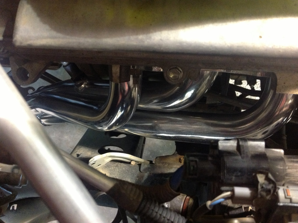

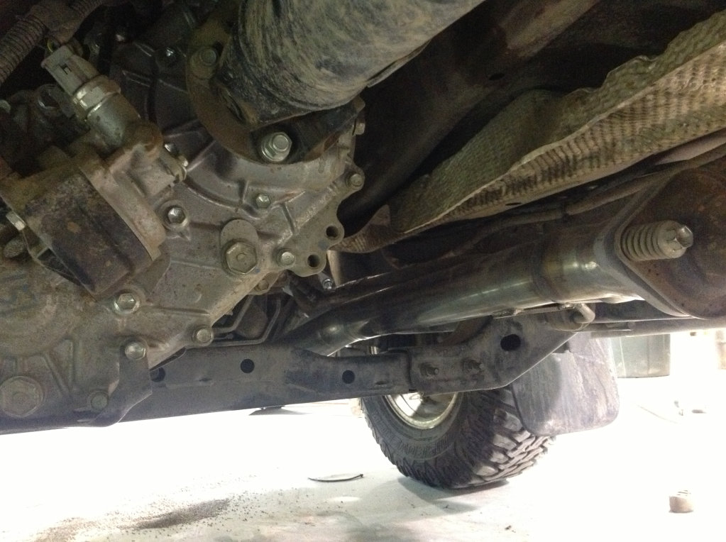

    Headers
    867c37e73db62e807c074cbffa9fdfdc_zps8762_8e9c1adc497a611ab83bc0d5b9658f1c58961ea4.jpg
    8e20abdf2da4c153f8f64534673cb9a7_zps3441_34c517fe9f693a4eb12a5f4ccac9399442d30ccc.jpg
    No more cats!! Gonna sound badASS

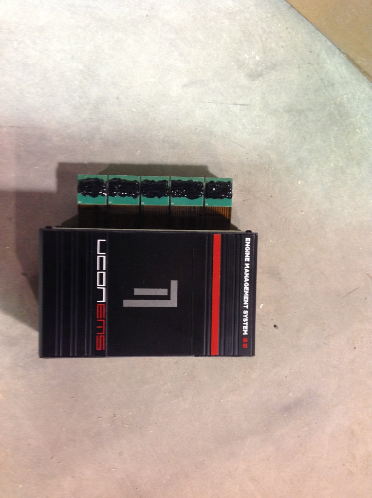

    Truck is back together and runs great!!
    Sounds bad ass!!!!!
    Pulls hard then before by quite a bit. No codes! Uconn worked great! Afr checks out perfect at 11.2-11.4 under WOT.
