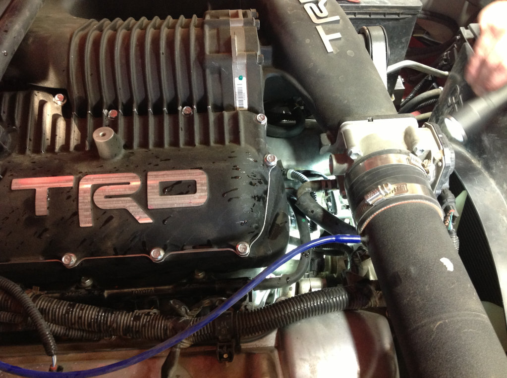

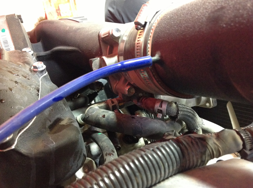

    Also came home and saw coolant on the SC :eek:
    0aaa2eef119acb8394f27f991502ffa9_zpse72d_035d20b7beffa32edd4310f584a94d4527bbe2b3.jpg
    Turned out we missed a clip right under the TB. Glad we caught it!

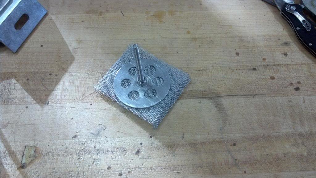

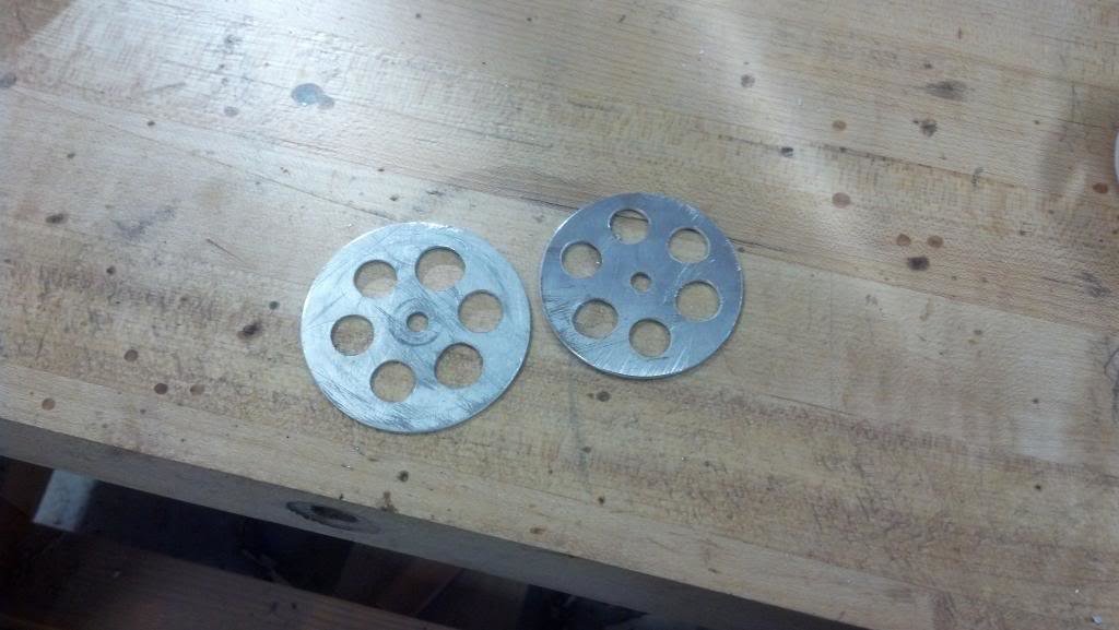

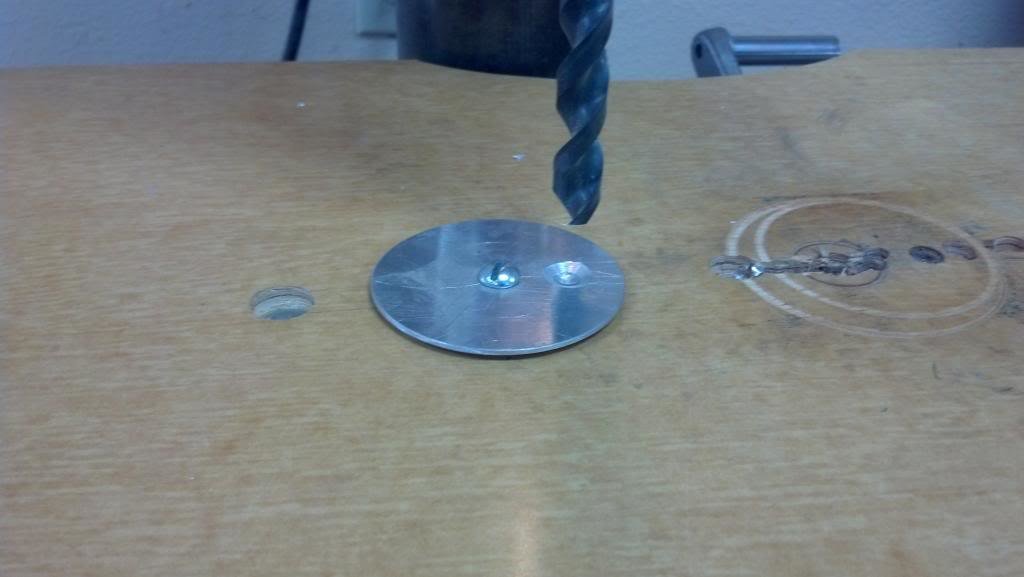

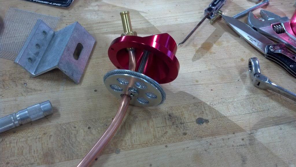

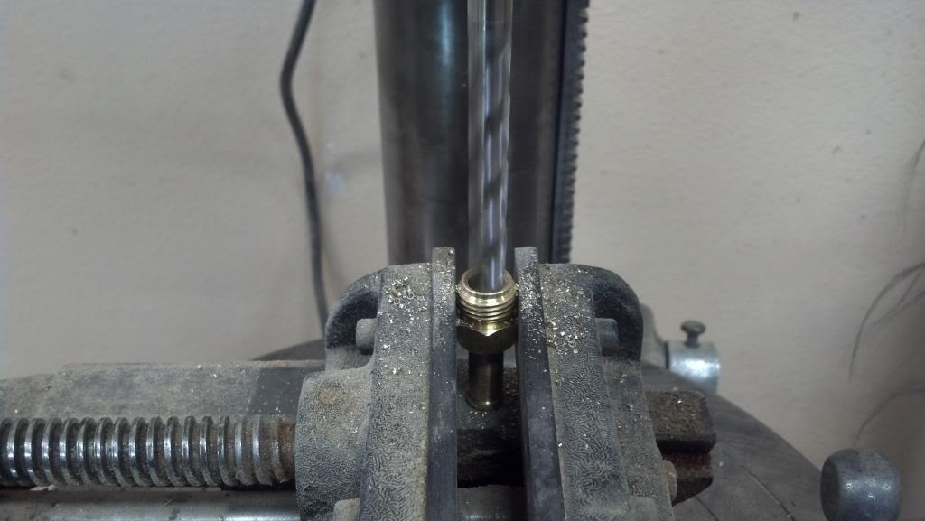

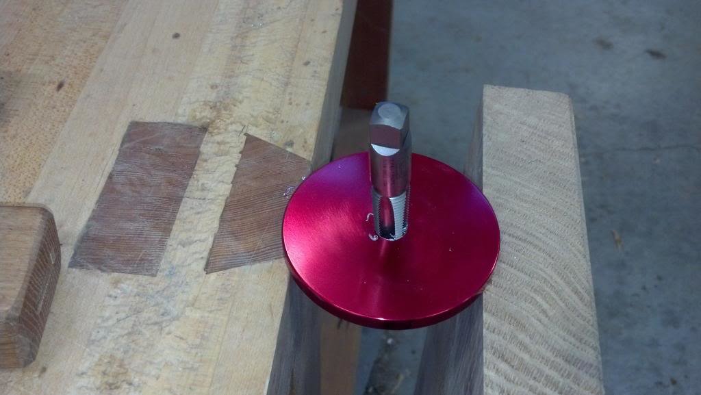

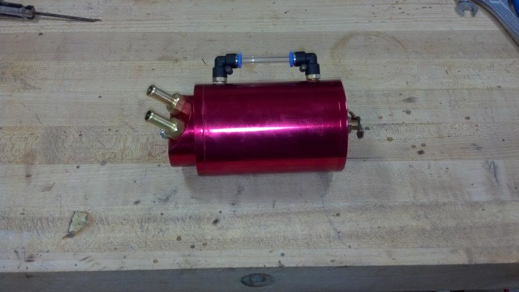

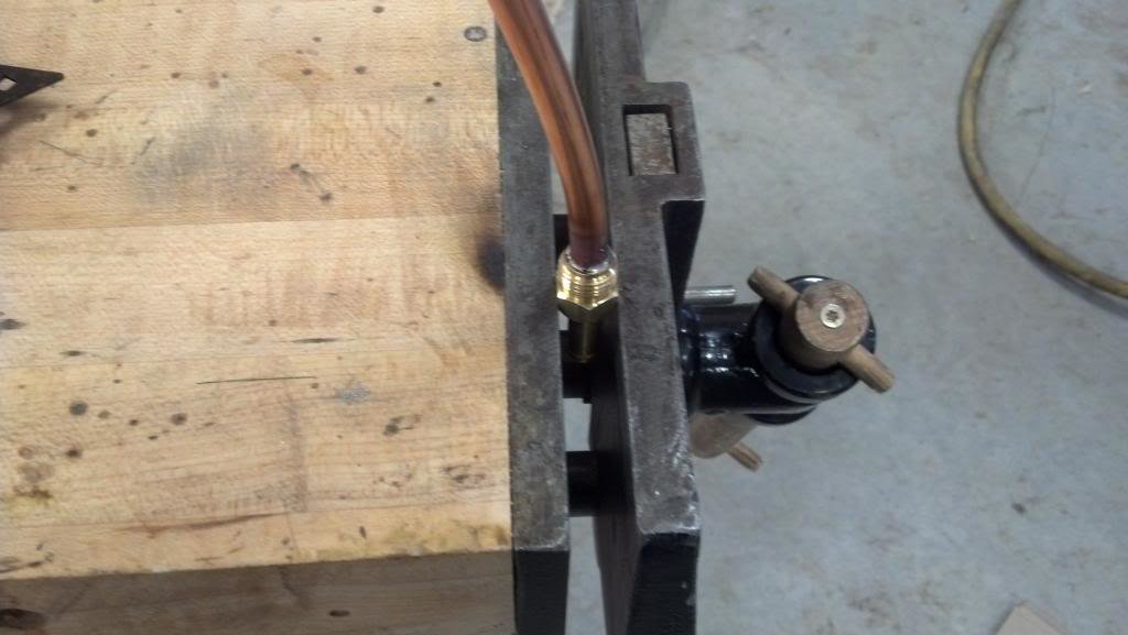

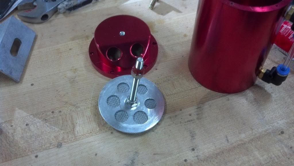

    Installed and Oil Can. Started with a cheap one off of ebay.
    I changed a few thing with it. I replaced the cheap hose barbs with brass ones, added a baffle system into it, and added a pet cock for a drain. The pictures below should explain it all. If you have any questions let me know.

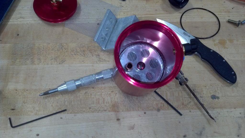

    Building the baffles, sheet aluminum cut out with a hole saw, the perforated with a 1/2" drill bit.
    Used window repair screen for filter media between the aluminum plates.

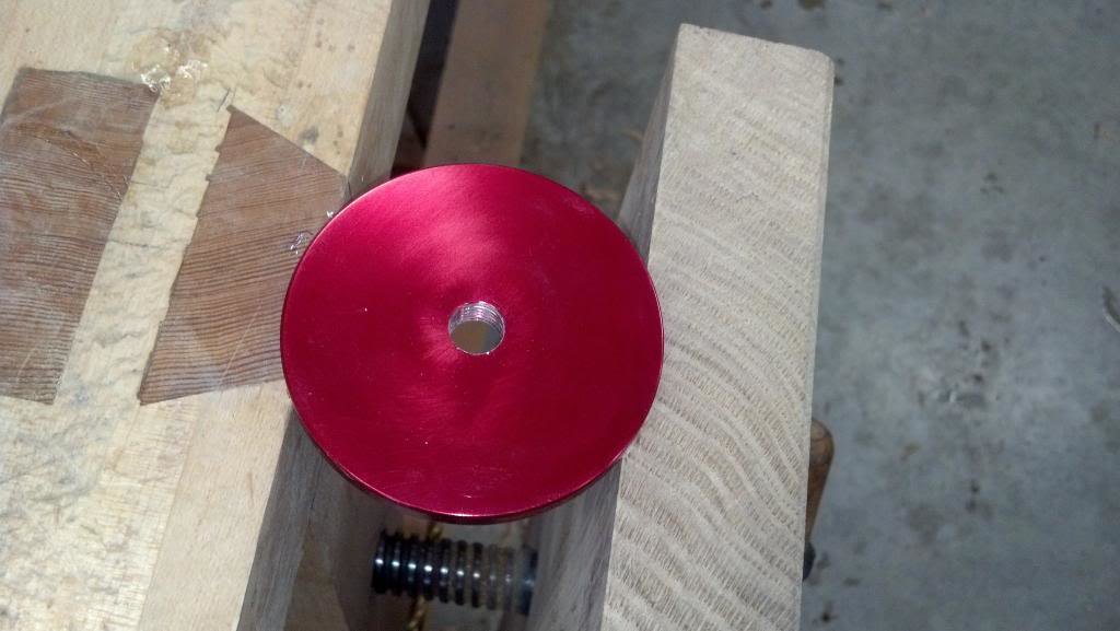

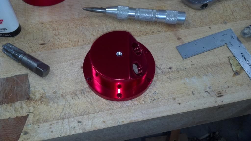

    Drilled out the bottom and taped to 1/4 npt for a petcock.
    Drilled out one of the brass hose barbs and soldered in some 3/8" copper tubing.
    Drilled a hole in the cap to hang the baffle assemble from.
    Hang baffle assembly
    Finished baffle assembly and copper tubing hose barb.
    Finished Can
    I'll do another post mounting it into the truck.

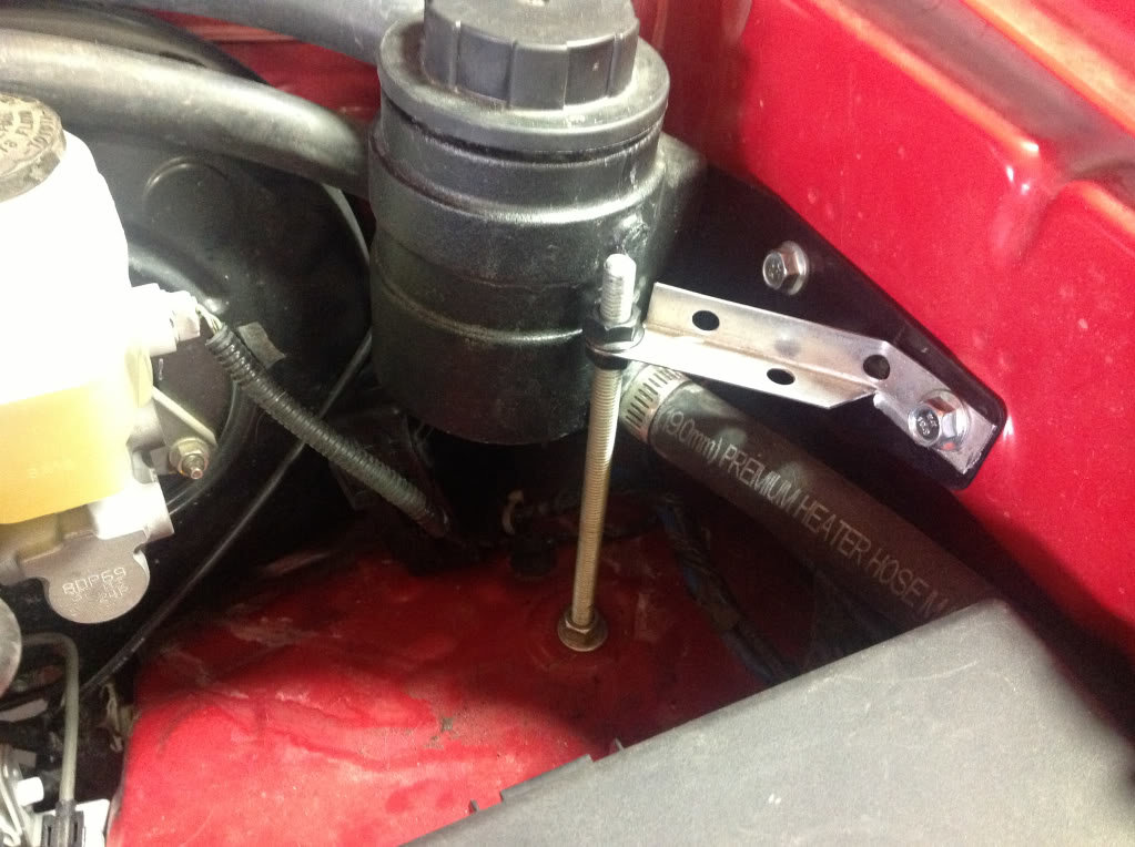

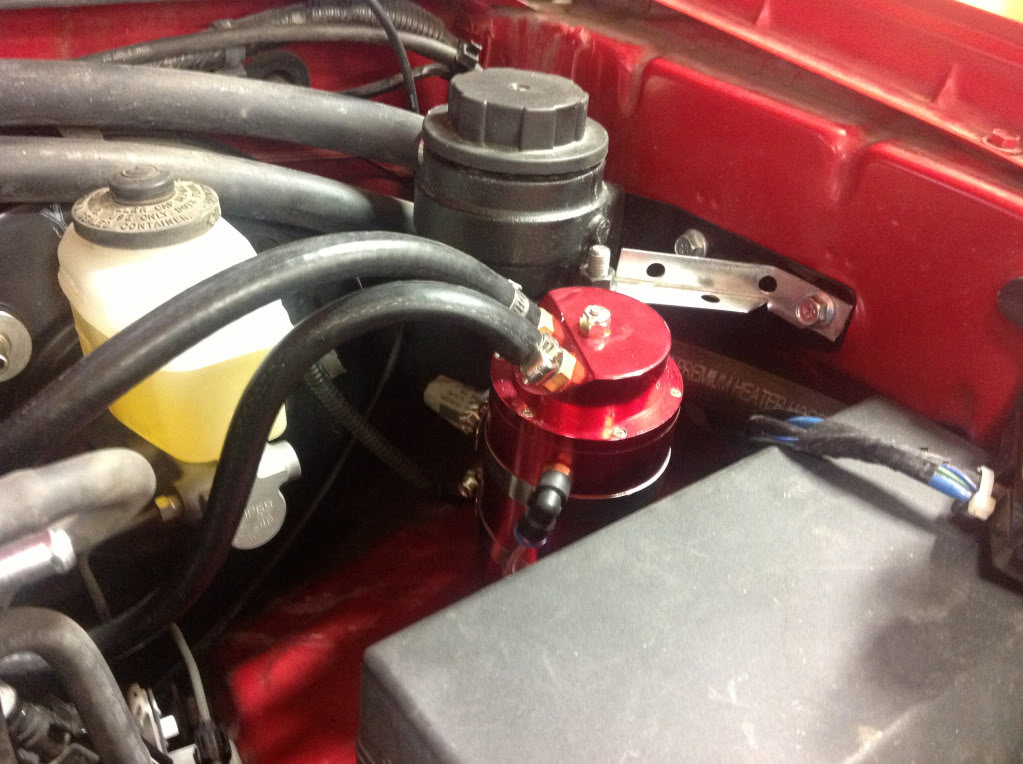

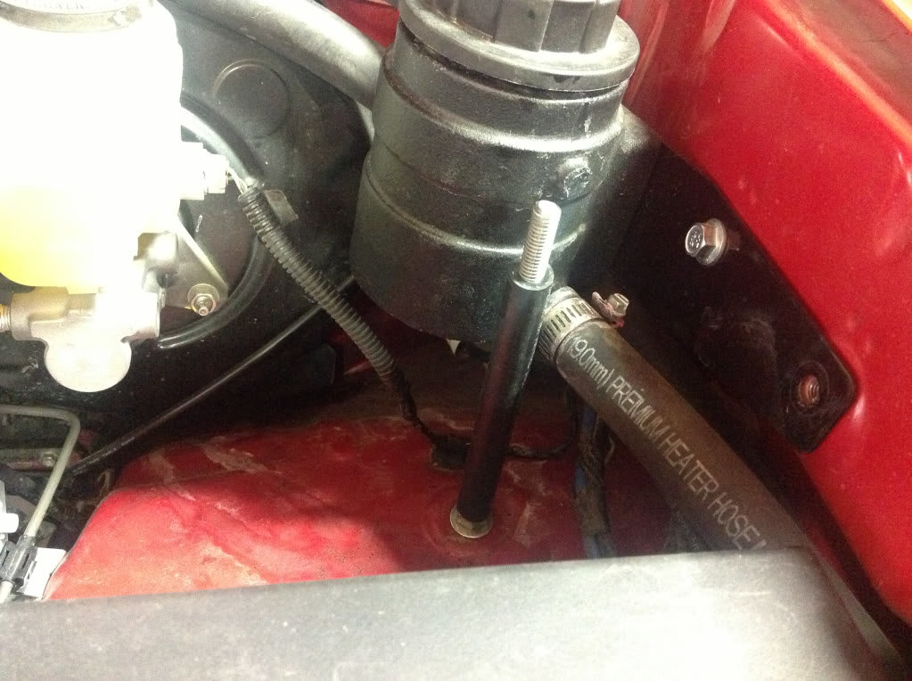

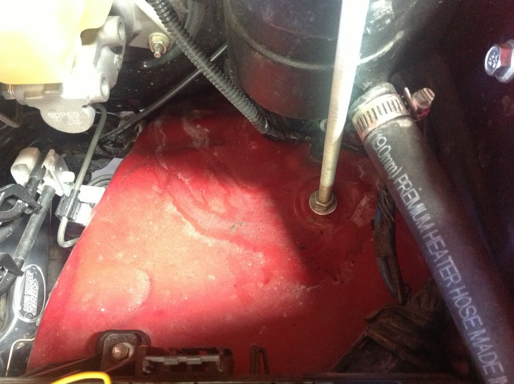

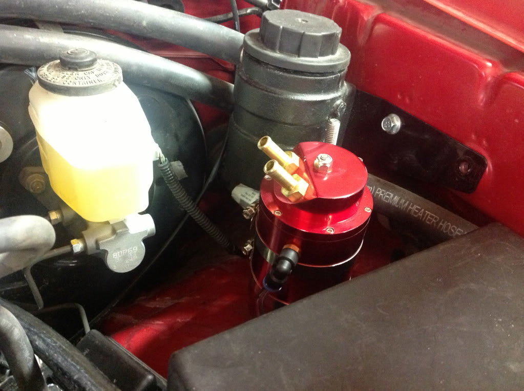

    Mounting into the truck proved a little challenging. After consulting with Monte we decided to run a piece of all thread from the wheel well and hose clamp the catch can to it. Turned out pretty good.
    Mounting all thread
    dfa7fae41d9540bf6c7a64172fa64c48_zpsd9c3_cb2e3d8d693f0b4a35cfdc2f946ab1d03a3b26f1.jpg
    Adding top support
    6e51b41da3ccc8bb3e22cf76d9760b49_zps39c0_b6b2d262874db94625825de8ca5d25ba0be4ad67.jpg
    Fuel line over all thread
    35965a8514f8149659680ed930f23531_zps5a7f_6978412dc5aa20655a05cad1a6d92ebce01d51a9.jpg
    Catch can installed
    96f21e1218c03ae11f21c443adb14914_zps978a_486f977253eff48059c5506d69b5be36a89d3494.jpg
    d27b5adda8b4b81b5de07353566ccadb_zps723b_d210e948b1648dfda7e2a64ab3623a009cb81598.jpg
    had to pretty much RTV every fitting and joint in this cheap can, but I think we finally got it to seal.
    Hope everyone likes it. :)
