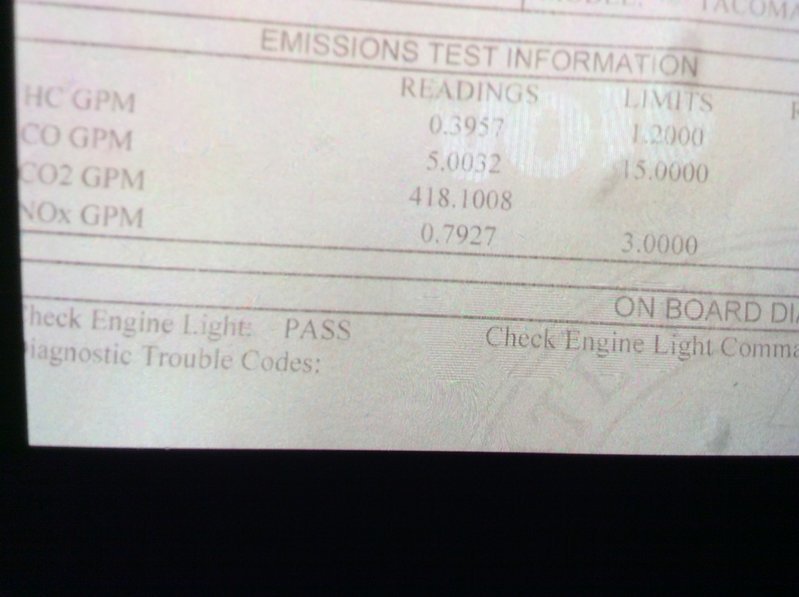

    Just now at 503,325 miles, had the charger rebuilt again at 480,000, I have a complete rebuild done every 150,000 miles or so give or take including the thermal coating of the rotors
    and just passed emissions with flying colors, look at those numbers

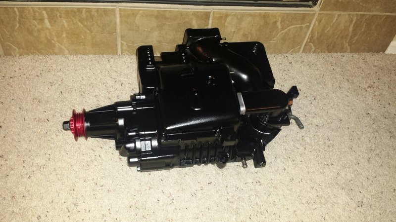

    Nope, I've heard of them but not had them installed, to be honest I would prefer to do a full rebuild every 150,000 miles.
    That way I know I have a like new charger again after the rebuild with full boost being put out again. The snout oil needs to be replaced,
    the charger will probably be full of carbon and will need to be cleaned and pressure checked and vacuum leaks sealed and the rubber seals by the bypass and blow off valve seals and will need to be replaced too along with the bypass linkage bearings and neddile bearings, rotor clearance reset along with rotors getting recoated as the coating does wear off. Then a fresh coat of paint.
    The last thing I need is a part breaking in the supercharger, damaging the rotors or houseing or worse a part going into the engine and blowing up the engine because a bearing or something fell apart. I like being safe not sorry.
    FYI,,, Subaru turbos do that all the time, the turbo blows up or comes apart and the broken parts, bearings or what ever get sucked into the engine destroying the engine. This is a common problem with Subaru turbos after 100,000 miles.
    Photo of it Rebuilt with 480,000 miles looking like new, gets rebuild every 150,000 miles or so

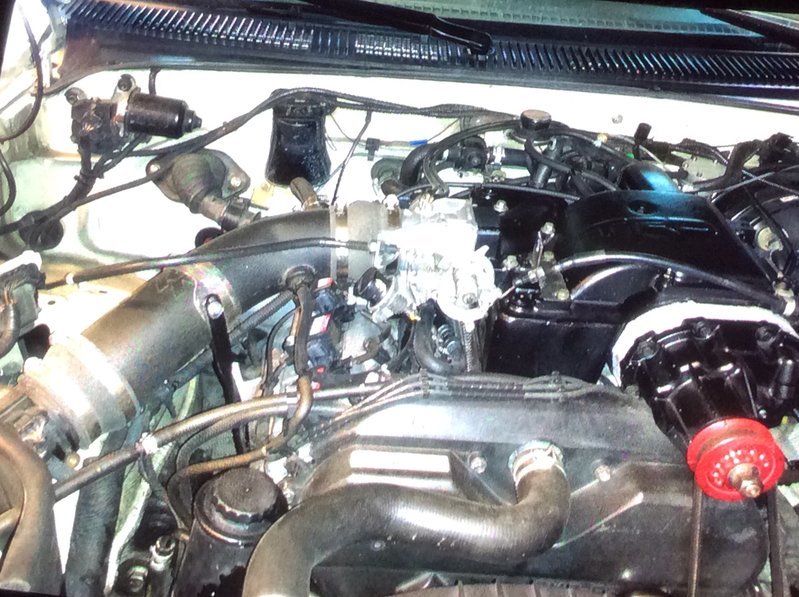

    A can of engine or brake cleaner, some emery cloth to cuff up the paint, some blue painters tape,
    And a can of semi gloss flat black ENGINE paint with 2 coats and your done in 2 hours or less.
