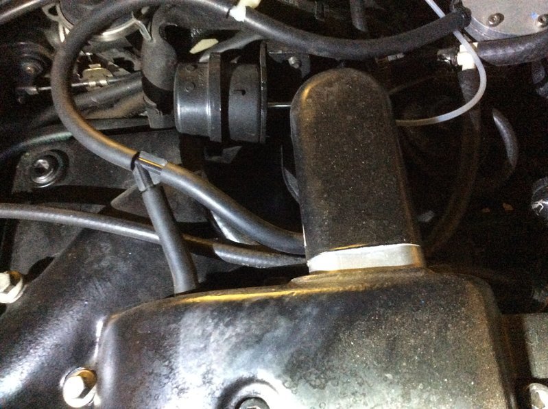

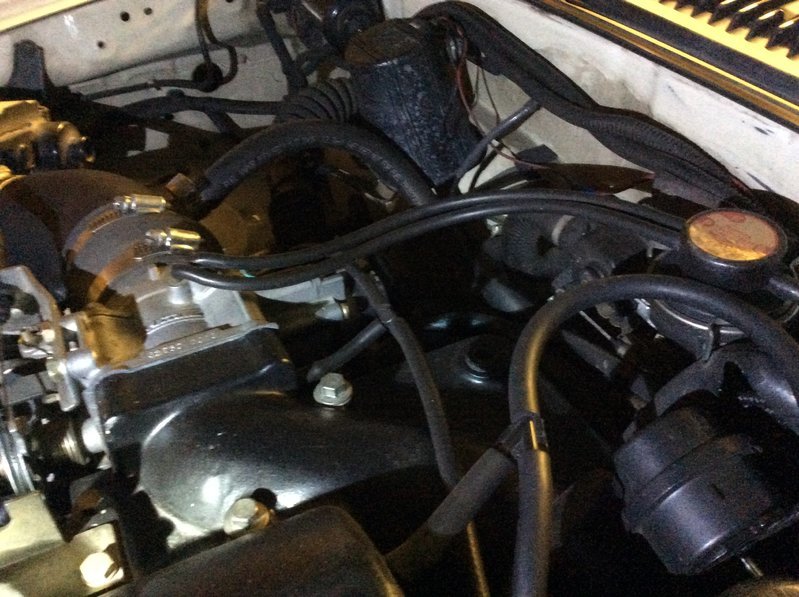

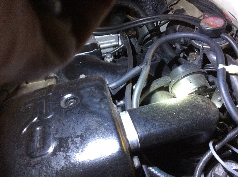

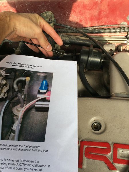

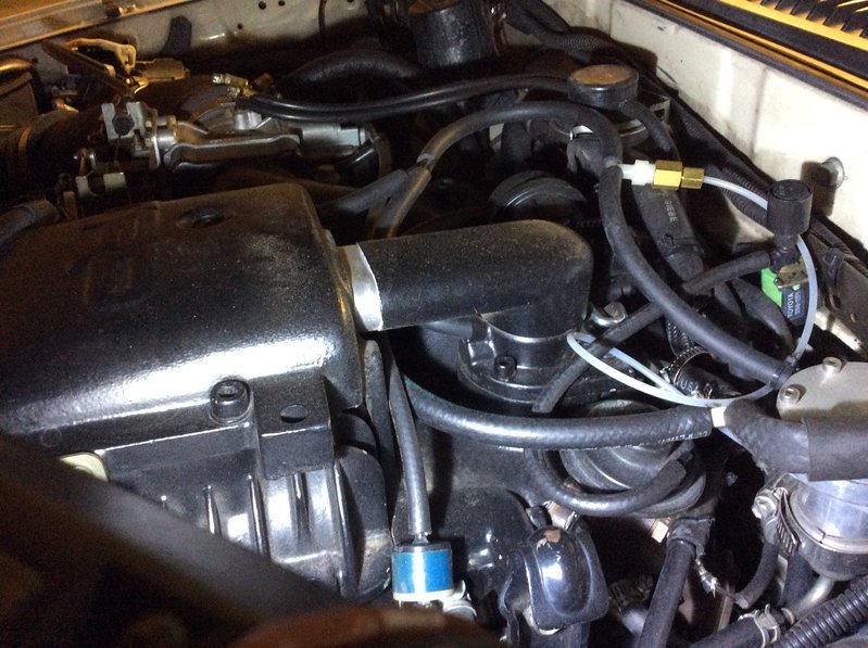

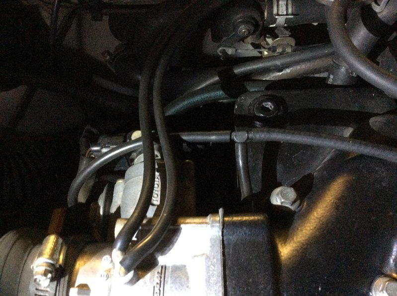

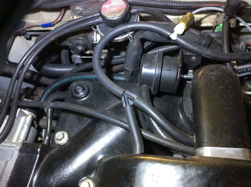

  11. Sep 4, 2016 at 10:46 AM
    #251
    TashcomerTexas
    TashcomerTexas [OP] My truck is a whiner
    Apr 16, 2014
    #127853
    10,350
    2003 TRD DC Supracharged

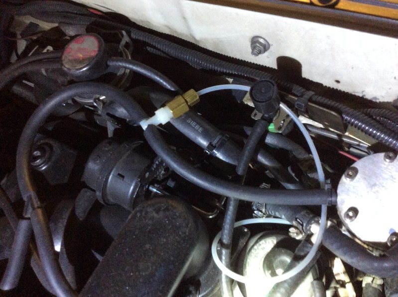

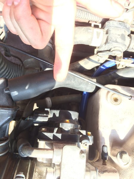

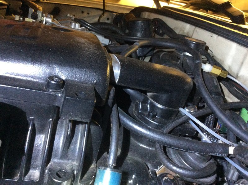

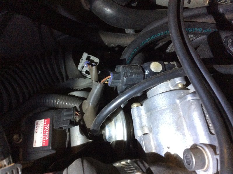

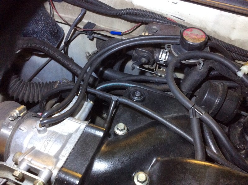

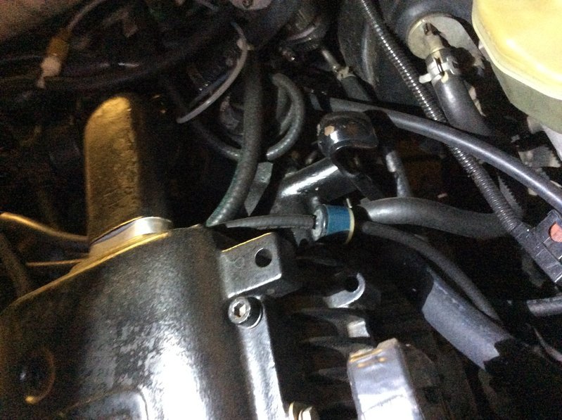

    Yes no more rough idle!
    The guys that installed my s/c and URD kit overlooked these areas.
    This line starts under the L piece but doesn't go anywhere, I put my finger at the end of the line with the engine running and its sucking in air.
    Now the blue arrow I'm pointing to, or the boost port was never capped after it was installed and as seen in the pic I capped it myself days ago to still end up with p0171.
    Now this end here as I feared is often forgotten, checked it couple minutes ago and it was left open sucking in air. As pictured here I capped it off. This is by the throttle body. According to the diagram it goes to the IAC valve, however this is for 01 and older year models.
    Which is what the guys completely forgot to install - it was left unopened in the box.
    It's funny how a $5 piece can help with the high rpm "hiccup". I marked the white arrows with marker that point towards the throttle body.
    And then I came to this tee that was also left open. So before this morning for the past week the s/c has been sucking in air from 4 different ports! The top of this tee coming from the fuel regulator is supposed to be connected to the boost port - according to the 2003 era this was called the "FMU mod"
    Reading from post 46 and on gave a lot of information based on this and what the IAC check valve can do
    http://www.yotatech.com/f2/flooring-s-c-5630/index3.html
    So I have finally fixed my p0171 issue and no other codes have been thrown. The s/c runs so much better and doesn't act like its in limp mode and I don't get a shaking rough idle anymore.

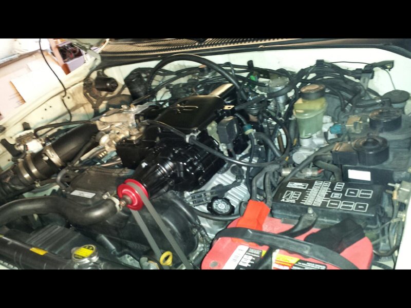

    This is how mines is done in 1998, grey unit, the white tube is the boost guage hose, has 505,000 miles on this setup
    CHECK VALVE AND HOSE RUNS ALL THE WAY ACROSS THE ENGINE

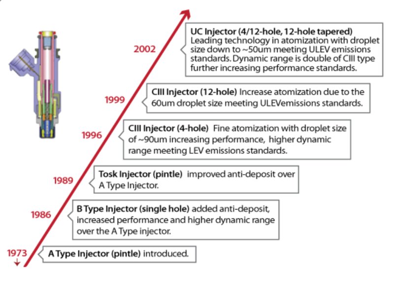

    Haha , yup, BTW, did you change your thermostat with your supercharged to the lower temp one??
    Did you feel or see any differance?
    I don't have any ping issues at all even with the 2.1 pulley, but was wondering if it would help, I have a 2004 motor that has the updated DESNO injectors that have almost twice the mist droplet in size and are larger then the 1997 ones, I'm thinking that's why I don't have any ping issues,

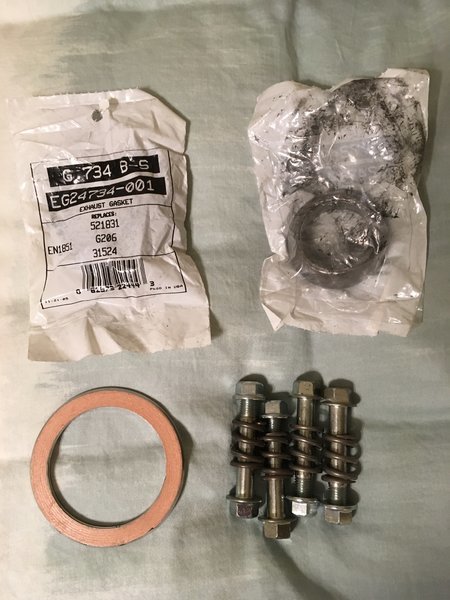

    Did you ever get to see what came with that y pipe, any gaskets or anything?

    Yes, I'll take pics tomorrow.little bit disappointed. The 2001-2004 y-pipe doesn't have a three bolt flange to bolt up to the cats. Only a two. Do you know anyone in DFW that can remove the two bolt flange and weld a three bolt flange on? I've looked online and found a few companies that sell just the three bolt flange. I could also take one off of my cat being that I'll be replacing those too.

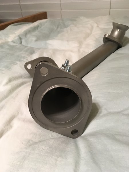

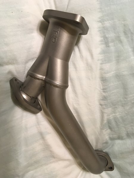

  20. Sep 8, 2016 at 10:51 PM
    #260
    QMEDJoe
    QMEDJoe Proverbs 3:5-6
    Nov 4, 2014
    #141714
    2,391
    Joe
    Columbus Grove, Ohio
    2003 Tacoma, V6, 5 speed, 4x4.
    Fox 2.0 Coilovers in the front and Fox 2.0’s in the rear, Total Chaos UCA’s, Al-lpro expo leafs, K&N cold air intake, TRD headers,Magnaflow catback exhaust,URD short throw shifter, switched out my 60/40 bench seat for some Tacoma Limited seats, Replaced the vinyl shift boot for a leather one, completely soundproofed the cab w/ Frost King. Replaced stock radio with a Pioneer AVH series head unit. Focal component system w/a 10" sub powered by 2 Alpine amps. Weathertech floor mats. Line-X'd the bed. SCS Ray 10’s, Installed an A.R.E. MX series camper shell. All-Pro Apex front bumper w/ All-Pro skid plates all the way back to the Trans. Low Range fuel skid plate.
    Ok, sorry this took me FOREVER. I got home last Thursday and it was one of those once every ten year flu's.it knocked me through a loop!
    Here is the y-pipe that I ordered (that corresponds to the part# on the box). The part #'s I ordered and the part #'s in the install instructions are not the same. There is a place within the instructions that says all "01-04" Tacomas. I will pull out my headers and show the difference in the replacement Y-pipes and the y-pipe that came with the headers... Also, I was expecting a three bolt flange and it has a two bolt flange. :annoyed:
