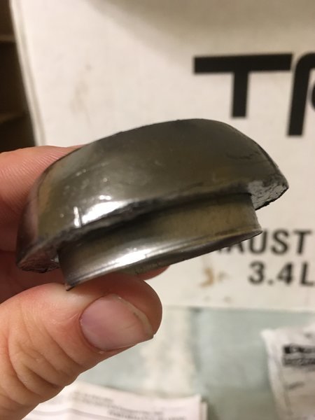

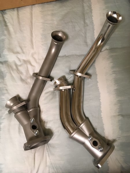

    Here is the y-pipe on the right which came with the headers. Note the difference in length, one ready to clamp to a 99-04 cat (on the left,minus the 3 bolt flange) and the other longer so to bolt up to the 95-98 cat.

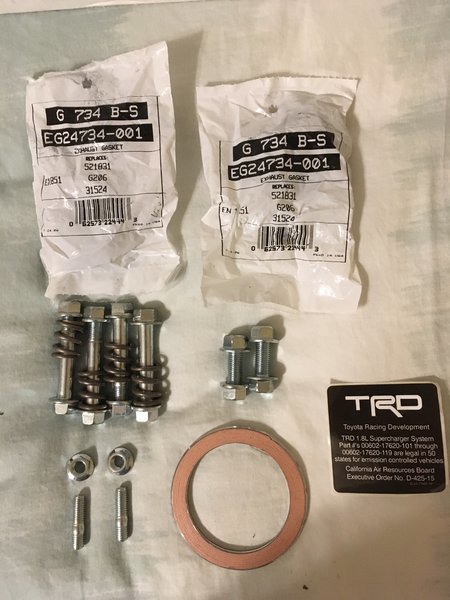

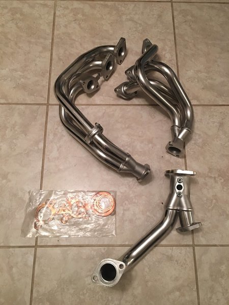

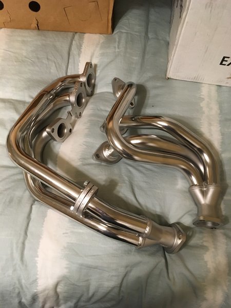

    Here are the headers, instructions and parts that come with it.
    I think my easiest option is to go with the longer y-pipe and bolt it to a two bolt Magnaflow cat and then the MF catback exhaust, get the URD rear o2 sensor simulator and be done with it...

    Dang don't know what to tell you there. That's interesting, now you got me researching all these part #s. I'm sure an exhaust shop could easily change out the flange styles.

    Regardless, I think it's an easy fix either way. I'm going to first try the two bolt flange just because cutting the flange off of that y-pipe makes me sick after spending all that money:pray:

    Yeah goodluck with whatever route you take. I'm just getting confused when you say the part # you ordered and the part #s in the install instructions aren't the same.
    So just to clarify:
    The part # on the box says ptr108999018 - which should be the corrected y pipe. However from research there was never a TRD y pipe with a 3 bolt flange so either way it would have to be modded.
    And PTR2635953 is the updated gasket and spring bolt set that you got.
    If I'm picturing correctly the y pipe that I have is different from both of those pictured, I'm thinking I have the old style. The y pipe you've had is the pre-2001 y pipe but is the updated version for the donut gasket, and the one you just got is the updated 2001-04 y pipe.
    Notice how the y pipe doesn't have those rounded openings
    Vs this

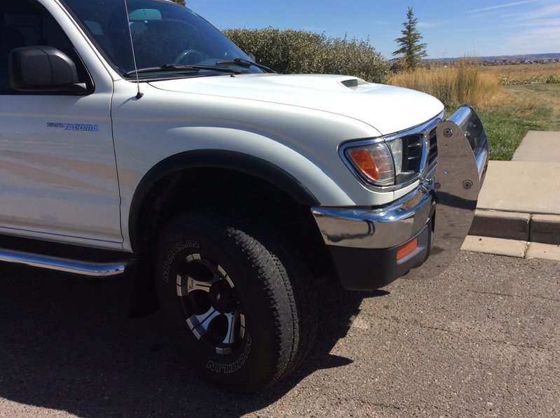

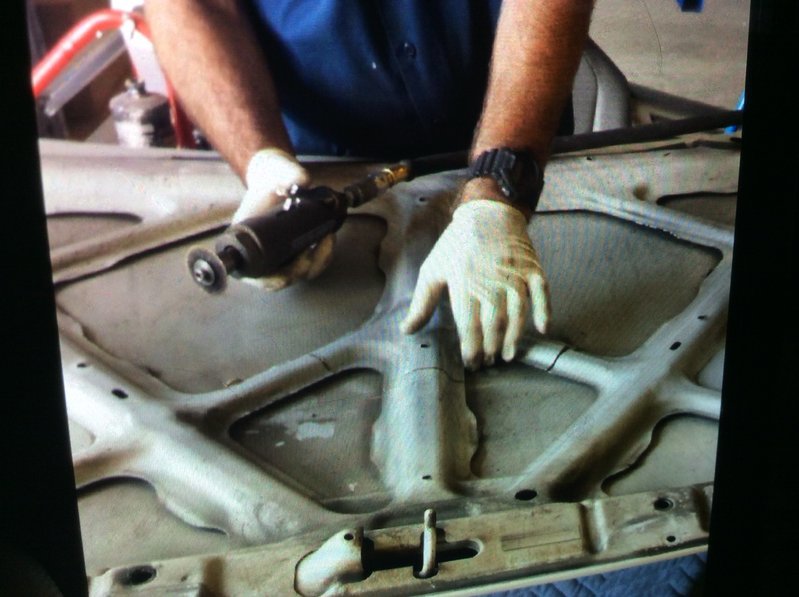

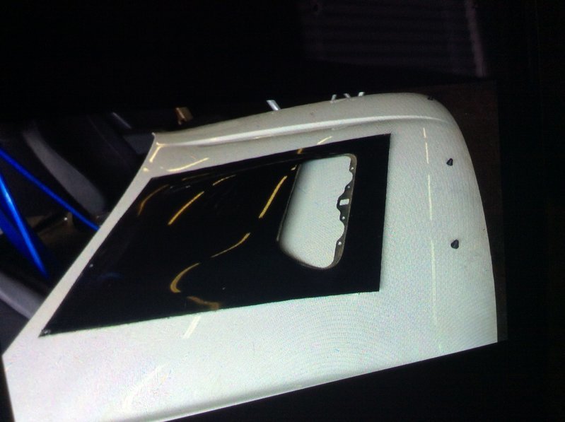

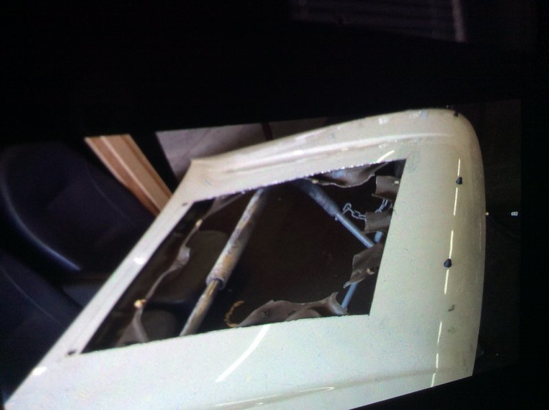

    V6 5sp,RegCab,TRD Supercharger, 1.9” pulley, methanol injected Haltech ECU, AC TRD supercharger,(MUST DO) TRD supercharger ported, every 125,000- 150,000 needs rebuild Projector headlights HID 5 speed manual Amsoil for all drive train Smaller 2” pulley, (MUST DO) 2004 DESNO fuel injectors, zero ping ping, 2004 side door mirrors Dick Cepek Rims, Michelin tires LTX, ( that last 100,000 miles) Now running Dynopro ATM mud and snow tires KN cold air intake Cat back exhaust with ss exhaust tip, Raised exhaust tail pipe to 2" below body line Optima*dry cell battery,red top Alpine sirius radio, 200 watt amp, focal is165 split door pod speakers Focal door speakers Subwoffer behind seat Viper alarm, Electric Locks Dark tinted windows, bucket seats corbeau lg1 Tacoma Rubber floor mats TRD fender extenders, Bilstien shocks, King shocks nerf bars, add a leaf for rear springs trailer iv hitch, electric brake control, Drilled slotted brakes, High carbon steel (MUST DO) EBS green stuff 7000 series pads(MUST DO) TRD engine oil cap TRD stick shift, Marlin crawl shift kit. Rear sliding window 2002 4Runner functional hood scoop cut into Tacoma hood, 4Runner dual overhead map light Gentex Auto dim + Compass + Temp, garage,rearview mirror Snow Methonal kit stage 2 Custom 3 core aluminum radiator Linex bed liner Haltech stand alone ECU, Intake supercharger gauge. Stainless steel brake lines, Custom leather wrapped steering wheel,

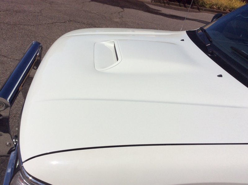

    Ok, I stared the hood scoop project today using a 2000 4Runner scoop
    Finished it , came out great

    You will love the finished product so many people ask about mine
