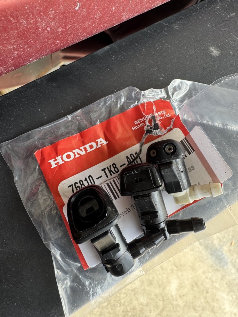

    Forgot to include this quick quality of life mod.
    Honda Odyssey spray nozzle mod. Pictured is the adjustable fan spray on the left, middle is a Dorman ford fusion (fan spray non adjustable), and OEM on the right.

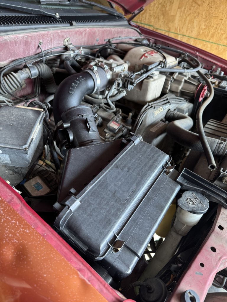

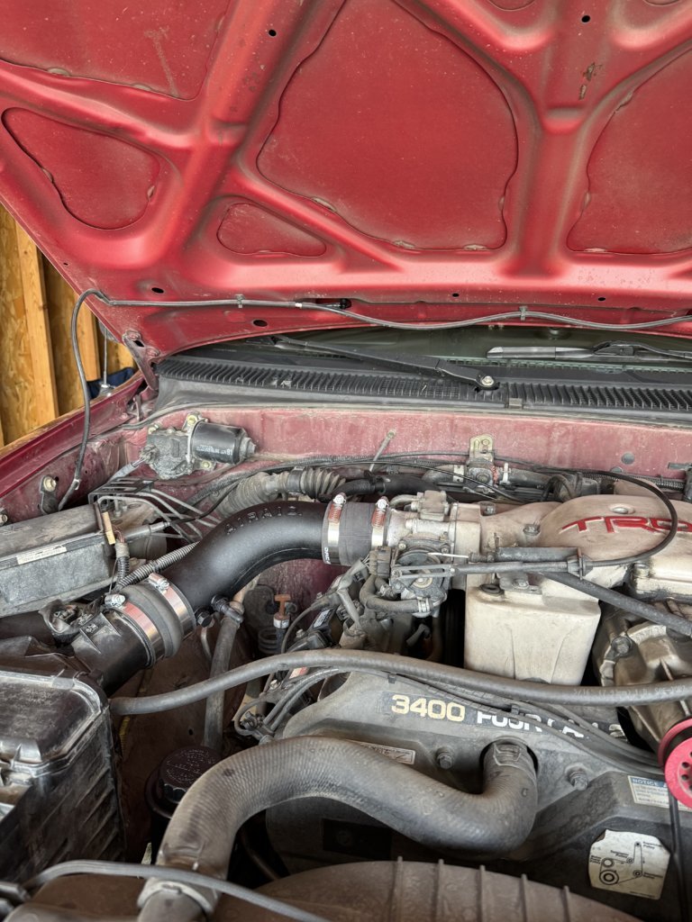

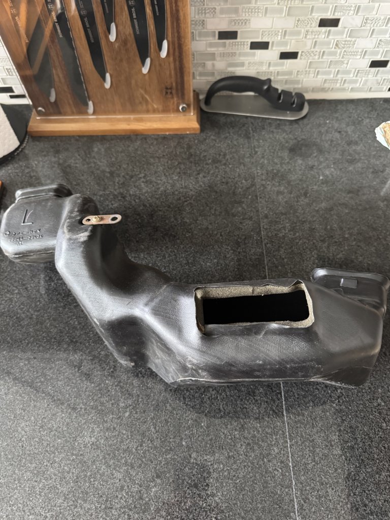

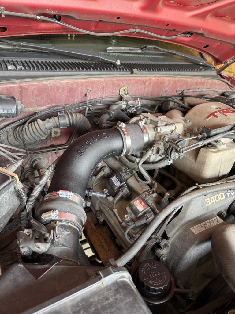

    Put in this airaid MIT this morning and most likely found the occasional vacuum leak code I have been getting.
    The tube really is a hoe and a half to get on. While shimmying the tube into the airbox outlet I noticed that it was partially giving way as if it was cracked…sure enough the truck’s parts are starting to show its age.
    Gorilla taped around it for now and did a test drive. Idled around 550-680ish which isn’t ideal but wasn’t enough to trigger a code. I will have to buy a new stock box soon. But hey at least it freed up some space - I also didn’t really notice any difference in performance or sound.
    On the other hand there has been some talk about driving around with ECT on to penny out MPGs and I admit I sort of forgot about it. While test driving I was getting some serious smiles per gallon in conjunction with the s/c.

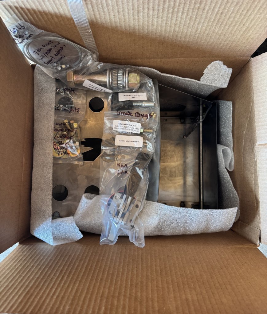

    Got this in the mail from @v5ensx today. Another piece checked off.

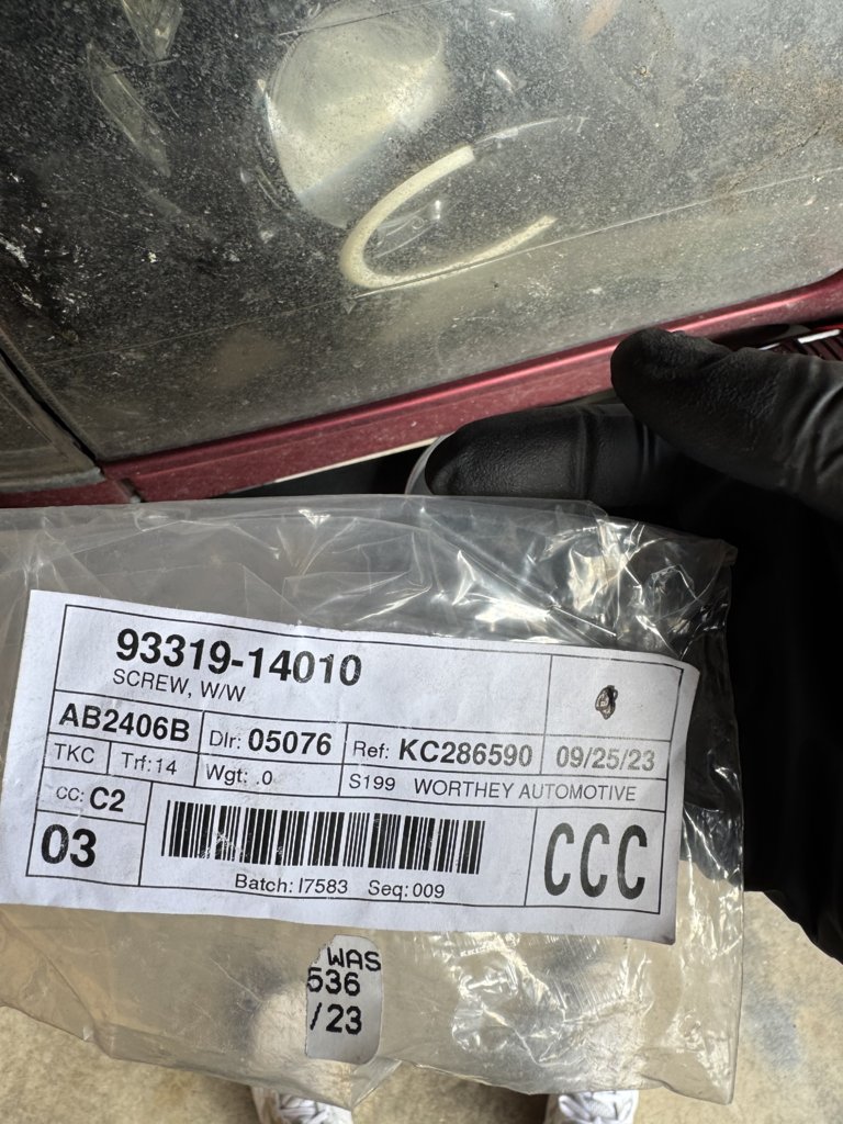

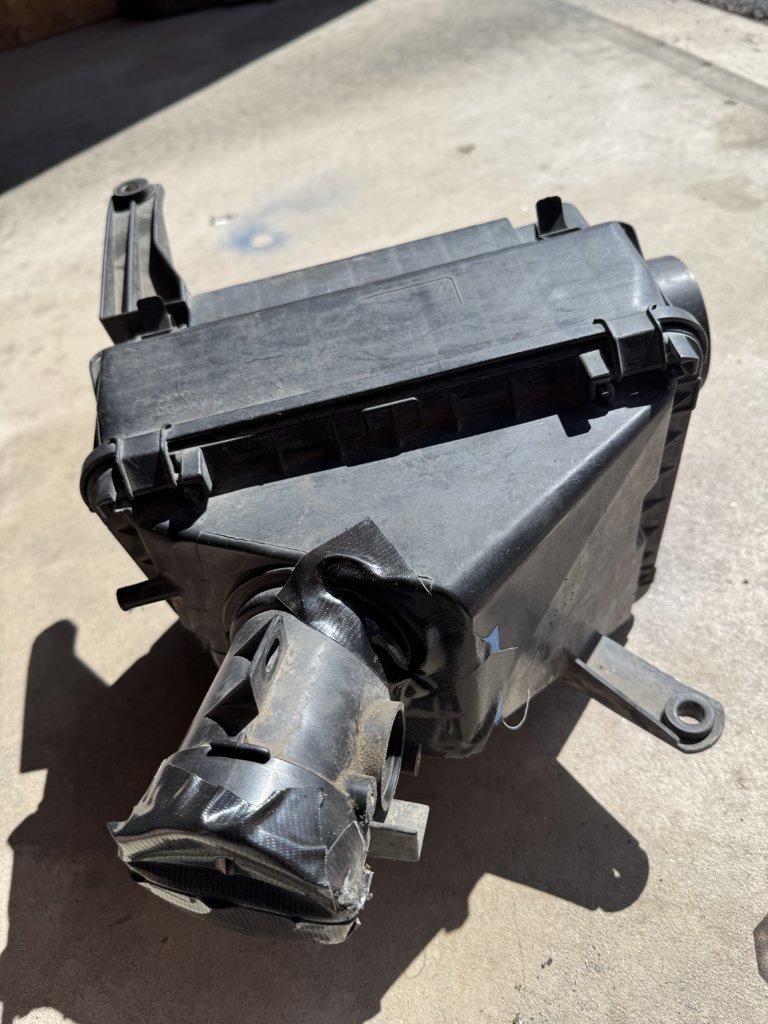

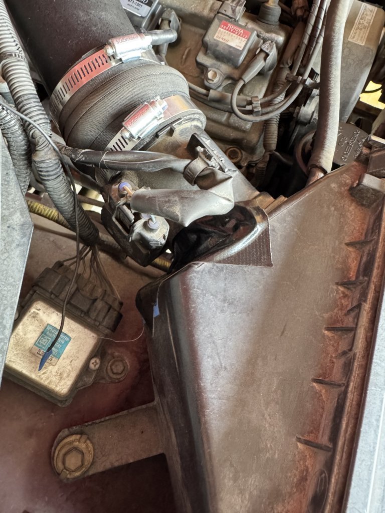

    More MX today. Swapped out the airbox with another OEM one I got from the Toyota yard.
    $130 not bad…better than $400 for a new one. Oiled filters are not welcome here so the sticker had to go.

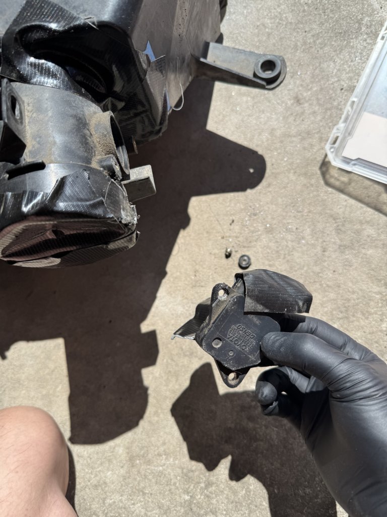

    Here’s the original one coming out. It’s always the easy fixes that seem to bring up more issues. But as pictured, the inlet neck is cracked halfway around.
    When trying to take the MAF sensor out one of the screws was stripped, naturally. Enter the dremel. Unfortunately the diameter on my cutting disk was too big to properly notch the screw head without cutting into the MAF housing. Didn’t feel like going out to buy a smaller one so I drilled the screw out.
    I called the dealership and luckily they had these on hand. The part # is not listed on the parts catalog but the parts guy ended up finding these. In case anyone needs to replace the MAF hardware here’s the part #.
    Simple green and a rinse and this junkyard piece is looking good.

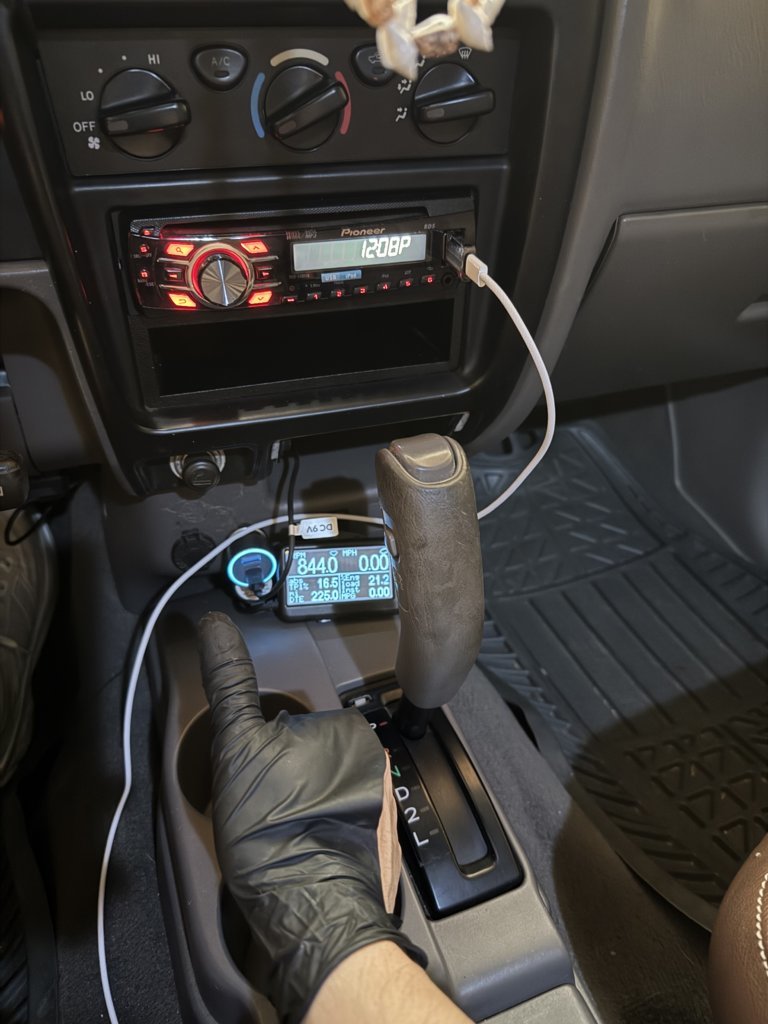

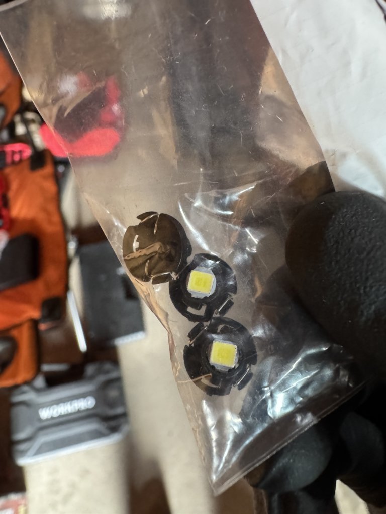

    Also got around to upgrading some of the lighting to LEDs which has been much needed. Great service from @csjumper2003
    I haven’t taken any pics of the dome or map lights but I also switched out the shifter light.
    I attempted the a/c cluster lights and unless I’m stupid or inept, these lights don’t seem to hold in the control board. No matter how much I try to turn them clockwise they just fall out. Any thoughts?

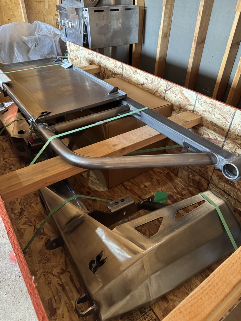

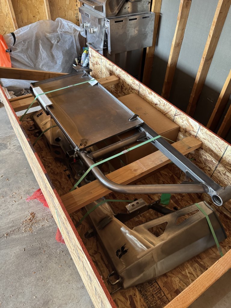

    Just came in today

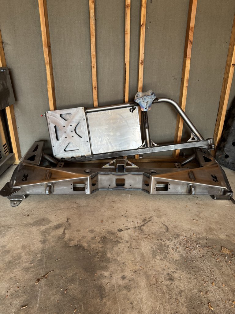

    The quality on Relentless Fab’s work is A1. Finally got a rear swing out with tire carrier. Last pic is the Jerry can holder.
