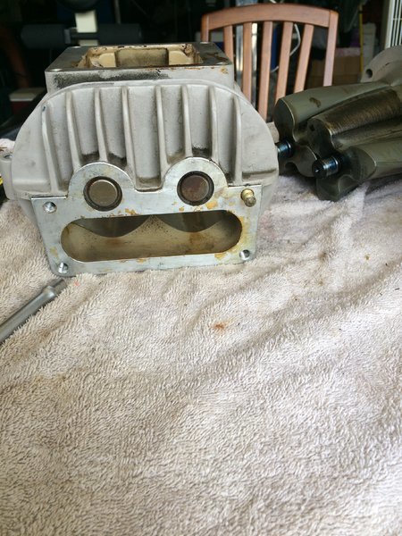

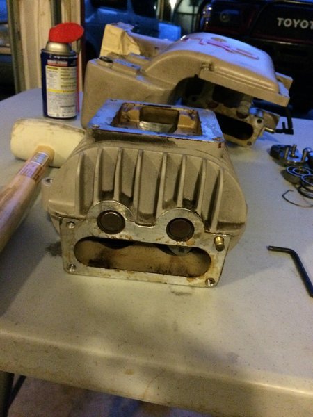

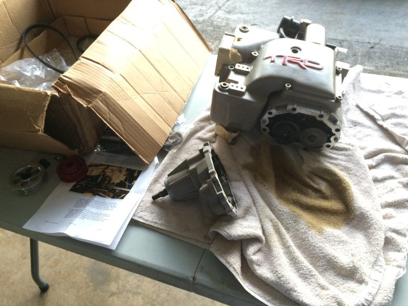

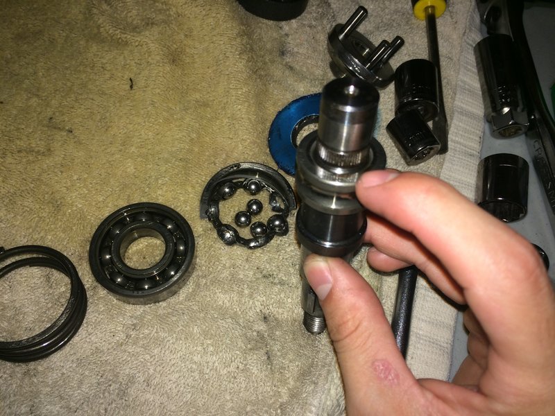

    Back in July I finally got to fully rebuilding the supercharger myself, after many trials and errors I got it done and had the satisfaction of completion.
    Here I opened up the nose cone to the smell of rotten bananas and gym sweat

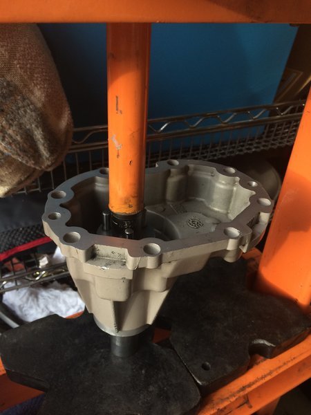

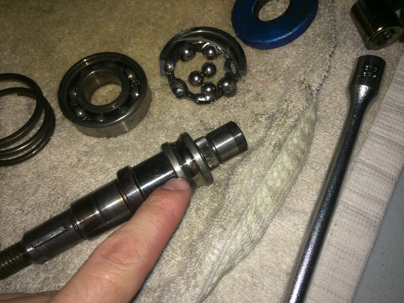

    My first manner of fucking up was exploding a bearing, I forgot to keep the spring under the bearing when pressing it out thus leaving the inner bore attached to the nose shaft.

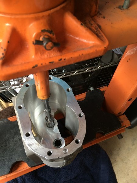

    Here I get the intake piece off and you can see the state in which the needle bearings are in. There's a nut on the rear that is a sucker to get off without grinding down a 10mm wrench to access the needle bearings.
    Pressing the needle bearings in and out was a breeze thankfully, not much to it.
    I made sure every inch of surface for new gasket was scraped clean and was very careful in keeping the rotors pristine and spec clean.

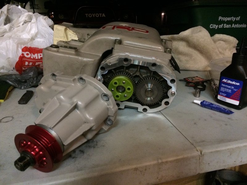

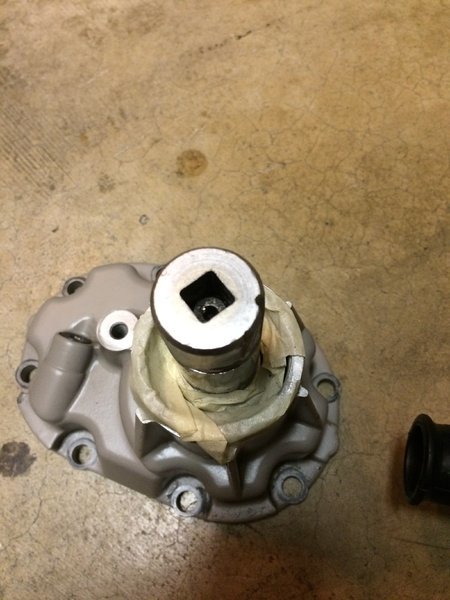

    Working on the nose cone became a different story; you must keep a socket on each side when completing the new bearing swap. The bearing that goes in the front of the nose cone where the pulley is installed must be kept pushed in as you are pressing from the back so it does not fall back out as you push the shaft with the rear bearing in.

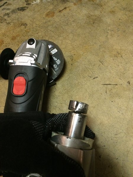

    Here comes fuck up #2 as I didn't take note of how deep the socket was in order to clear the cone shaft as it was being pushed in (giggity)
    Therefore surgery must be done to carefully remove the stuck socket trying not to fuck with the threading on the shaft.

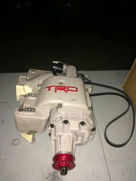

    After all bearings and new nose seal installed it was all downhill from here. I promise the surface never looked so clean since it was new.
    And done!
