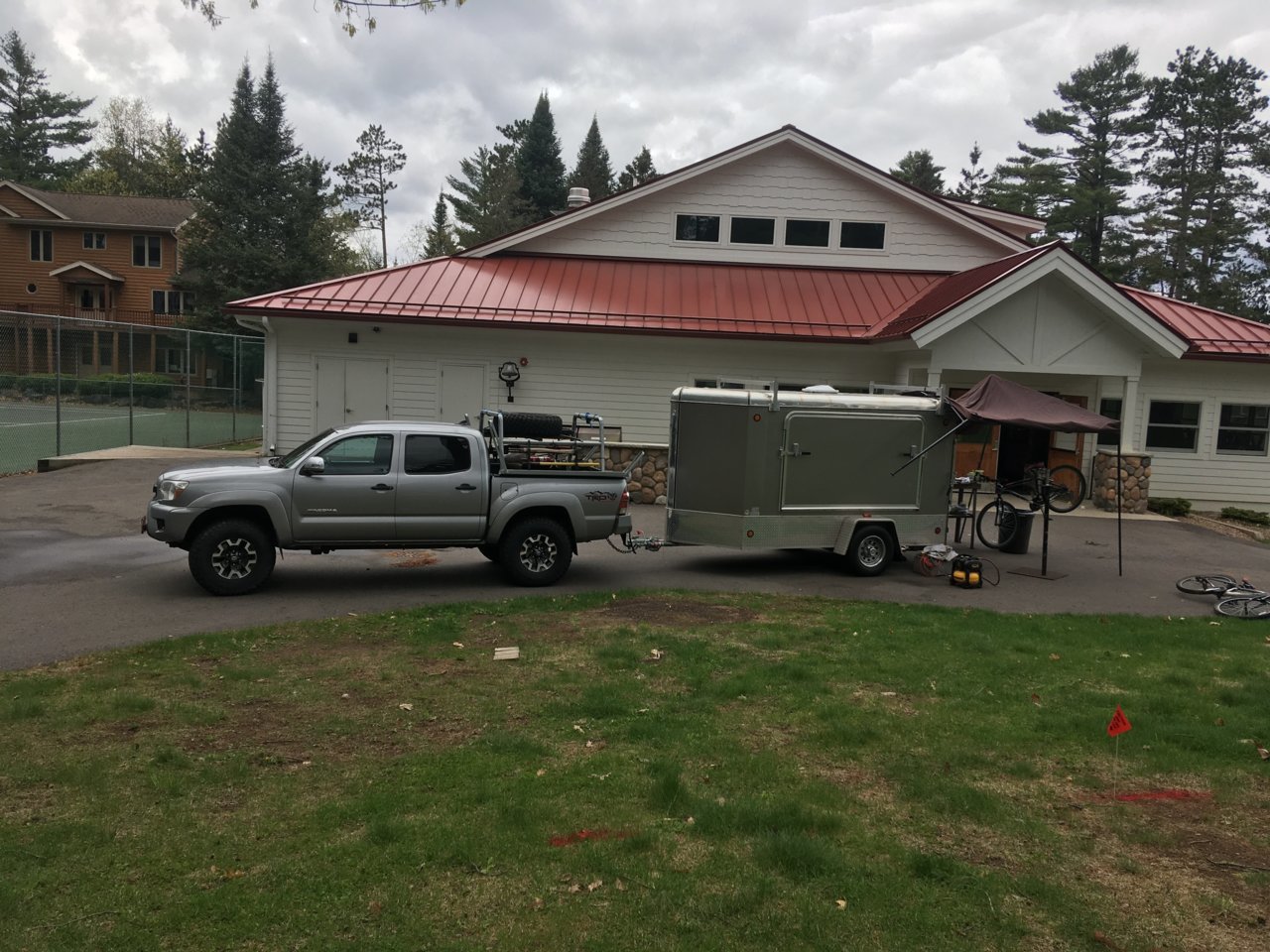

    I pull a trailer with a 2015 Dblc. Trailer weighs in at #3000. Truck and trailer weigh in at 8400. Truck has a Head Strong AAl in the back. Tows "heavy" and feels heavy. Constantly on the bump stops. Just ordered new springs from Alcan yesterday. Lew put me in #1300 over stock with 1" lift. In my opinion the truck needs springs if you tow anything but a canoe behind it...
