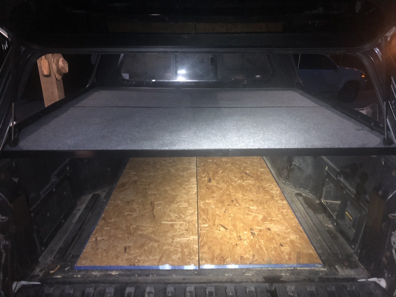

    Im moving back to college tomorrow and moving home at the end of last year I had the truck PACKED will all my stuff. Since I now have the camper top I knew I’d be able to fit more stuff but stacking doesn’t always work out so I decided to put a deck to separate the bed from the camper top to better utilize the space. Just 3/4” OSB sandwiched by 1 1/4”x 1 1/4” 3/16” thick angle iron. Got it all how I liked it and pulled it back apart. Angle iron was painted black and plywood was wrapped in outdoor carpet. Scrap plywood was cut down to use as slide outs as well.

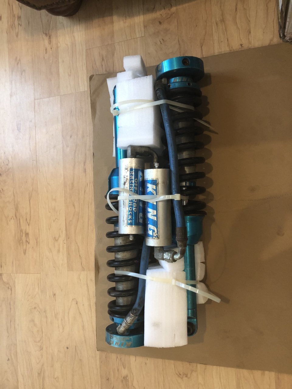

    Got these Johnny’s packaged up and shipped of to get rebuilt. It put a hurting on the wallet but I can’t wait to get them back.

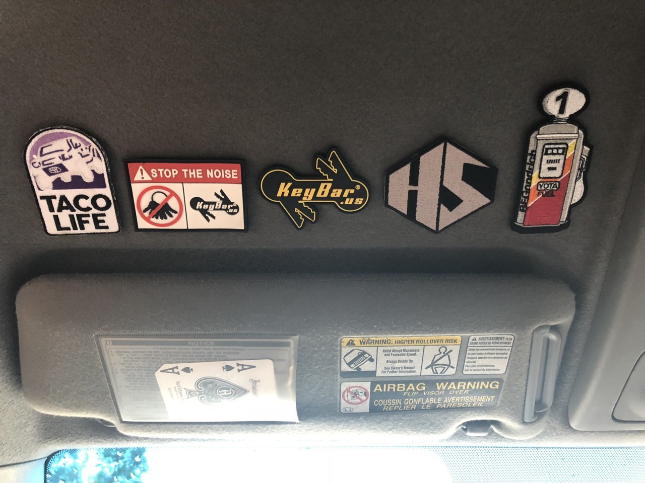

    00C4AC2E-265E-4A72-B87B-1F33B2A0B9BF.jpg So I started collecting patches. I have a ton more coming but one specifically I’m super excited about and it actually can be seen on most of these posts.

    Nice snag on the V1!!! :woot::woot:

    Thought you might like it. I saw it and knew I had to have it.
