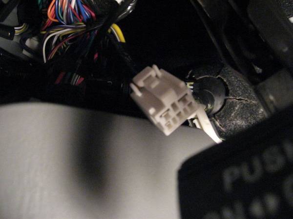

    Brake Controllers and their Install:
    You must have a brake controller because with a trailer at the tow rating of 6500 pounds you are asking the service brakes of your truck to stop more than double the weight they were designed to stop. (Based on a curb weight of roughly 4000lbs.)
    Also with a brake controller you can manually engage the trailer's brakes without engaging the trucks brakes. That is a lifesaver if the trailer should get a little squirrelly on you. What I mean is that you can engage the trailer brake which slows the trailer while the truck attempts to maintain its speed. This pulls the trailer into a straighter line behind the truck and takes away the room it had to sway when it was trying to move at the same speed or faster than the truck, and as such brings it back under control where if you engage all the brakes you'll likely only make it worse, as that way everything is still trying to move at the same speed.
    Also, even with a properly set up brake controller you stopping distance will still likely be at least one and a half times greater than the truck by itself, so you will still have to get used to it and alter some of what you do driving when you have a trailer in tow.
    Brake controller install

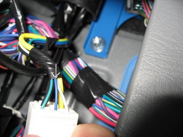

    The pigtail for the brake controller should have been in the glove box when you bought the truck. If not go back to the dealership and ask for it as it was part of your purchase price. (This is for v6's with the towing package from the factory only)
    The plug is under the dash on the driver's side right above the top of the kick panel.
    The trailer brake pigtail (I believe is Toyota part number 82132-0c010, but don't hold me to that) has five wires coming from it. A black/red tracer, solid green, solid red, solid brown and green/white tracer.
    The BLACK W/ RED TRACER is your (+) power to the controller
    The GREEN W/ WHITE TRACER is the stoplight switch. (Where the truck tells the controller to engage the trailer brakes)
    The SOLID RED is the output from the brake controller to the trailer itself
    The SOLID BROWN is the ground (-)
    The SOLID GREEN is the illumination circuit. (You will not need this for Drawtite and Reese controllers, just tape it up and ignore it.)

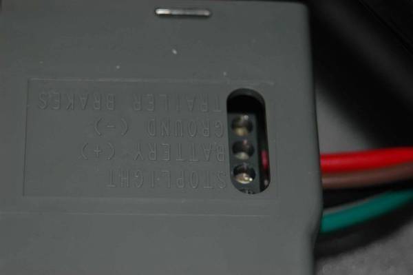

    That brings you down to four wires, which will match up with the terminals on the back of the controller, after that it is just plug and play.
    For what it's worth, I chose the Draw-Tite "Activator III" for my truck as I could find no good place to mount a brake controller. The Activator III is capable of mounting on any angle, anywhere, and has a hand box that comes out of it with your display, adjustments, and manual trailer brake activation switch.
    Now, in all honesty with the supplied length of wire from the pigtail, there is absolutely nowhere under the dash that you can mount the controller. So what I did was to go to the local hardware store, pick up 4 feet of each color wire. The RED W/ BLACK and the SOLID RED were 12 gauge, and the others were 16 gauge. I soldered the new wire to the factory harness, heat shrunk the connections, taped the whole thing into its own harness, and then routed it down through the kick panel, under the door sill molding, and out under the driver's seat following the wiring for the seat belt light.
    The controller itself will have four openings and four screws in the back of it. Each opening will be marked as I have described above. You would then strip a quarter inch of insulation from the correct wire, insert it in the opening and tighten down the corresponding screw to clamp the wire down and make contact. Repeat for the remaining three wires.
    I Velcroed the controller itself to the carpet under the seat, and then when I am towing, I plug the hand box in and leave it sitting in one of the cup holders in the console.
    Now, if you don’t have the Gen 2 V6 with the plug and play wiring, you can still have a brake controller. You’ll just need more wire, and a solder less quick connector. You run the positive and negative wires from the battery to the location of your controller. You route the output signal from the controller back to the trailer brake pin (pin 2, bottom left) in a 7-way round plug. Then you just splice the input signal wire into the brake switch wire. You’ll need a wiring diagram of your truck for this, as I do not know which color wire that is off-hand.
    You may also see something called a pulse preventer mentioned in your brake controller instructions. A pulse preventer is not required in Toyota and most other foreign applications because the turn signals are a different bulb and socket from the brake lights. A pulse preventer is used for vehicles like Fords where the turn signal and brake light are the same bulb, so the pulse preventer stops the trailer brakes from engaging if you were say driving up a steep grade with your hazard lights on.
    Just for the record the activator III controller has been discontinued, not because it had any problems, but because it was fairly expensive compared to its competing models. IMHO, however it is the best controller for the money and the only practical one for our trucks. You can still find them through some retailers as well as on eBay from time to time.

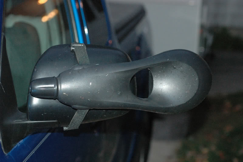

    Extra towing mirrors are also a must. A typical RV/toy hauler is 7 1/2 to eight feet wide. With the stock mirrors you'll never be able to see what's along side the trailer much less what's behind it, and without a team of spotters on FRS radios directing you, good luck backing it into a campsite.

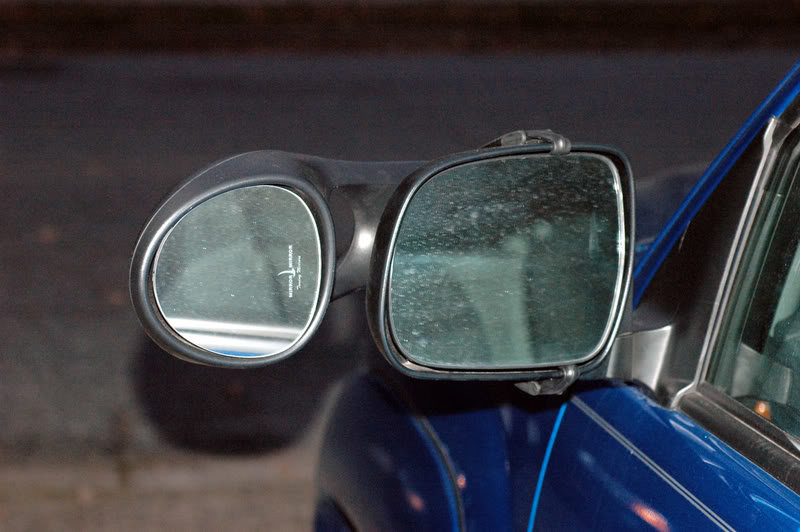

    These are the mirrors that I use.
    I did a pretty extensive search, for something like the mirrors that you can get for the big three trucks where they just replace the stock mirrors and can telescope out when you need them, but it seems like nothing like that exists for Toyotas.
    So I did the next best thing and went to a campground, and walked around and looked. Then I talked to people driving Tacomas and 4-runners and such.
    These mirrors came highly recommended, and I have used them for over 3000 miles this summer and have no complaints other than the little rubber feet are cracking from the sun, but I am going to e-mail the manufacturer and bitch and see if they send me some new ones, but if they don't I'm happy enough with the product that if all I have to do is replace the rubber feet every two years or so then I'll be ok with that.
    Here's how the look on the truck.
    Also, when you buy them, in the box will be an order form for mirror storage bags and wide angle replacement glass. I'd say pass on the storage bags, but to go ahead and get the wide angle glass for the passenger side mirror as it makes it so much easier to adjust that mirror and see to back the trailer.

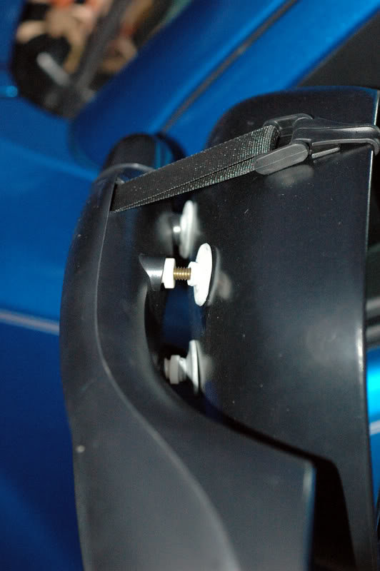

    How they mount to the stock mirror.

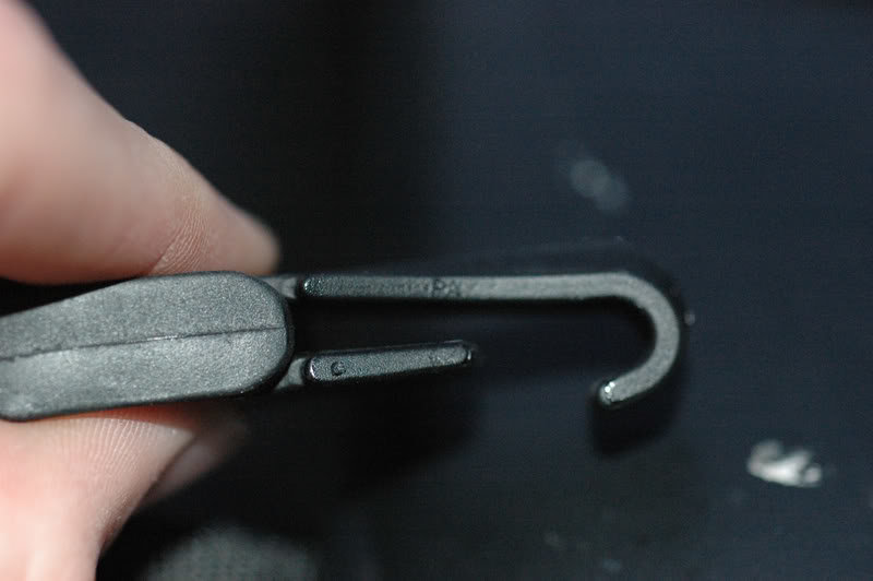

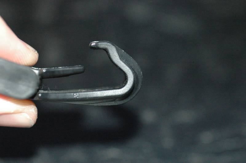

    There are two types of mounting hook in the box with the mirrors. Use this one for the top of the mirror.
    And use this one for the bottom of the mirror.

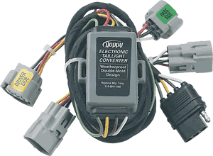

    Chapter 9 Adding hitch and wiring to a non tow package equipped truck:
    Ok for those of you who have a Tacoma already and have now decided to tow with it. Here are the part numbers and instructions for your hitches and wiring adapters. The listed adapters give you a standard 4-flat wiring connector. This is standard for flat-bed light weight utility trailers, and most small to medium sized boat trailers. This can be adapted to a 7-round RV style plug as well and I have included the part number for that item, but it will only provide lights and turn signals without some additional modifications which I'll get into at a later date.
    Gen 1 Tacomas:
    4-flat wiring adapter: Hoppy Litemate part number 43315 (for 84-94 trucks {except T-100} and 95-04 Tacoma)
    Instructions here.
    Buy it here.
    Class III receiver hitch:
    Hidden Hitch part number 87579
    Hitch is rated for up to 5,000 lbs. Gross Towing Weight with a maximum of 500 lbs. tongue weight.
    Hitch is rated for up to 5,000 lbs. Gross Towing Weight with a maximum of 500 lbs. tongue weight when combined with the use of properly installed weight distribution equipment.
    http://Drawtite part number 75078
    Hitch is rated for up to 5,500 lbs. Gross Towing Weight with a maximum of 550 lbs. tongue weight when combined with the use of properly installed weight distribution equipment.
    Gen 2 Tacomas:
    4-flat wiring adapter: Hoppy electronic tail light converter part number 43355 (for 94-98 T100 and 05-08 Tacoma)
    Instructions here.
    Buy it here.
    Class III receiver hitch: Hidden Hitch part number 87581
    Drawtite part number 75236
    Then to set either up to accept a 7-way round RV style plug you would need the following two items.
    4-flat to 7 round vehicle end adapter.
    7-way round harness mounting bracket
    I'll cover taking this set-up and adding a brake controller to it as the information becomes needed.

    Step 5. Locate the factory brake controller harness, it's up there just above the kick pannel and it looks like this.
    We are looking for the solid blue wire.
    Step 6. Use your 16 Gauge blue wire and quick splice, and connect them with the solid blue wire above. Tape up your connection and then routhe the other end of your 16 Gauge wire to the under the seat location with the rest of your wires.

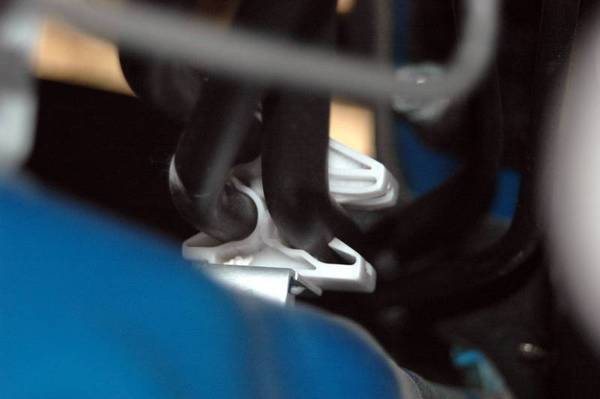

    Step 8. Route the 10 Gauge Blue wire down to the fuel lines, and along the fuel lines. Securing it with zip ties as you go.
    Continue along the fuel line untill you are roughly under the driver's door where you will see the wire loam for the harness that runs to the rear of the truck. Switch to running your new wire along this wire loam, or if you are really resourcefull you could route it into the wire loam, securing it with zip ties as you go.

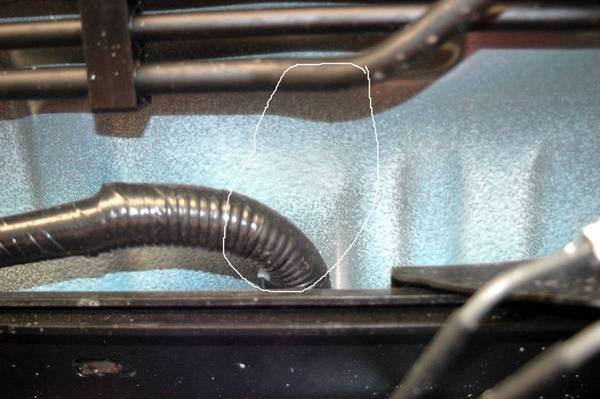

    Step 9. Once you reach the back of the truck you'll be looking at your 4-flat to 7-round adapter. You'll have the 4-flat connectors plugged into one another and secured already, and you'll be looking at a few bare wires. Trailer wiring colors are supposed to be universal. That should mean that the blue wire on your 7 round adapter is at pin two. (bottom right, the 5 O'clock position as you are behind the truck looking at the plug) Regardless of color, (hopefully it is blue) that is the point where you are going to join the wire you just ran to the 7-pin connector. Make sure to slip the heat shring tubing over the wire before you join them, strip some insullation, use a solderless connector, and crimp the hell out of it. Slide the heat shrink tubing over the connection and shrink it up, then electrical tape it up just to make sure it stays dry. Finish securing the wiring and get ready to move back into the engine bay.
    Step 10. Clip the RED 10 Gauge wire so that it is a little longer than it needs to be to reach the mounting location of your choice for the circuit breaker. Connect the end of that wire to one post of the circuit breaker. Connect the remnants of the RED 10 gauge wire between the other post of the circuit breaker and the positive battery terminal.

    Step 12. Return to the interior of your truck. Look at your brake controller, and you'll see that there are 4 screws on the back side of it. One marked Stoplight, One marked Ground, One marked Battery, and One marked Trailer Brakes.
    Strip a quarter of an inch of insullation from each of the 4 wires that you previously ran to this location and insert them and tighten each screw down as follows:
    RED 10 Gauge wire goes to Battery (+)
    WHITE 10 Gauge wire goes to Ground (-)
    BLUE 10 Gauge wire goes to Trailer Brakes
    BLUE 16 gauge wire goes to Stoplight
