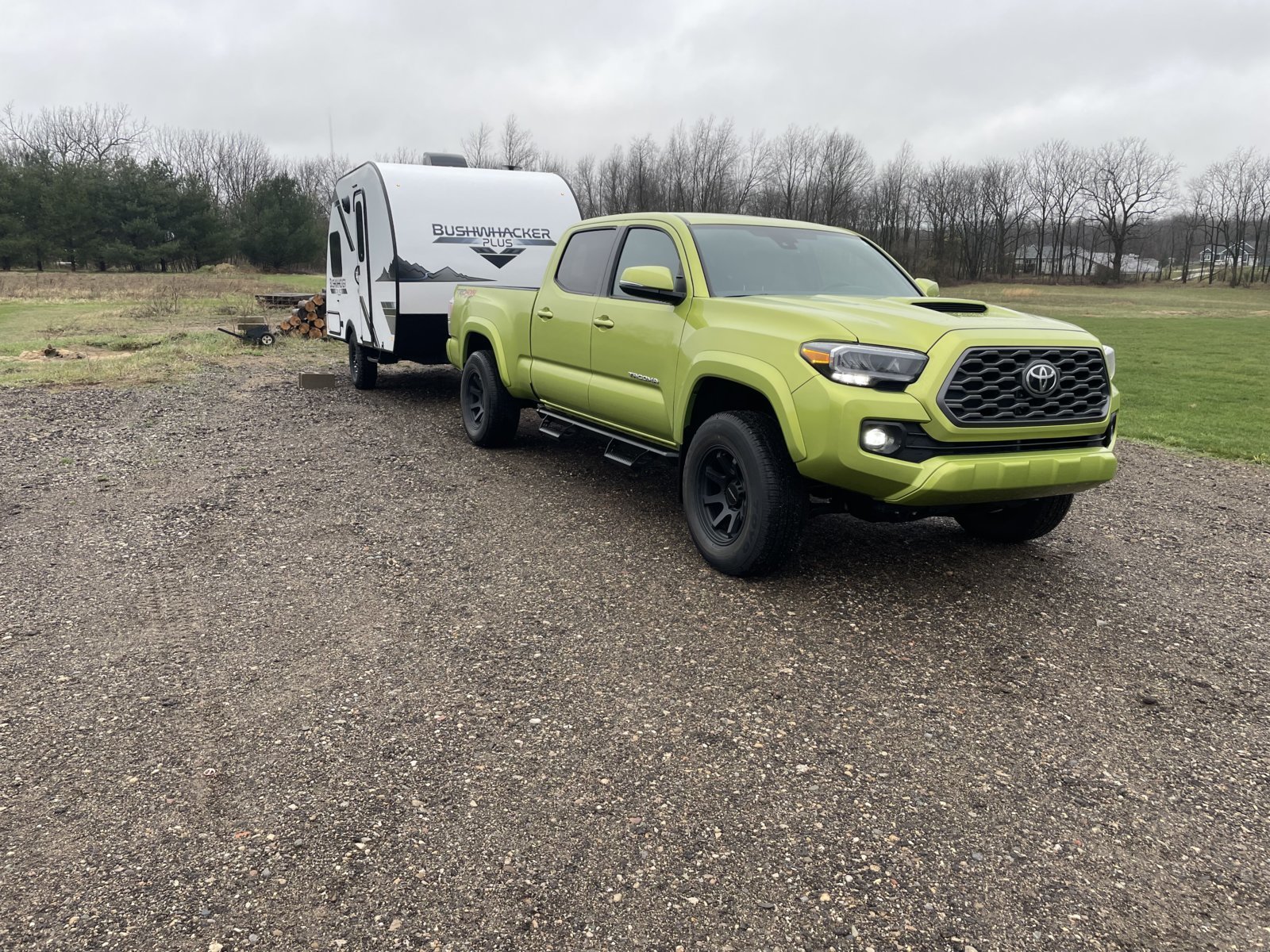

    Just picked this little guy up. It’s just over 2k lbs empty. I suspect being around 2500 once gear is loaded etc.
    It seems like the sweet spot towing with the 3rd gen auto trans is around 55-60mph. Would you agree? It was a quite windy day when I picked it up and 65mph was around 4K rpm, wouldn’t shift to the next gear.

    I occasionally tow a similar sized trailer with my 2nd Gen and I'd prefer to have the engine at 4k rpm staying in one gear than a lower rpm with the transmission hunting. Have fun camping!

    The speed you travel will depend on the terrain and weather for each trip. I'm typically traveling between 55-65mph on the interstate with a trailer. As a general rule when towing, unless there is no wind and the road is very flat, I put the transmission in 4th gear. That keeps the trans from hunting for gears which will cause extra strain on the powertrain. In the 2nd gen auto trans, 4th gear is a 1:1 output ratio, 5th gear is a OD .71:1 ratio. In the 3rd gen you get an extra OD gear, but is still 1:1 in 4th gear. Overdrive gears were never meant to be a towing gears. On occasions when the road was flat and I had no wind or a good tail wind, I'll move the trans into overdrive. But if either of those things change I'll downshift from overdrive. I don't wait for the engine to bog down before change the gear. Assuming the trans is the same from '19 to '23, this chart should be helpful to see the different gear ratios.

    This is awesome info. Thank you!
