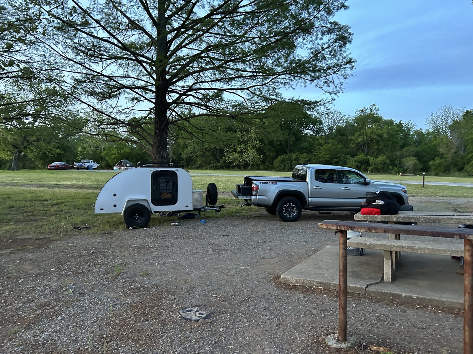

    I appreciate this towing information. I am two weeks old, as a Tacoma owner and love my 2022. My teardrop is around 2,000 lbs without adding water and other essentials. I would never have thought to keep it in 4th gear and didn’t last weekend going to Ft. Gibson Lake.

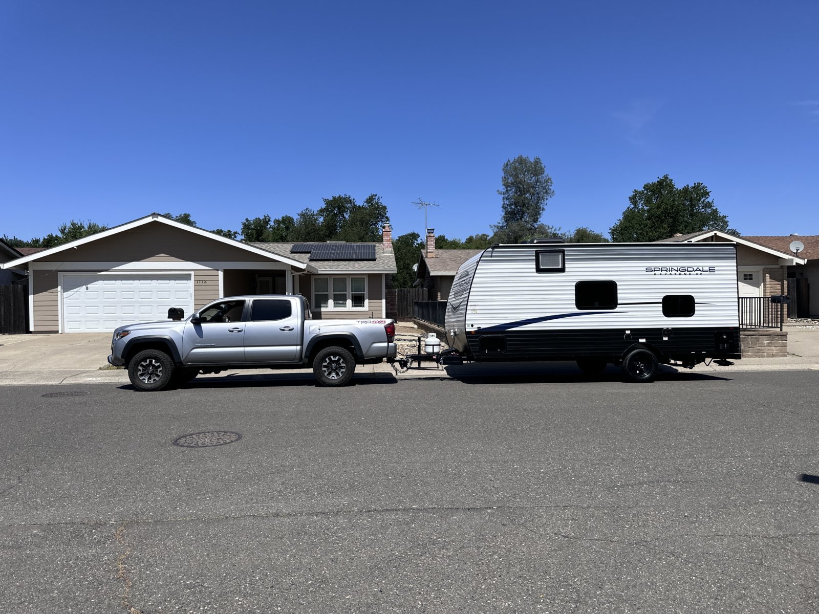

    All hooked up just have to add the sway control bar tomorrow. How’s this WDH setup look.

    2K is not a significant amount of weight. For me the decision to keep in 4th gear would depend more on the terrain and speed. If the ground is mostly flat and the trans is not down shifting frequently, you could get away with leaving it in OD. If you are in an area with hills and curves then I would definitely keep it in 4th or less depending on the speed limit. With a goal of keeping the RPMs in the 2-4K range without frequent shifting. An example would be driving on a county road with frequent hills, I might choose to cruise in 3rd gear at a steady 4500 rpm, instead of 4th gear that might be at 2500 rpms but it shifts down to 3rd at every other hill. I'm just guessing on the speed vs gear here, but I would not want to try to maintain 45mph if the rpms are at 5K+ in 3rd gear. I would either shift into 4th gear or slowdown enough so that I was not close to the redline.

    Looks pretty level to me.

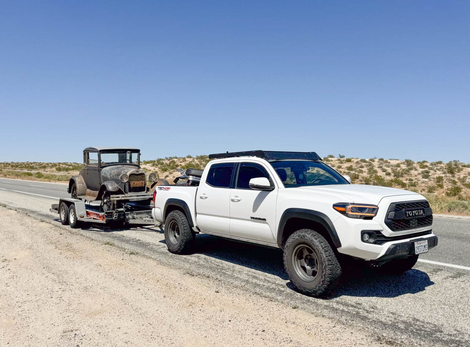

    Picked up my new project this past Monday. 1928 Ford Model A Coupe
