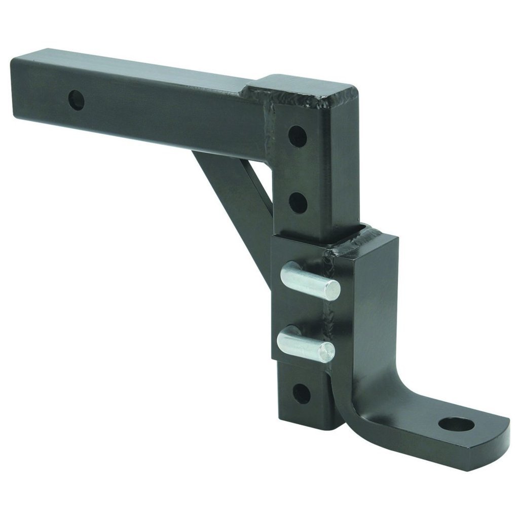

    is it recommended to adjust hitch height for load?
    empty trailer all was fine.
    but loaded, truck squats.
    Front of the trailer dips.
    Debating finding a jack to unhitch
    And move the tow ball one setting upward to see how much that helps even things out
    it almost looks like this now (loaded): “nose down”
    Jack is buried in the trailer (oops); worst case I can dig it out.
    Or am gonna call see if Uhaul or Autozone have one to use there for a minute (lift up trailer to reposition hitch)
    it’s currently on lowest holes

    Yes, you want the trailer to be level when towing.

    It might help, but it won't fix it if the problem is too much weight in the front of the trailer. If the problem is a weight imbalance, you'll need to move a few heavy items to behind the axles. What you describe sounds like weight issue. The tongue weight should not be so great that you need floor jack to unhitch the trailer, the trailer's own jack should be sufficient.

    I don't think those uhaul trailers have a jack. They're made with a handle to lift it up and mount to your ball by hand. But yeah, sounds like he didn't balance the trailer very well. Needs re-arranged most likely.

    On one side, I once had a trailer I couldn’t lift and needed to floor jack.
    that was squatting 225x20 ATG
    on the other side, I then pulled that trailer 2300 mi without issue
    I guess lesson learned next time I will try to ignore Uhaul cockeyed “heavy to front”
    And put major weight in the middle above the load supporting axles, leaf springs, and tires, which makes more sense
