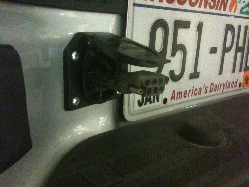

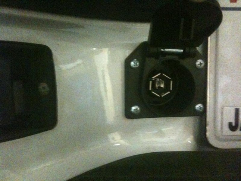

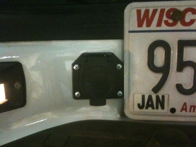

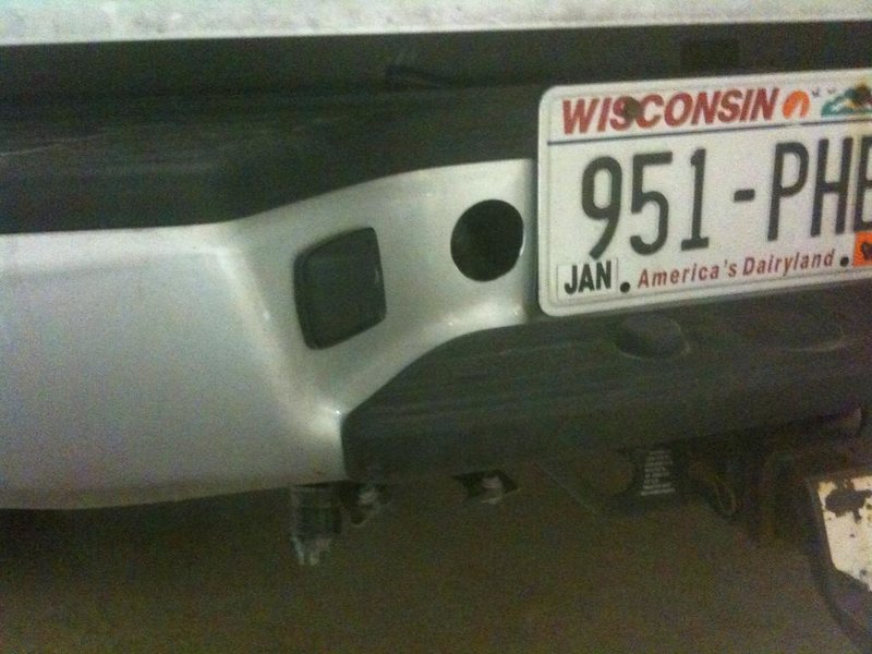

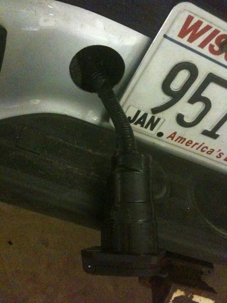

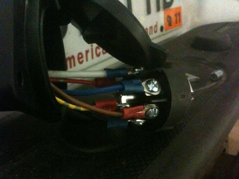

    Did it yesterday after work. Looks sweet. Was gonna pick up the one that had the 4 pin on the side in addition to the 7 pin. It plugs directly into the factory harness, but I was afraid it wouldn't fit. After putting this monster in I am positive it wouldn't had fit lol. Oh well, I have my 4 pin plug in.
