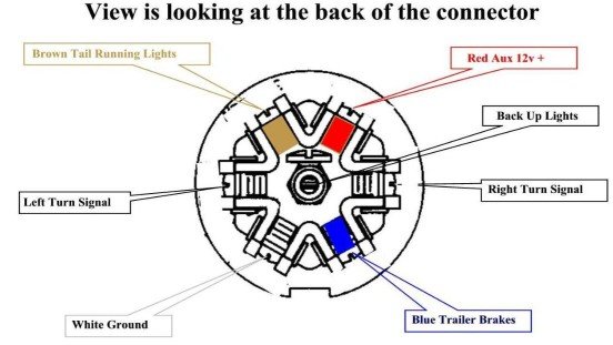

    2013 Double Cab Tacoma
    I have a 2010 tacoma without tow package. I had my toyota dealer put a hitch and 7 pin plug on the vehicle at purchase. I am going to buy a prodigy brake control. I thought I could just buy the pigtail and conect the controller to the plug near the kick panel. I noticed that I have 2 wires that are comming out of my round 7 pin trailer plug at the rear of the vehicle. One is blue and the other is purple. I am not sure where these are supose to connect to. Any help would be apreciated.

    Sounds like they probably only ran 4 pole to the harness, and you're in the same boat that I am.

    The BLUE is for the brakes. This will connector to the brake output from the controller.
    Now the PURPLE is confusing. Purple isn't a known (or common) color for trailer wiring. I can probably conclude that this is for the Reverse/Aux circuit. It could also be for the constant (12v+) for charging the trailer brake battery. You will need to test light all the connections at the connector and compare to a diagram to determine what the function is and connect it properly.
    The only thing that worries me is that if the dealer added the connector, their should be (3) wires not connected.
    1. Brake
    2. Reverse/Aux
    3. Constant (12v+)
    If there really is only (2) wires and the connected the wire for the Constant, how did they wire that in?
    Again, the only way to tell is using a test light and verifying that each terminal is wires to the proper function. Here is a diagram, just make sure you compare to the truck side as it will be reversed on the trailer end (when laid out in a diagram, that is).

    I don't understand. Do you not have the plug under your dash/near your kick panel? If you do, you should be able to use the Toyota plug and wires with the brake controller. I am getting ready to put a Prodigy in my truck and it seems pretty straight forward. I don't understand the reference to the 7 pin plugs in this context.

    After removing the tape the dealer put on I also found a black wire too. Should these wires be into the rear wirring somewhere in the rear of the vehicle or do I have to run wires to the front of the vehicle. I found the plug near to the kick panel and thought all I had to do was plug in a brake control. I am wondering if the toyota dealership messed this all up. Thanks for any help.
