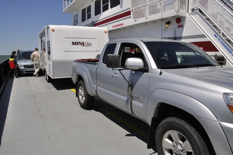

    I use these mirrors, they work great.

    do the straps leave marks on the side of the truck?
