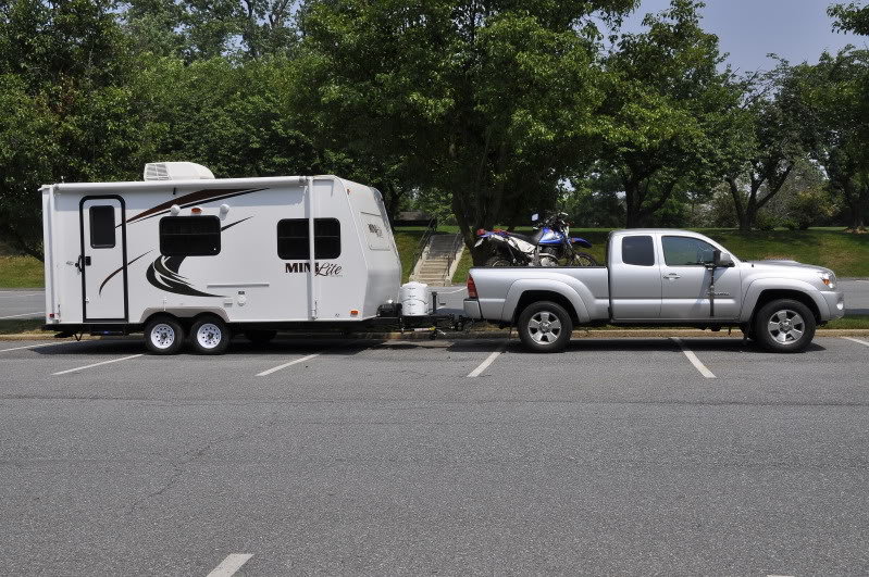

    My apologies if this was already answered, but when figuring out the tongue weight of a TT, do I include the WD hitch weight? (95 lbs. shipping weight) Also, does a WD hitch have any effect on the tongue weight capacity? I am looking at buying a 2002 Fleetwood Coleman Caravan 25SLB, and I can only find the dry weight and GVW. I am not having any luck finding any kind of published tongue weight, and as of right now, that is what will make or break the deal. Thanks! :taco:
  11. Mar 2, 2013 at 7:57 PM
    #671
    psmcn
    psmcn Well-Known Member
    Sep 15, 2010
    #43306
    339
    Paul
    Rockville Md

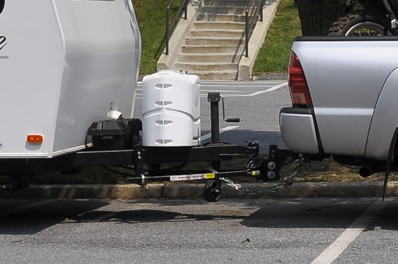

    Once you start to conciser the WD system the TW pretty much goes out the window but you should try to stay close to your trucks max TW. The hitch on the tacoma is a class 4 hitch. If it was on a bigger truck it could be rated up to 10.000lbs with a TW of 1000lbs. Because of the Tocos lighter weight and smaller drive-train it is rated at TW 650 and a trailer weight of 6500. These numbers are for a single ball mount TW with the MAX Trailer weight. Once you put the WD hitch on it is a matter of equalizing your TV and trailer using the WD system and making sure you have a strong enough system to handle the weight you are trying to distribute. You should never go over the max trailer weight rating or truck cargo rating though. ANything, cargo or weight added aft of the rear axle is considered as part of the TW. This is why you adjust a WD hitch with your TV and trailer loaded. When my rig is loaded I with bike in the truck and full tank of water with full LP tanks an two Batts. I have to really crank the WD system to get it level but it works fine and my truck handles great.
    Here is a link on hitched
    http://www.etrailer.com/faq-weightdistribution.aspx
    Here is a link on how to measure TW
    http://hildstrom.com/projects/tonguescale/index.html
    A pic of my rig completely loaded.
    Hope this helps.
    Paul

    Leave the tanks were they belong. You want them secure for safety reason that I think you can understand. When you get your WD system load your trailer and truck then set up your hitch. I hope you got the 8-10K lb hitch for your rig. Anything else would be to light. I think you will be fine with the TW. Take your time when you set it up, take it for a drive then adjust it as may be needed. My trailer is a little over 4K lbs loaded. With the Taco I know its pulling that weight but I have never had the "white knuckle" experience that some talk about. My rig is steady and I can feel comfy with one hand on the wheel. I never exceed 65mph it makes the Taco work to hard with the wind resistance. I don't know what type of hitch you are getting. I have the equalizer and it has worked great after I got it set correctly.
    A pic.
    Notice the bars are parallel with the frame of the trailer. This is the correct position for every system I have seen. If they are low or hi to find your proper level of the TV follow the instructions to level the bars until you have the desired weight distribution.
    I will send you a PM with my email address.
