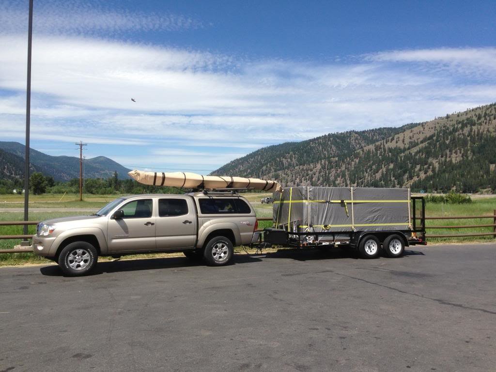

    go for it man! I got airbags on mine and is like night and day difference! I just moved cross-country and towed about 4k pounds. The whole rig did well and the drive was very comfortable.
    Here is a pic I took during my move from GA to WA:
    a4344644-24cd-4dc9-9480-a3fac88104b9_zps_aa7ca6975aabfb87158d064e050a7b72addad409.jpg

    How big is your trailer? Looks like it's right about the size i'm thinking of getting

    My trailer is a 7x14 from bigtex. Tows nicely.
