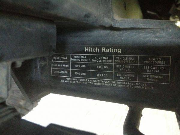

    Clicko BUILDo
    thats weird that a second gen can only tow 500 more lbs and 50 lb more tongue weight than me...I figured they would be much higher.

    Well actually if im reading it right the gen 1 are 5000 and 500 tongue weight.
    So its 1500
    and 150 tongue weight more then the gen 1's

    False,
    my tow package is Factory -
    and on the tow package it says
    6000
    and 600 tongue weight.

    Oh, I was just going off the post by the op.

    Where does it say you can tow 6000 #s? According to the 2nd post also, 1st gens NEVER came with a towing package. Also they are rated at 5k#.... But do show where it states on your vehicle it can tow 6k#. So that way OP can update his post since apparently he is wrong.
