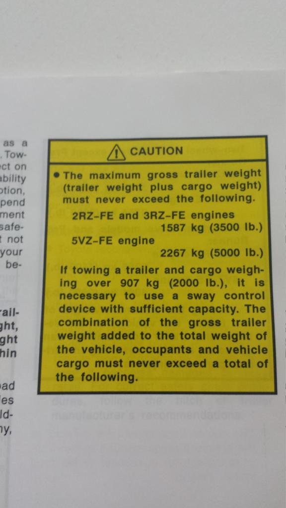

    As a 2009 Tacoma owner. I had a Class III hitch installed. I have the 2.7L engine, 5 speed manual, Reg cab.
    Am I still restricted to the 3500 lbs limit?
    The trailer I was going to first use was a 6 X 12 Uhaul enclosed unit.
    No need for a tranny cooler. Oil cooler for the smaller engine?
    The trailer has hydraulic style surge brakes. I will eventually get an electric controller but was wanting to be able to haul around 4000 lbs from eastern Washington to western Washington (not much in the hills arena).
    Thoughts?

    - Class III hitch can tow up to 8,000 pounds, so you can tow that.
    - Dont need tranny cooler; overrated.
    - brake controller; overrated.

    Uhhhh, I STRONGLY disagree with Adrians broad statements. Although in Colofan's particular case with a manual transmission a transmission cooler is not an issue, transmission coolers themselves are NOT overrated, but a neccessity for any significant towing with an automatic transmission. Without it you put your transmission at serious risk of catastrophic failure.
    The towing capacity of a truck is not determined solely by the hitch itself. I could weld a horseshoe coupling rated for 50,000 lbs in the bed of my Tacoma, but guess what? I still can't safely tow a fifthwheel trailer that exceeds the towing limits of my truck. The hitch doesn't change the suspension or the powertrain of the truck, which are two huge factors.
    With this particular style trailer you can get by without the electric brake controller. But trust me, electric brake controllers are REQUIRED to stop MOST decent sized trailers. Nearly ALL travel trailers with the exception of the smallest of pop-up campers and most boats will need the brake controller too. In essence, if the trailer is equipped with electric brakes you absolutely NEED the brake controller on your truck. Your truck brakes will stop your truck. NOT your truck plus several thousand pounds. Without the "overrated" brake controller you truly risk your life and the lives of others on the highway. Your brakes WILL fail you sooner than later if you try to stop any significant towed weight with just truck brakes.
    The response is irresponsible and misguided.

    "Tundra" is the key word. Yes, I agree that he should be ok with the uHaul set up,if he is cautious, but the the "hitch is rated 'x'....SO you can 'y'...is a VERY dangerous statement.

    Most Semi truck accidents happen from not being able to stop or stop quick enough. Not because they can't pull a load. If you have never towed anything you will learn quick enough to keep an 8 second or better following distance when rolling. It will all make sence the first time you have to make a sudden stop and the trailer weight almost pushes you into the back end of the guy in front of you.
    Keep it safe Rollin and keep it between the lines.

    You can pick up the entire Tacoma by the hitch that alone does not make it capable of towing 8000#
    No cooler needed if you own a transmission shop.
    Brakes required in most states for any trailer over 3000# some require brakes on trailers 1000# and up.
    Tacoma manual says 1000# up
    Even states with lax weight laws require a stopping distance of 40' at 20 MPH so you do the math easy to stop an empty trailer.
    You must comply with the state law even if you are just passing through that state.

  11. Oct 18, 2014 at 9:15 AM
    #931
    Supra TT
    Supra TT Supercharged Lifter
    Jan 3, 2011
    #48645
    7,226
    Eric
    Indiana
    2000 SAS D60 F/R Supercharged
    Supercharged on One Tons
    Perhaps they changed it in the 2001-04 generation. Either way, I'd never pull #6k with my 1st gen... That's just asking to die.

    Report back everything went smoothly. I towed 3800 lbs. The surged brakes were funky as others have noted. Electric brake control is in my future but since the Uhaul doesn't brake that way kind of a waste for this first tow with my Tacoma.
    The question I was asking mostly was about the addition of the oil cooler on the 2.7L 4 cylinder engine? I did not have temperature issues at all but we are talking about 50 degrees right now.
