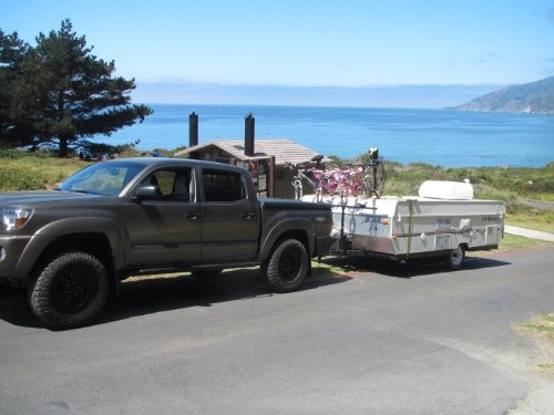

    I camp every year at Big Sur and I know that road like the back of my hand Lol. I recently just bought a fleetwood pop up and this will be my first year towing it up there, I live in HB as well. I've been pouring over all the information I can find on towing in perpetration for my trip this June. Thanks to this thread I think I've got the all my bases covered, brake controller added, upgraded to yellow stuff pads in the front added a tru cool lpd trans cooler and installed a ultra gauge to top it off. Will be servicing the truck next week trans flush, radiator flush, brake fluid flush, power steering flush, oil change and what ever else the manual call for at 50,000 miles. I'm kinda looking forward to hitting the hills on hwy 1 to see how my truck does, I've never pulled anything up that road more than 1500 lbs. This thread has been an invaluable source of info.
    Thanks!
