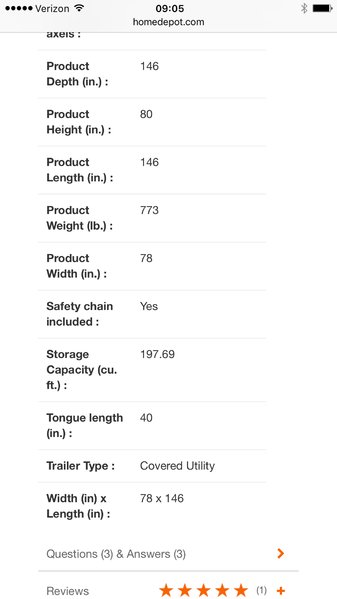

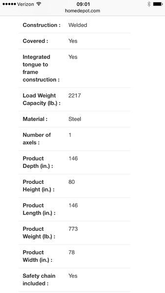

    image.jpg Super newbie here. I have a 2016 Tacoma OR with tow package. I am going to be moving from Kentucky to Florida and want to use a trailer to move. Does anyone see any problems or have any pointers with this trailer? Will my truck be able to handle it?image.jpgimage.jpg
  16. May 14, 2016 at 10:59 AM
    #1176
    LeftCoastNerd
    LeftCoastNerd Old 'nuff to know betta
    Mar 27, 2016
    #182459
    1,890
    John
    Santa Cruz, California
    08 AC 4x4 OR 6sp
    if those numbers are right, 770 lbs dry, 2200 lbs capacity, thats 3000 lbs GVWR, that should be fine. for sure you'll want to use a hitch bar that puts the ball low enough that the front of the trailer is lower than the back when its hitched up on the level, and you'll wnat to load the heavy stuff in the trailer first, distributed so the tongue weight is 10% of the total (200 lbs if you put 1200 lbs in the trailer for a 2000 lb gross). it will ride better with a WDH, its probably so short you don't reall yneed antisway.
